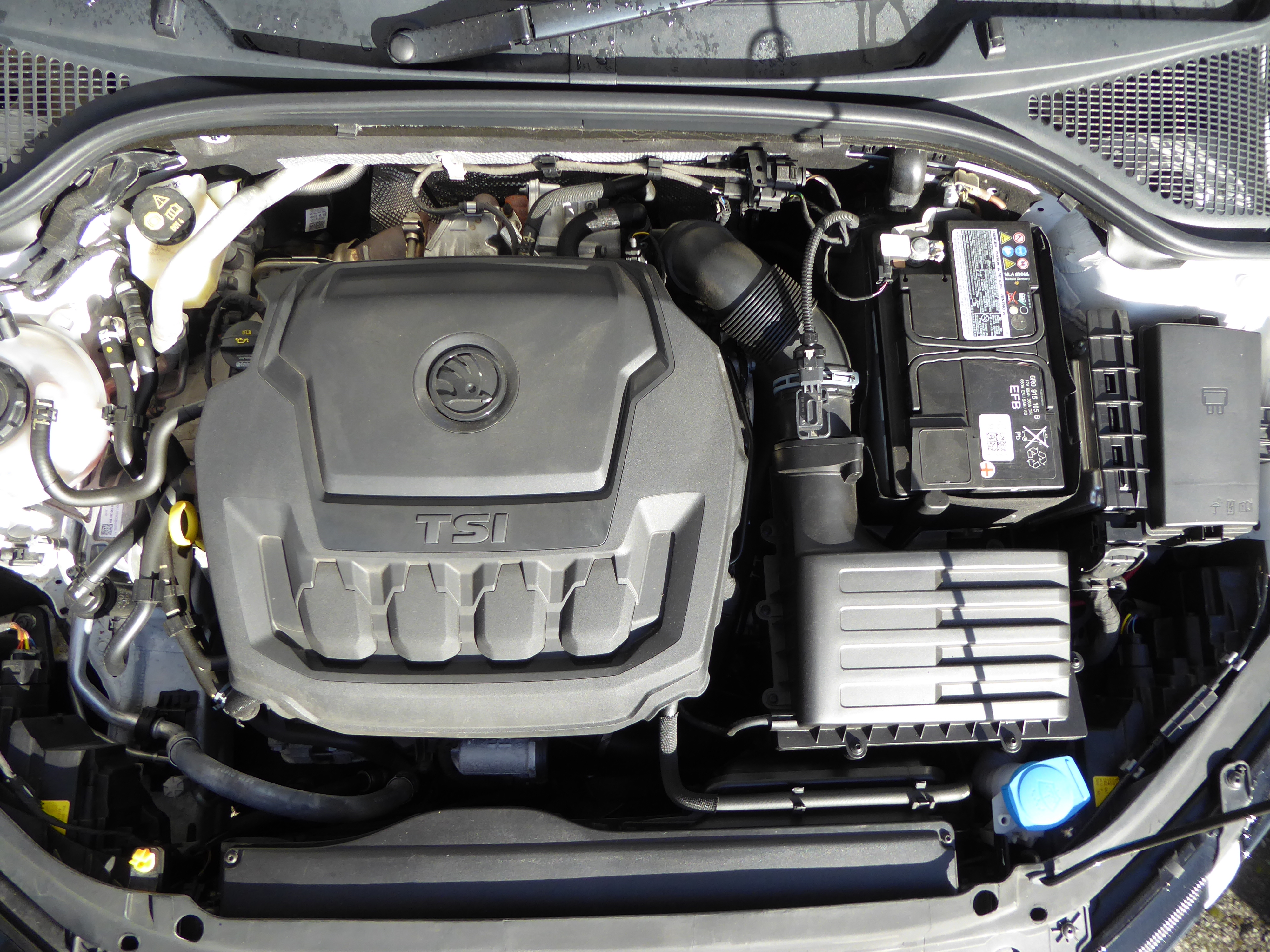

I bought a new-to-me Octavia estate from 2018, and noticed that one of the engine bay foam ends (not sure of the proper name) is missing. I think it's there to prevent debris from entering the engine bay, and as I live in the countryside I very much want it in place. I've attached a picture with an arrow to the one that is still seated.
Any idea what this part is called so that I can order a replacement? Many thanks

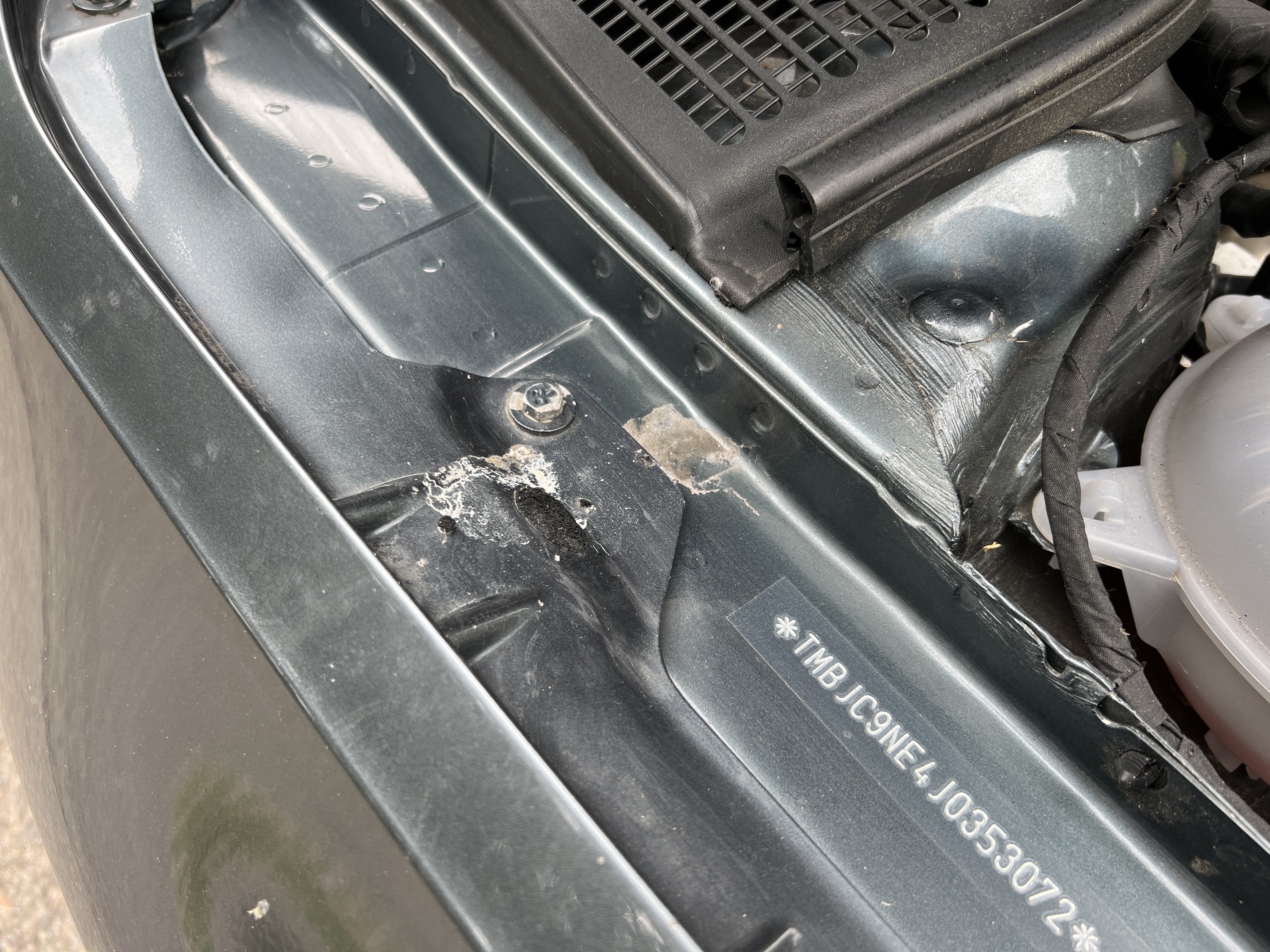

Is there any evidence of body repairs and paintwork on the side missing the seal?
No, I didn't realise that actually. Have attached a picture of the side of the missing seal where it looks like it's been ripped off

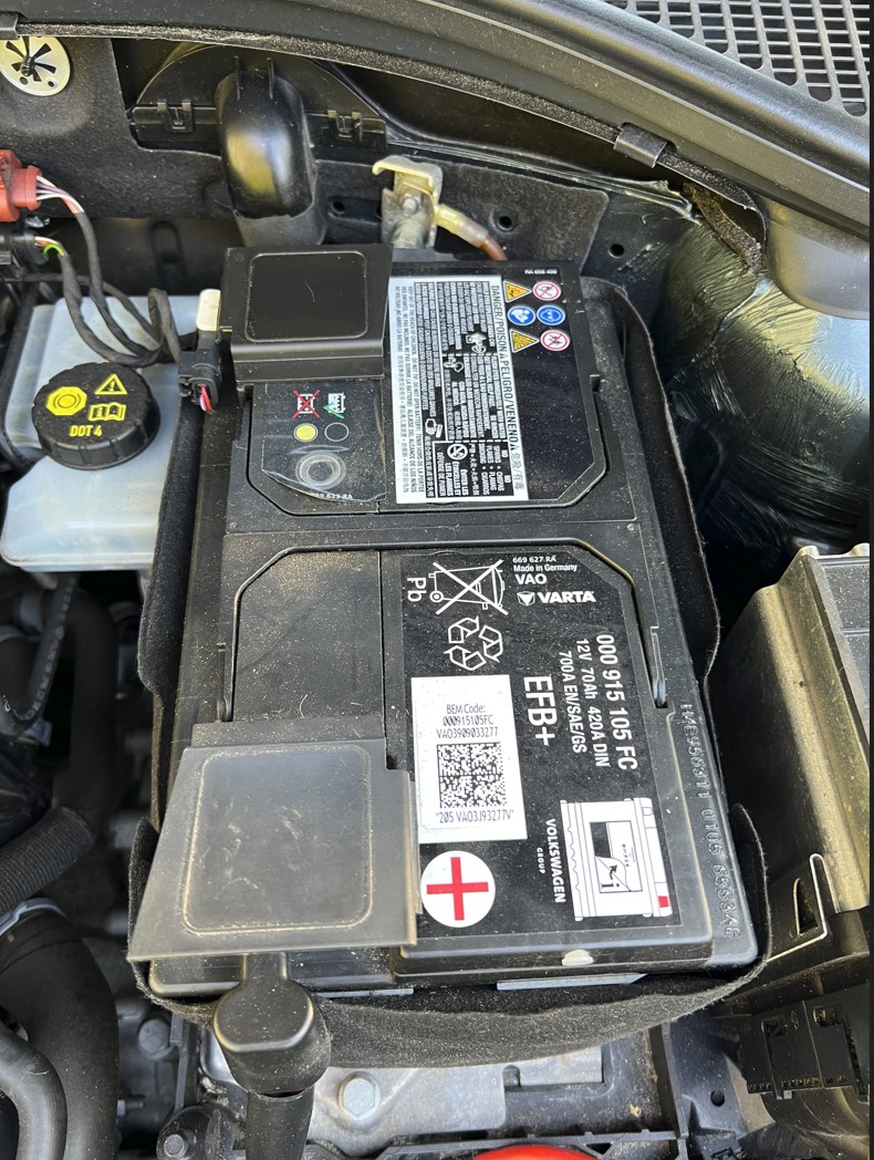

There should be a top cover for the battery as well.

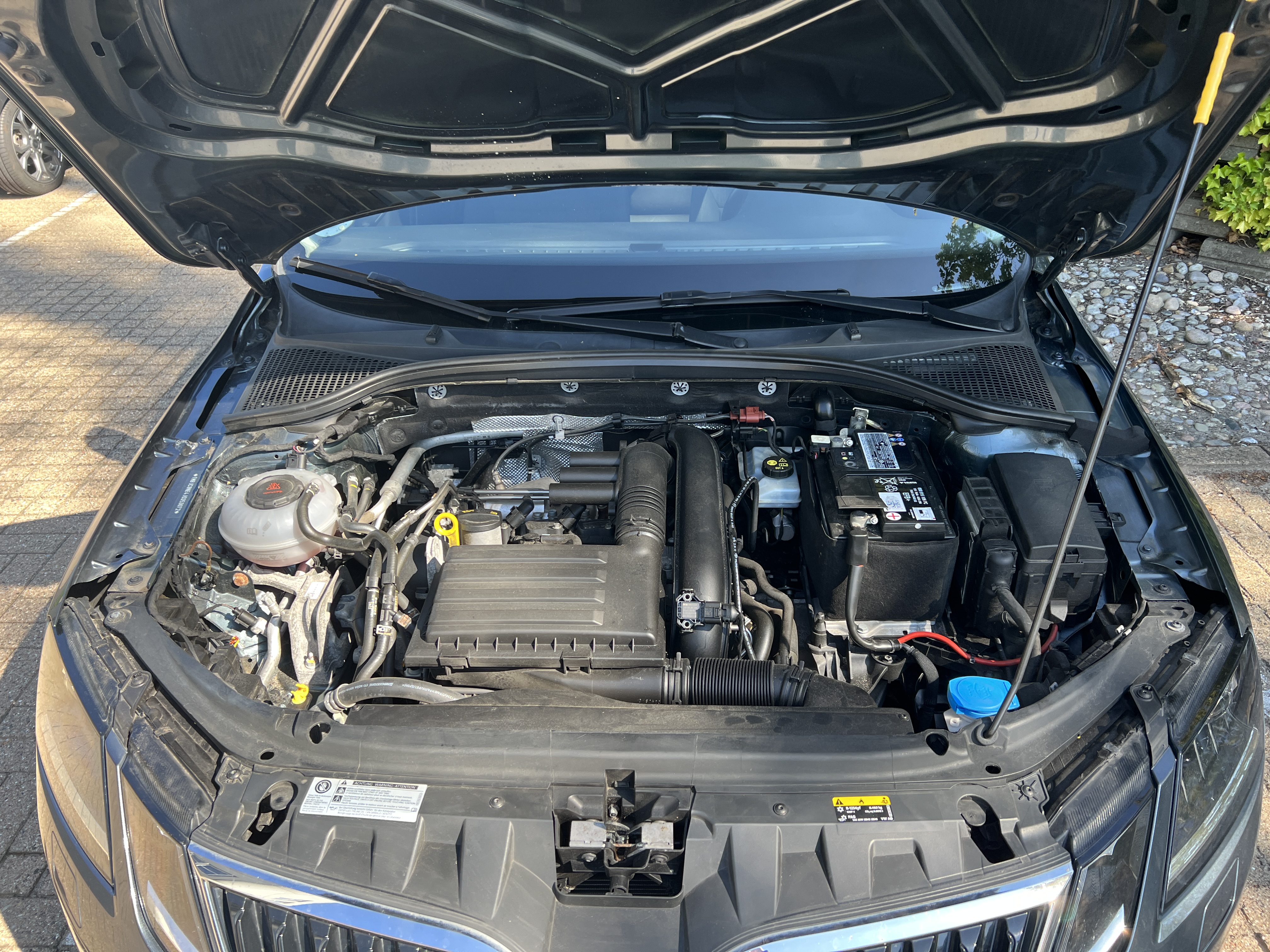

Good to know. Is it the top part only that's missing? Have attached a picture of the entire engine bay

From my understanding on the superb it is double sided taped down and the rest tucks just under the plenum chamber
Mine doesn't have this! Owned it from new.

Stopper Škoda 5E0823713 (skoda-parts.com)
Left and right is similar.
Or cut it from DIY shop foam.
Excellent, many thanks. Have ordered that plus a battery cover
Ok. mine has the same surround and a cover. some sort of flimsy material. Would it be just the diesels that have it?
Should be used also for petrol Octy.
No, petrols have it as well - both my previous 1.4TSI and my current 1.8TSI have them.

Plenty of options for battery casings...
Casing with upper cover is 5Q0915411E (cheap versions also on AliExpress).
Existing casing 2Q0915418C is without upper cover (just side parts).
I ended up ordering this one from AliExpress. It's not the same, but I'm guessing it's not an essential item

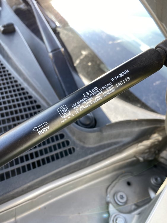

Krosno (Poland) gas struts. Cheap as hell, 5...10min job.IMG_9058.thumb.jpeg.5bf0323c1aabd7ec482b0b2b60b94aeb.jpeg
