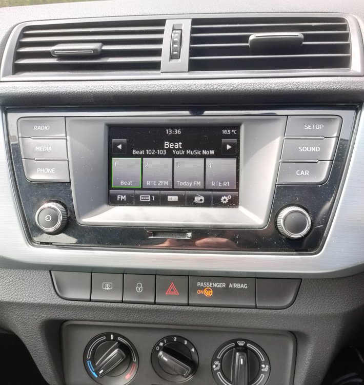

I got my first car 2 weeks ago, 2015 Fabia pretty sure it's pre week 22 as it hasn't got Mirror Link or Smart Link.
I've been looking up ways to get android auto on it and so far most of the companies I know that install carplay or android don't have a system for my car.
One does & is quoting me €450.
Before I do that, is there any options of doing it myself what system do I need to buy? Is it worth doing ect?
This is my current setup

Thanks for that, I'm going to look into it over next couple of days and see.
One thing I noticed, when I press media on my car, there's an Extras option on the touch screen, but it's greyed out, I can't press it. Any idea what that's about?
