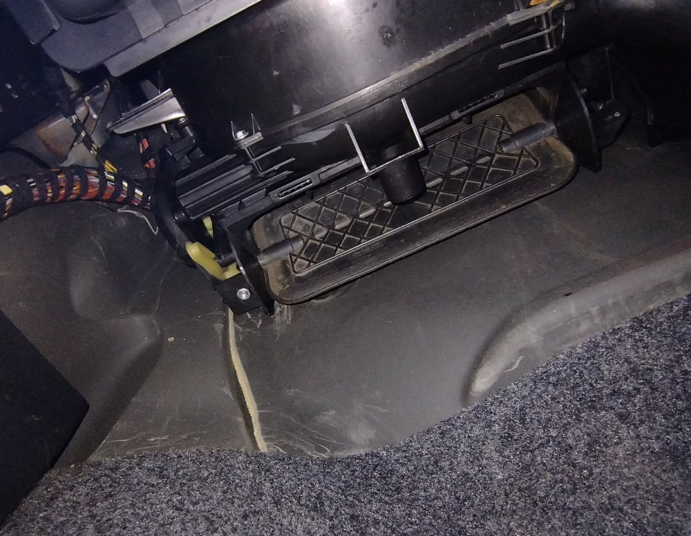

Step 4. Ignition on, turn on recirc, switch to Econ (no A/C). Check the recirc flap is open. This is the hatched flap in the pic below, under the housing in the top of the passenser footwell towards the door side
Locate the aircon bomb using best Heath Robinson skills so it points directly at the recir opening.
