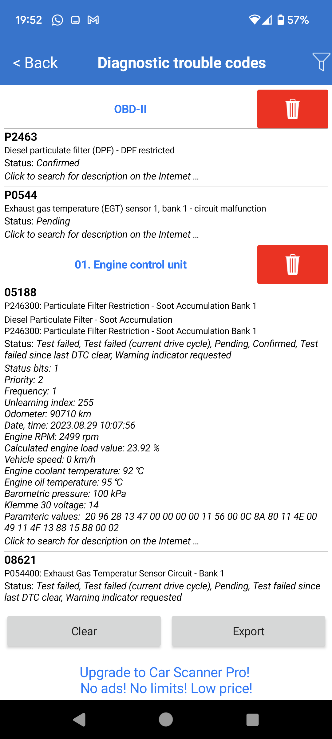

They insisted a long run was the right approach and they'd cleared error codes. Turns out they'd missed an exhaust temperature sensor fault that I showed them on my very basic OBDII reader.
They've fixed this today, put in some DPF cleaner and suggested again just a long run to regen. My reader is suggesting a calculated soot of 50g. I'm wondering if this is the right approach or whether I should take it somewhere to get it cleaned. It's also due an oil change/service (does around 8k a year) which I've read may be needed too for regeneration to work well.
So I guess, should I be driving this just for a long run? (They tried for a bit after the sensor but before the DPF cleaner and saw calc soot reduce to 50g and measured soot at around 2.5g). But the DPF light is still on. Or should I try and get it cleaned professionally, if so what should I be asking/looking for in a cleaner? I read that the Halfords one is a waste of time...

Clearing fault codes rarely fixes faults. What other ones were there?
Before the temperature sensor was replaced just these
