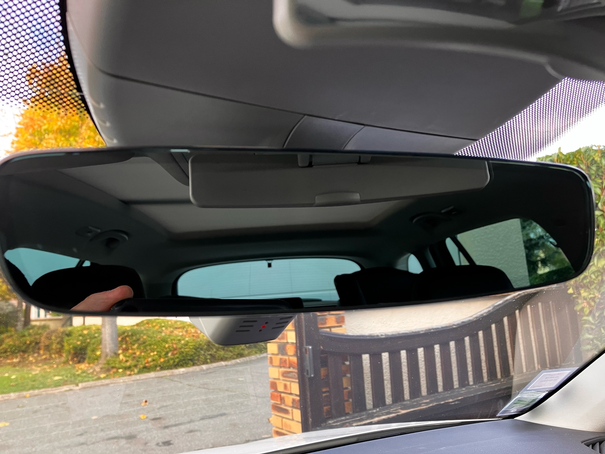

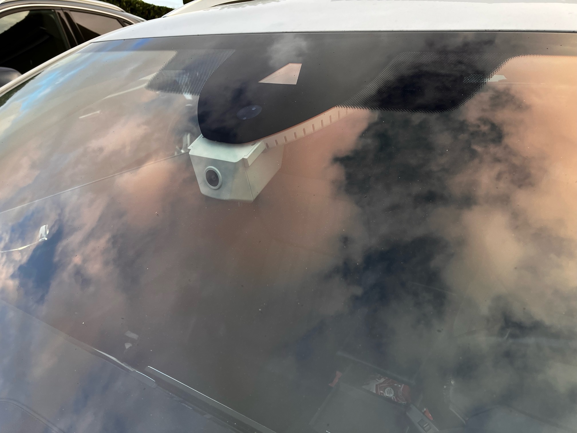

Some pics after installation:
Front cam:
... which doesn't come to low under the inner rearview mirror. Hence it doesn't hide what happens ahead. Rear cam is quite small at the top of the tailgate window...
But it's not well integrated, at least... not in an OEM spirit:
But I'm thinking about it to arrange that. ;)
