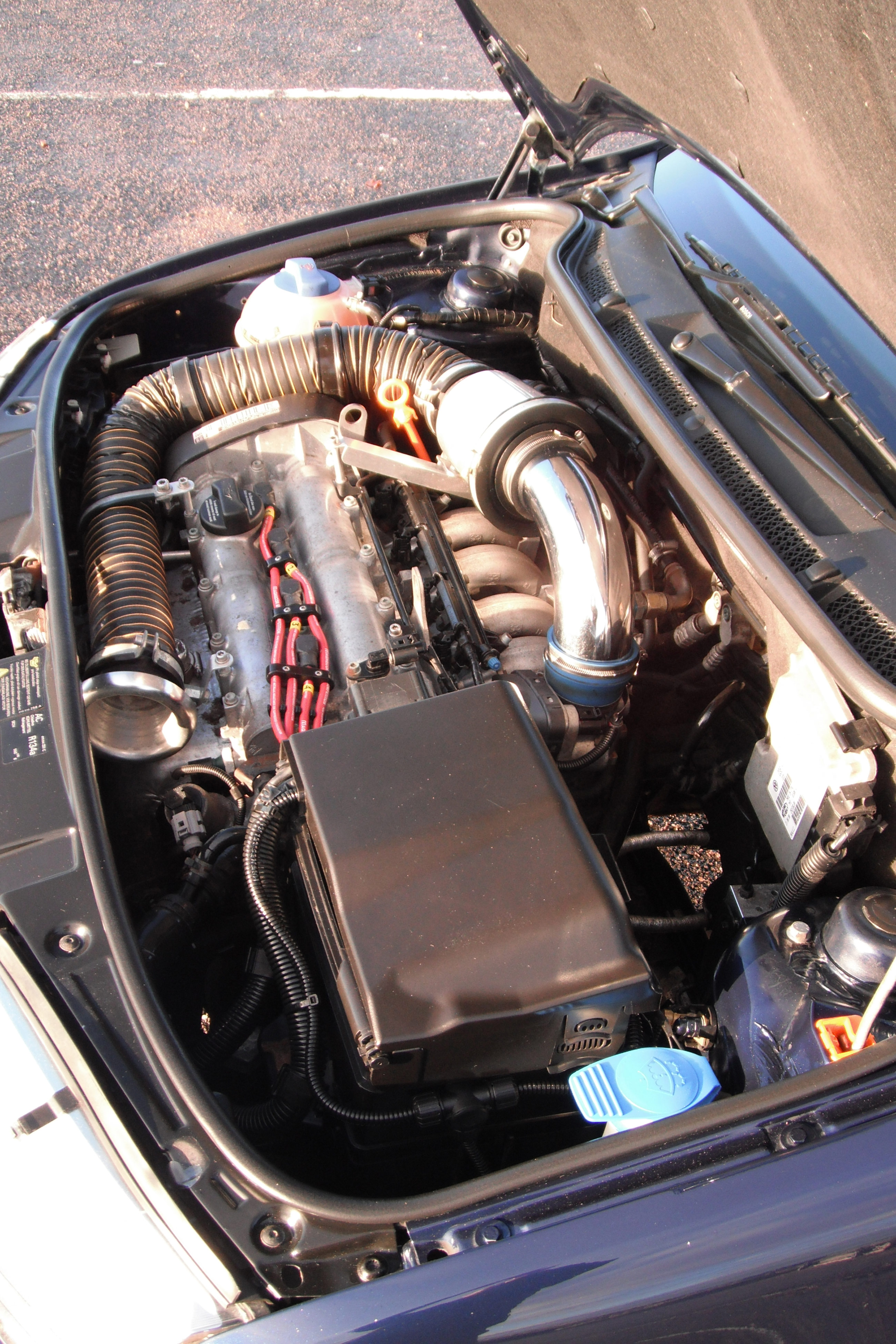

I had an AUB 16 100bhp Fabia...these were the engine mods I did:-
Mobil 1 engine oil
Millers Oils 75w - 90w Fully synthetic Motorsport gearbox oil
Magnacor Competition spec KV85 ignition leads
NGK “Iridium IX” spark plugs BKR6EIX-11 (3764) (a recommended upgrade by NGK for the original fitment NGK BKUR6ET-10)
Green Cotton Twister 75mm air filter based sealed cold air system
Remus S/S exhaust back box 2 x 92x78mm
B.M. full S/S 200 cell cat’ and front pipe
I had to later on remove the  200cell race CAT as the ECU kept throwing up "too lean" type codes. Basically the car was operating so well that it was producing very little emissions & the ECU was not seeing enough "scrub" of the emissions between the two Lambda sensors...& to "tell" the ECU that these result were acceptable would have required what was known as a custom "stage 2" (similar to the ABT one) re-write/flash...costing £££££ ......plus a trip down south to a specialist for the car...so I gave up on that & simply removed the race CAT!!!....
My old Fabia AUB engine which had about 120bhp...:-
