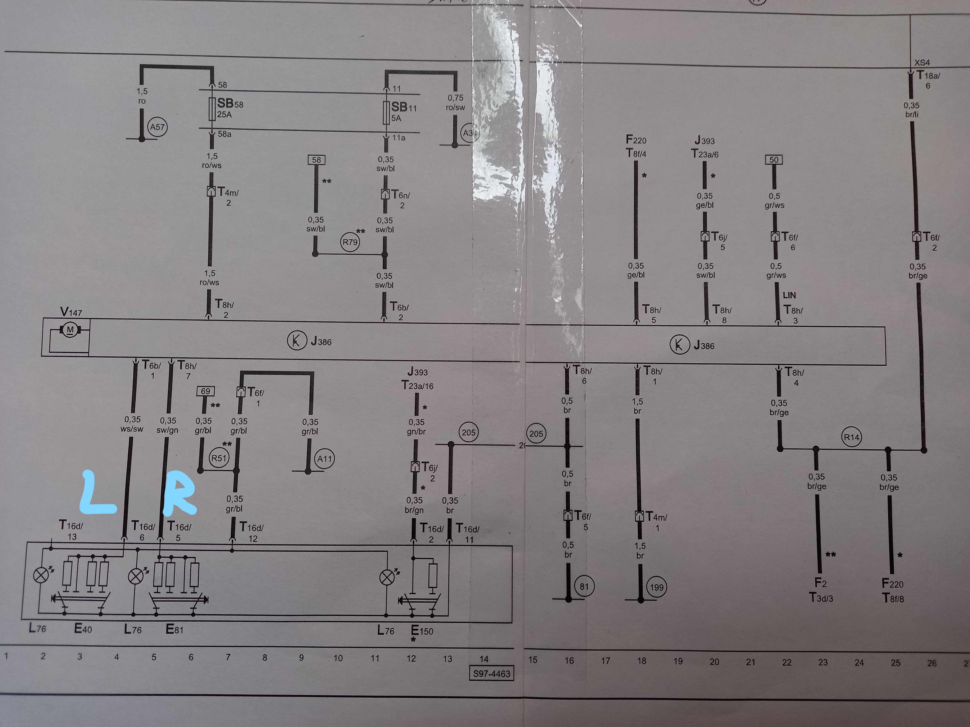

There's just one wire that connects driver's side and passenger side window motors on the facelift cars. A LIN bus data connection which is grey/white all the way, within each door loom, and from one side of car to the other in the cabin loom to each A-pillar connector.
Here's the driver's side wiring, showing the permanent and ignition switched 12V feeds which would be good to measure at the motor connectors, both relative to the main thick brown earth wire.
Thank you, I will look into this when I can. Might see if its possible to order some new switches also as a failsafe.
