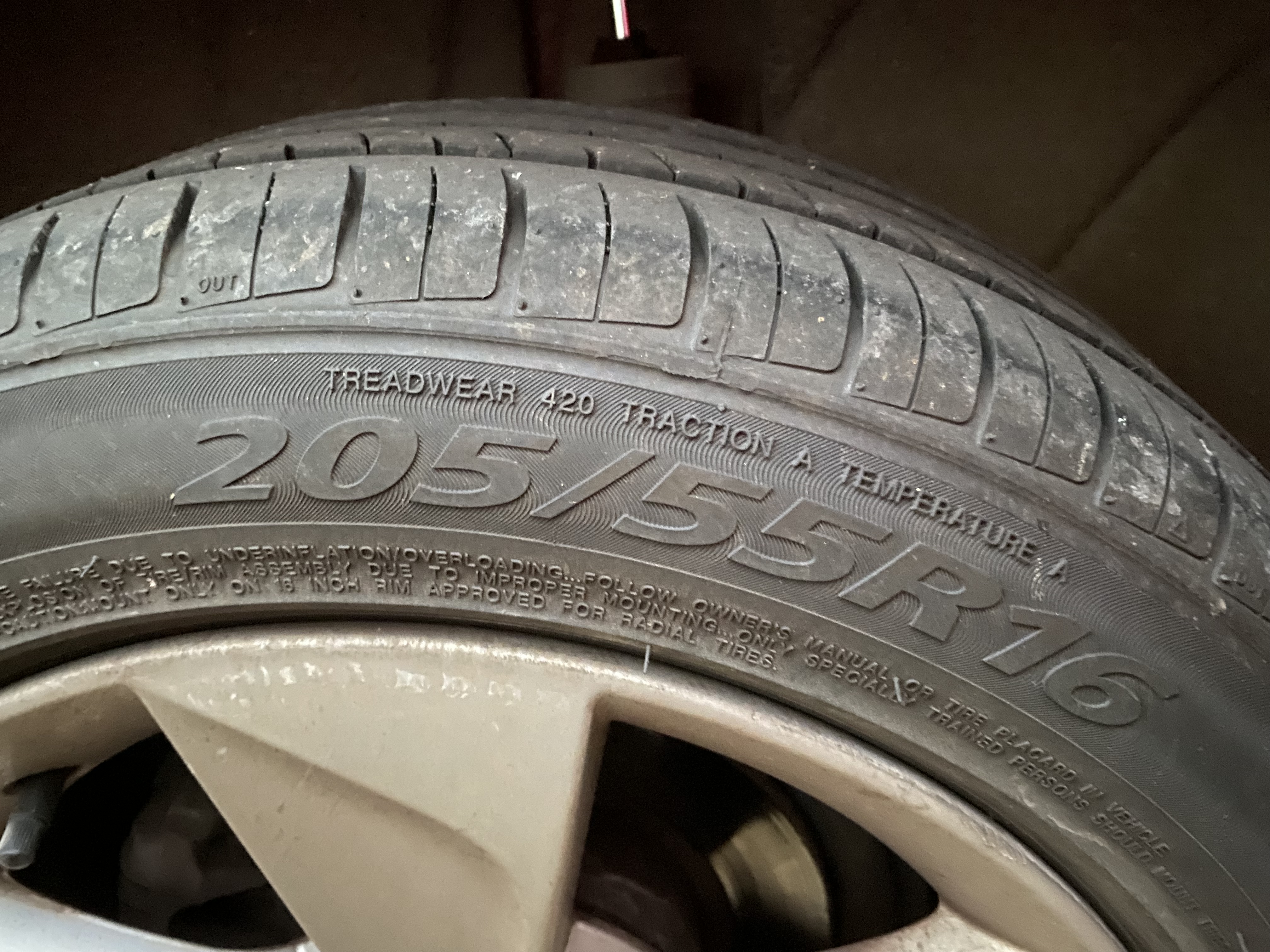

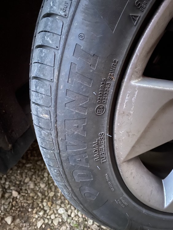

I took photos of the type of tyre and size that is currently fitted. Each time it was a puncture to the rear tyre, one was just 6 weeks after the last puncture so resulted in a puncture in a brand new tyre 🙈
Each time it was damage to the side wall, usually inner side wall, by a stone. Once it was a nail, the type used to shoe horses, but this was in the tread and was repaired.

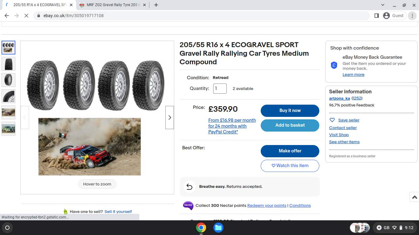

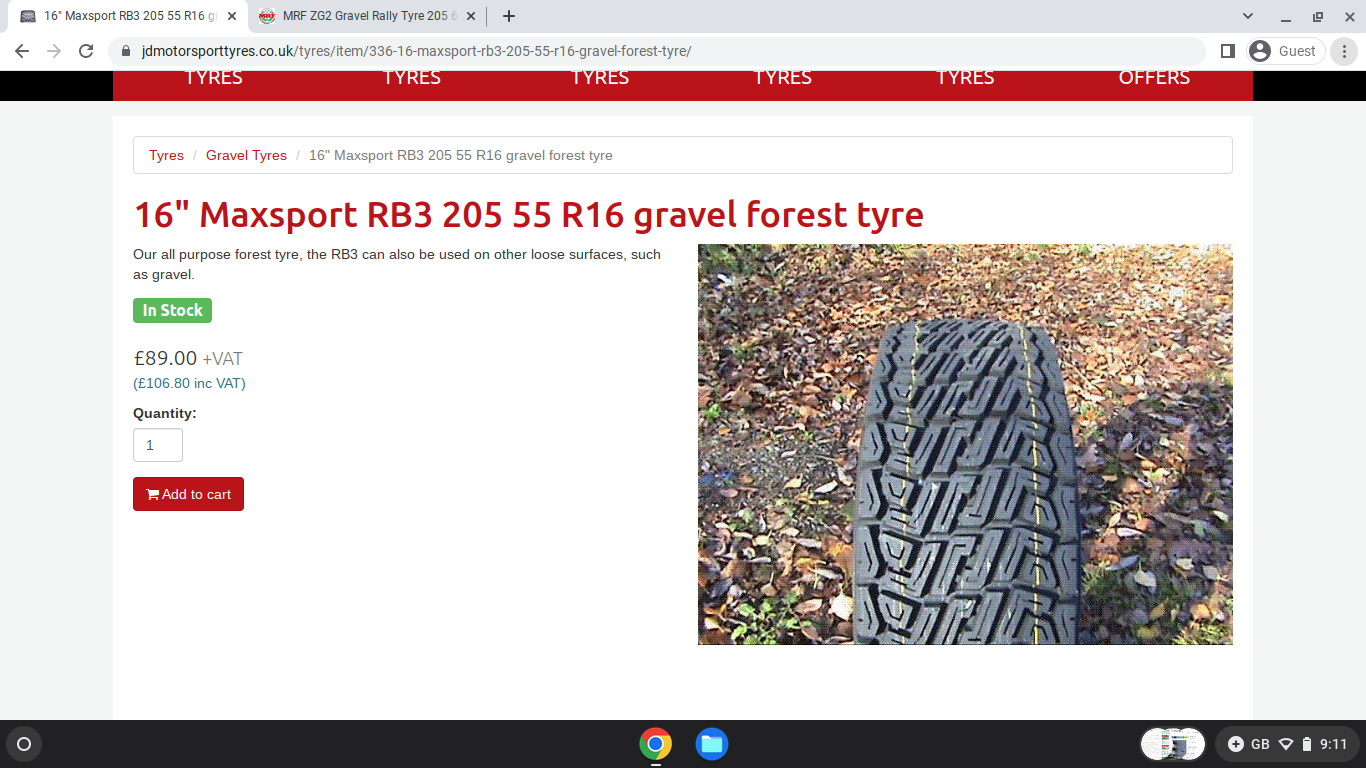

@Carlstonis the one to tell you the strongest sidewalls.
Maybe Gravel Stage Rally Tyres which are not that expensive.
Or something from BF Goodrich,  or the Geolanders,
I have used all of them at some point on different vehicles.

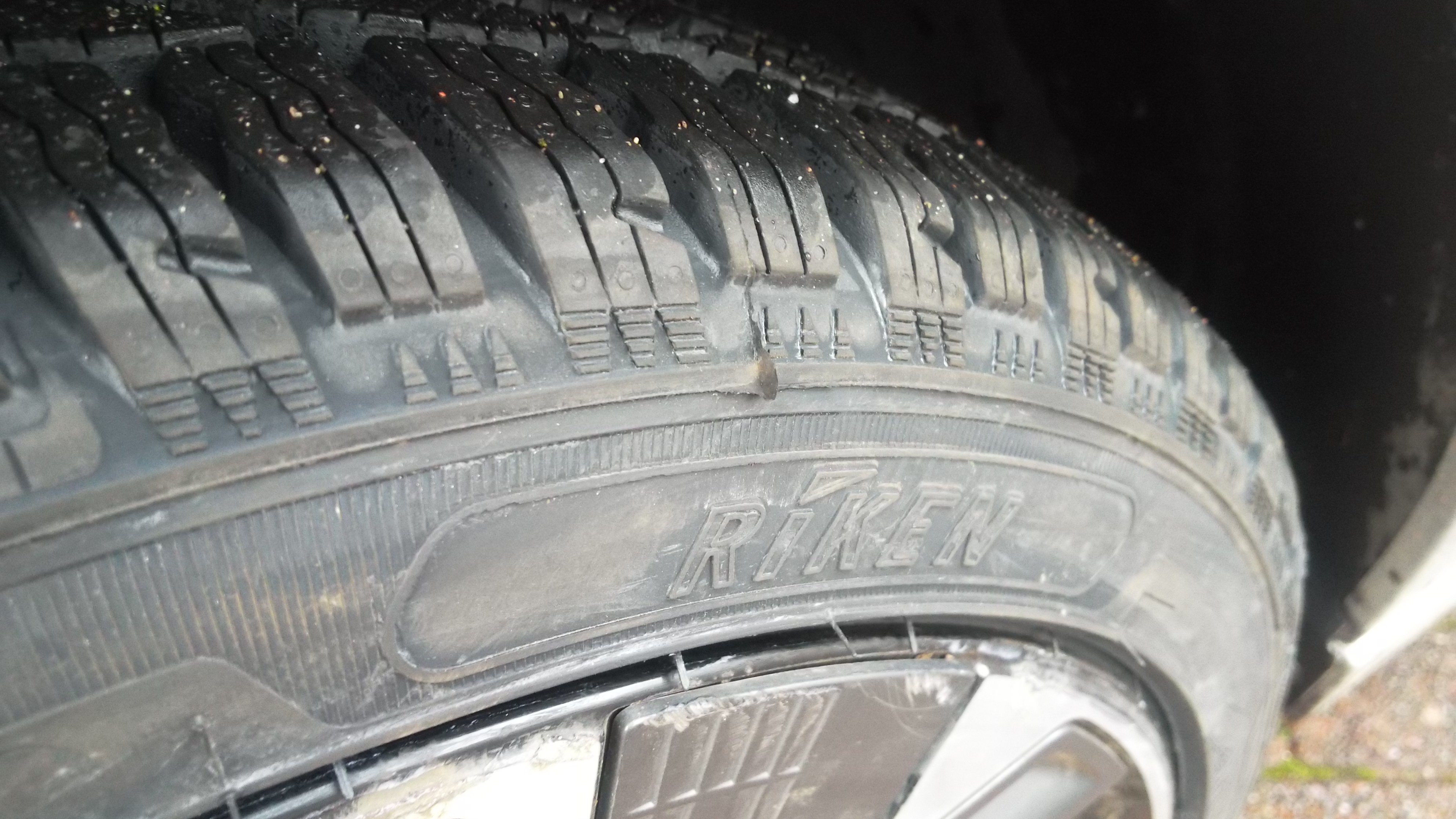

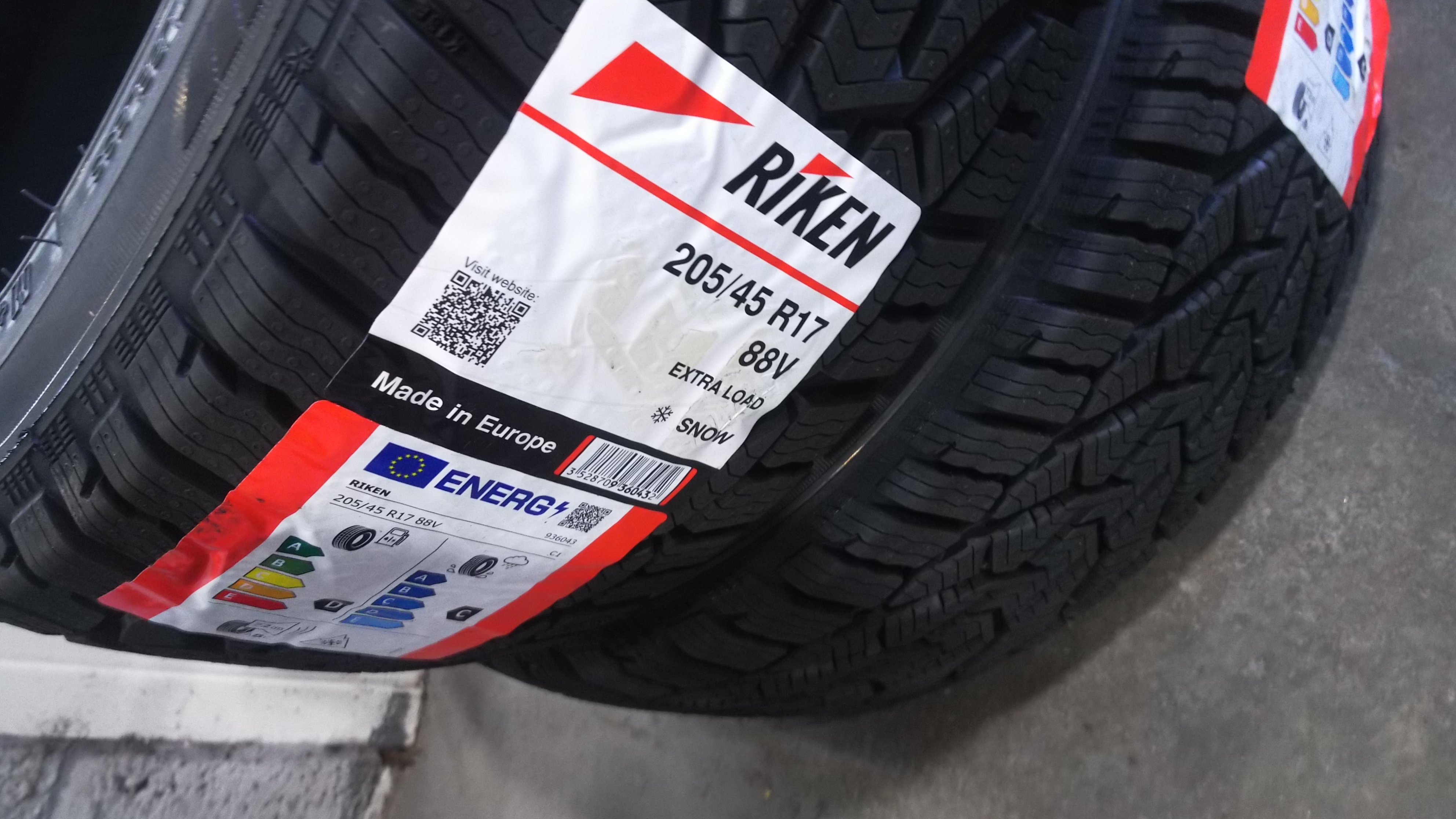

I had the Riken Snow tyre on my Electric Corsa (Low profile) through this summer having wrecked sidewalls on Michelin Alpin 6, they were fine and used on some tracks with sharp stones etc.
DSCN2038.JPG.9ee37824f8120a191c65f9f1a26e8535.jpeg.b15d3f97156755907e69c68bf86c8f67.jpeg
DSCN2048.JPG.6b4a756cf8966500e08138d2a2f130cf.jpeg.92f9280187b95e17bbbaaf0d943f5e2a.jpeg

I can see from your photos that you have 205/55R16 tyres fitted to 7Jx16 ET45 5/112 57.1 alloy rims.

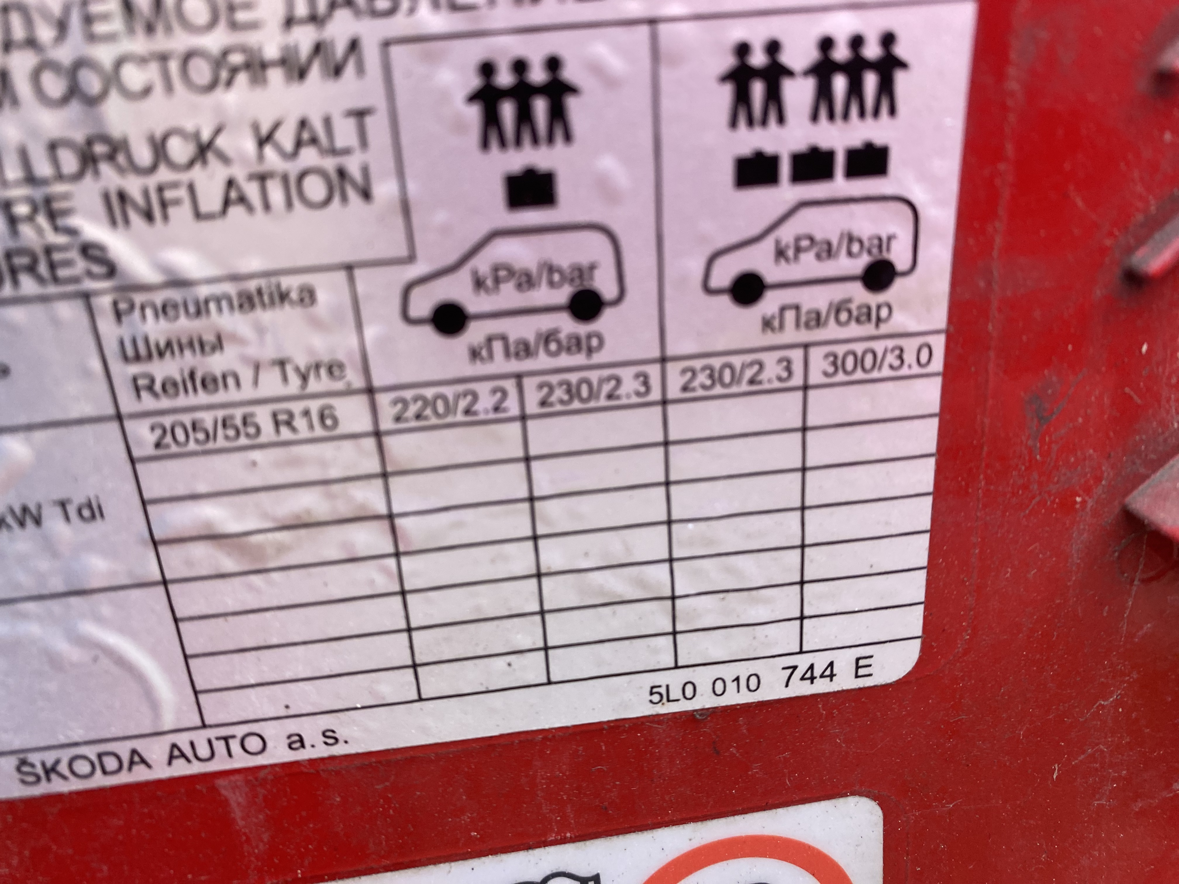

I have looked at the fuel flap again and it does have the tyre size on it, photo attached. I am guessing the low side wall tyres are all part of the greenline being lower to the ground than the ordinary yeti to improve efficiency and fuel consumption?
Yes, the 205/55R16 helps to improve efficiency and fuel consumption by lowering the ride height. However, how you drive the car makes a much bigger difference than the relatively small difference 205/55R16 tyres make on the Yeti.
One Yeti owner compared the 205/55R16 and 215/60R16 and found the ride much improved with the 215/60R16.
