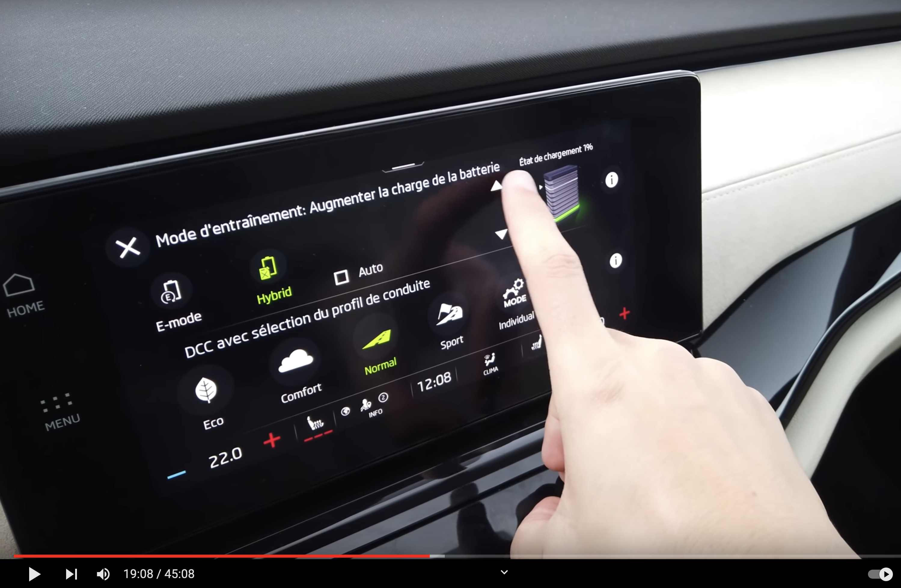

I didn't know too much about the hybrid system on Octavia, but it's the same one that I now have on the Formentor - it's the one VAG uses across several brands and models.
Long story-short, this PHEV IS ABLE to charge itself. I had to search the web for a while and find a video for Octavia (to make sure I'm not wrong correcting you guys), but there it is:
Sorry for the French, it's the first I could find...
At minute 19:05 you'll find the setting in the infotainment that allows the user to set the car to charge the battery to a certain percentage when needed.
Assuming you're on a long highway trip and you depleted your battery on the first part of your journey, but there's a town ahead of you that you want to cross in EV mode, this setting will allow you to either preserve a certain battery level, or to charge it to the desired level using the ICE if the battery is too low.
Thank you for setting me right on this. 👍

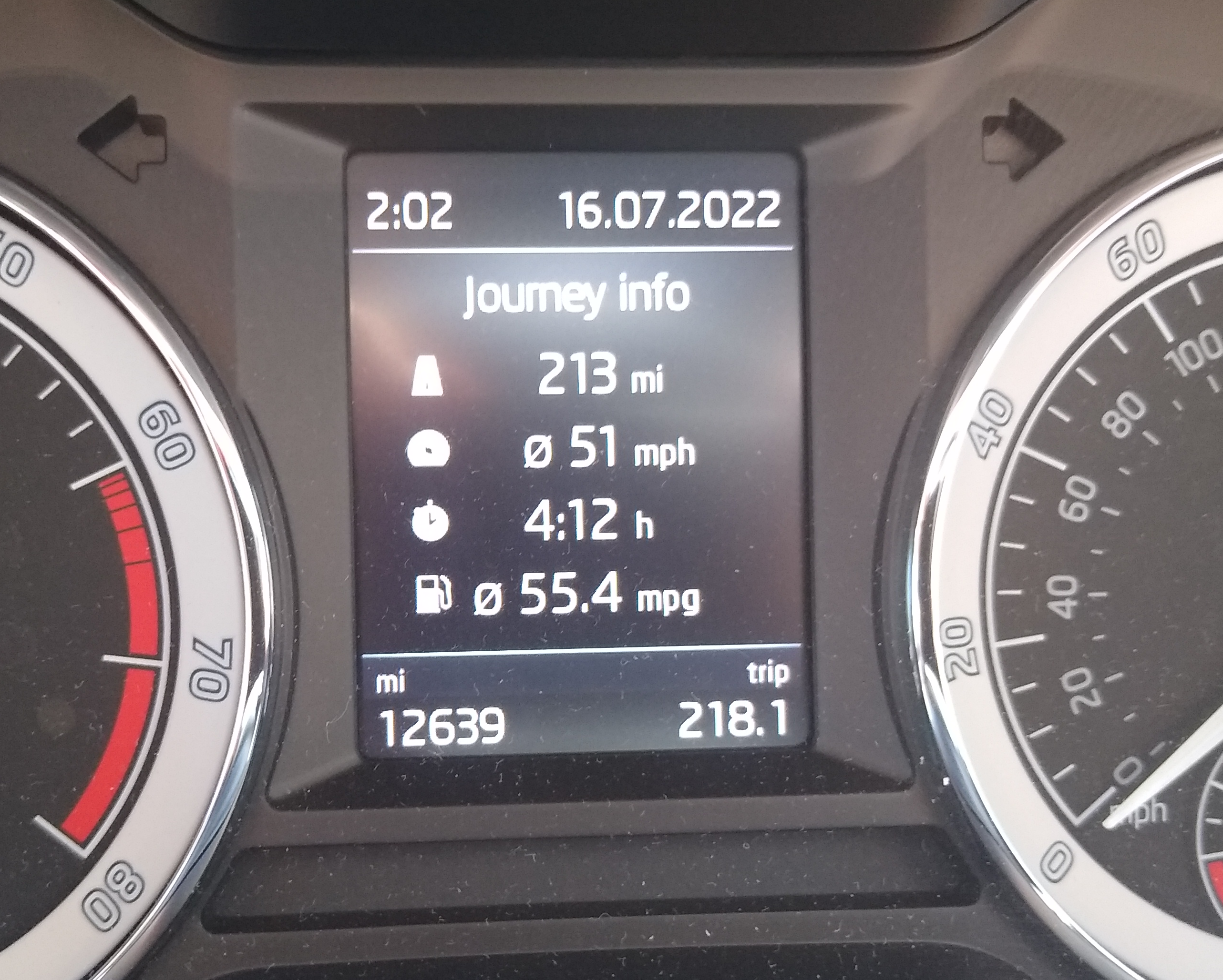

I disagree. Once the car is rolling, it doesn't take much fuel to keep it going. I believe 50MPG is perfectly doable on a run for the 1.4TSI, even lugging the PHEV gear around, which is a bit over 1600Kg including the car AFAIK.
I can get 55MPG in my 2.0TSI fully laden on my holiday trip, which can't be much different weight wise, with us two over 6' plus all our camping gear.
Unless there are a load of other efficiency losses associated with the PHEV side of things on the PHEV Octavias.
That's a nonsense reply. I was doing a lot of city driving in Edinburgh that day and some motorway when I got 49mpg.

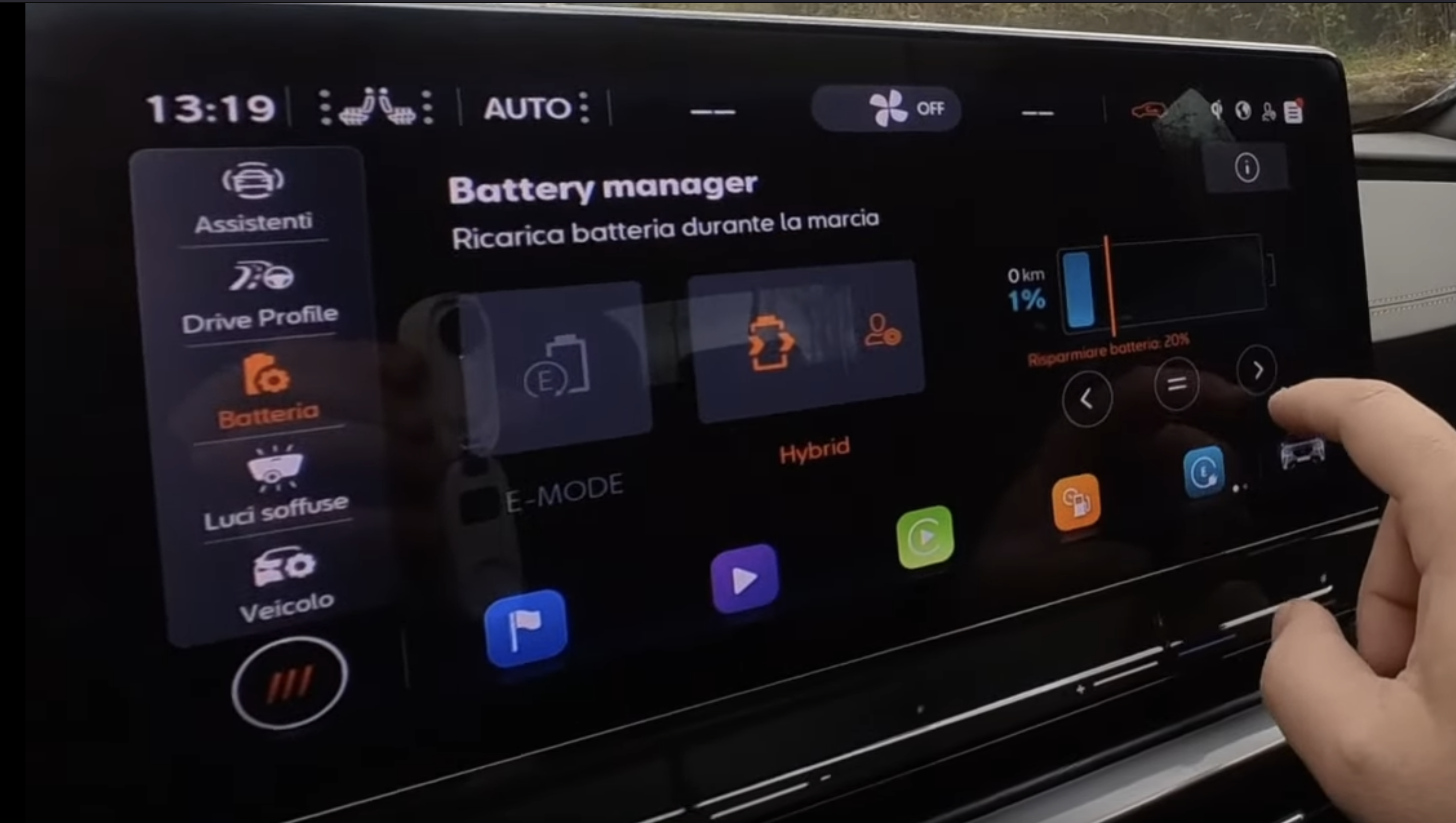

On the Formentor I had the opportunity to play just a bit with the battery options:
To keep the charge at a certain level - there's no problem, even if I decided to drive a bit sportier. It will give the electric boost anytime I need it and it will recharge quite fast via ICE.
Once I tested the charge while driving option; I was down to about 15%, on the highway returning to the city and asked the system to charge to (maybe) 30% - it's hard to say, 'cause the CUPRA menu is different to the Skoda one, so all I can see are level bars instead of percentage. In about 20 km on the highway it got to about 25% - enough for me to cross the city in EV mode. But that was just to test the way it works, otherwise I'm able to charge daily, and for the really long trips I'm reserving some battery percentage from the start of the trip. Too  bad you have to remember to set again the battery reserve if you have a stop along your trip... it would be nice if it would remember that setting for short stops. The same way a short stop will not reset your current trip mileage for example.
I don't have a picture of that menu on Cupra, but I found something online; if you press the "=" symbol the system will preserve the current charge level...

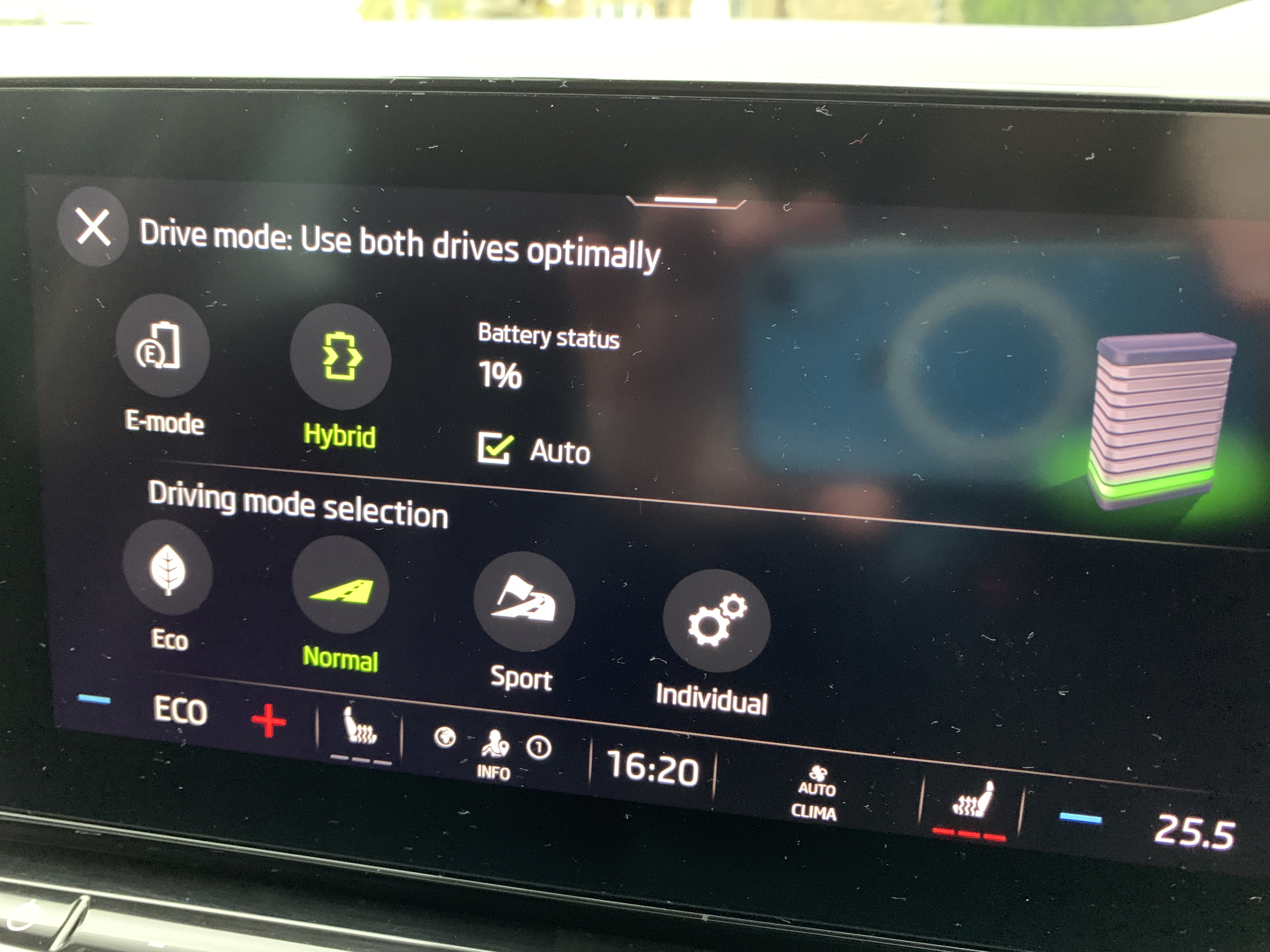

You can get it to save a certain percentage of charge. Deselect auto and you can go up and down on how much percent to keep.
if I’m going on a hundred mile round trip I’ll get it to save 50% for the way back.
