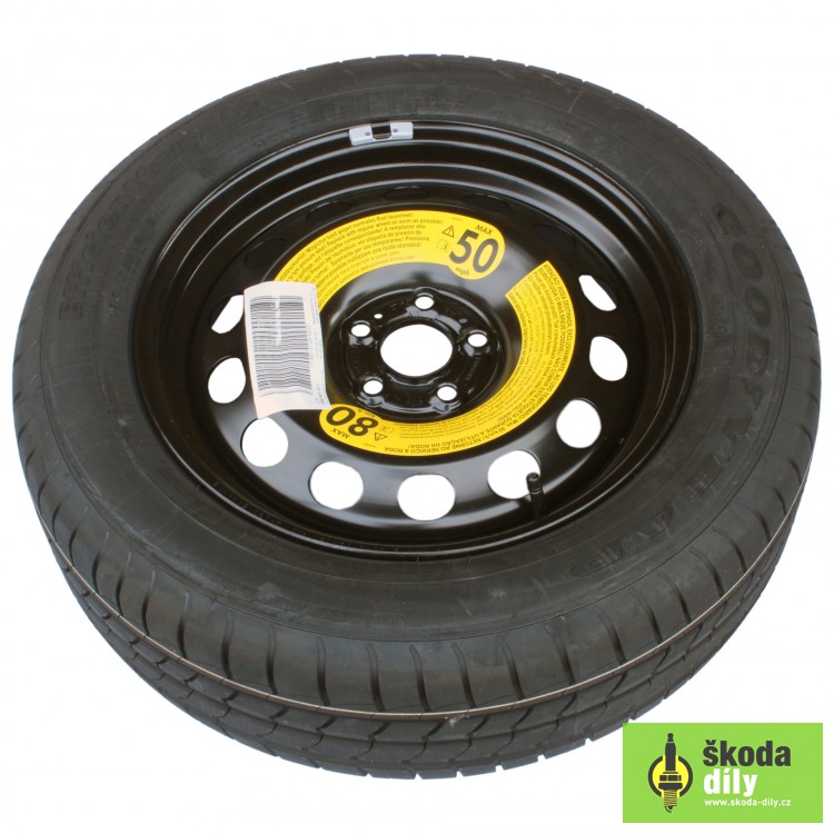

Trying to find the ''correct'' wheel for this car is a pain....  The one the dealer's are quoting on is part number 65860101. It's not a full size wheel but it's not classed as a space saver either.  Only want it to stick in the boot as a spare.., Don't trust the tyre sealer stuff that is supplied with the car.
I think you mean 658601011 rather than 65860101, ie. with nine digits...as shown in the photo and link below.
On the Kamiq, 195/60R16 6Jx16 ET35 5/100 57.1 is a winter tyre and rim specification although Skoda dealers are also supplying this size as a spare wheel for the Kamiq. This is an economy measure so that the same spare wheel can be used for both the Kamiq and the Scala. If Skoda had chosen a 205/60R16 spare wheel for the Kamiq they wouldn't also be able to sell it for the Scala...because the Scala uses smaller outside diameter tyres than the Kamiq.
If a 205/60R16 fits in the spare wheel well it might be better to use that size. Skoda has a habit of supplying undersize spare wheels, most notably the 205/55R16 6.5Jx16 ET46 5/112 57.1 from the Octavia MK3 that they supply as a spare wheel for the Superb MK3...even though 205/55R16 has an outside diameter 4.9% smaller than the standard 215/60R16 tyre size on the Superb MK3.
195/60R16 tyre fitted to 6Jx16 ET35 5/100 57.1 steel rim 658601011
https://www.skoda-parts.com/spare-part/658601011-spare-wheel-skoda-37007.html
