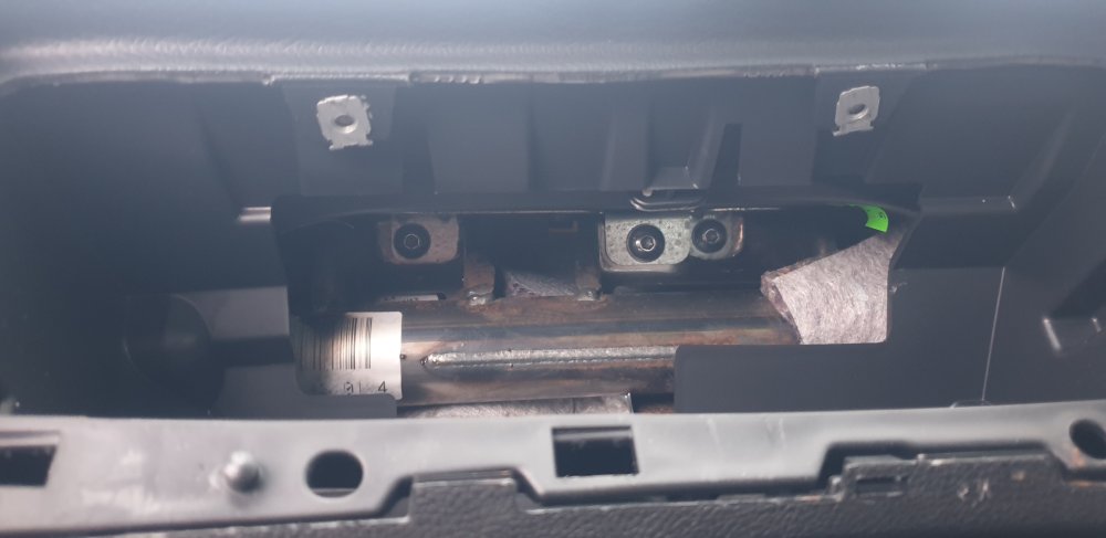

My Roomster model has the double glove compartment. There is NO passenger airbag disarming keyswitch.
I have managed to remove the upper compartment and I can see the three screws that hold the passenger airbag. (I didn't have long enough Torx keys/allen keys to go further and attempt removing the airbag at the time!)
My queries are, before I 'go for it'...
1 Should I have to disconnect the battery before I start (and if so, will I lose the radio/code)?
2 I've read that there are clips on the airbag to be 'popped' before pushing the airbag up onto the dashboard.? Where are these located (Picture attached). Do you push/pop/slide these clips?... and does the airbag need prised out or lifted out in a particular way?
The airbag sitting above and behind where those three screws are?
3 Will there be enough length on any cables attached to the airbag and plenty of room to get to the resistor bank?
4 How sensitive do you have to be when handling the airbag?
