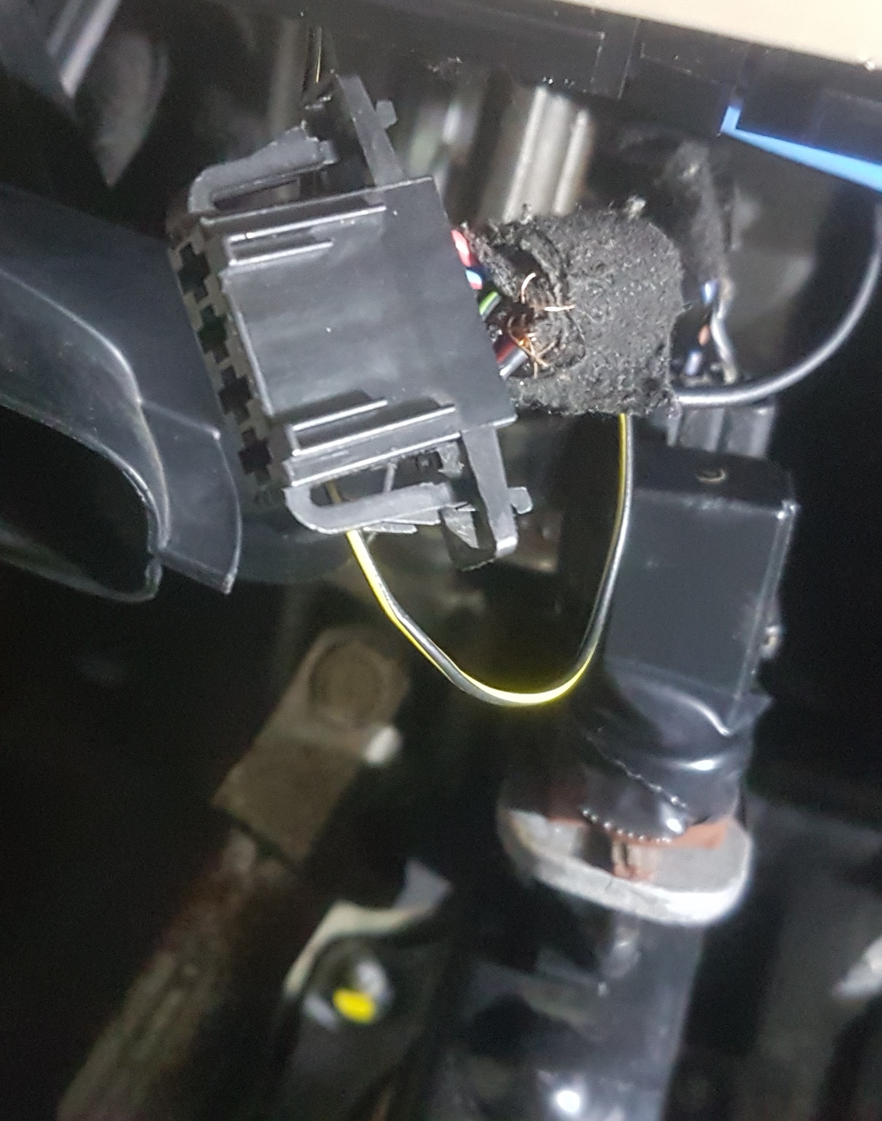

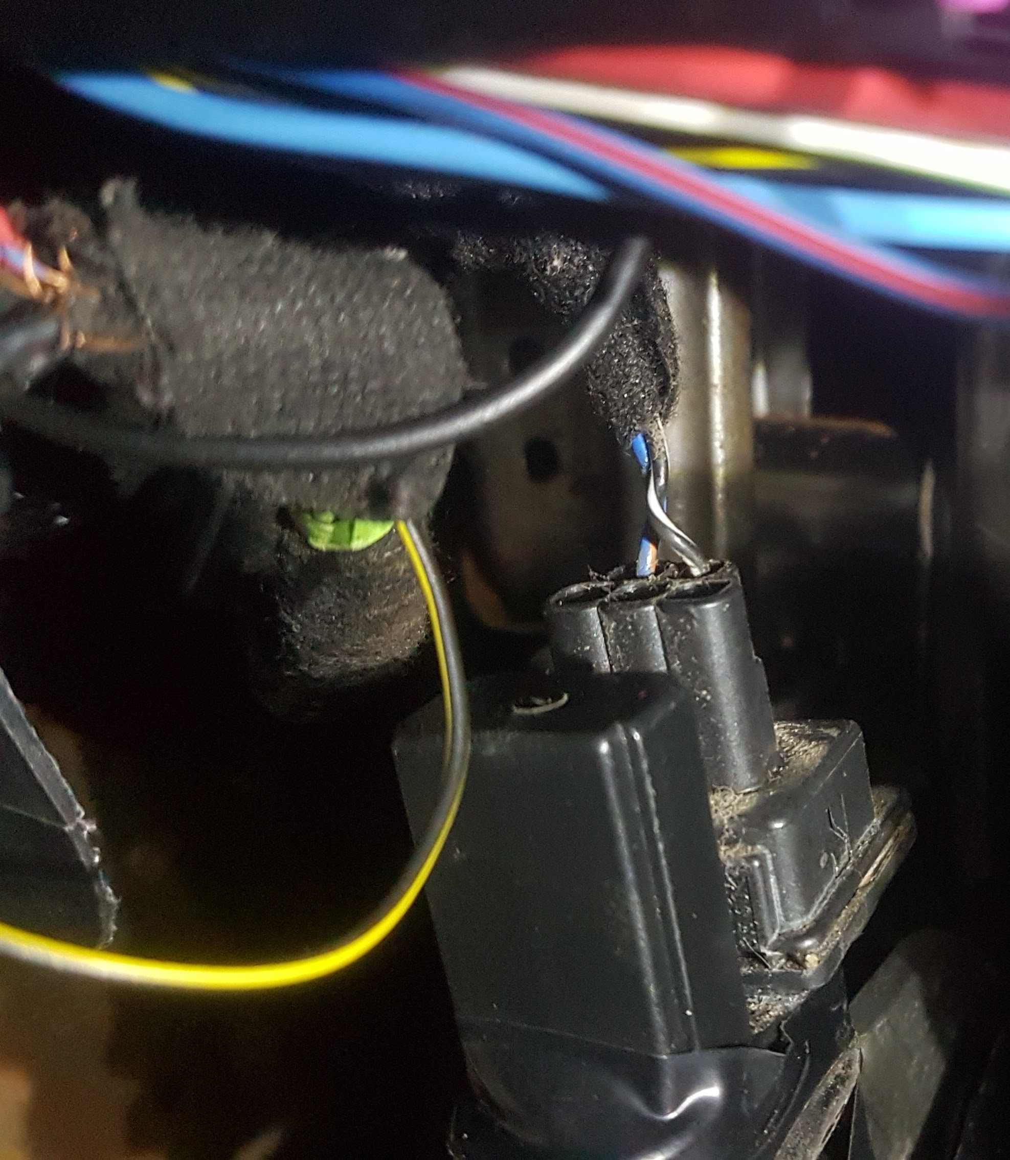

On closer examination, my Roomster brake pedal switch has been relpaced with an obviously "wrong" part. The wrong switch in question has only two terminals, spliced into two wires on the original 4 terminal connector. Could anyone tell me the original part number for a pukka brake pedal switch, and maybe point my to an idiot's guide to fitting it.

In it's present condition that unidentified switch pictured previously at least operates the brake lights. As for the reversing lights, I've jury rigged a toggle switch and lamp so I can temporarily get by with that!

Fit that brake light switch.

Fuse 21 (10A) feeds the brake light switch (NO) for the lamps, on a red/black wire, pin 1 of connector at switch. Feed to bulbs is the black/red on pin 4.
This black/red from the downstream side of the NO switch also connects to inputs of ABS module and engine ECU.
Fuse 32 (5A) feeds the brake pedal switch (NC), for the engine ECU's info on 'pedal-pressed', on a thinner blue/red wire at pin 2. Connection to engine ECU is via the black/green wire on pin 3.
NO = Normally Open (no connection when foot off pedal)
NC = Normally Closed (always connected except when pedal is pressed)
