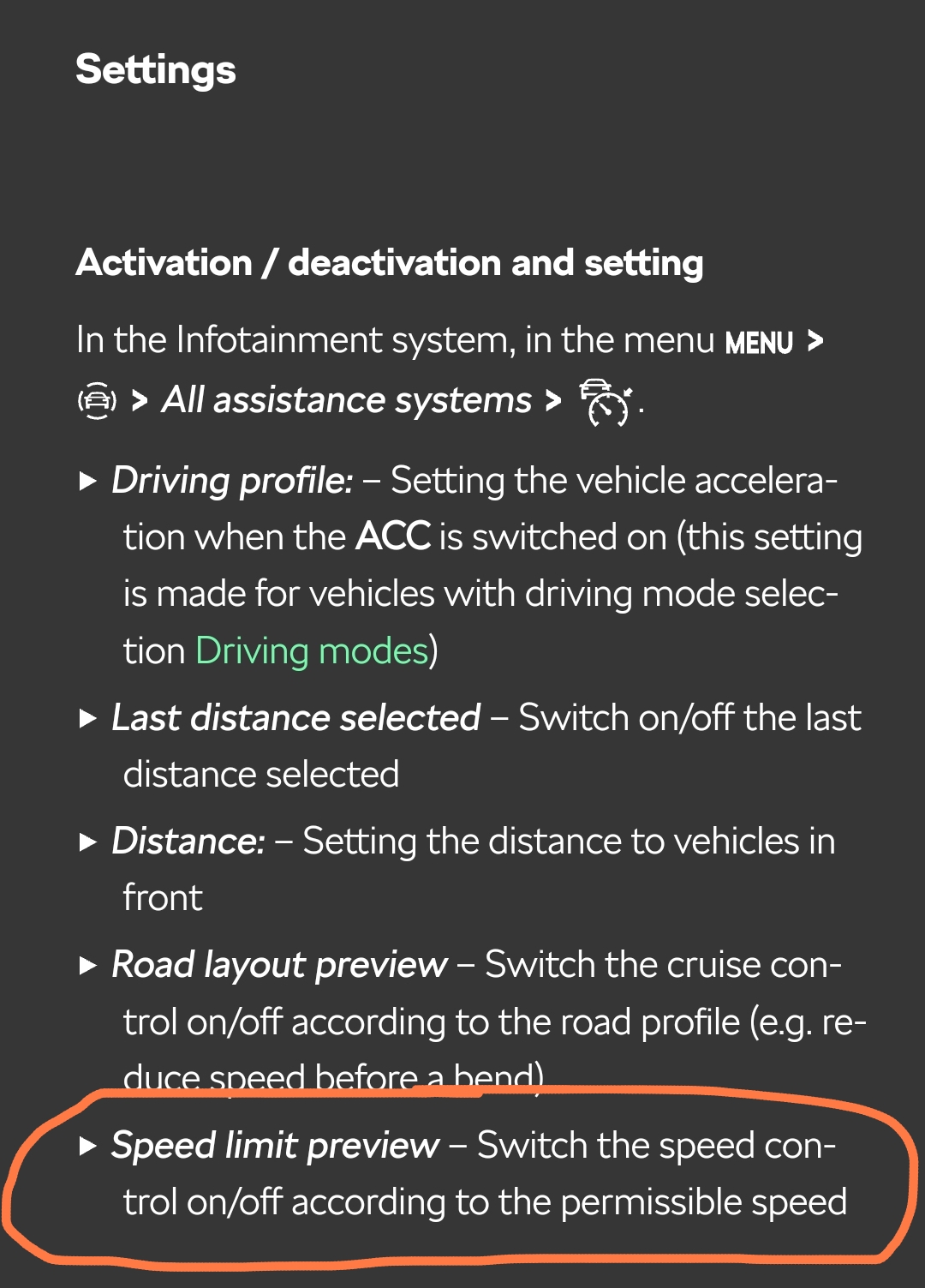

Maybe I am being thick but I cannot find speed control anywhere.... Give us a clue
It's in the manual... Ideally you should disable both the road and speed previews to get rid of annoying behaviour.
Screenshot_2023-11-25-11-24-09-140_com.android.chrome-edit.thumb.jpg.84a7140e165513f25e70c742c7b53e90.jpg
Thanks mate, I will take a look later today....
Sorted thank you, now the car does what I want.. Cheers..
