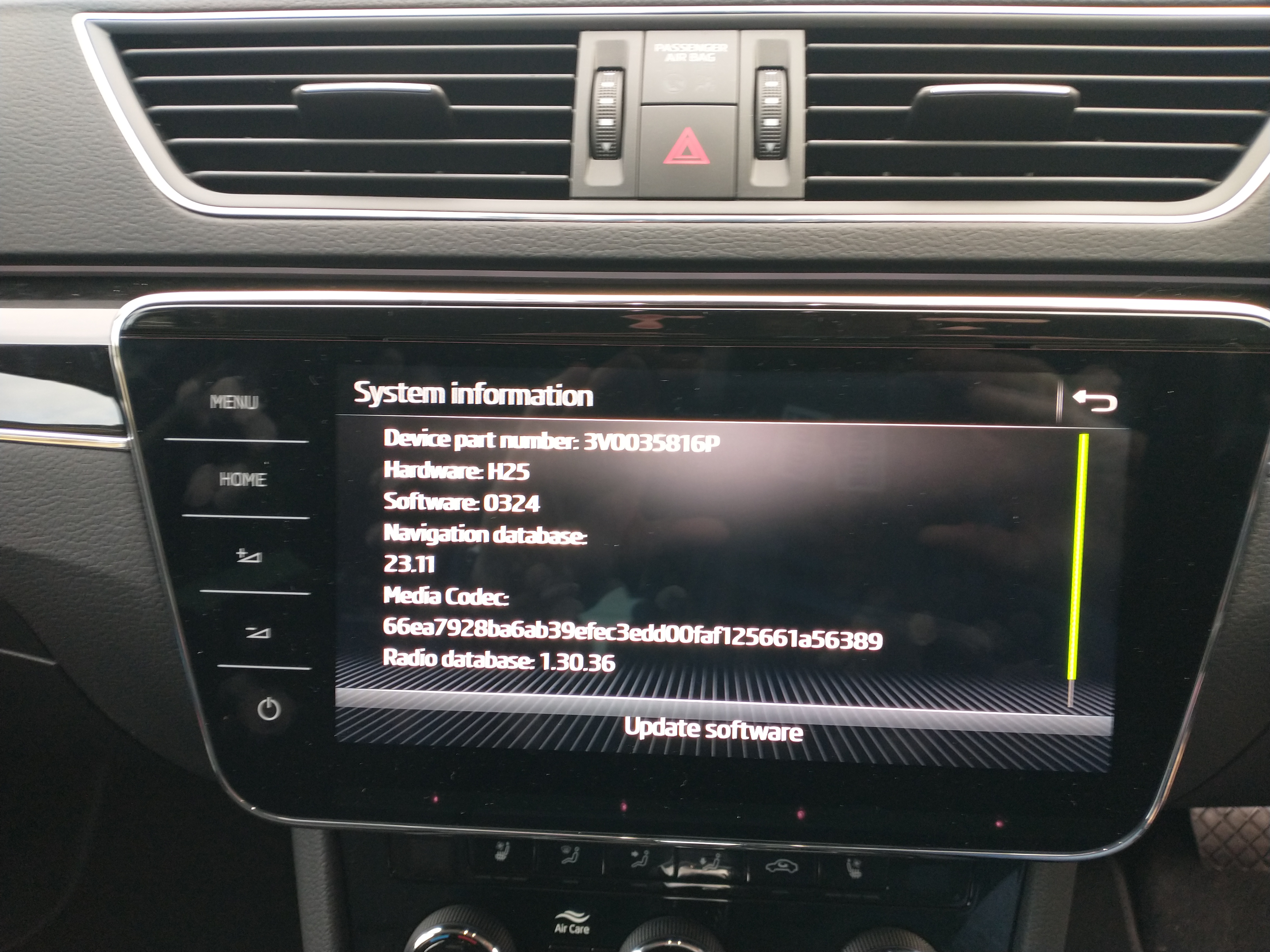

I am sure this is an mib2.5?
@superbrex
By Nav db title it looks like Mib3
Yes, I'm sure.
On the surface, MIB2.5 and MIB3 screens look the same.
MIB2 and MIB2.5 do not use/have USB-C slots.  They can't as it's a different protocol.  They can only USB-A.
USB-C was introduced with the MIB3 units.
Hence if ur car has factory fitted USB-C ports, it's MIB3..... simple.
