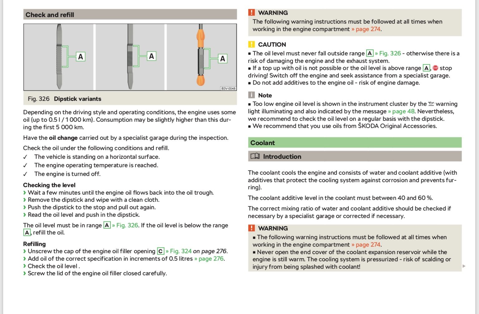

@jannerofl I presume you have actually checked the oil dipstick and not noticed oil drips under the car?  Just because it's not done the mileage to service it, you should. There could be a reason such as low oil level.
Yeah oil is absolutely fine. Dipstick perfect etc
@janneroflHandy if you mentioned how many miles your car has done?
Oil needs checked at normal operating temperature, parked on the flat and after a few minutes.
Lots of threads on that?
If you have Low Oil and a warning shows and there is low oil and you open the bonnet the warning goes out for 100km/ 62 miles.
NOT A GOOD THING.

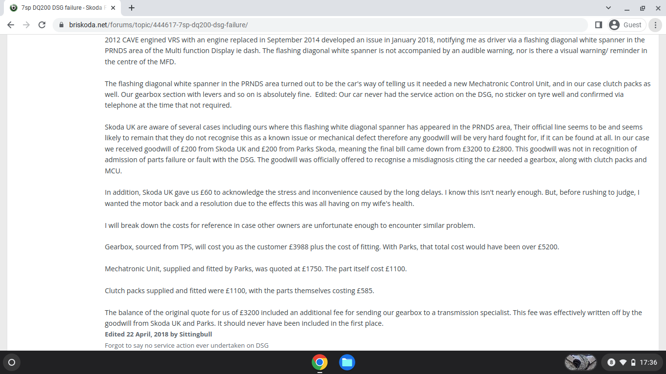

This was 2018 and this was my pals DQ200 DSG. Which was too far away to get brought to where i live so that my pal a Autobox Specialist could do the work.

38 minutes ago, Rooted said:
£1,200 was less than a Mechatronic usually costs plus fitting.  £1,700 is usual for an Independent Specialist.
Is it a new MCU or a repaired / refurbished one?
