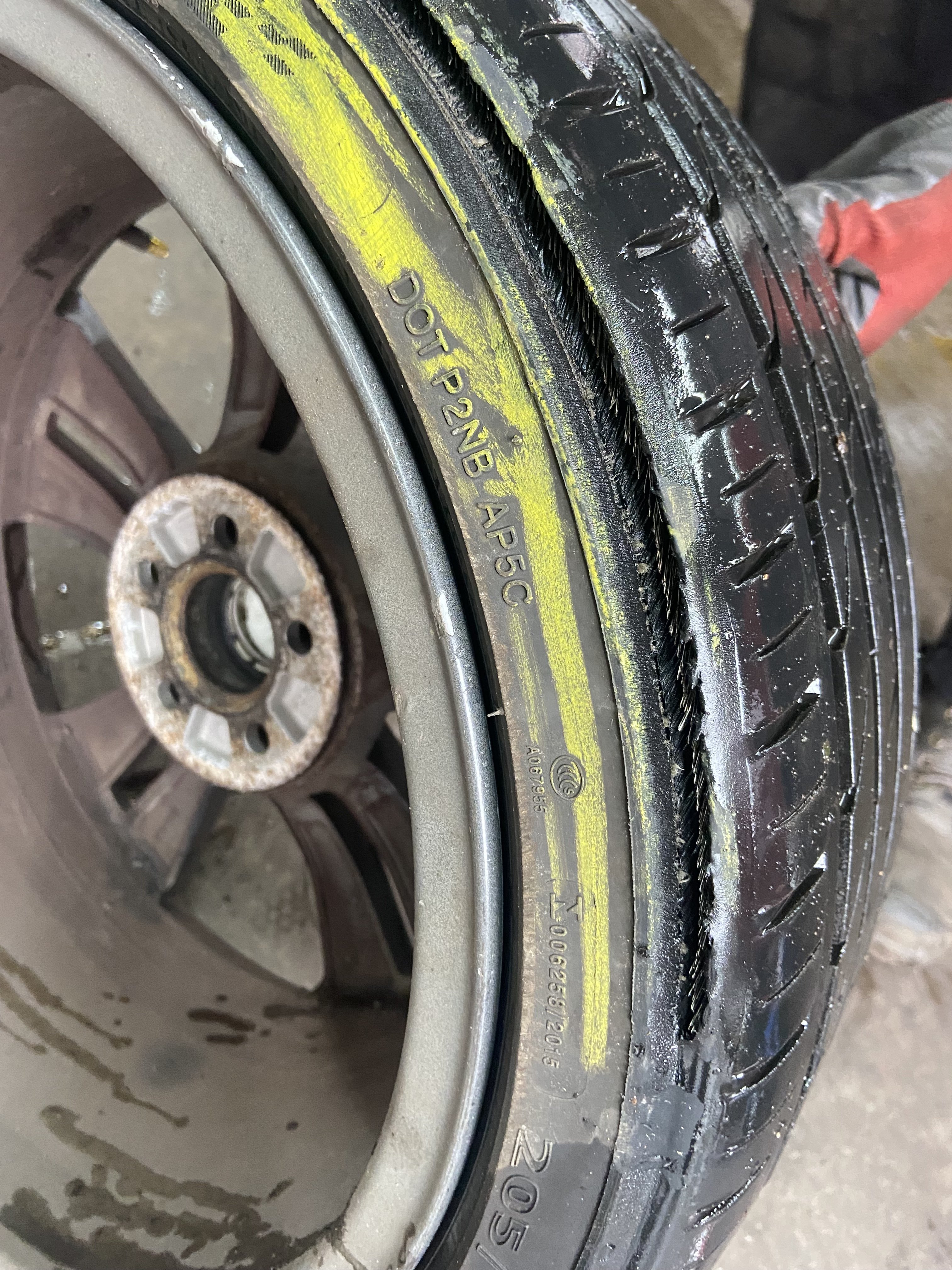

I’ve had my Skoda Fabia Monte Carlo from virtually new and always had a problem with excessive inner tyre wear on the front wheels. This time however, when I took it for the MOT the garage said they had never seen anything like it and how we hadn’t had a blow out was a miracle. The tyre garage said we would have been prosecuted if it had been in an accident. They said the only time they had ever seen it so bad was when a spring had gone which it hasn’t. We have had the tracking checked at a 4 wheel alignment centre and he said it was fine. I just want rid of it now as I am beginning to think it is a manufacturing fault. It has done it to every set of tyres I have put on it but never this bad. This time the treads are still perfect but the inner wall was nearly through. Has anyone else had this trouble? Its a 2013 Special Edition.

I'm pretty certain that a gouge like that indicates either something sticking out from the spring just above the wheel, or the wrong size wheels fitted. What is the wheel size supplied? This will be either cast (alloy) or stamped (steel) into the wheel, probably on the inside. An example measurement (figures from my old Octavia for illustration only) would be "6.5x16 ET42 5x100 56.1".

This is not uneven tyre wear and nothing to do with alignment, the inner tyrewall has been ripped out, does it happen on both sides?
It is either impact damage from hitting potholes etc with silly rubber band tyres which has torn the re-inforcing wires but then it has continued to propagate because the tyre has not been checked, given this has happened before I would be physically inspecting every inch of all the tyres on a weekly basis and immediately after hitting a pothole or coming into contact with another object.
I dont believe it can be related to the spring or spring platform as that is above the tyre, the wrong rims is a strong possibility but any tyre fitter, mechanic or diligent owner come to that would easily see what it has been coming into contact with (if that is the case) by polish marks, paint or underseal worn through etc.

Can you take a photograph of the tyre 180° away from the damage please?
Its hard to see from that photo but there could be a groove running all the way around the tyre, it looks like it might continue downwards out of the photo frame.
What has the wear been on the previous tyres? Uneven tread wear or the inner sidewall being ripped?
All I’ve got is that video as I’ve had them changed. Maybe its 2 different things? Maybe this was pothole damage and not wear but it has occurred in the exact same place where all the previous tyres had worn.
Delinte tyres are horribly cheap so it could have been a manufacturing defect that caused the delamination, you generally only see damage like that on under inflated tyres on cars with negative camber.
I know the Monte Carlo is lowered as standard so I recommend you get a full tracker printout showing the suspension geometry accurately.
Seeing the gouge has got me wondering whether or not the wheel is warped or buckled. Do you get a rhythmic drone, changing in frequency with road speed?
