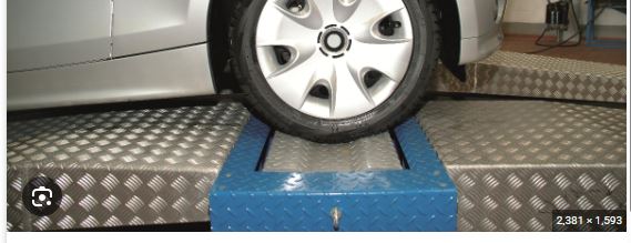

If bouncing on front wing (by hands) tells nothing, if rods of shock absorbers are not leaking, if it's not concerned with upper mounts or squeaking control arm bushes...
Maybe shock tester can help? Here you'll get print-out about condition of shock absorbers:
