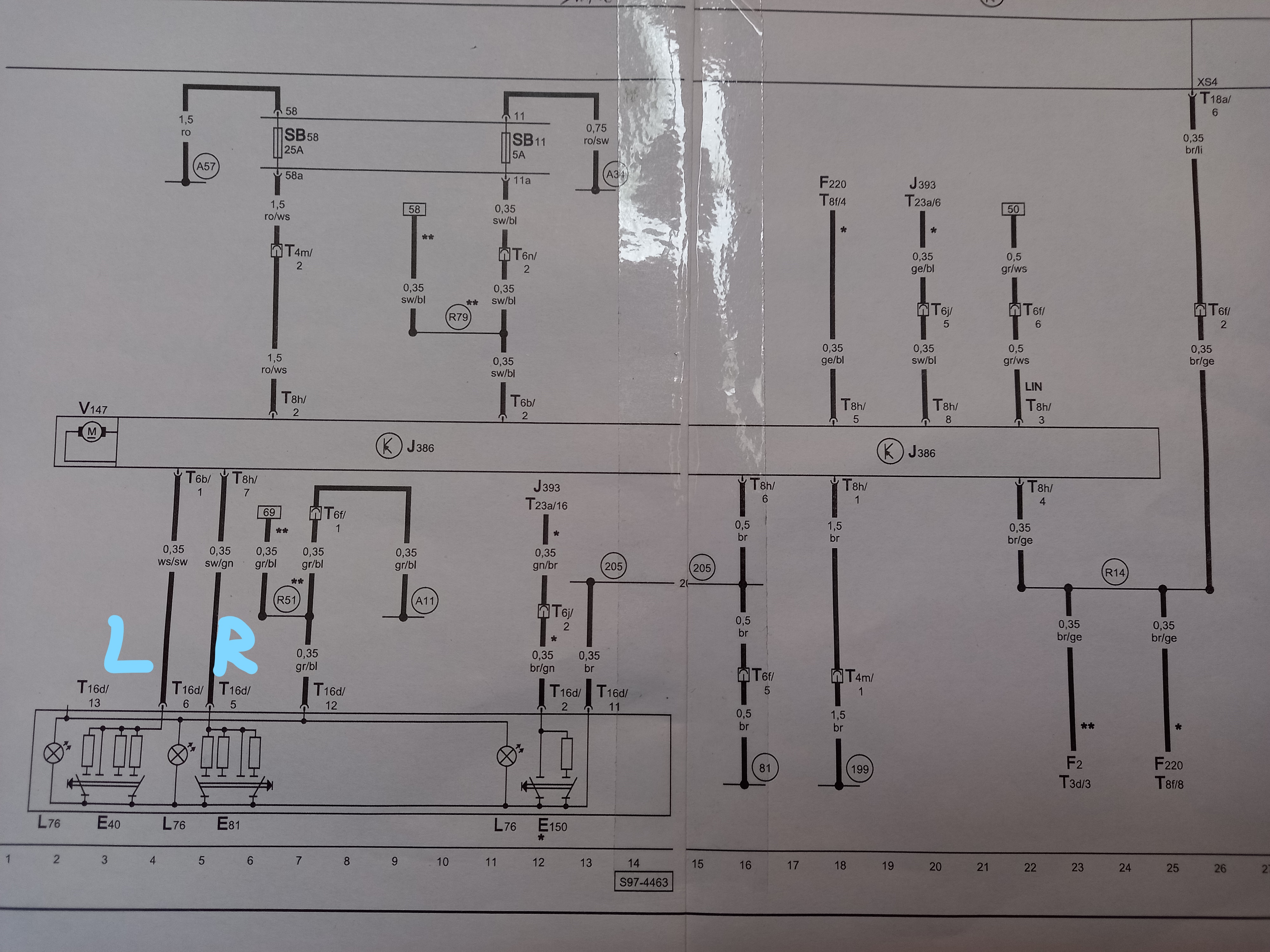

Autodata shows this model as having a Can Bus to the motors, but that is wrong. The Skoda wiring diagram shows it having a Lin wire that goes from the drivers window motor to the passenger side motor and that has a steady 10V when tested at the motor with the plug in and does not vary when working the window switches.

Is there a way of bench testing the motor, I was thinking I might be able to connect VCDS or ODIS through a breakout box that I have (Godiag GT100) Only problem is not sure where to connect the diagnostic line to.

It'll be the driver's side motor module failing/failed.
Did your fuse and voltage checks include #11, an ignition switched feed to the smaller connector at the motor.
There's no data connection other than the LIN wire, so OBDII is blind to these problems.

Fuse 11  is the switched feed.
On the bench, if you provide the two 12V feeds, you can ground the wire labelled R here and see if anything happens.
Failing modules sometimes work when powered afresh, but then fail again next time they're given a wake-up call by the door lock 'key turned' signal or the ignition feed.
In the absence of the passenger module it'll go to sleep after 10 minutes and only wake up if the main permanent feed is cycled, I seem to remember.
If the LIN wire is connected to a passenger/slave unit that's also powered, the normal key and ignition 'wake-ups' should work.
