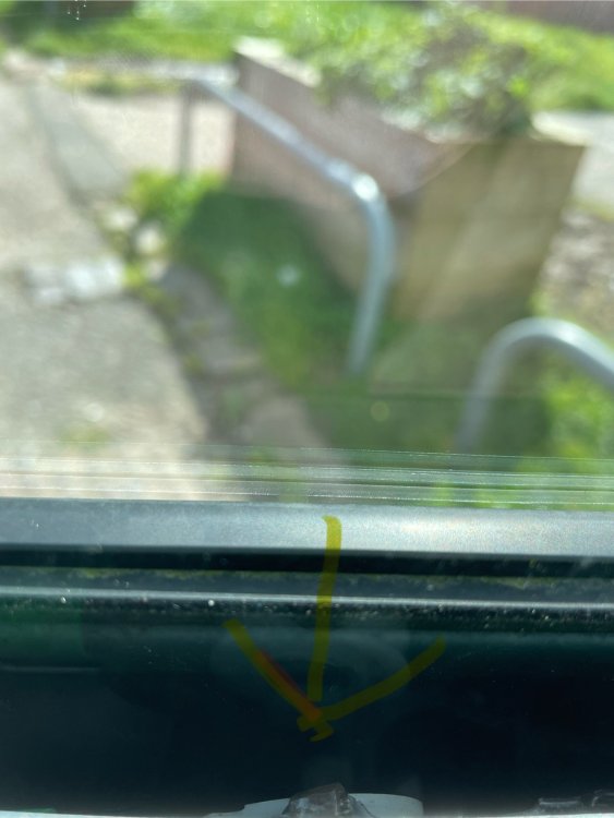

You can just about see the end of the cable that hose into the white plastic bit in the middle of the door I think .
  • Sponsor
I can't make out much, but I'll trust that you can see enough to tell that the mechanism/regulator is bust.
Probably worth replacing that ahead of worrying about the motor.

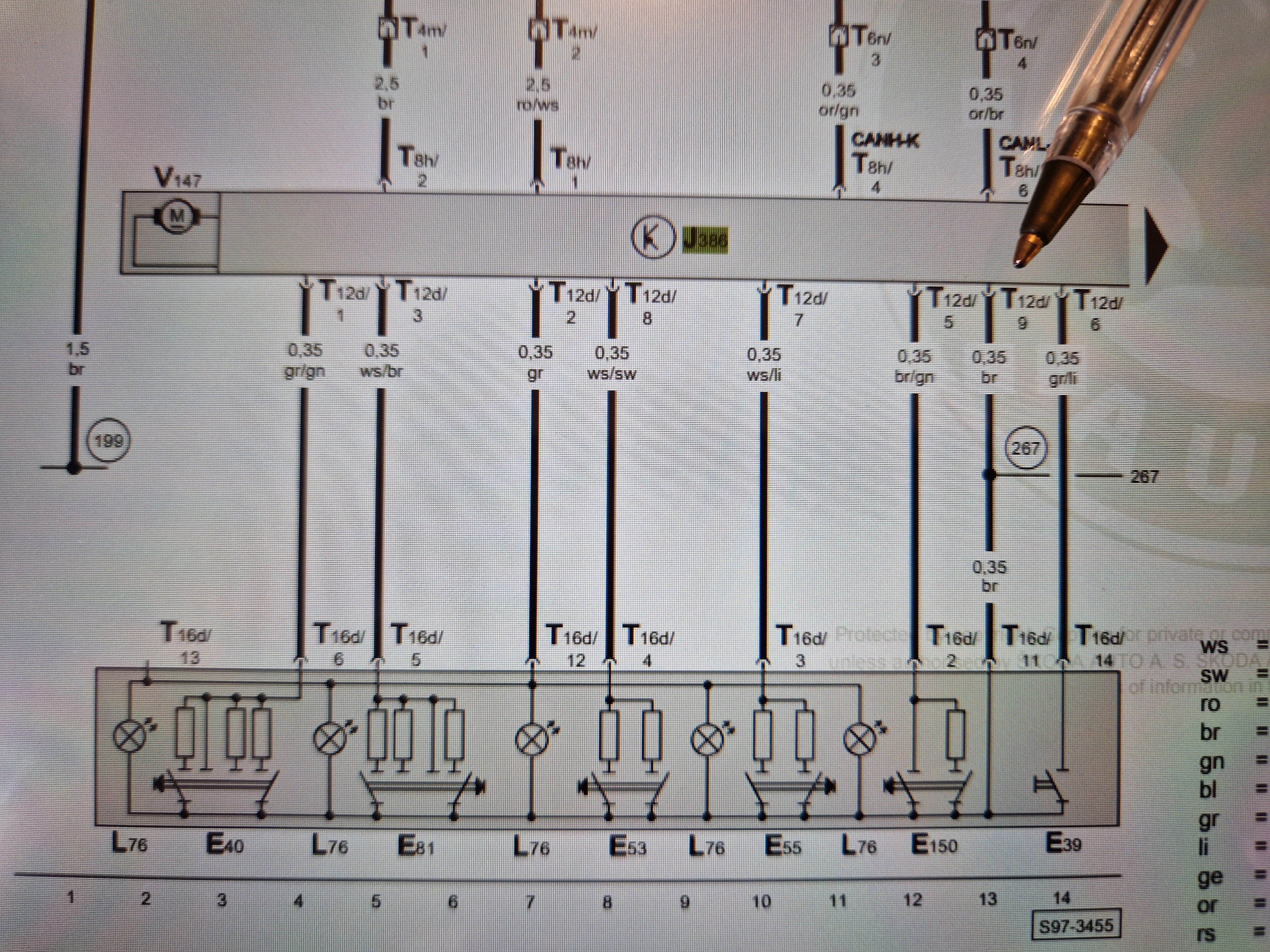

Let me just check the circuit in a sec.
Did you say you have circuits?
  • Sponsor
For pre-facelift cars with all four windows electric, the crucial earth to the switchpack is a brown wire that connects pin 11 of the 16-way at the switchpack connector to pin 9 of the black 12-way at the window motor.
It's also shown as splicing into an earth wire in the door loom (marked 267 in circuit).
Without that none of the switches nor backlighting will work.
Edited by Breezy_Pete
