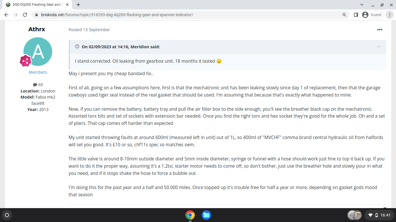

http://briskoda.net/forums/topic/517146-what-is-this-oil-leak
http://briskoda.net/forums/topic/518213-my-dsg-gearbox-seems-playing-up
Likely the cheap fix is no use to your box, that is an accumulator kit.   That is for the issue common on 2013-2015 DQ200,s and there was a Service Campaign on them from 2017.
34H5.  That was a pressure issue and cracked boxes and MCU,s.  Software Update was as a preventive measure.
