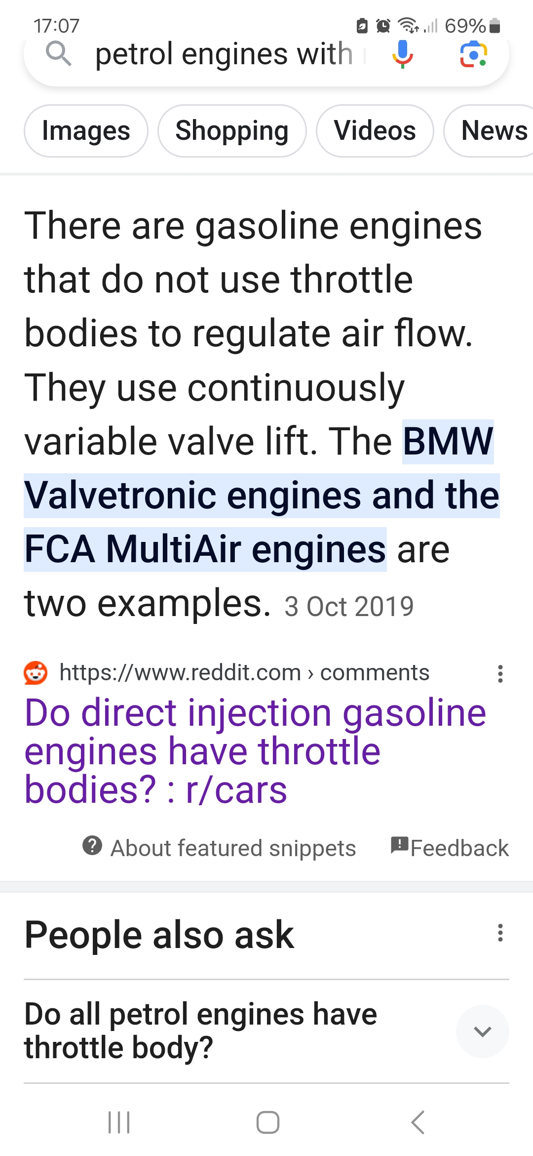

There are some petrol engines without throttle bodies actually.
I remember being very doubtful when a young pal of mine told me he'd failed to find one in a petrol BMW he'd been looking at, several years back.
Google confirms:
1266804374_Screenshot_20231225_170756_SamsungInternet.thumb.jpg.15258dfdf5b9f8e6cfeb2df08bb53617.jpg
I stand corrected. I was not aware these two arrangements dispensed with the throttle body.
However both are very expensive solutions to the control issue, and the Multitronic is not very durable.
