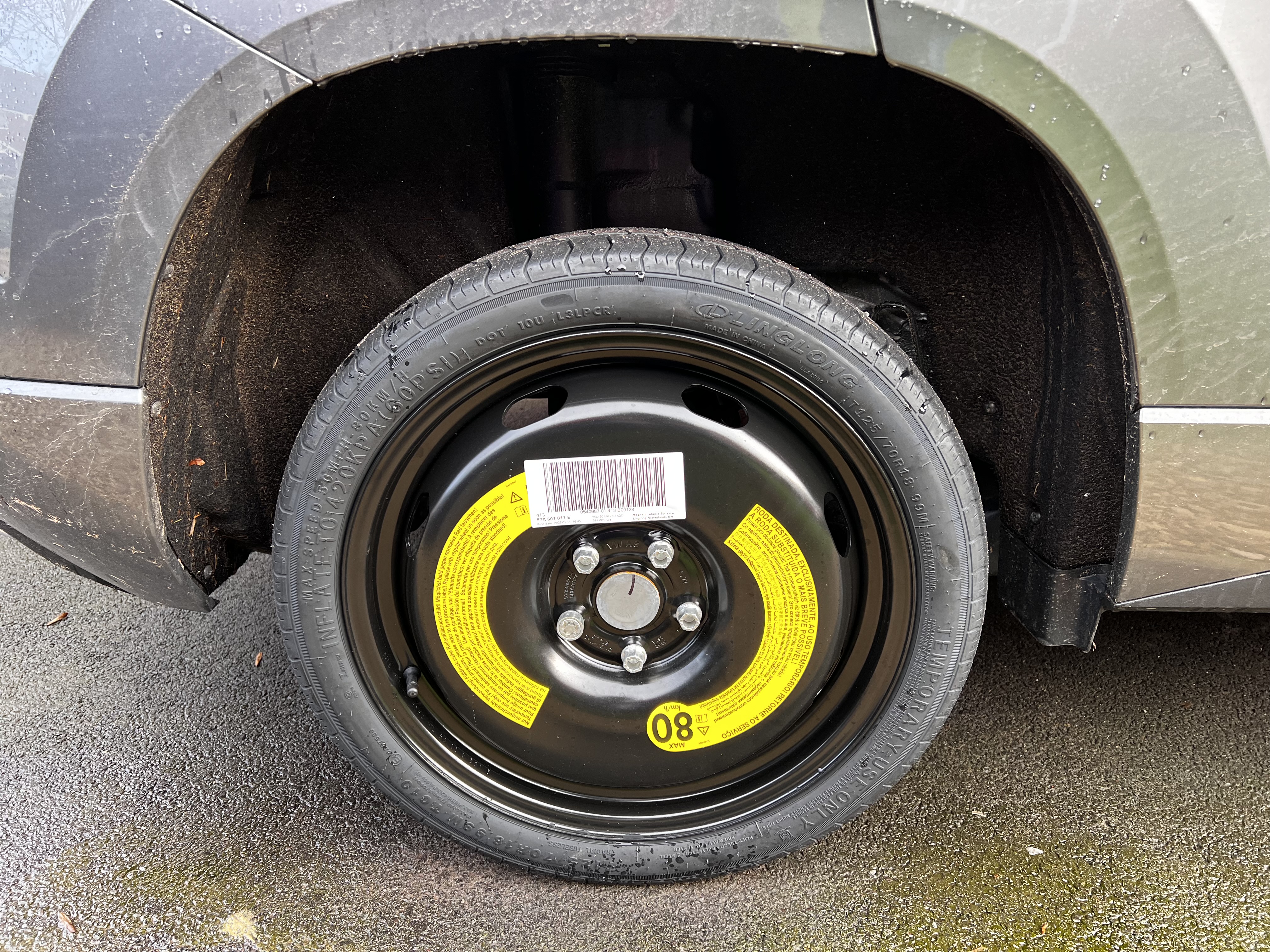

Space saver to the rescue!

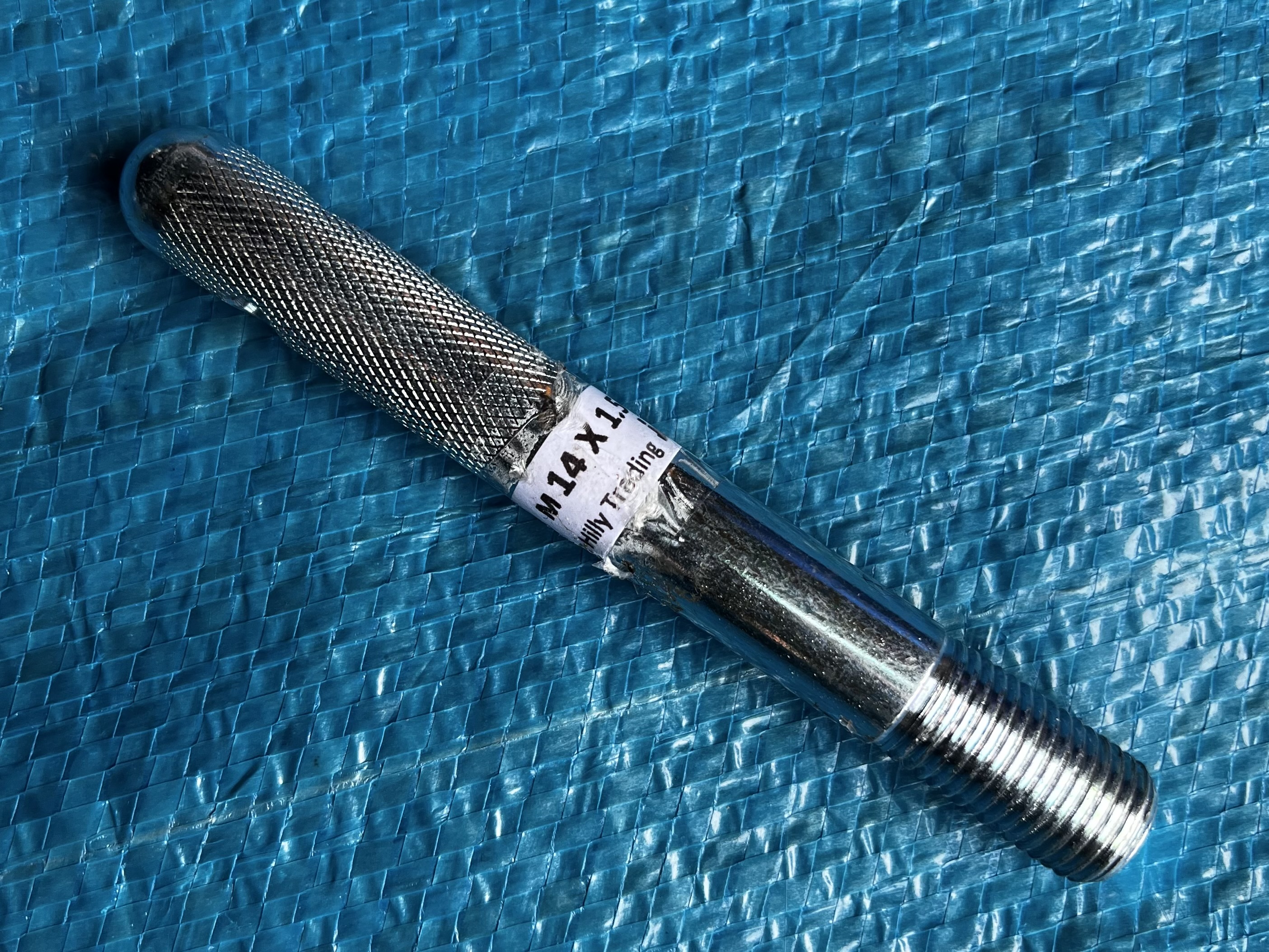

I’d highly recommend investing a fiver in a wheel alignment pin as there’s not much of a prominence on the hub to get the alloy on to, this was compounded by trying mount the wheel by torchlight at the side of the road.
Brilliant idea! Just ordered one - now £7.00 but worth every penny
l wouldn't take a car off the drive without a spare wheel - either a regular size or space-saver - they've got me out of trouble on numerous occasions.
Soon after getting the Karoq, 5-years ago, I saw an advert or an article mentioning the wheel-alignment tool. I thought what a brilliant idea, and bought one - touch-wood, I haven't had to use it yet. Karoq wheels are b..... heavy and I don't see how, without the alignment tool, you could lift one and put a wheel-bolt in at the same time - unless you had 3 hands.

I’ve used one of these rods to change wheels, they are a great help.  However the wheel still rotates around it so going to get a second, then the wheel will be held in the right position to put the other 3 bolts in place.   That’s the only thing that’s better on my past LRs cf Skippy, they had hub bolts and wheel nuts which makes changing way easier, even when the wheel weighs 34kgs.
I bought a pair quite cheaply but being the selfless person I am I gave my now ex UK neighbour one of them for his Octavia, we both have to struggle a tiny bit more with only one but its easier than none.
I can swop the wheels easily enough without them if I'm wearing overalls and have the car jacked up enough, if not I cannot see through the bolt hole in the wheel to see if the threaded hole is behind and there are other holes and things like the disc retaining screw which look the same to my one functioning eye.
At the side of the road at night using the car jack I really need the pilot stud, my method without is to sit on my backside and raise and position the wheel using my shins, no use when sat in a puddle with the car too low and not being able to see the threaded holes.
