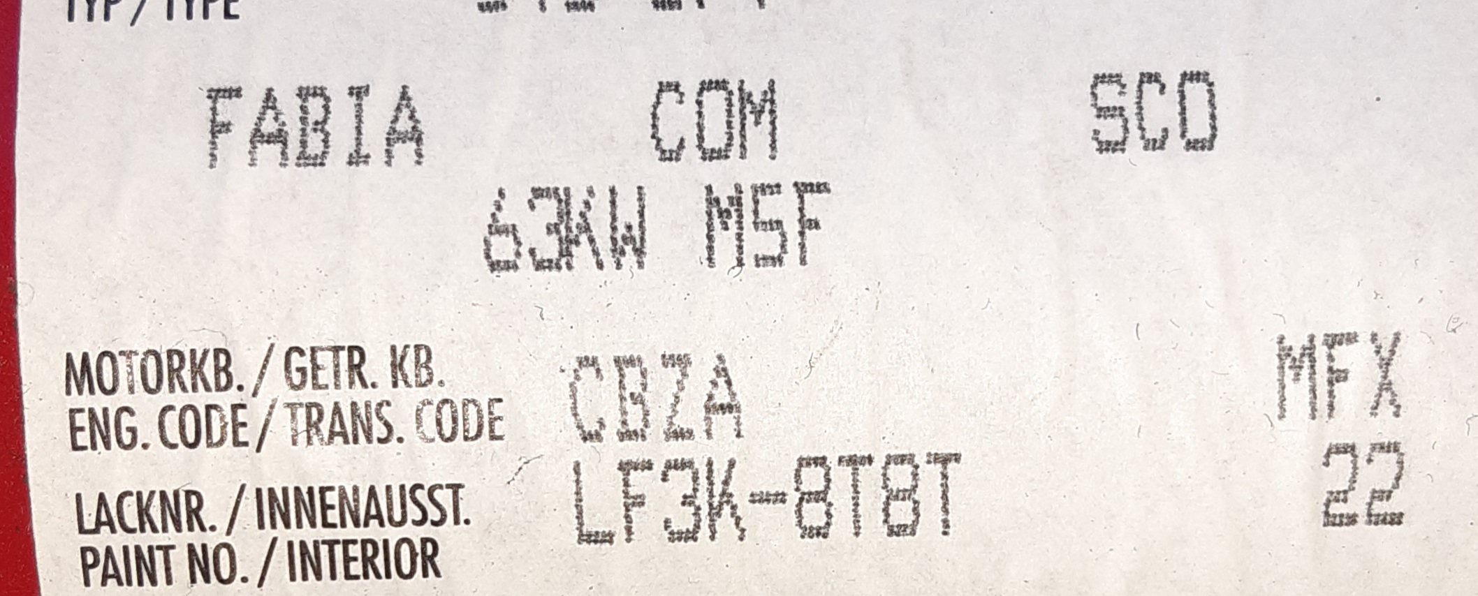

As in the OP,  63 plate registered in 2014 is not one of the 1.2 TSI,s that are covered by the TPI is it.  Those were pre 2012.

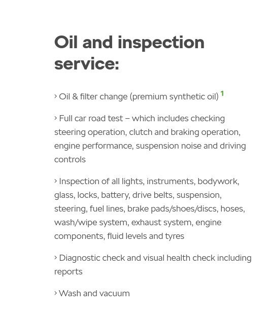

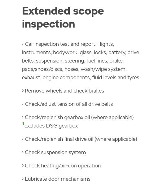

What kind of Major Service is being done, Oil & Inspection, and are you having the spark plugs changed, the pollen and air filter, the brake fluid & anything else?

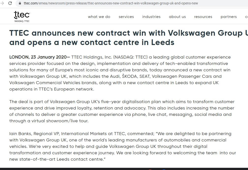

These are who you are talking to on a phone, e-mail or Chat , or even a Bot.

Below is the engine info regards my vehicle, if anyone can confirm this  indeed shows my car is one that falls within the Chain failure issues bulletins?
Thanks👍

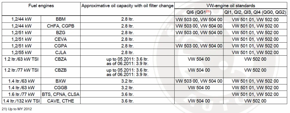

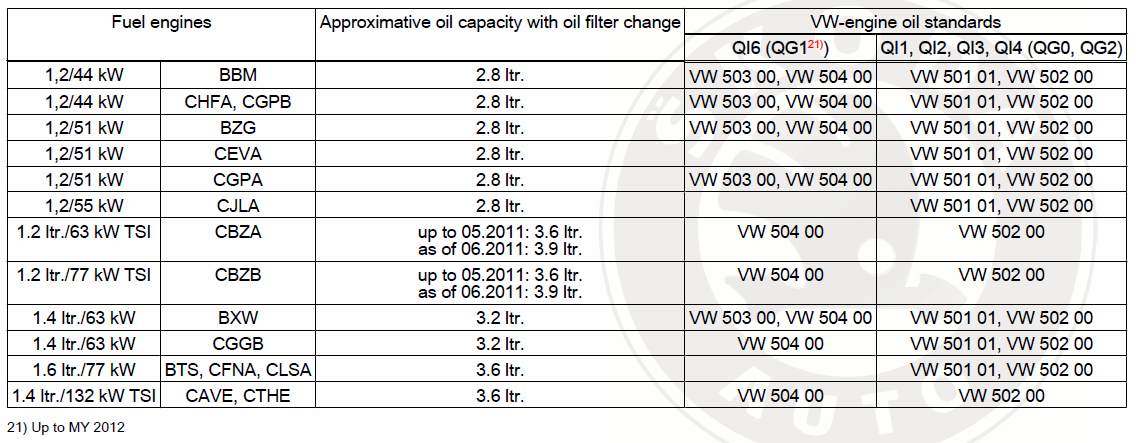

Maybe it was decided to use VW502 , 5w 40 FS oil instead of the VW504 00 / 507 00, 5w 30 FS III long life oil and there is not the same rattle on start up or when running or just the Technician / Fitter had good hearing and also was trying for the job of getting to replace the timing chain.

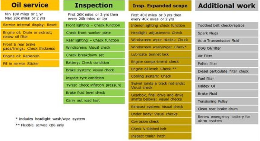

At Main Dealers the extras need paying some jobs / parts, as the Oil & Inspection services & the Extended scope does not include Spark Plugs, Brake Fluid Change or Air or Pollen filters

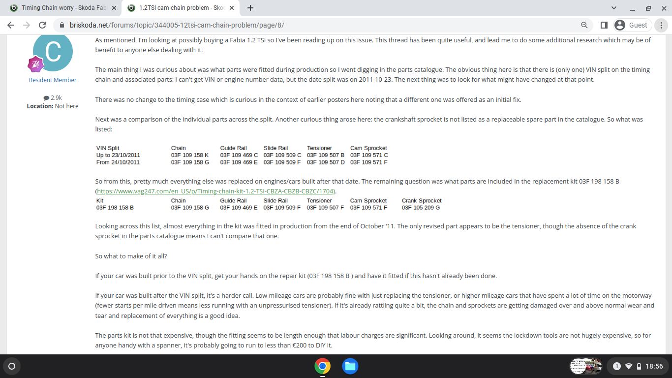

63 plate car will have the revised engine with improved chain drive so in my experience chain life is considerably longer (120,000+ miles v 60,000 miles in the examples we owned)
A slight rattle on cold start ups for a couple of seconds (until oil pressure is established) is quite common and probably nothing to worry about.
But if the rattle gets loud ( heard inside the car) on start up (usually happens after being stood a long time) and sounds painful, like a machine gun , this is the chain so slack it's riding up on the sprocket(s), IMMEDIATELY turn off the engine to prevent disaster. Wait 4 or 5 seconds, then restart the engine and hopefully the loud rattle is no longer there as the oil pressure on the initial start allows the tensioner to take up the slack and force the chain to engage the sprockets correctly.
In this case its time to replace the chain kit (entire kit contains chain, 2 sprockets, tensioner and 2 guides).
I had replacements done at around £400 each time at my Skoda dealer but the last was around 3 years ago.
Tip: Don't leave the car parked in gear. In this design if the crankshaft rotates reverse to its normal direction then the chain tensioner can be forced back and the chain goes slack on the non tensioner side.  It will then hang down off the bottom sprocket. If you must park in gear, use reverse gear if the car is pointing uphill and 1st if pointing downhill.
Btw the ticking/clicking noise you mentioned in your 1st post is probably from the mechanical high pressure fuel pump located on the cam cover - big shiny hex head on top and 2 stainless steel fuel pipes. Can be quite loud at idle stood outside but inaudible in the cabin. Normal and nothing to worry about.
