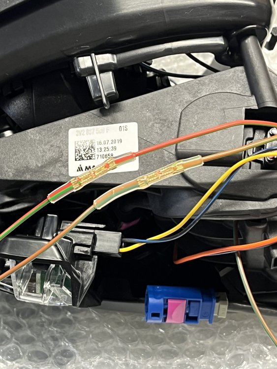

Next I have to extend the blind spot connectors, on the FL the blind spot LED is in the elbow of the mirror on the cover, and not wanting to buy 2 new mirror glasses at £300 each, I will extend the blind spot wires to the mirror glass.

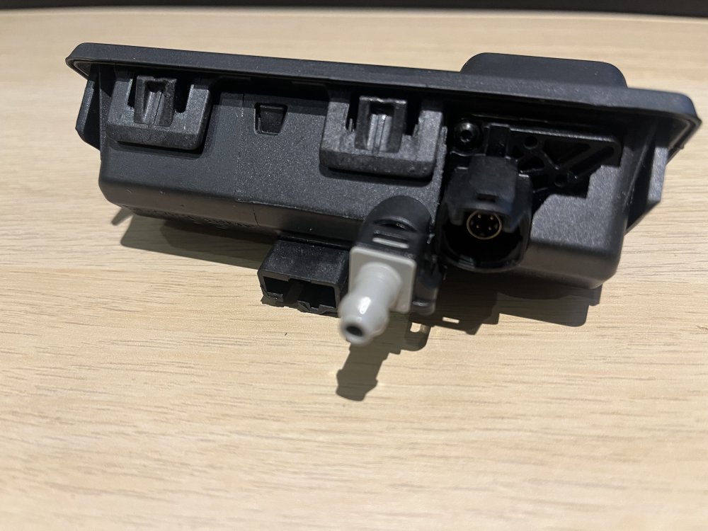

The camera for the front has arrived and I can now get dimensions for this and start making a 3d printed bracket - 5Q0980546A is the part number.

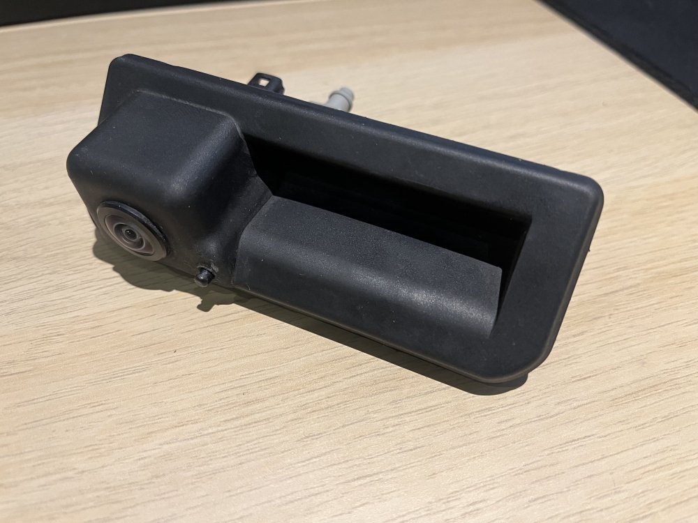

The rear camera is 8W8827566C and the version I have bought seems to be a dodgy version as the lens sticks out the camera body way too far, not an issue but the lens washer wont do anything. For now, this will do, if it all works, ill replace the camera with another one.

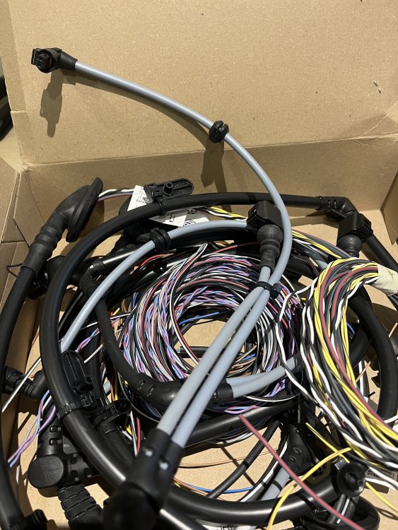

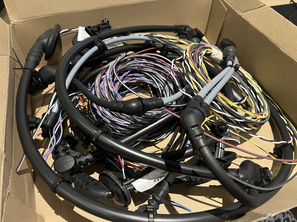

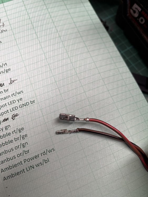

The door wiring is a big issue, there are 4 methods to doing this:
1 - pin the 5 HSD wires to normal terminals and run them through the door plugs like normal wires.
2 - purchase new door connectors and the complete interior and door looms as skoda dont sell the data cables on their own
3 - purchase new door connectors and get the data cables new from a passat as VW sell the data cables on their own.
4 - purchase used loom sections from a breakers car and use these - i found a passat with the wiring complete.
Why did I go for number 4 and not make the cables myself? Well the rosenberger HSD connectors that go in the plugs arent standard Fakra connectors and cant be purchased in quantities less than 10,000....

The mirror covers are also different for areaview as the entire mirror is chunkier.
Stay tuned to find out what is different on LHD and RHD mirrors - I really hope these dont bite me in the ass, As I cant return them.

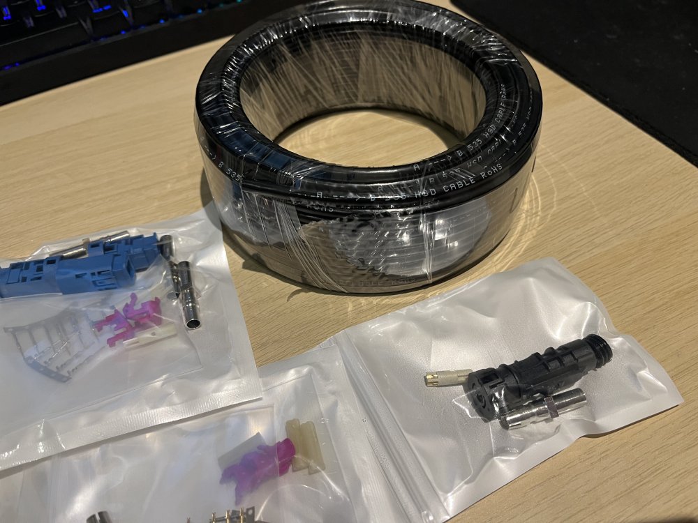

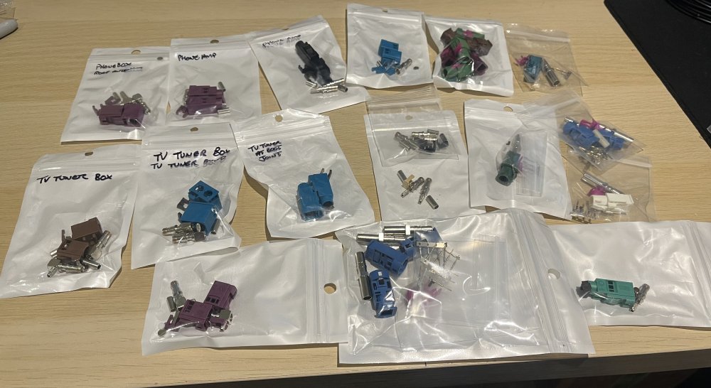

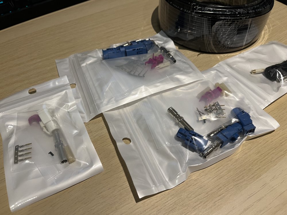

HSD cable and a tonne of connectors arrived today.
Never made a HSD connector before, just spent the last 45 minutes terminating one end.
Anyone that plans on doing this, buy the cables made by a company! They are hard
IMG_9120.thumb.JPEG.10f4a7d77a917d351331ab1e5bf461f4.JPEGIMG_9119.thumb.JPEG.70c59fb294e158dbaf3577899e9c9d66.JPEGIMG_9121.thumb.JPEG.9e766d5e4796507052036923e7cb2968.JPEGIMG_9123.thumb.JPEG.8fbf943dc2e86115f4096acaed4f4f2b.JPEGIMG_9122.thumb.JPEG.2713757da614a29d32cf08b47271c390.JPEG

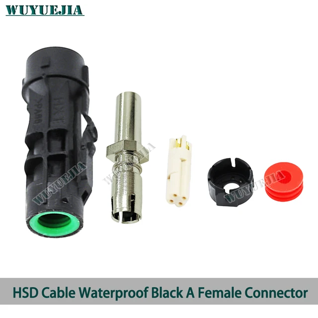

Also something to note - the cameras need a 'long' HSD connector, This comes in waterproof form, So ive got a waterproof connector for the front, but had to order another one for the rear. These are easier to fit also as they are solder connections, not 0.08mm crimps!!!!
1Piece NEW Waterproof Black Code A Female Jack HSD LVDS 4 Pin Connector  Assembly for Dacar 535 4-Core HSD LVDS Coaxial Cable - AliExpress
A lot of other connectors arrived also for this and the other projects, as I use them ill document them.

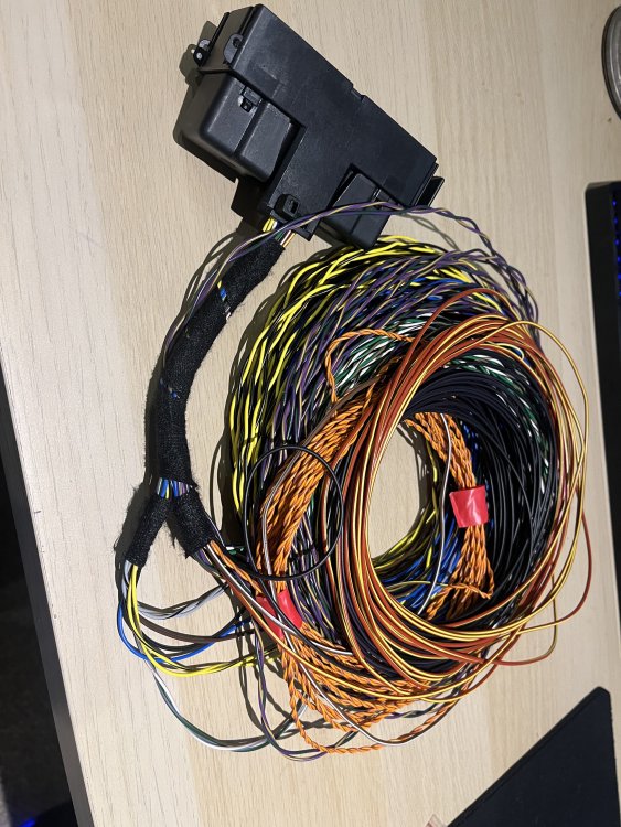

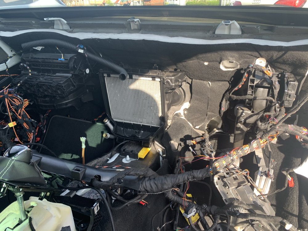

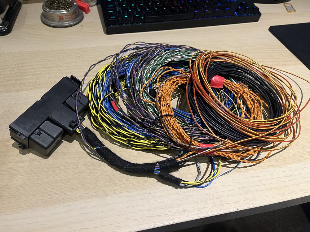

A few more updates!
So this is the majority of the interior wiring for DCC as well as a photo of 4 brand new wiring looms for each of the arches, the 2 fronts with DCC plugs and level sensors, the rear just with additional DCC plugs.
IMG_9163.thumb.JPEG.b82115bf853b5383b001b575bf3deb8e.JPEGIMG_9162.thumb.JPEG.ab8b38a789e699a4cbac291231474460.JPEGIMG_9160.thumb.JPEG.b5062f55d05315ef9d416c50af6ac240.JPEGIMG_9159.thumb.JPEG.cb0f567f95fb2b89026491d4a2092916.JPEG
On top of this there is about 15 new wires through the firewall into the engine bay, lots and lots of work!

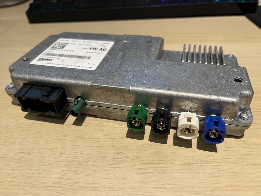

Some more areaview updates -

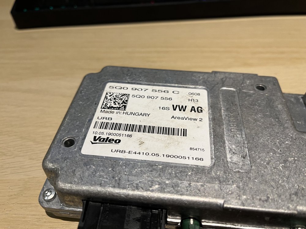

The control module arrived, 5Q0907556C is the most common module for datasets and is also the earliest revision used so should be compatible. The 4 HSD connectors for the cameras and the 1 coax for the output to the infotainment unit.
 IMG_9149.thumb.JPEG.fedf69712fff16aeef00cd4424845998.JPEGIMG_9148.thumb.JPEG.c6acdad7ae383c805115e18cac8205f7.JPEG
The poor quality camera was sent back and a used genuine one was sourced instead, much better quality!
As you can see, no wires coming off the back of it, instead a HSD connector type A waterproof.
IMG_9157.thumb.JPEG.7639787fec78ddabf57dee3f89239821.JPEGIMG_9158.thumb.JPEG.9e47fdd40b85f175eae8464be9c60a00.JPEG

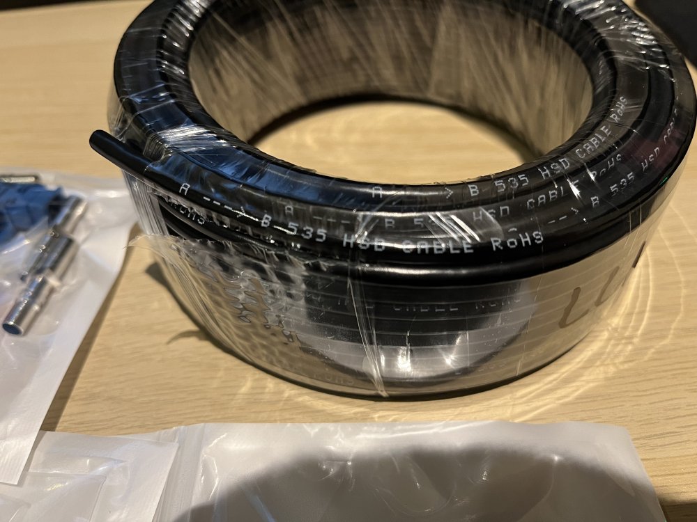

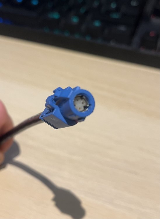

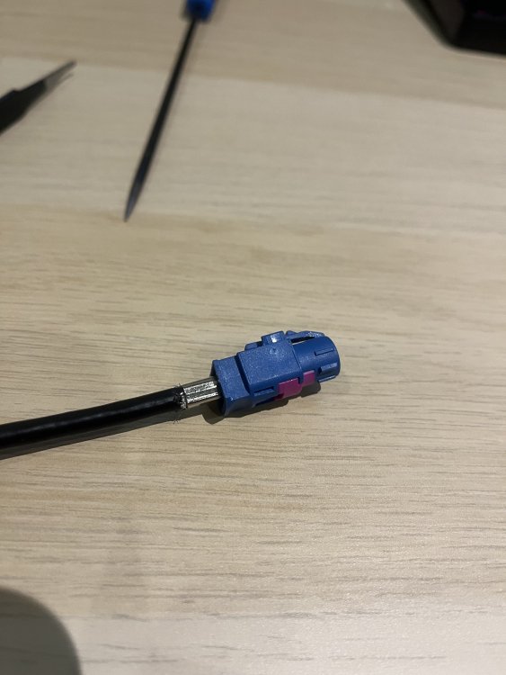

We are now going to talk more DATA CABLES! Again....
So there are two types in play here, we will start with the simple ones.
Often called Fakra, but this is the connector type, instead they are Coaxial cables, a single copper core with a braided sleeve around it to prevent interference, used for video signals and for radio/antenna signals. These are quite easy to make up - a wire stripper, soldering iron, crimping tool and a magnifier glass.
The cable choice was RG174 as this most closely matches the OE RTK031 but without the huge price tag!
Ive used around 40 meters of the cable so far - tv tuner, phonebox and amplifier, areaview output, parking heater remote signal.
Quite straight forward compared to the next type....
LVDS HSD Fakra so this type of cable luckily isnt used too much for my retrofits, but it is a low voltage high speed data transfer setup - very similar to a USB port.
It contains 4 individual cables surrounded by a metal film, surrounded by a braided sleeve, surrounded by insulation.
These 4 wires are power, ground, RX, TX - meaning with this single connector a component can get all it needs and send and recieve data - such as a tiny areaview camera.
The OE connectors and cables are made by rosenberger - but they dont want to sell me any parts in quantities less than 10,000.... so ill stick with the RFDOTOP ones at £4 each the quality is very good and matches rosenberger ones exactly.
The cable type im using is a Dacar 535 and the tools im using are a crimping tool, soldering iron and terminal crimping tool down to 0.03mm
Now you would think each end of the cable goes pin 1 to pin 1, pin 2 to pin 2 and so on.... but no. These cables crossover, so pin 1 at one end will become pin 4 at the other end, heres a chart to make it easier.
New Vehicle High-speed Transmission FAKRA HSD B White LVDS 1.2m Shielded  Dacar 535 4-Core Cable
Every fakra HSD cable does this, side A and side B so it gets more complicated. Now if you have a single cable run its easy because side A in, side B out, but if you connect 2 together you go side A, side B, side A and it wont work. So cables always need to be in odd numbers - like they are on all VAG cars - or if you dont want to do that, you get a A to A cable, so when I run too cables it goes side A, side A, side B and you still get the switchover.
So now we have solved the issue of keeping the crossover but with less cabling and connectors.
Now building the cables is a different task all together.... very hard and as i learn to do it, ill post more details.
The only other thing to note - there are around 10 different colours/codes for the connectors and they are not interchangeable (except code Z/water blue which is universal) so for the connector for the cameras themselves, they are Code A/black but they must be waterproof connectors (even inside the car) as they are longer to reach inside the camera.

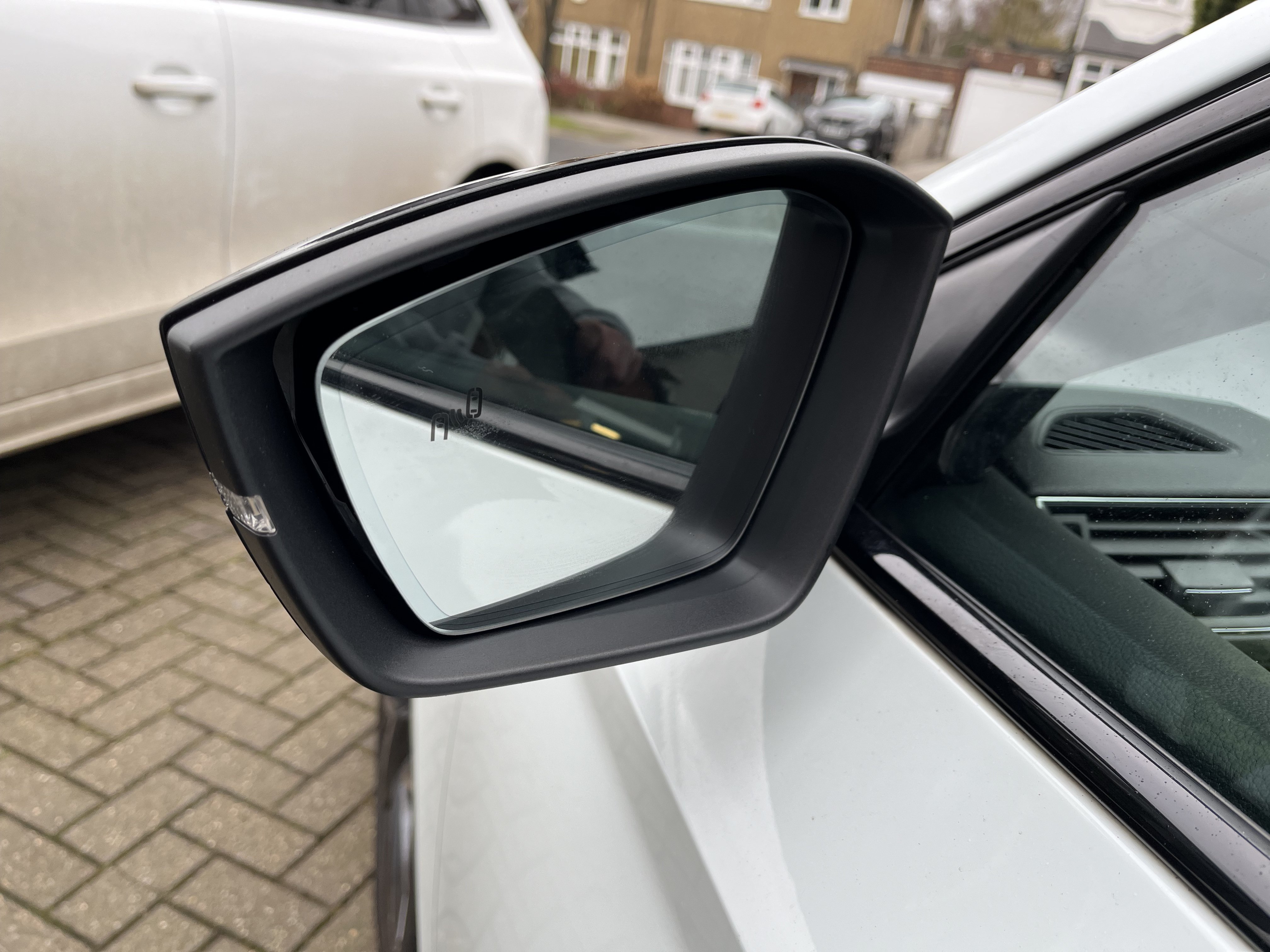

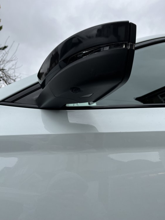

So i thought id test the wing mirror gamble today!
LHD wing mirrors for 1/4 the price of RHD mirrors.... well.... they didnt fit exactly.
So they physically mount up and such, the connections are all the same. The angle of the internal mirror frame is the problem.
The mirror glass need adjusting to their absolute extremes for any chance of seeing anything - even then you cant get them into a good position. Even spacing them out with washers to tilt them.
So if someone like my partner drove the car and had to move the seat forward - she would see nothing at all out the mirrors.
So ill have to purchase the RHD mirrors as at this point im already very deep into the retrofit. £700 per mirror! As no one has a used one for sale anywhere in the UK 😞

It would be cheaper to move the steering wheel and pedals 😁
I should not make fun because I will probably soon have a mirror clash incident with an oncoming car (I'm long overdue after 15 years!) and all I will be able to source will be LHD units.
Bad luck on that one, I too would have taken the punt but it sounds like the same issue I had with the LHD mirror glass, I'm assuming the mirrors would be correctly aligned from the passenger seat.
New mirror units ordered at £850 for the pair.
better than the £750 each that other places sold them for!
Should be able to sell the lhd ones and my original ones for £150ish each so £600 returned which helps to offset the cost from the brand new units.

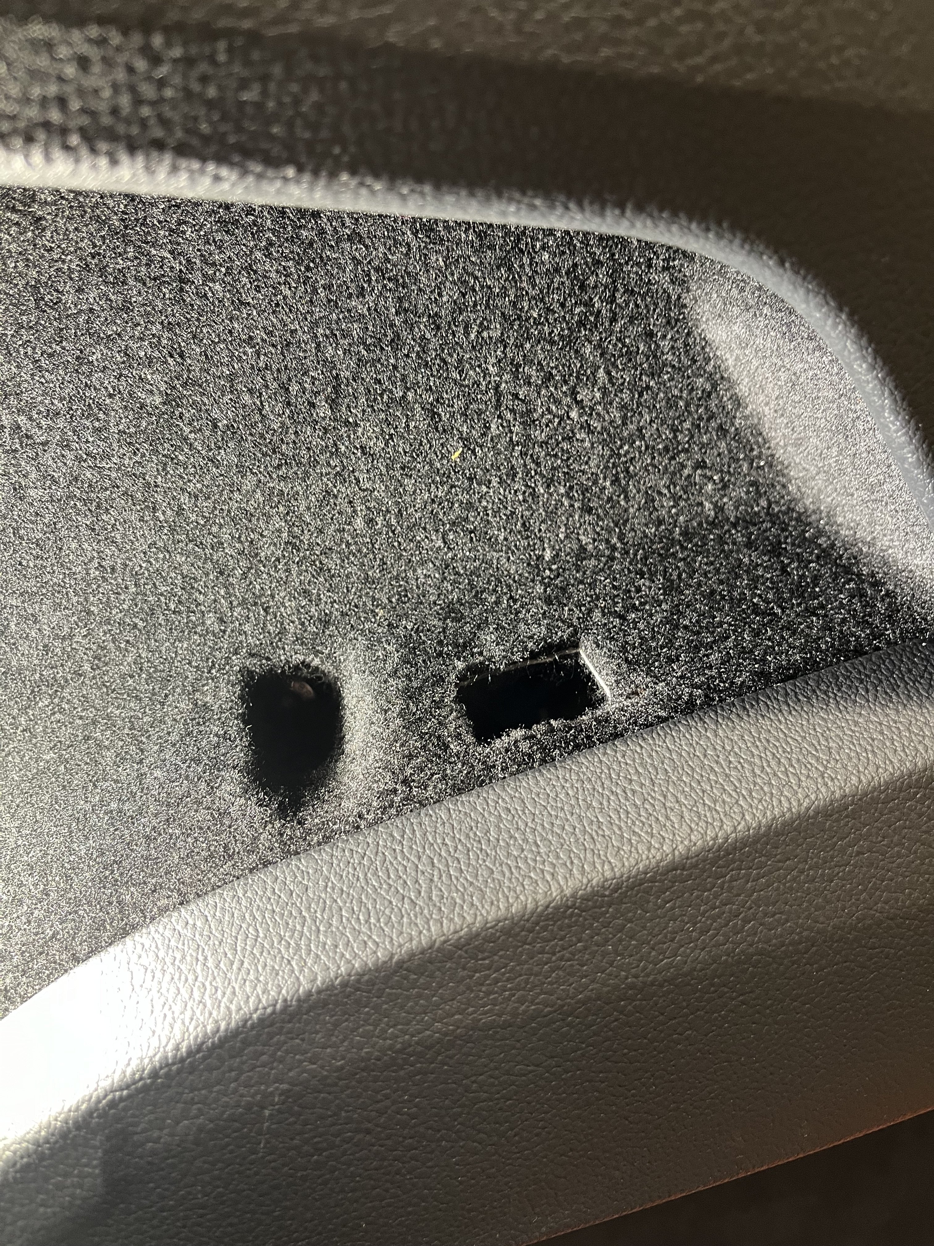

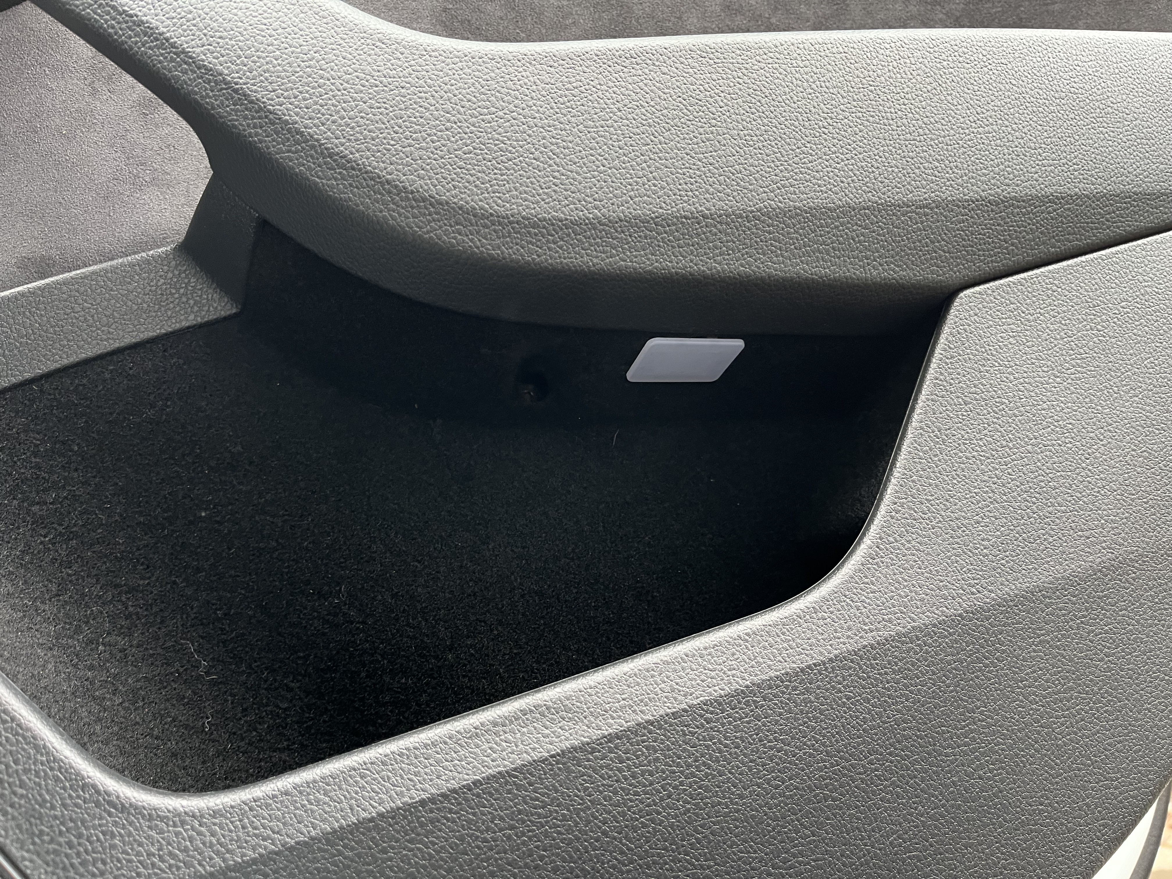

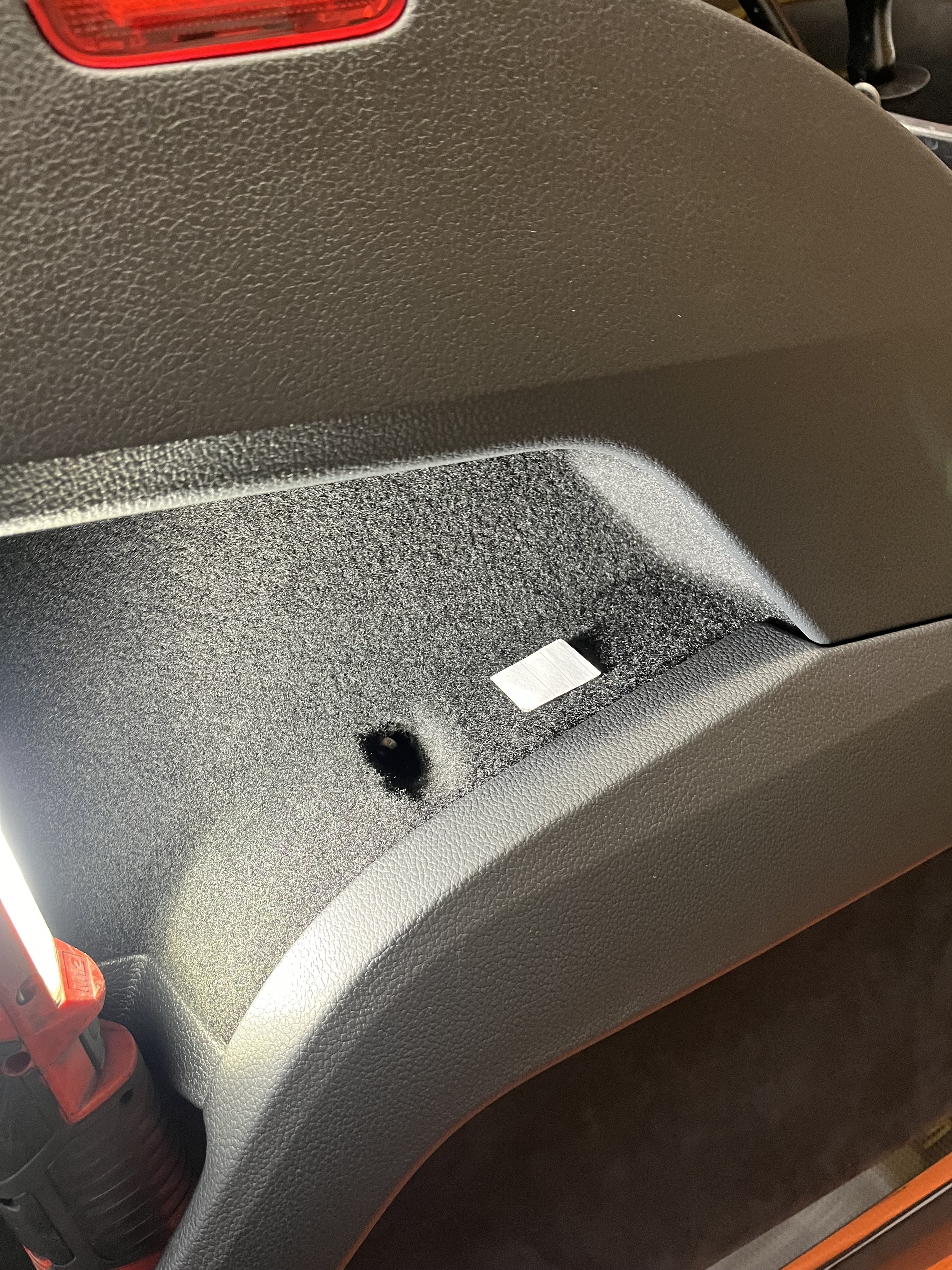

On another note, 2 of the door pocket lights are now fitted, just got to code them in;

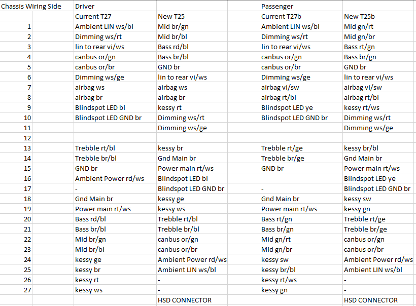

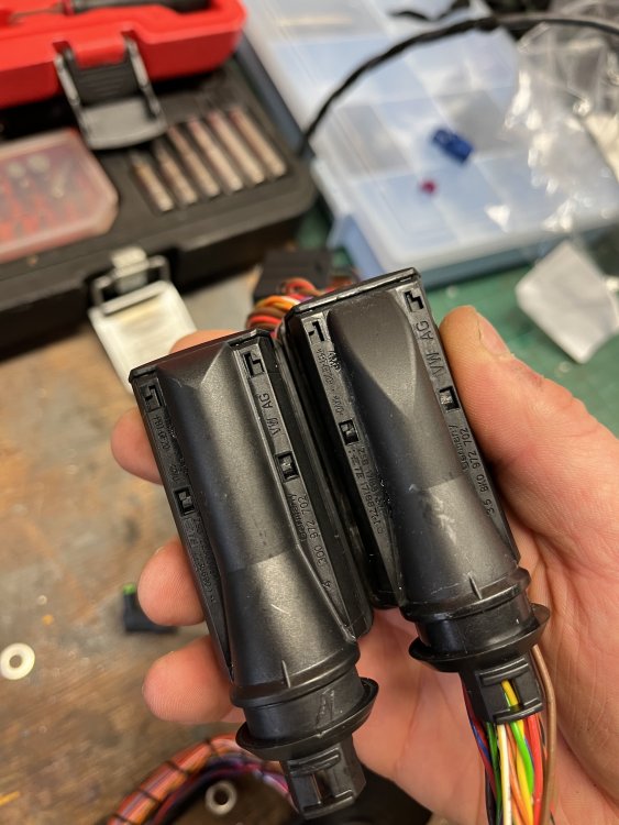

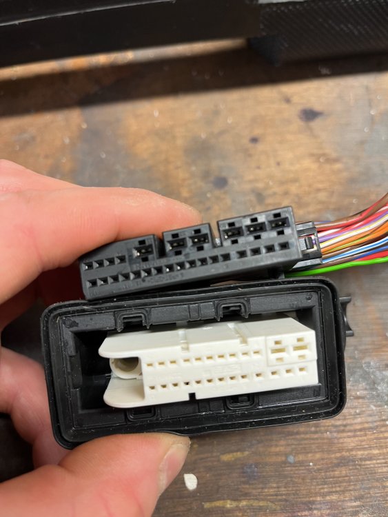

Next up is the door connectors themselves - these go from: 27 pin connectors which use 2x MCP 2.8mm terminals and 25x MCON 1,2mm terminals. To 25+4 pin connectors which use 2x MCP 2.8mm terminals, 23x MCON 1.2mm terminals and a 4pin HSD connector. As the pins dont match up like for like, ive made a excel sheet that matches my car wiring so i can swap the pins to the new connectors. Ill take photos of this up close in the next few weeks.
Something worth noting - the new connectors with part number 3Q0972701 and 3Q0972702 - the aperture for terminals 1-4 are larger than the rest, this is to accommodate the larger 1.5mmSQ wiring for the speaker system (2 or 4 wires depending if canton or not).

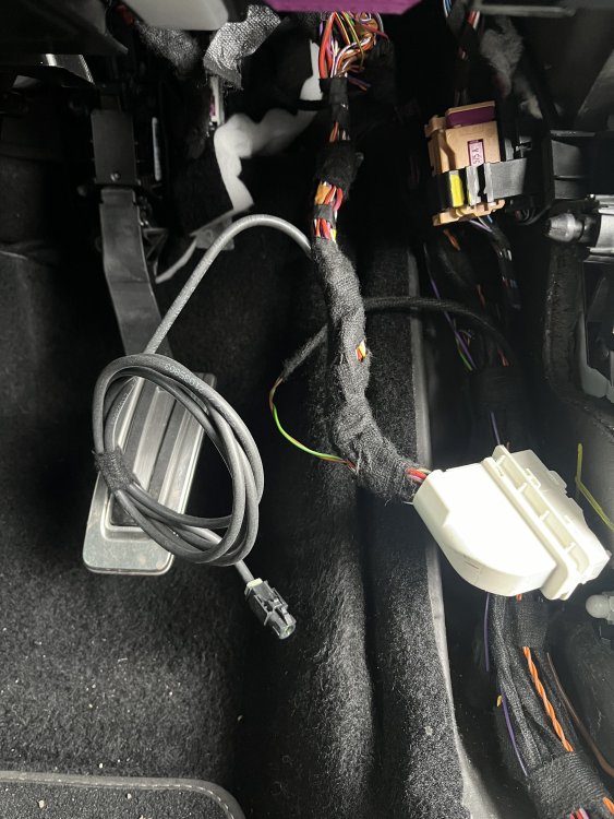

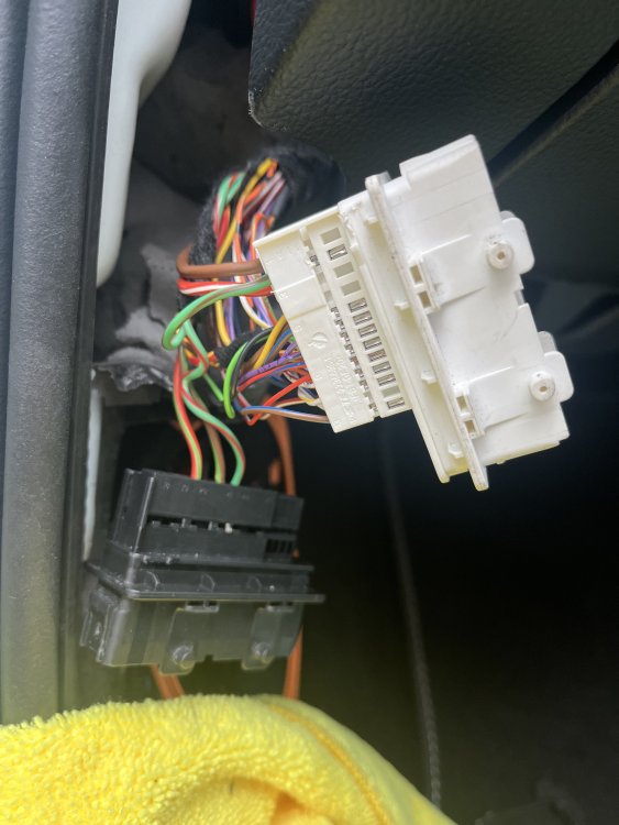

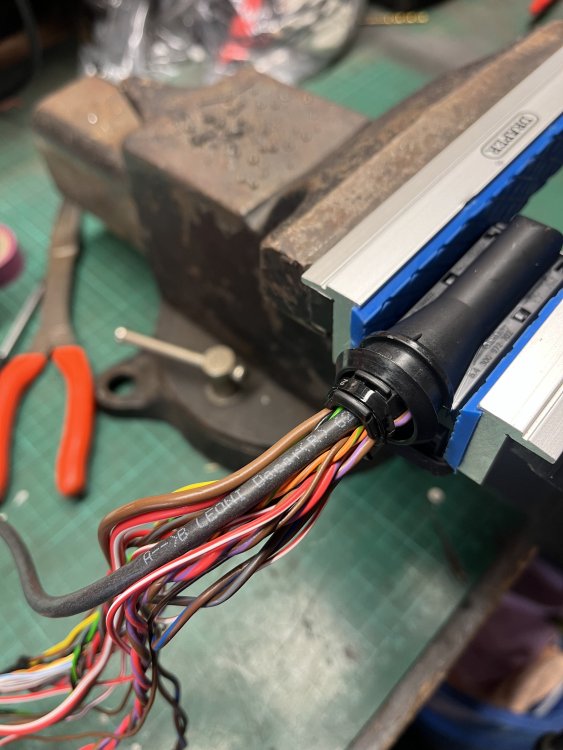

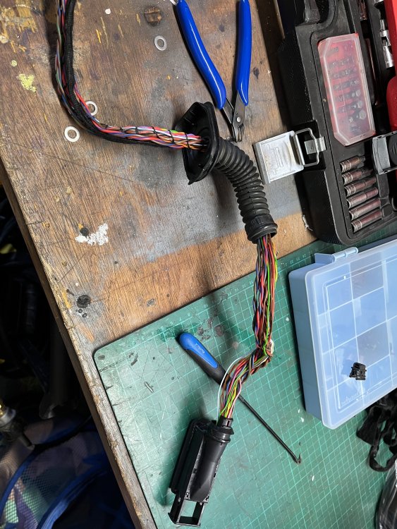

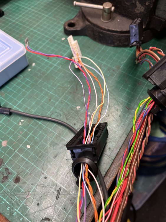

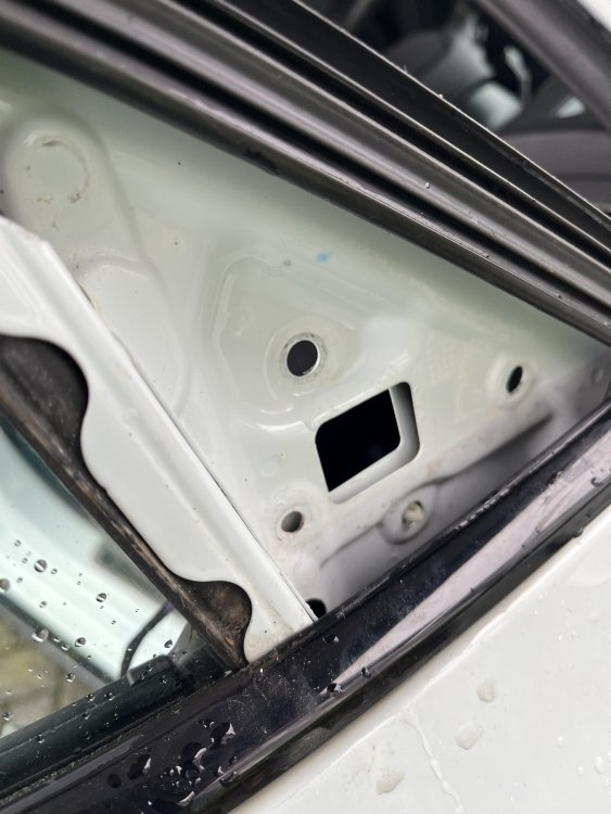

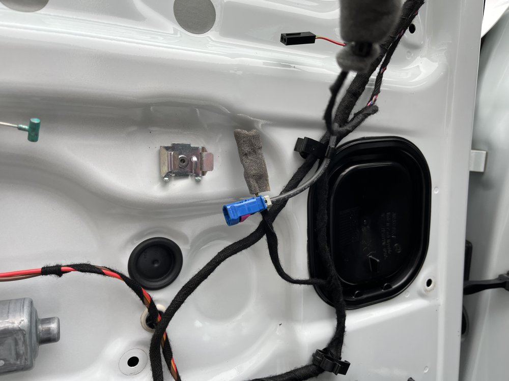

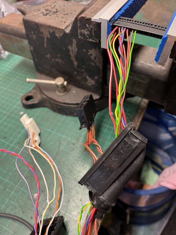

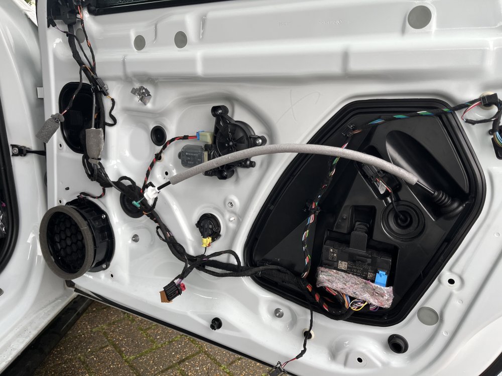

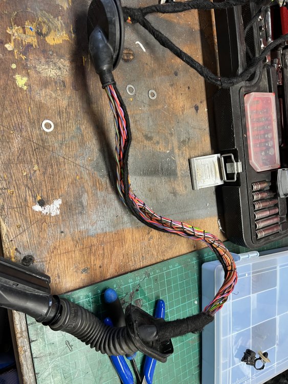

So today i had a spare few hours so i started on the passenger door. The plan is to run all the wires in all 4 doors and the tailgate, that means when it comes to doing the big strip out, ill of saved a massive amount of time.
What was carried out? Well, first is to strip out the front door so door card off, speaker out, all covers off and remove the complete wiring assembly as one.
Now the wiring was out i had to strip all the insulation from between the 2 gasket sections to allow the new wires to be ran.
IMG_9363.thumb.JPEG.f99d2dd4a0881e24bfaa308151c9adf2.JPEGIMG_9361.thumb.JPEG.a7efc40c58e6171a87eb2586de1462e5.JPEG
The wires then all need to be moved from the 27 pin to the 25 pin, and add the LVDS cable. This took a long time, and 4 of the wires needed their pins changing to MCON 1.2 pins from the previous MCP 2.8mm pins.
As you can see, the actual housing for the connector is different as well, this is to allow the LVDS cable more room, Part numbers in the pictures :)
IMG_9366.thumb.JPEG.868ea44b176c0e71dc3e80016a7f7823.JPEGIMG_9370.thumb.JPEG.e806fb424b10e1e685ec7022a0a3ebd1.JPEGIMG_9369.thumb.JPEG.686f5b74d639092cc19e626bcc09d8f7.JPEGIMG_9368.thumb.JPEG.7b13ee7b05d4c05595b7b1465af7d778.JPEGIMG_9367.thumb.JPEG.984e6f36216284392e4d5bda316ae252.JPEG
Note: The post above with the excel spreadsheet of wiring covered everything, except 2 things of note - the wiring sometimes changes colour across the plug, and also the original 27 pin connector had a red/white wire on pin 12 that I simply moved to pin 12 of the new plug that i didnt account for in my post above.

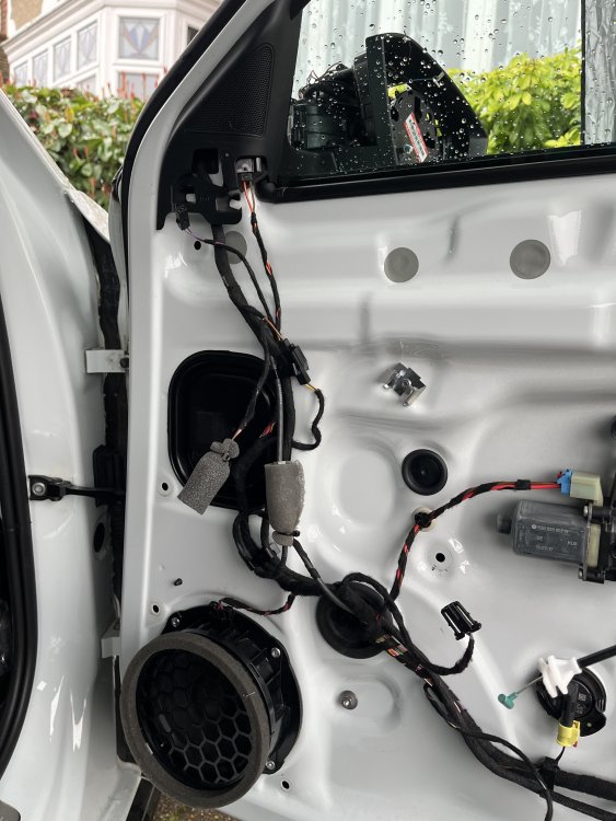

Once this was done, the loom was refitted to the car and then the same process was repeated on the car side, this was a bit more of a squeeze working in the passenger footwell.
IMG_9376.thumb.JPEG.55ad458b8551b911f671d0c25f18c331.JPEGIMG_9375.thumb.JPEG.fb7db2f068b5cbd98657433aca940f80.JPEGIMG_9374.thumb.JPEG.c2f9cf04da8e9ad9c5abda3876ed82a8.JPEG
All moved from the black connector to the new white connector, the LVDS cable which is 4m long was then coiled up inside the car behind the trim and all was boxed back up.

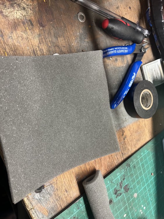

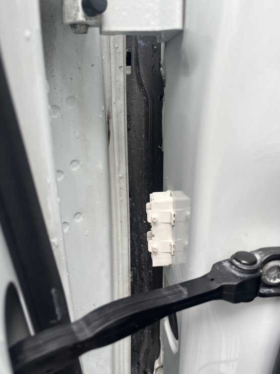

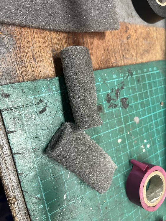

To add to the OE feel and to also reduce vibrations in the door, I didnt want the LVDS connector to rattle around where it connects to the mirror and the OE solution to this is a foam sock that goes over the connector to prevent vibration and noise. This cant be purchased from Skoda so i had to make my own.
4mm Open cell foam sheet is the solution, rolled up into a tube and glued together with superglue to make my own socks. These were then slid over the connector and cable tied in place, exactly how the rest of the door connectors are done.
IMG_9372.thumb.JPEG.753face78a45bdd441d617fa0c2b3c4d.JPEGIMG_9371.thumb.JPEG.ea1c728972b162d98785317be5744b97.JPEG
The other option for securing the LVDS connector is this holder 7P6937545 which looks like this: 2012-2022 AUDI VOLKSWAGEN PASSAT Genuine Wire Harness Bracket 7P6937545 OEM  🚗 | eBay Or 1K8937545 could be used (but that only fits a elongated hole that isnt common).
But this also needs one of the mounting method (6mm hole or sheet metal edge) holders to connect the 2 together. 8Z0971848F is the 6mm hole mount, 3B0919136A is the sheet metal edge mount.
Then it started to rain so i had to quickly box it all up and forgot to get photos of the inside of the door and plus this side alone took me around 4/5 hours. When I do the drivers side and boot lid ill get the extra photos.

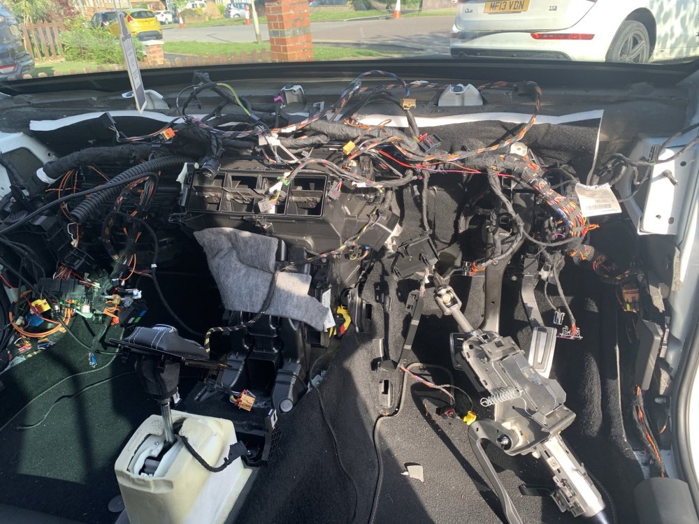

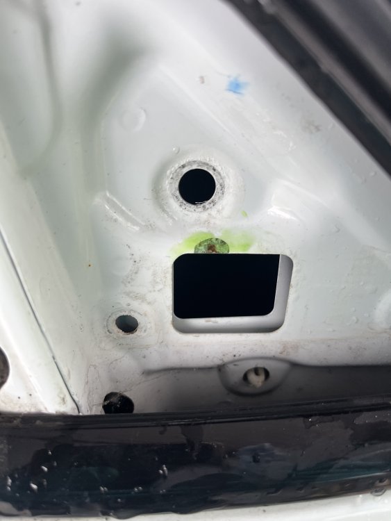

I wanted the 3 zone climate control
IMG_3996.thumb.JPEG.fbe348e8e65d810702296abc49430d9c.JPEGIMG_3999.thumb.JPEG.9c92be5ac65880a824e9be168ca0e696.JPEG
Its all going to be coming out again soon for the rest of the fittings.
The camera mount I created was no good - but the joys of 3D printing is i can just start again
The hole for the camera was too big, the entire body is too big to fit in the honeycomb, so ive had to start from scratch with a 3 piece design and bond them all together. Hopefully it works better this time.

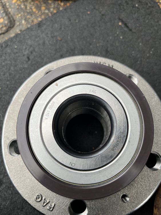

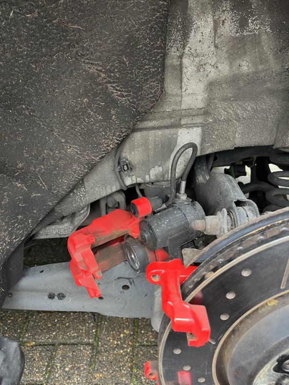

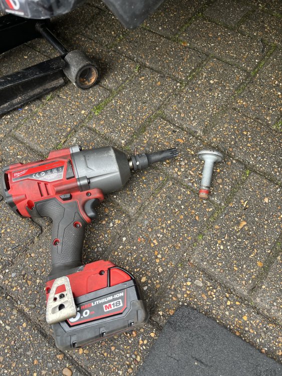

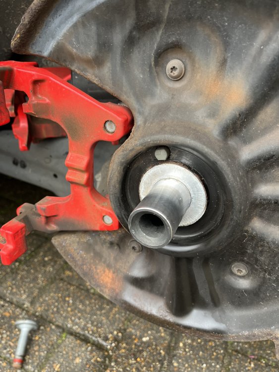

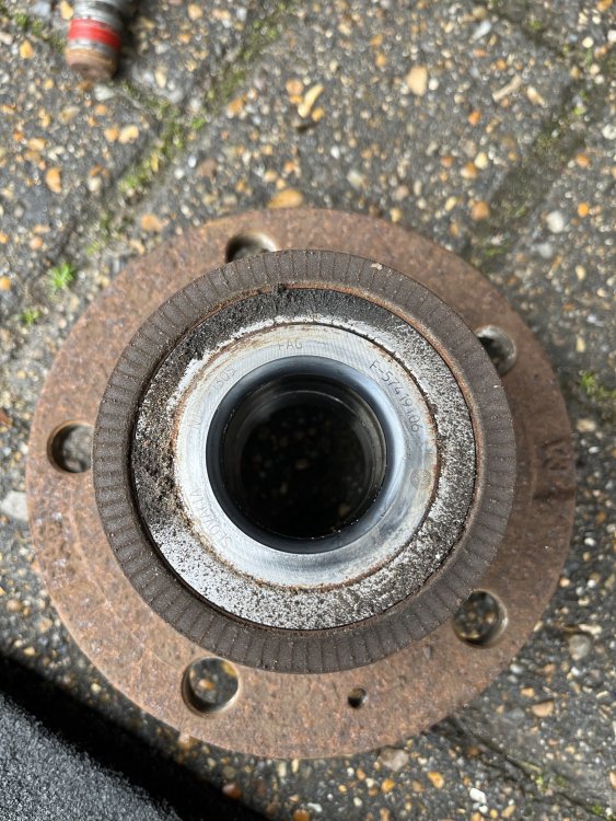

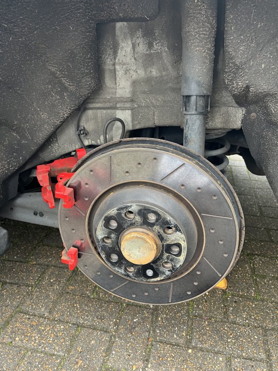

I then had the wheel bearing to sort out, nearside rear wheel bearing needed replacing, the genuine bearing is priced at £200 and made by FAG. A FAG bearing cost me £40. (Same part numbers on the bearing, OE is made in CZ, Aftermarket is CN)
Replacing is fairly straight forward, release the handbrake to service mode, remove the caliper, remove the torx screw on the disc and slide it out from the carrier body and undo the centre hub bolt.
Replace the bearing and make sure all surfaces are clean and dry (Dont oil them! You dont want the inner race to spin, thats what the bearing is for!), the bolt is torqued to 200Nm + 90 degree if its a silver bolt, or 180 degree if its the older black bolt.
IMG_9470.thumb.JPEG.3b4f0a3949be23c139d8598533cd84f0.JPEGIMG_9468.thumb.JPEG.6ce934755eb69585cacb631dd06fa7b0.JPEGIMG_9467.thumb.JPEG.9bb542b2641ecb5360f9f838a5b97028.JPEGIMG_9474.thumb.JPEG.152c9a59f2b158f5d90fe45a005757cb.JPEGIMG_9473.thumb.JPEG.08ed9d4a4900e4a8d7d86cc206b2066e.JPEGIMG_9472.thumb.JPEG.db975e1d46e7a55dd2bb4b43689da9eb.JPEG
