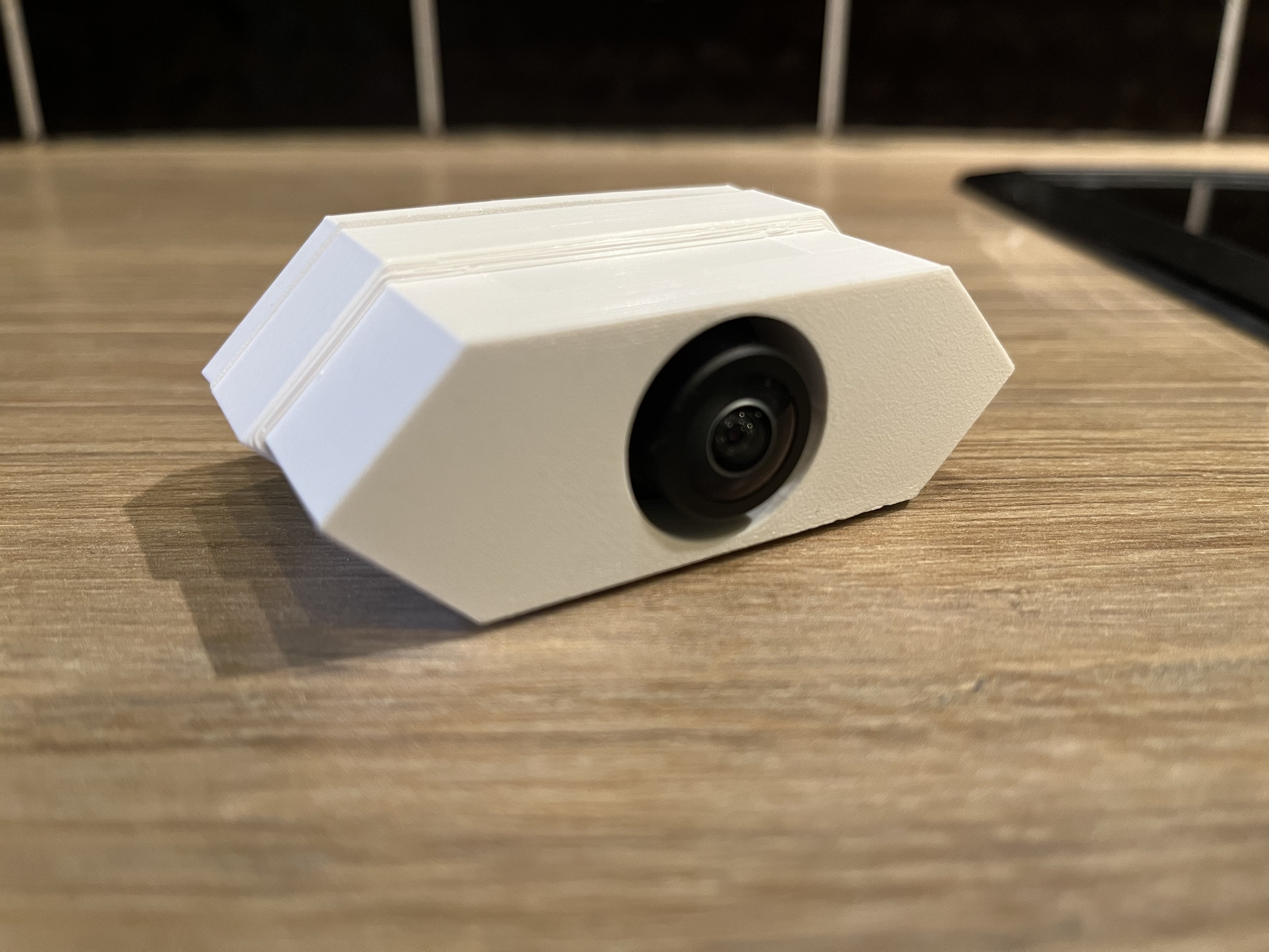

The camera mount I created was no good - but the joys of 3D printing is i can just start again
The hole for the camera was too big, the entire body is too big to fit in the honeycomb, so ive had to start from scratch with a 3 piece design and bond them all together. Hopefully it works better this time.
