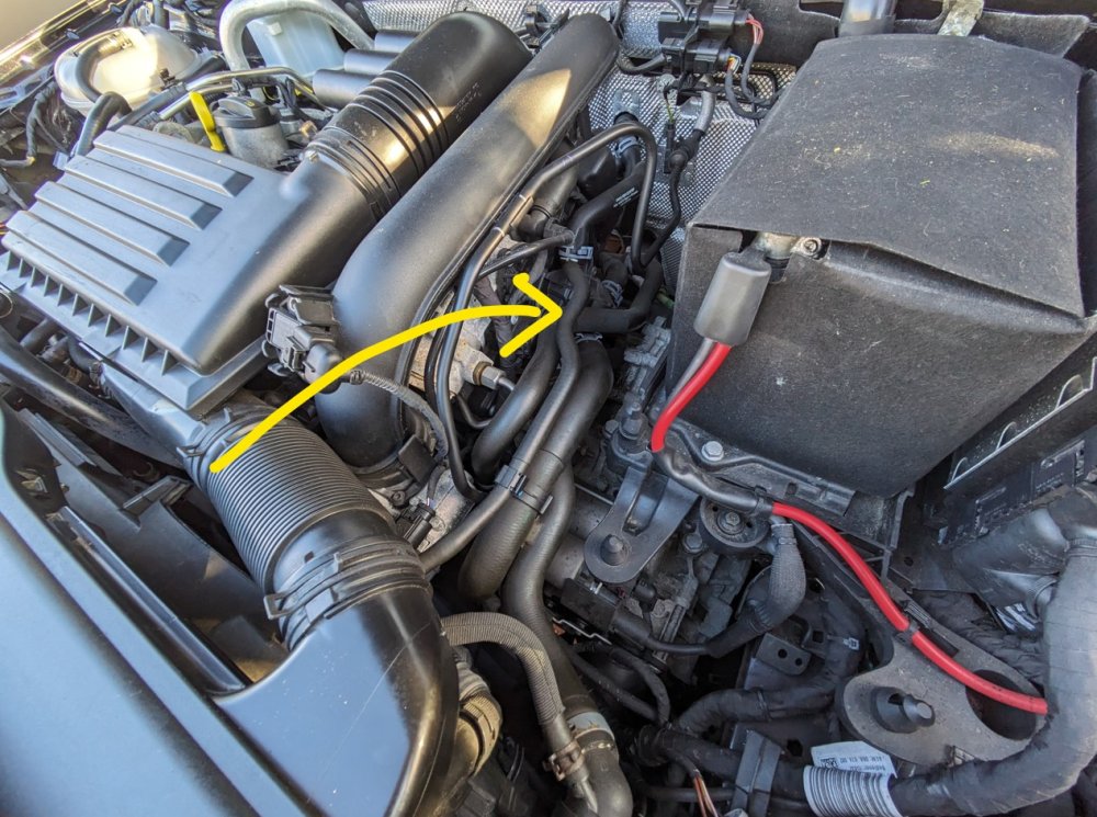

I've been loosing a bit of coolant all of a sudden and it looks like I've got a leak from the coolant pump housing.  This lives on the right hand side of the engine. Mine is the 1.4 TSI 103 KW CHPA unit,

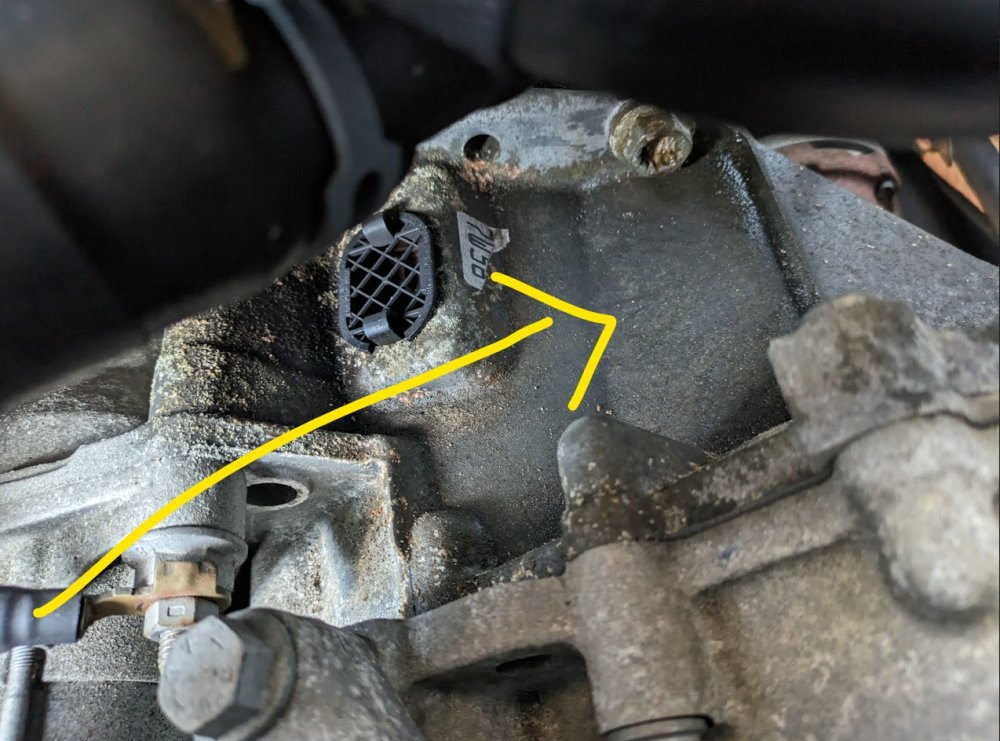

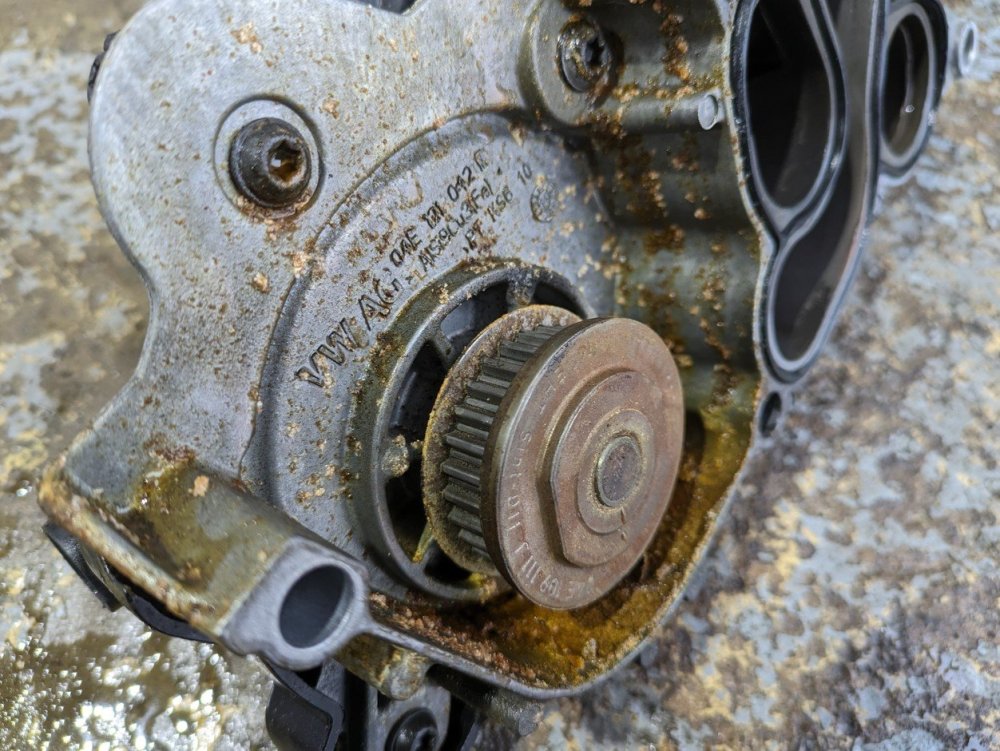

Picture 1 shows the location of pump, picture 2 shows where the coolant collects (handy in a recess - though I've mopped this up) and picture 3 shows where the coolant is dripping from.

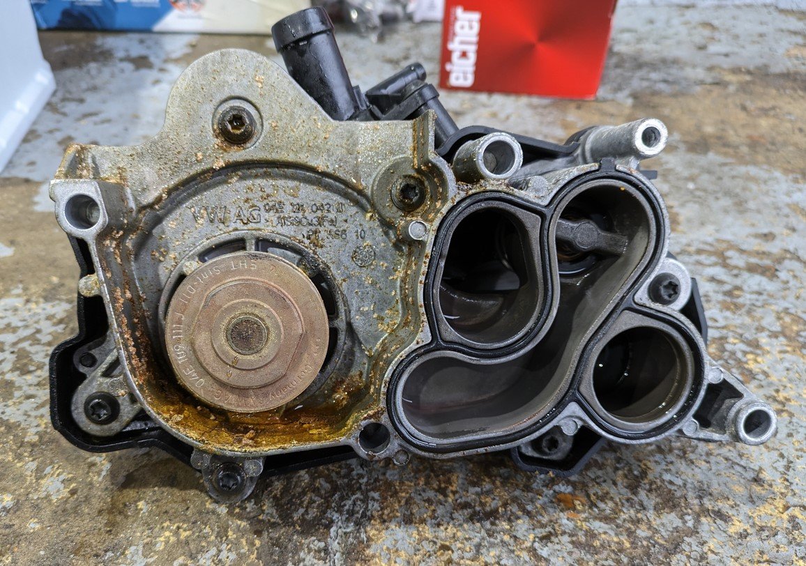

I fitted a new water pump to mine last year for pretty much the same leak. I fitted a new genuine Skoda water pump which is the whole thing including thermostats and housing. I paid £243.80 inc vat for the pump, belt and 5 litres of premixed coolant. You can buy just the pump part from motor factors but I decided it was better to just change the whole thing as it all has to come off anyway.
It isn’t too bad of a job which took me about 2 hours. You have to remove the battery and battery tray and air intake pipe to the turbo to get access and you need to use a torque wrench to put the correct tension on the belt.
couple of pics from when it was apart, 3rd photo is the old pump with the belt cover removed ;

Mine is on 34k but is a 2014 model so guess its the issue of having a plastic pump assembly on a metal block which shows the weakness - the heating and cooling cycles perhaps.
The actual pump part is alloy. Once I got it off I could see it was actually leaking from the impeller seal and then running along and appearing more or less where yours is.
Cheers for the pictures too Classic. Nice to see the beast and compare with a new unit.

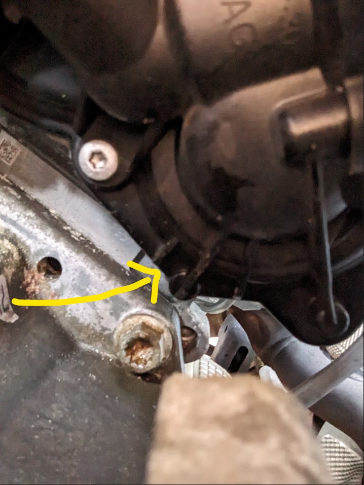

Just as a follow up - pump replaced by the local indi VAG garage so fingers crossed tis all good.
The old one looks pretty hideous - car has 35k on it and it looks like its been leaking for a while!
Classic was correct, leaking from the impeller seal.
