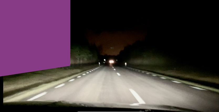

I'm sure the matrix mapping is wrong for UK motorways and dual carriageways;
It blocks out the left hand side (shown in purple) rather then the right hand side - which I would expect it to do, so that even if car light are obscured by the central barrier, they would not get blinded...
Edited by MARViN2003
That's exactly what's happening yet nor one person in skoda is acknowledging that issue
FL 2023, RHD, left side of road here.
I have coded my HBA to be on as set when the car was switched off, so on most of the time even when driving on UK motorways. I never get flashed at by oncoming traffic on the right. The car is set to RHD in the menu.
In STG 4B there is a setting for "motorway light" which has always been set to active. Another setting "Highway light" cannot be set. If you do you just get errors.
When we went into France I set the light to right hand traffic, driving on right. On motorways even when there is no discernible barrier in the middle and I can see the lights of oncoming traffic I frequently get flashed by the traffic on the left of me and turn the auto HBA off. I have not really tried to drive in France with the car set to left hand traffic thinking that the settings have to be correct. Next time I might try keeping the lights set to left hand traffic. Unfortunately I cannot change this when driving. The car has to stationary to do the change.
