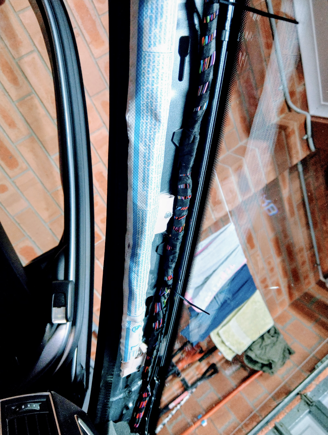

I hope they are not ran across the width of the A pillar in any place as this can cover and obstruct the airbag and there is a chance if it was to deploy, it may not deploy properly.
Pet peeve when people (including garages and halfords) do this!
Not saying it will cause issues, but if your airbags are deploying, youd want them to deploy with no wires wrapped around them
To me, a safe way to route the wire (or video cable if a dual dashcam) along A-pillar is to remove the trim and then to fix the wire/cable to existing harnesses with tie wraps.
This way it can't cause an issue if airbag needs to deploy.
+1 to remove the A-pillar trim and run the dashcam wiring along the existing wiring loom.
It is easy to tuck it under the A-pillar trim and just run it down to the side of the glovebox fuse panel, but that will likely fowl the curtain airbags from deploying properly.
The A-pillar trim is a pain in the behind to get back in but it's the proper method.
This is mine, in the process of cable tieing the dashcam wiring to the existing wiring loom next to the windscreen, away from the airbag (white).
