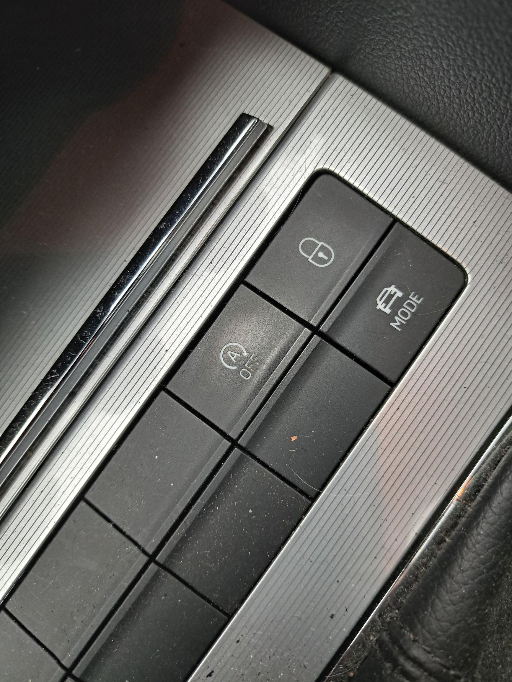

Welcome to the forum cobber. Battery adaptation (coding) depends on whether or not your new vehicle is fitted with micro-hybrid energy recuperation - does it have automatic idle stop (stop-start)?
Edited by Warrior193
typo
Ok, I'll have to check for that. There was no engine cut out when stopped at lights on the test drive or the drive home so guessing that it doesn't.
Well, there is no start/stop button in the car so guessing I don't have it.
Hello, see the attached image below for the automatic idle stop button - if your new vehicle doesn't have this button somewhere on the instrument panel1979038293_skodaautomaticidlestopbutton.thumb.jpg.964d6ab56ee45bb5b49afce29cb19361.jpg, it's probably not a micro-hybrid - in which case, you don't need to carry out any adaptation when fitting a replacement battery and you don't require an EFB or AGM type.
Yeah, no start-stop button in the car or the manual. No coding for me 🙂

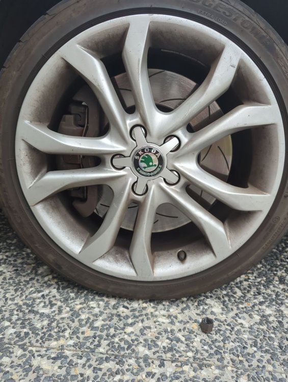

Finally found the right hub covers for the alloys I purchased.
I knew I needed new alloys from the start as (see pics above) they were totaled and at at least $250 (around 125ukp) a piece to repair and then the near $1000 (500ukp) for the tyres, the budget didn't quite stretch to cover all of that so I went hunting on Facebook and other local selling sites for alloys that would fit.
Found some (the one's on the car atm) for $400 (200ukp) with Bridgestone Potenza RE003's on them that had around 6-7mm of tread on them so enough to pass the roadworthy inspection. I had no hub caps though.
Not thinking it through I just went and ordered some cheap things from Aliexpress thinking they would fit and of course they were too small. Measured the gap and ordered some more - too big this time. So I gave up initially and then realised that these alloy's were never sold on a Skoda so went hunting for the right car and thanks to Google Lens I found it - Audi S3. Once I found the right part number I ordered some BUT they would have either an Audi or VW badge on them. Thought ah well, just get the Audi one's and get some stick on Skoda badges and see if they will cover them. Well, they did once I removed the Audi symbol from the hub cover.
Don't look too bad I reckon
