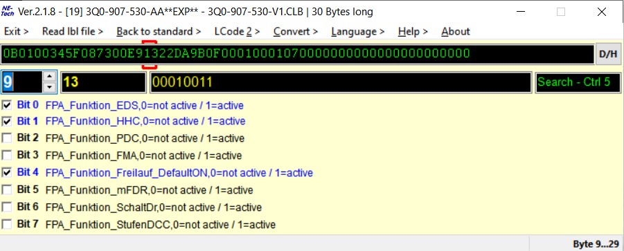

Disable coasting
Finally found a solution to the pita.
19 CAN Gateway, long coding.
Byte 9, untick bit 4.
(may vary on different models, but the bit name is always the same.
