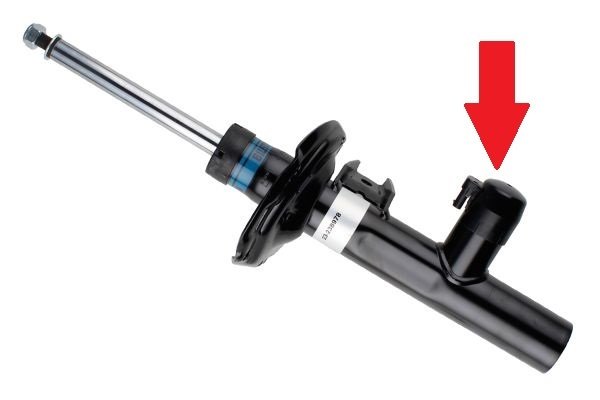

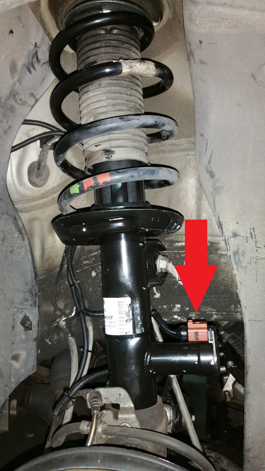

visually, u can physically have a look at the shock absorber to see if there is protruding small cylinder bit, as shown by the red arrow in the pics below.
if it does, u have DCC.
if it doesn't, u don't have DCC
DCCshock.thumb.jpg.dce2ee29bc0df82f862e190e22d4dc7f.jpg  DCCShock2.jpg.df4b4963560dd55704dd3bef48036490.jpg

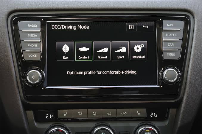

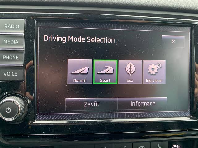

via the MIB unit - without DCC
via the MIB unit - with DCC
thank you @JR RS,  that picture without the DCC is what i have. I'll do the visual check as well.  I know there's lots of good info on here to help decide on which shocks to get now.
