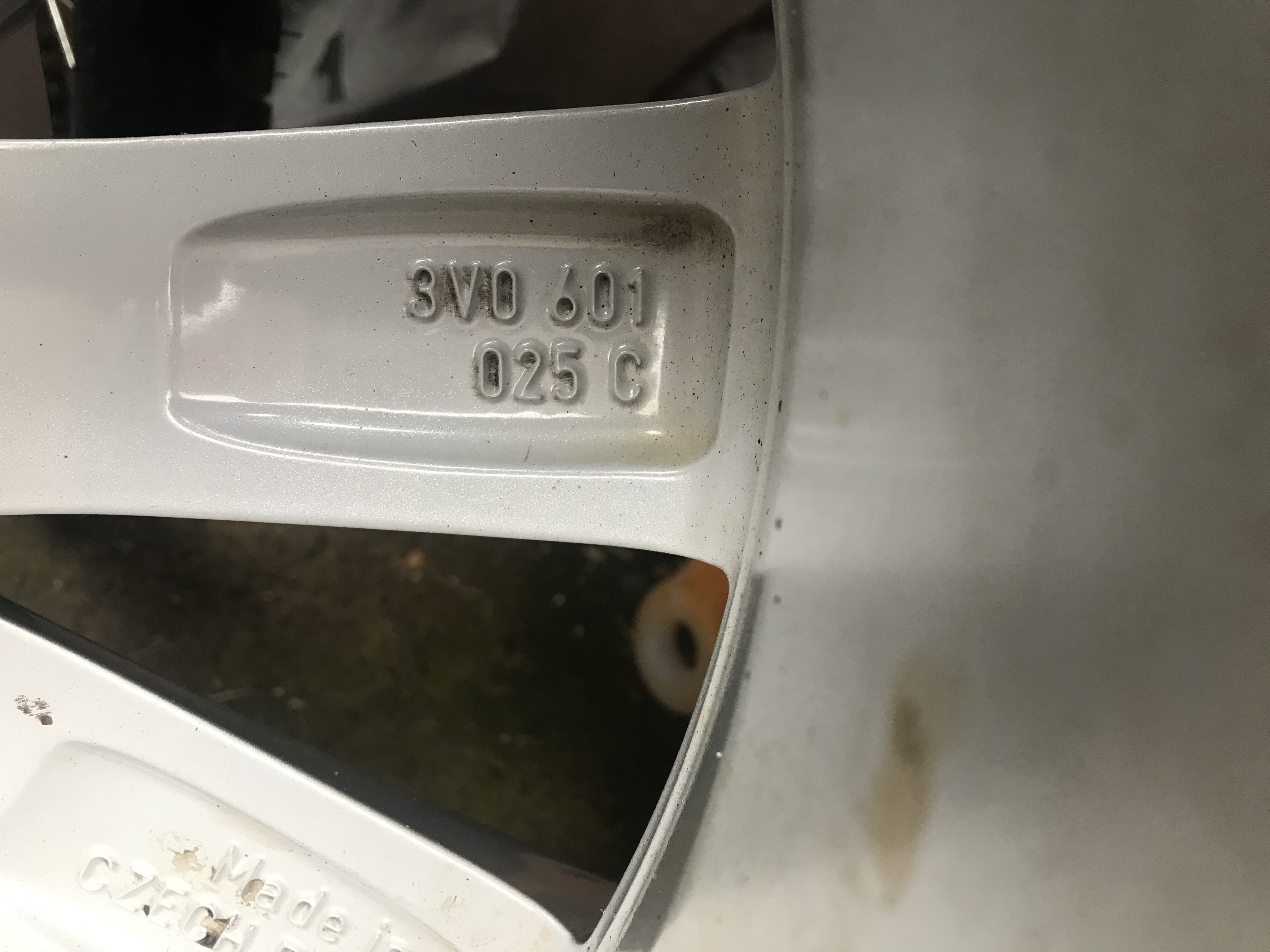

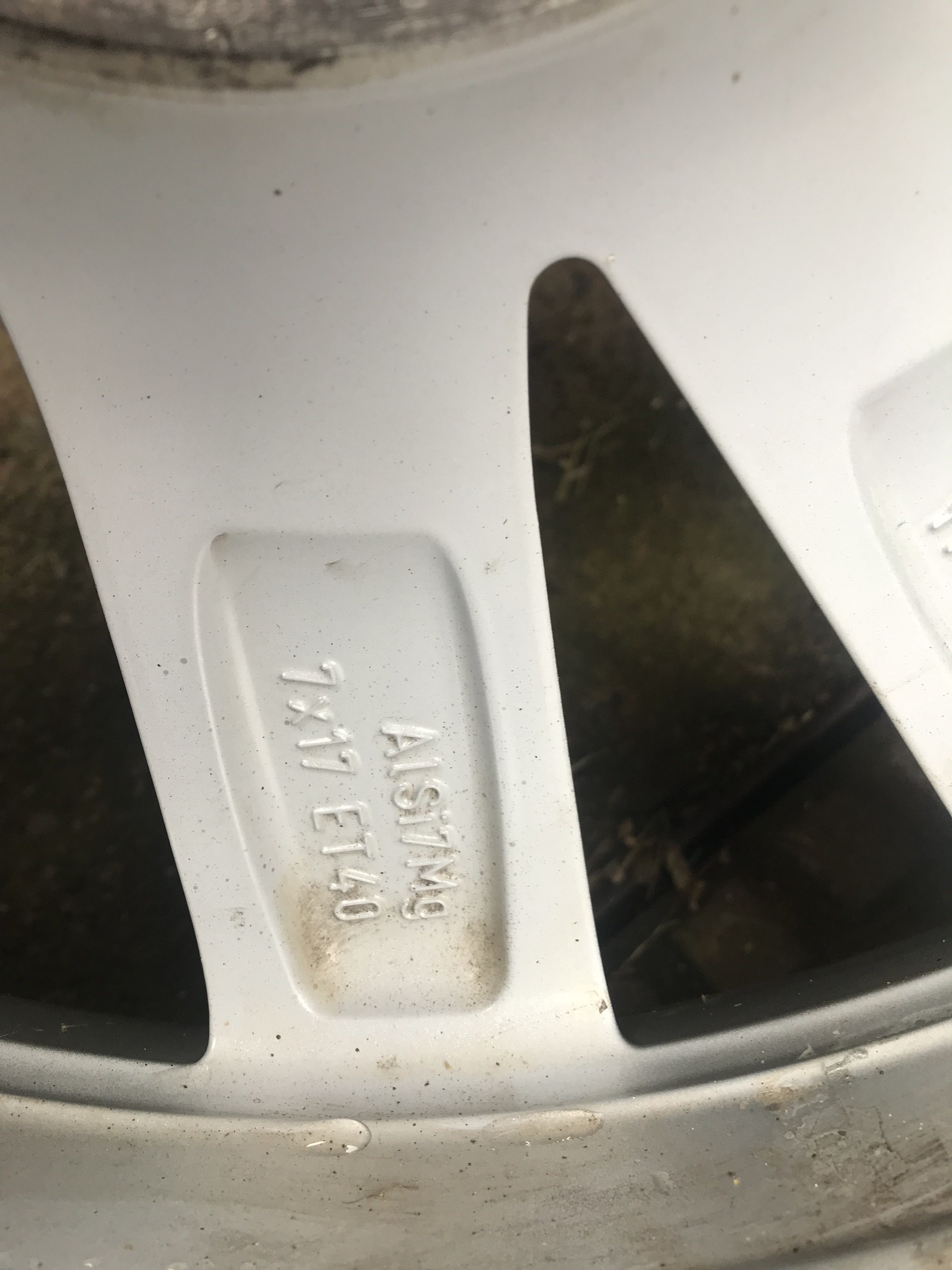

I suggest 17 inch wheels with 215/55 tyres are a good compromise - as fitted to the SE model as standard.
Those on mine were made by Ronal ( HQ in Switzerland) specifically for Skoda- both logos are cast into the rear of the wheel.
(Not so long ago there were 4 of these with nearly new Uniroyal rainsport5 tyres on eBay for just over £800).   I managed to find 2 a few years ago for about £80 each to use with winter tyres.  New cost is about/ just over  £200 each from dealers I believe. Part no. and size attached in case you want to follow up.
