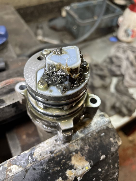

The Haldex will only engage (subject to a few other points which are not relevant atm) when slip is sensed in either of the front wheels. The ORB does NOT turn it on; it is on all the time just not engaged. And as soon as you reduce power it dis-engages.
Get a fault code read done. Common failure is the pump reporting back as failed but a new pump often does not work because the ECU is water damaged. Getting a Gen 4 ECU off is often a sketch as the lower M4 screw rots in the case and easily snaps off flush. Getting the broken piece out is very tricky as there is no inline access so I get a specialist to come out and remove it. We always fit a new pump anyway and replace the filter (which VAG refuse to admit is there). The important point is to throughly blow the system out with brake cleaner and compressed air as it gets full of disgusting goo.
