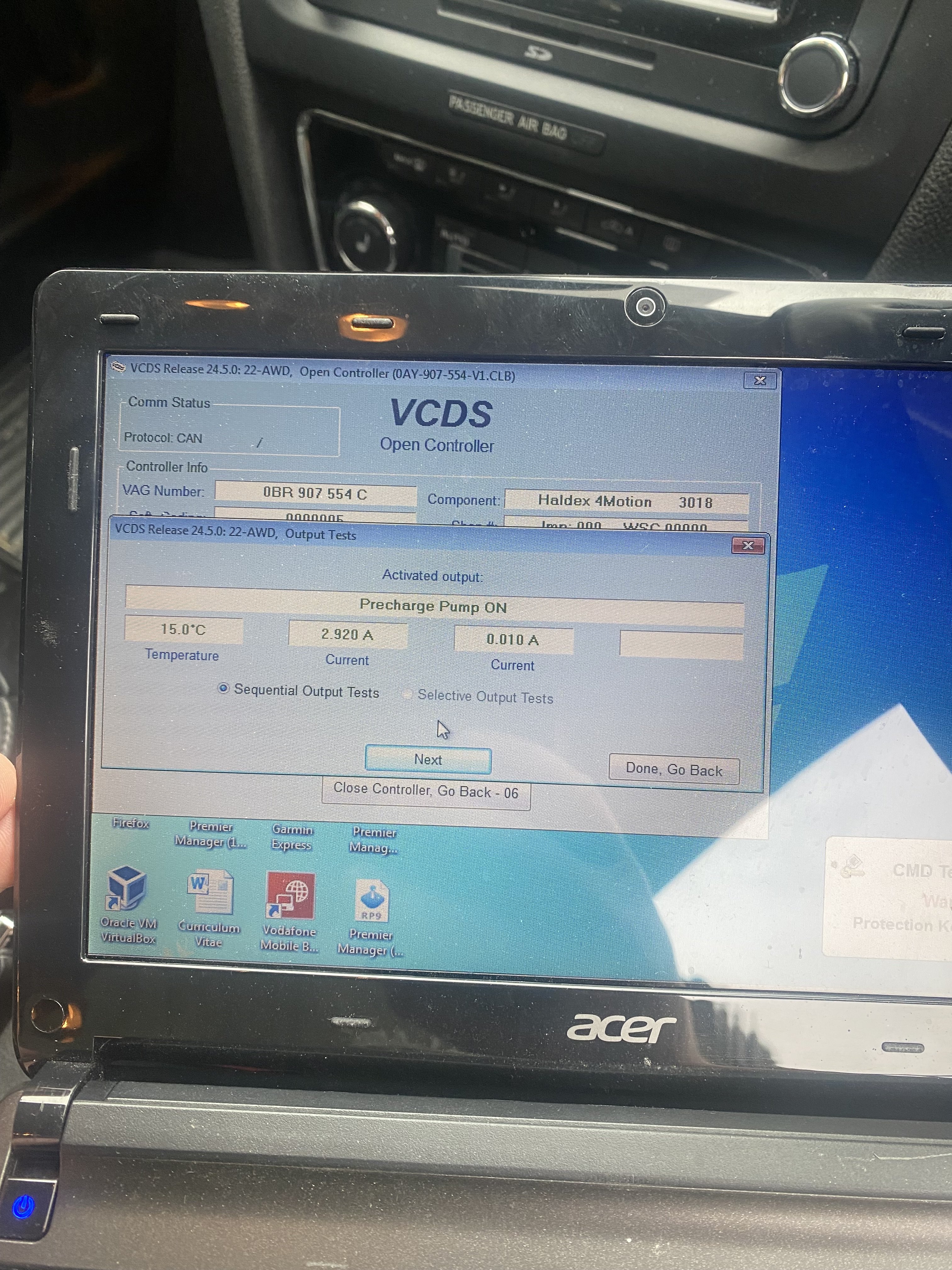

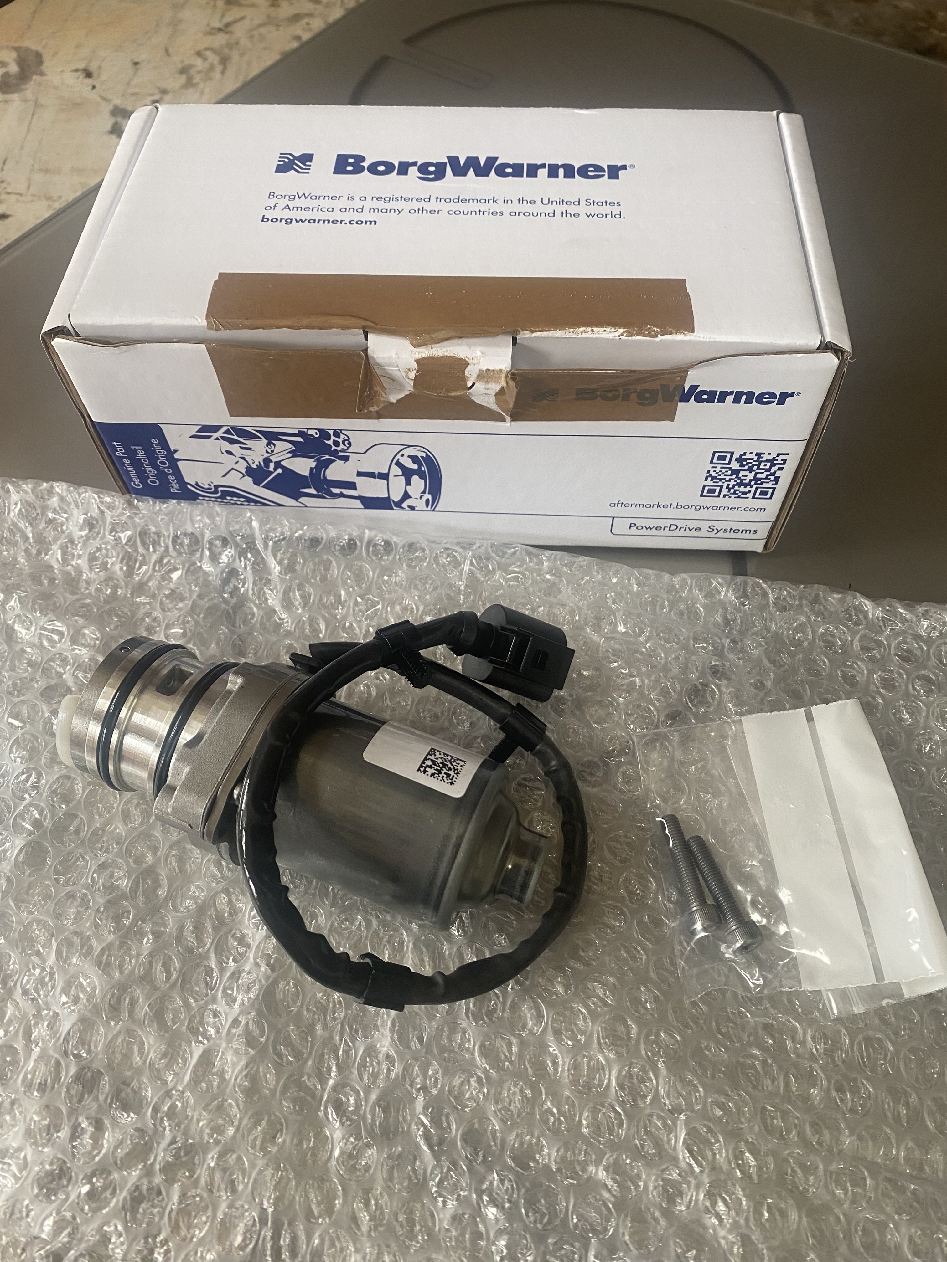

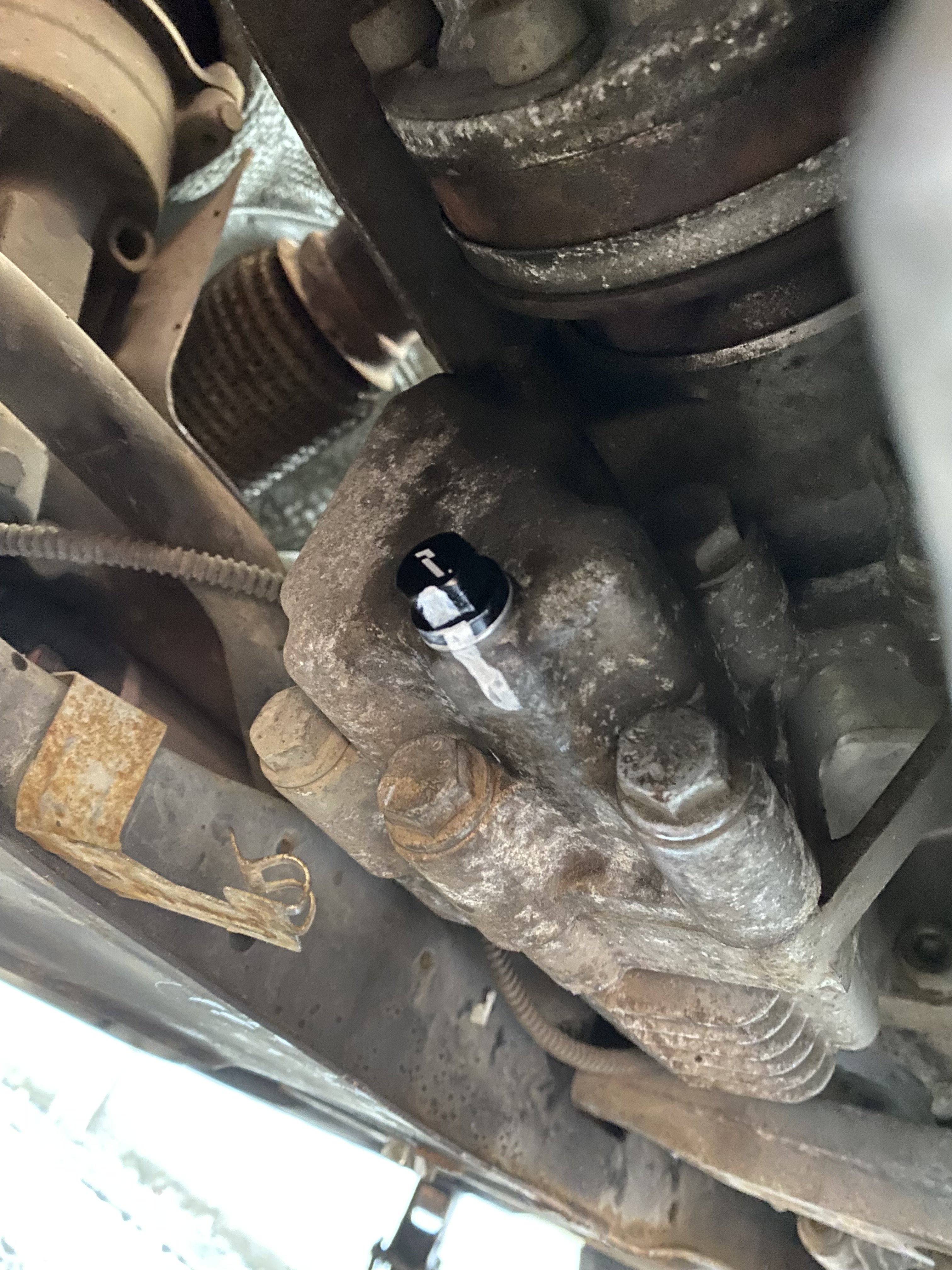

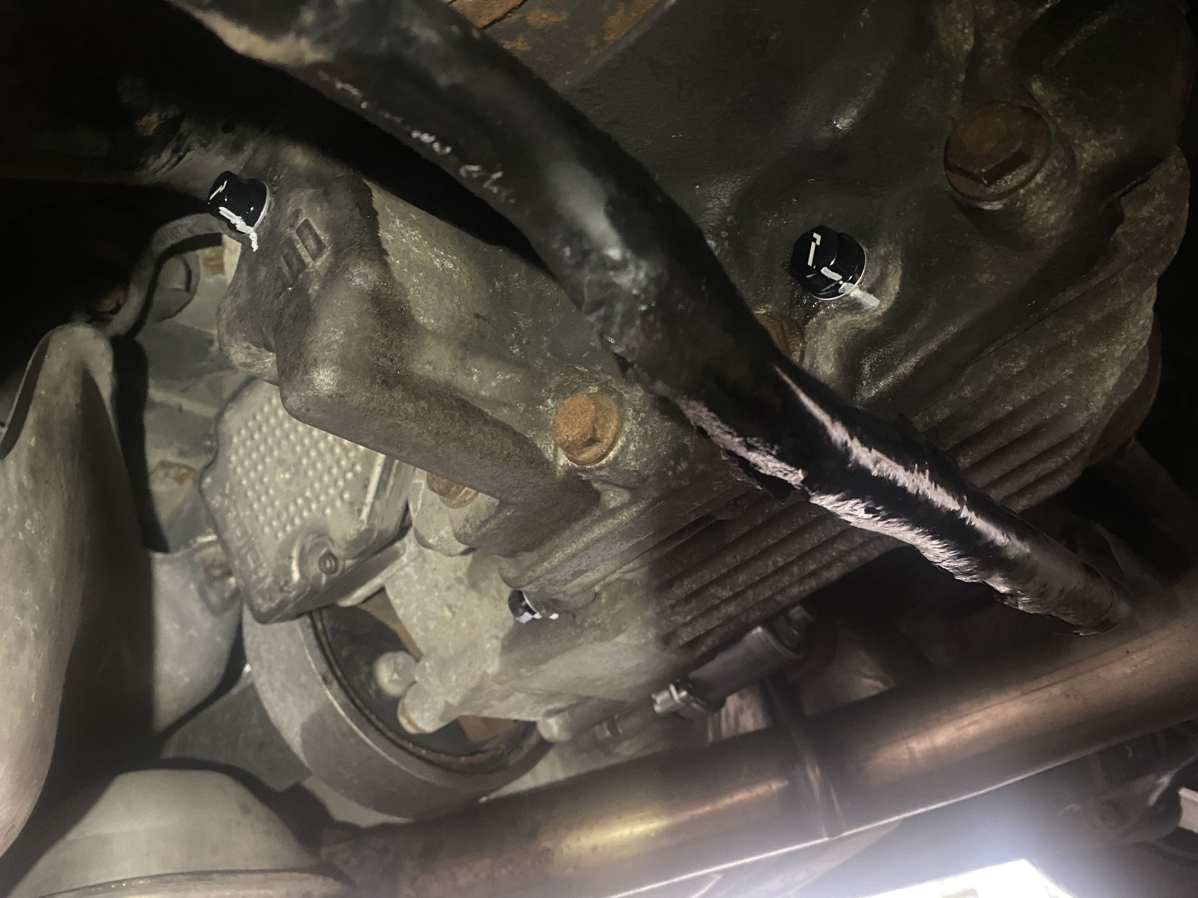

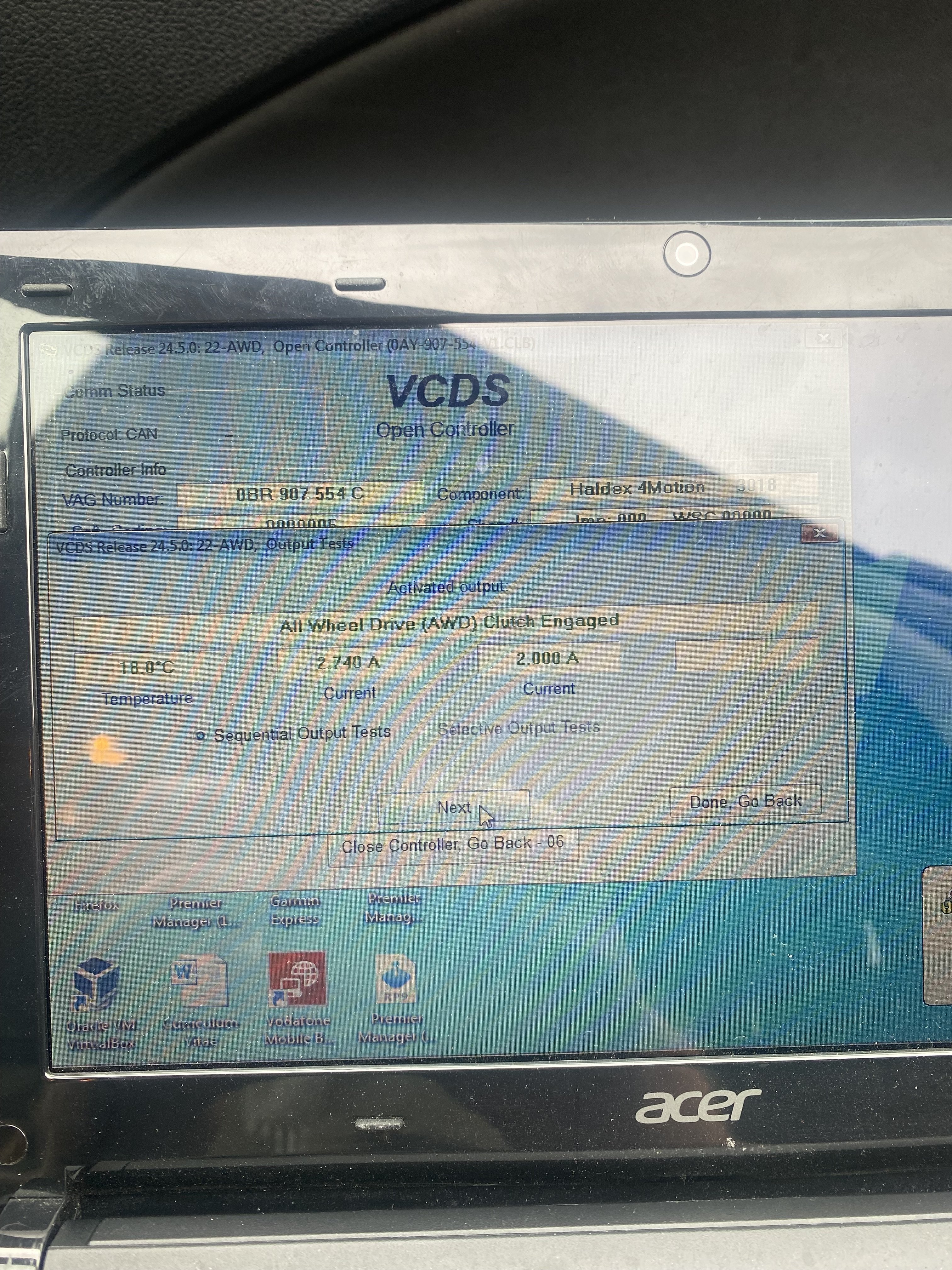

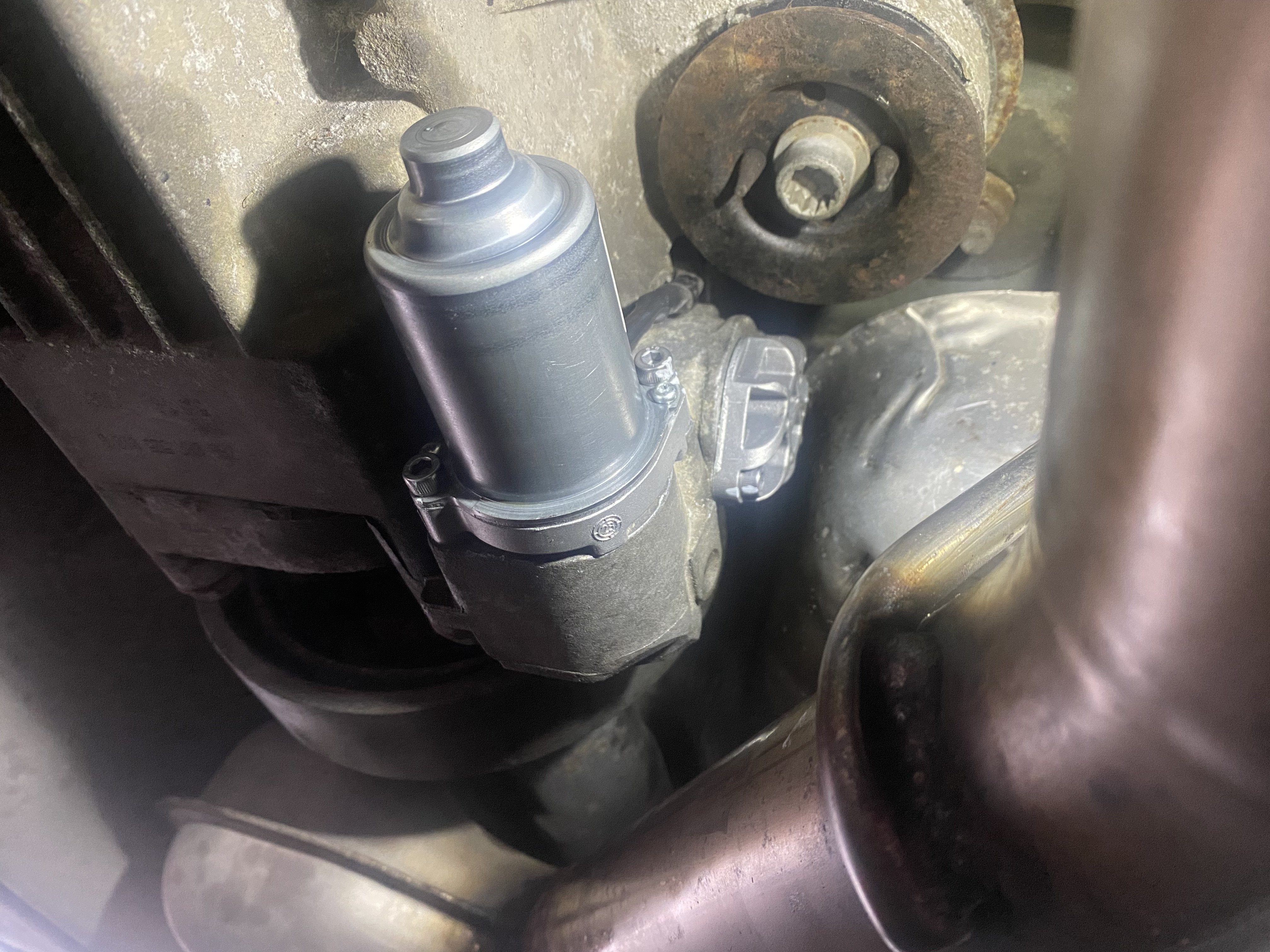

New haldex pump fitted along with new filter, next day delivery from Haldex repairs very good service.
Primed up with vcds and managed to get the full spec 850ml in from empty.
Also changed the rear diff oil while I was there and fitted some more racingline plugs for both the Haldex and rear diff with magnetic drains.
Glad I can do all this stuff myself god know what it would have cost at a Garage 😀

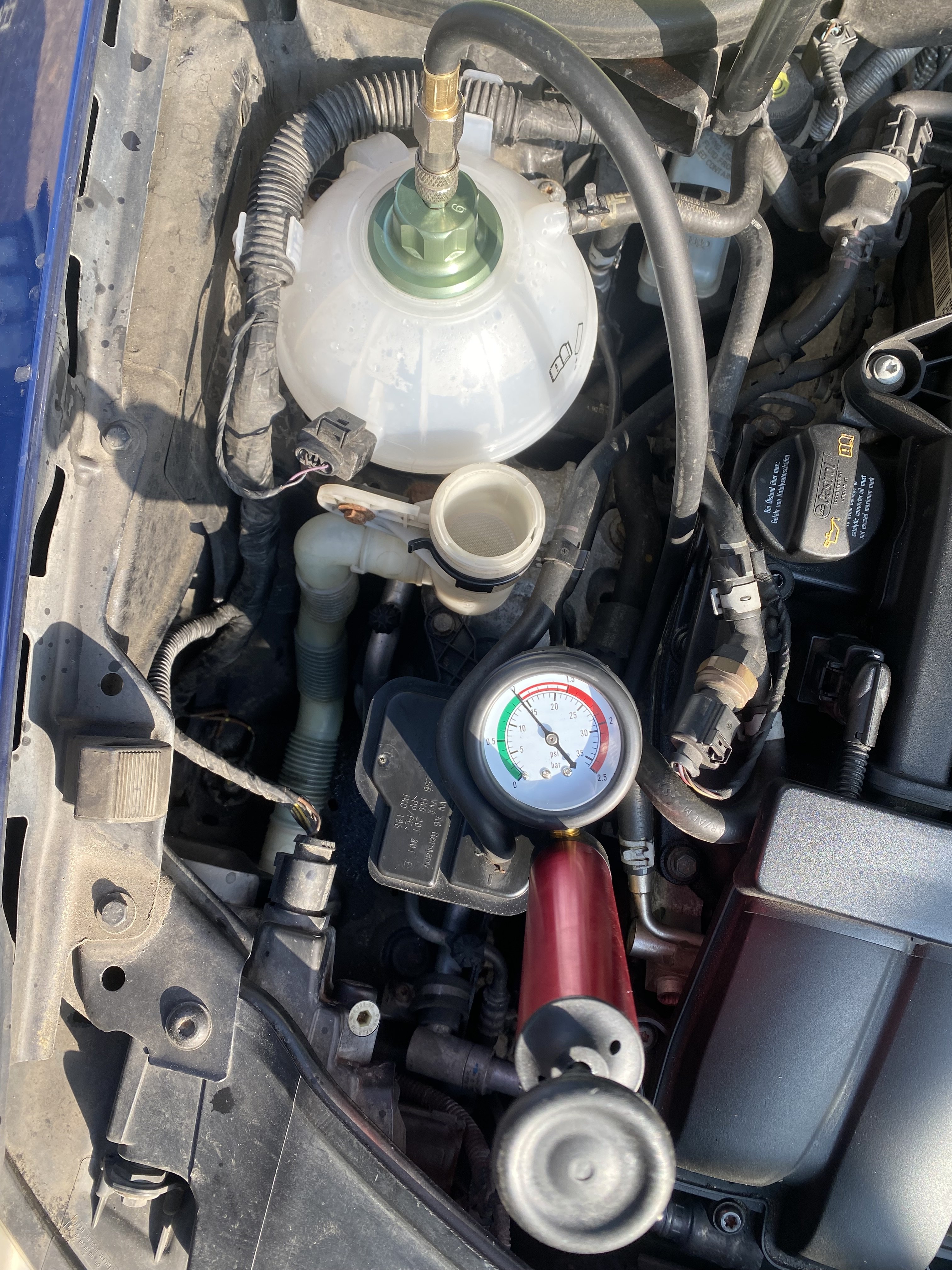

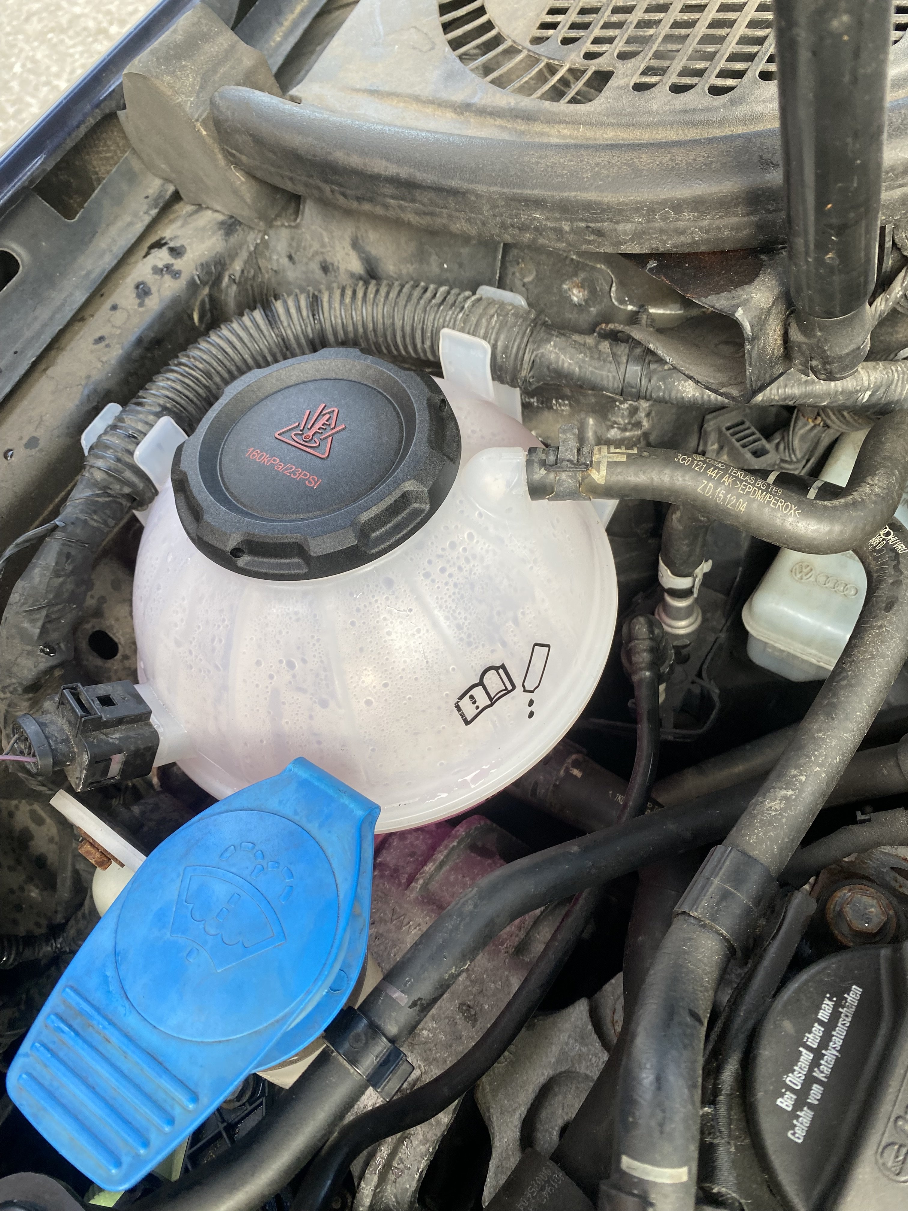

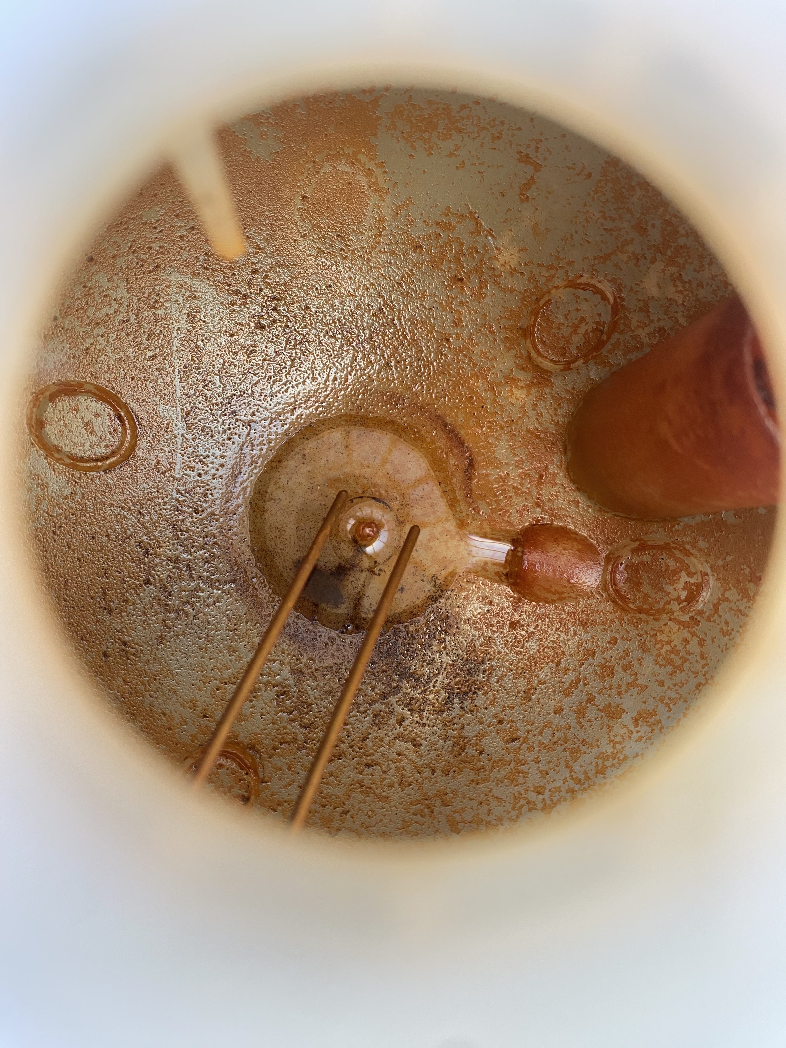

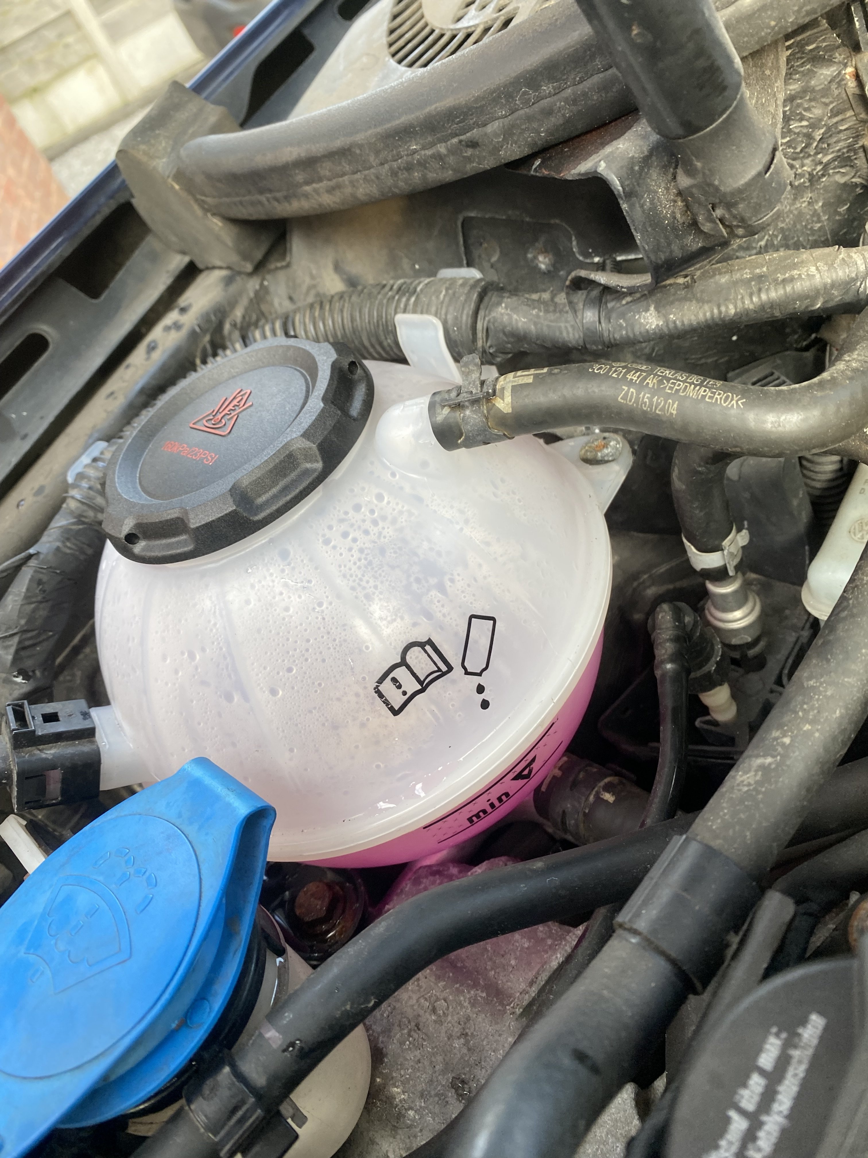

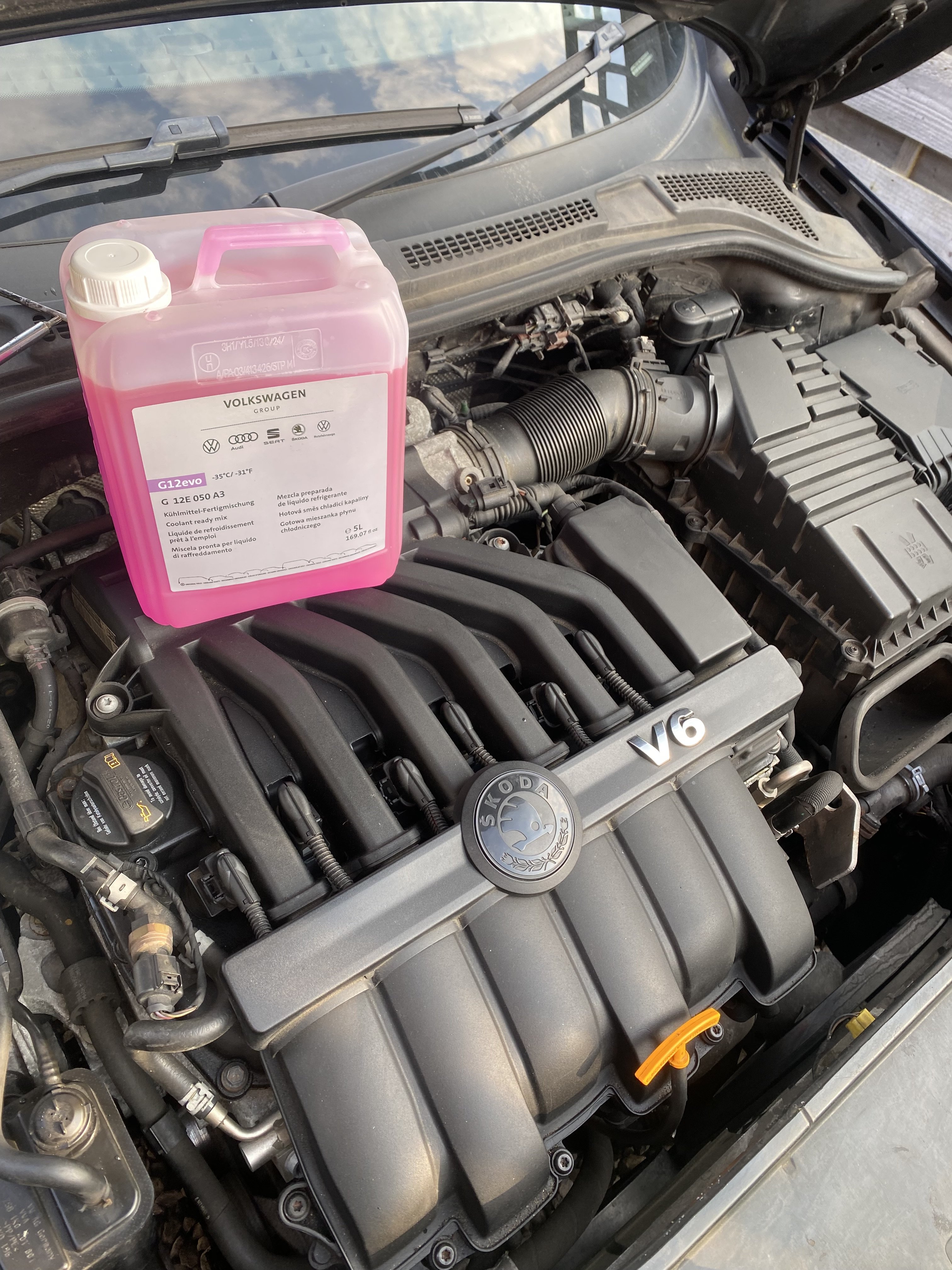

  • Coolant leak sorted and flushed through, filled up and drained pretty much All day, till I got pure water coming out, took forever but I like to be thorough, now have some lovely genuine g12+ pink coo

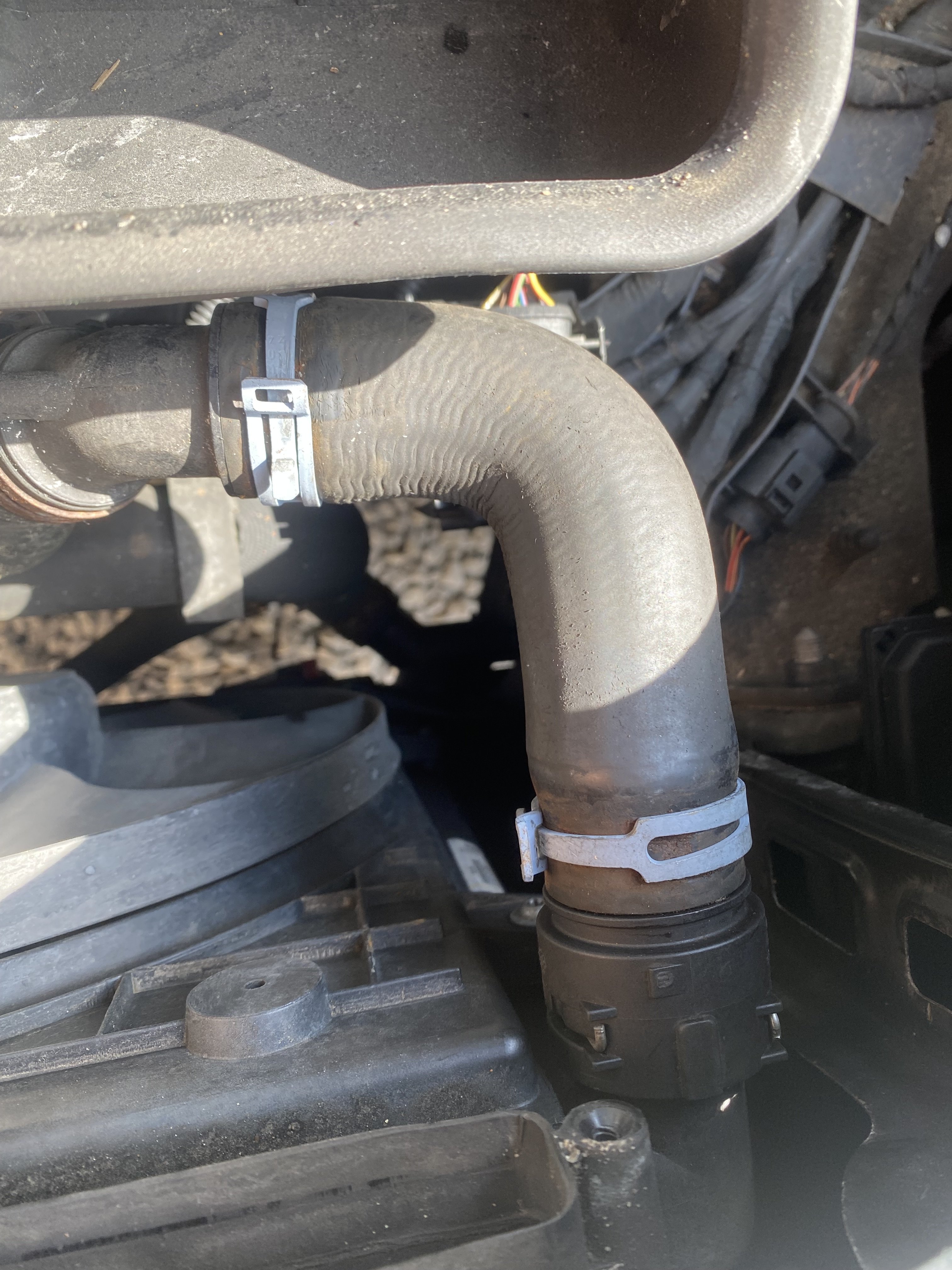

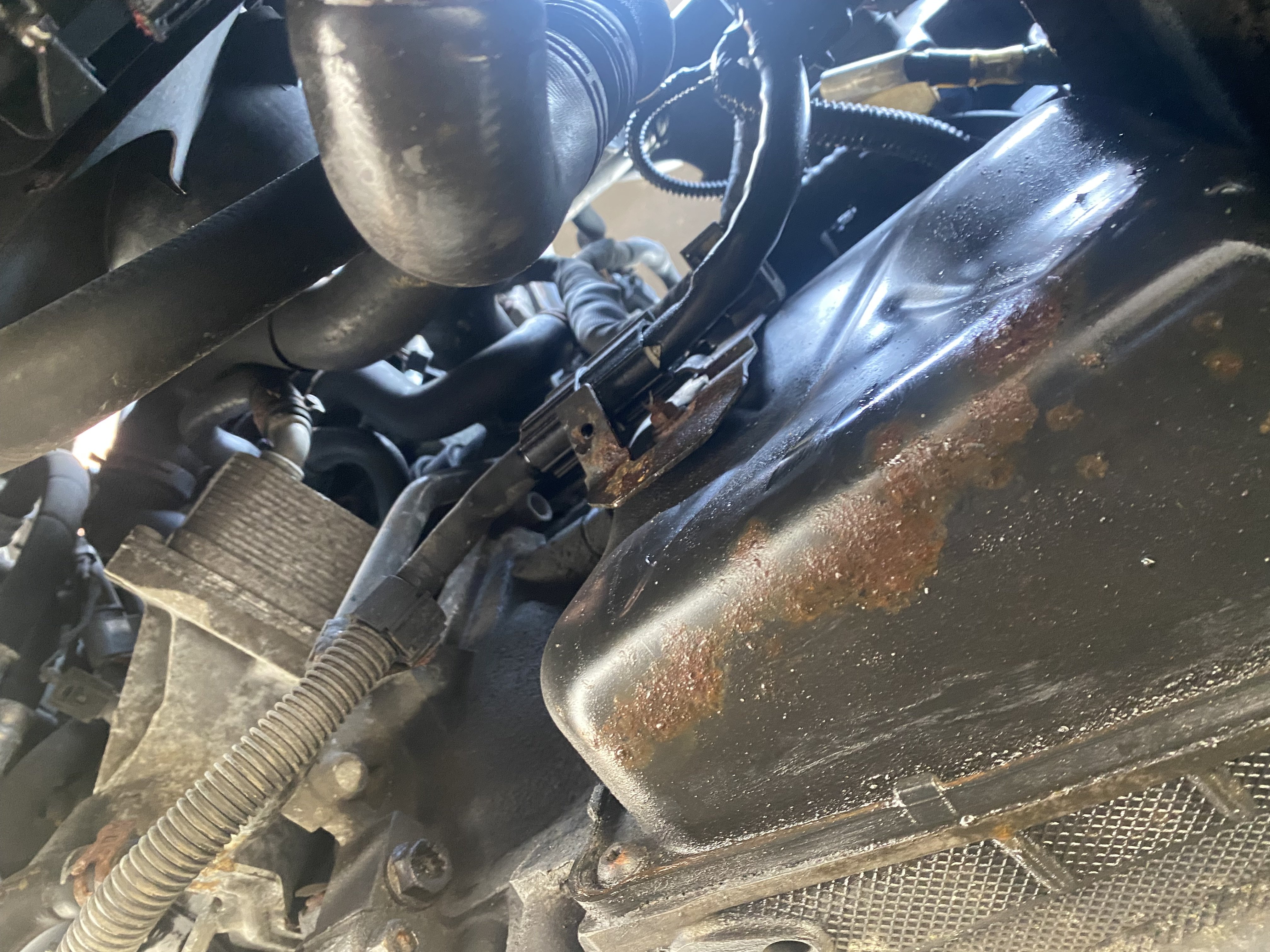

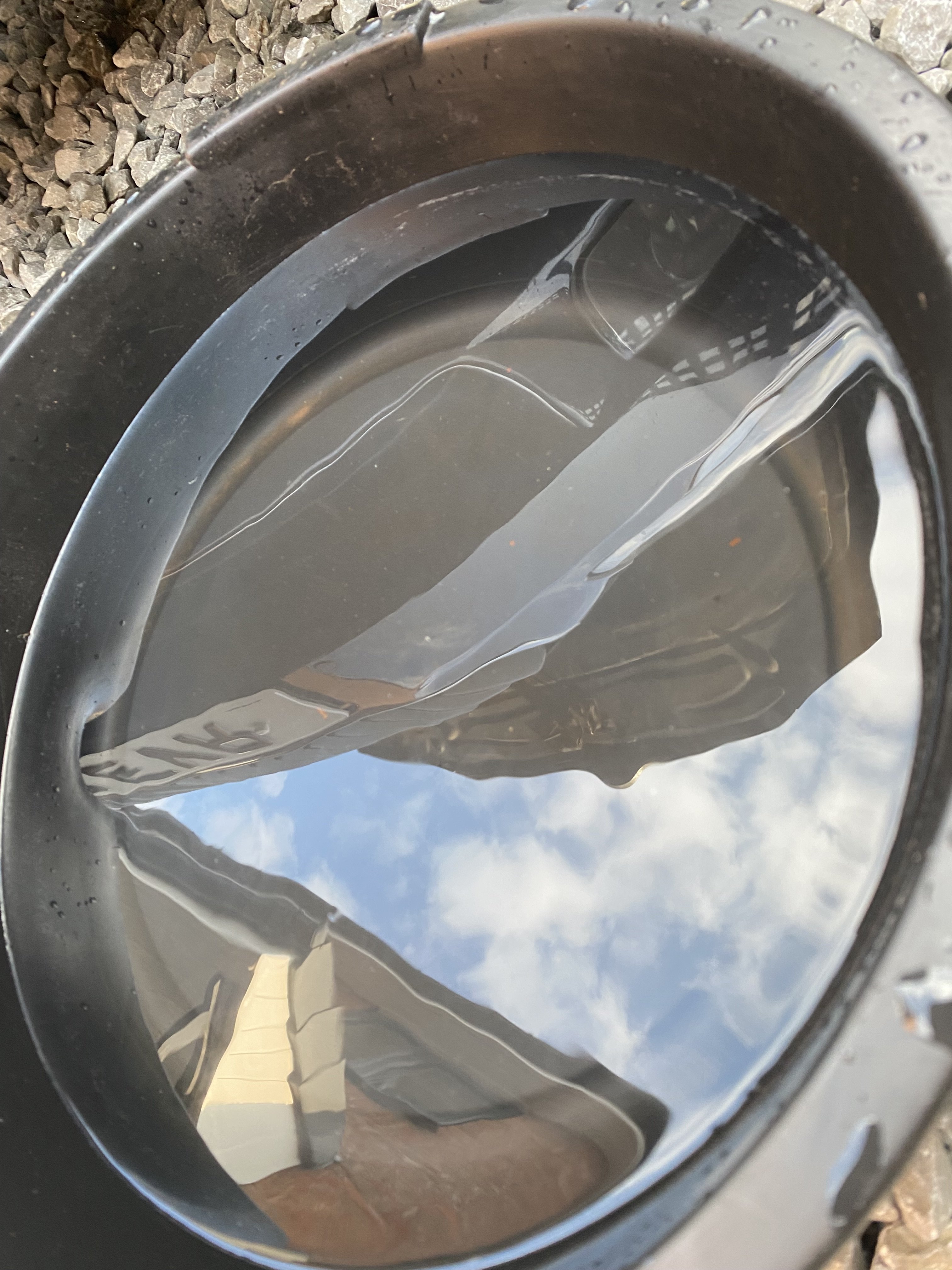

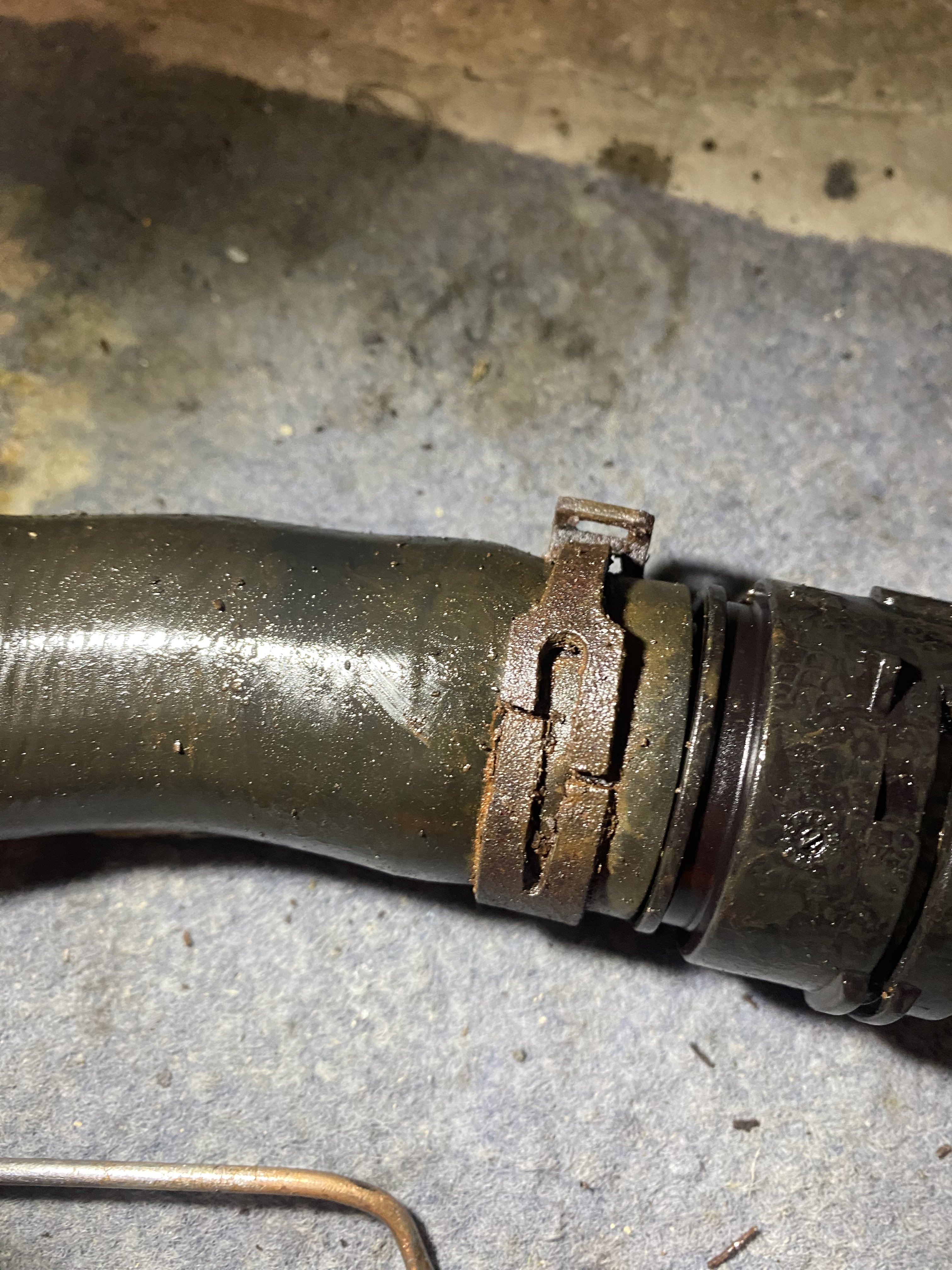

Found it had been using abit of coolant, topped it a little when I first got it and then I’ve done 1000miles since and I noticed the dampness down the front Side of the gearbox. I had been planning on a flush and new coolant bottle anyway as the level was hard to see the bottle was stained. Traced it to the top rad coolant pipe and on removal was quite easy to see the clip had failed. So nice easy fix just waiting on a couple of new clips and a seal for the top coupling and temp sensor o ring where I drained the system. As these don’t have the built in drain on the bottom hose.
Also got a black washer cap this morning
Edited by TrevorB33
15 hours ago, TrevorB33 said:
Also got a black coolant cap this morning
Washer bottle this time @TrevorB33?
Do’h yep I meant washer cap, now edited cheers

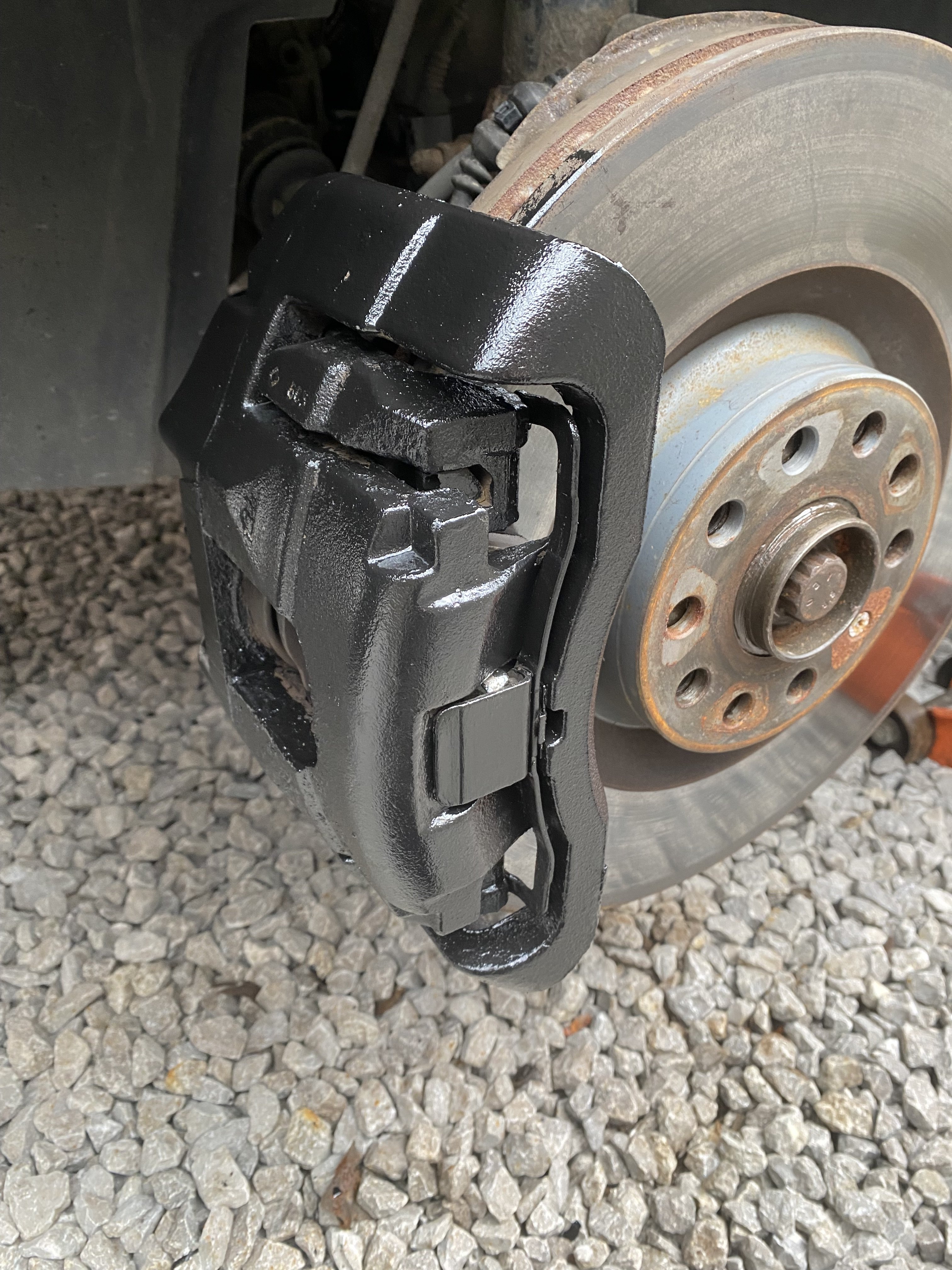

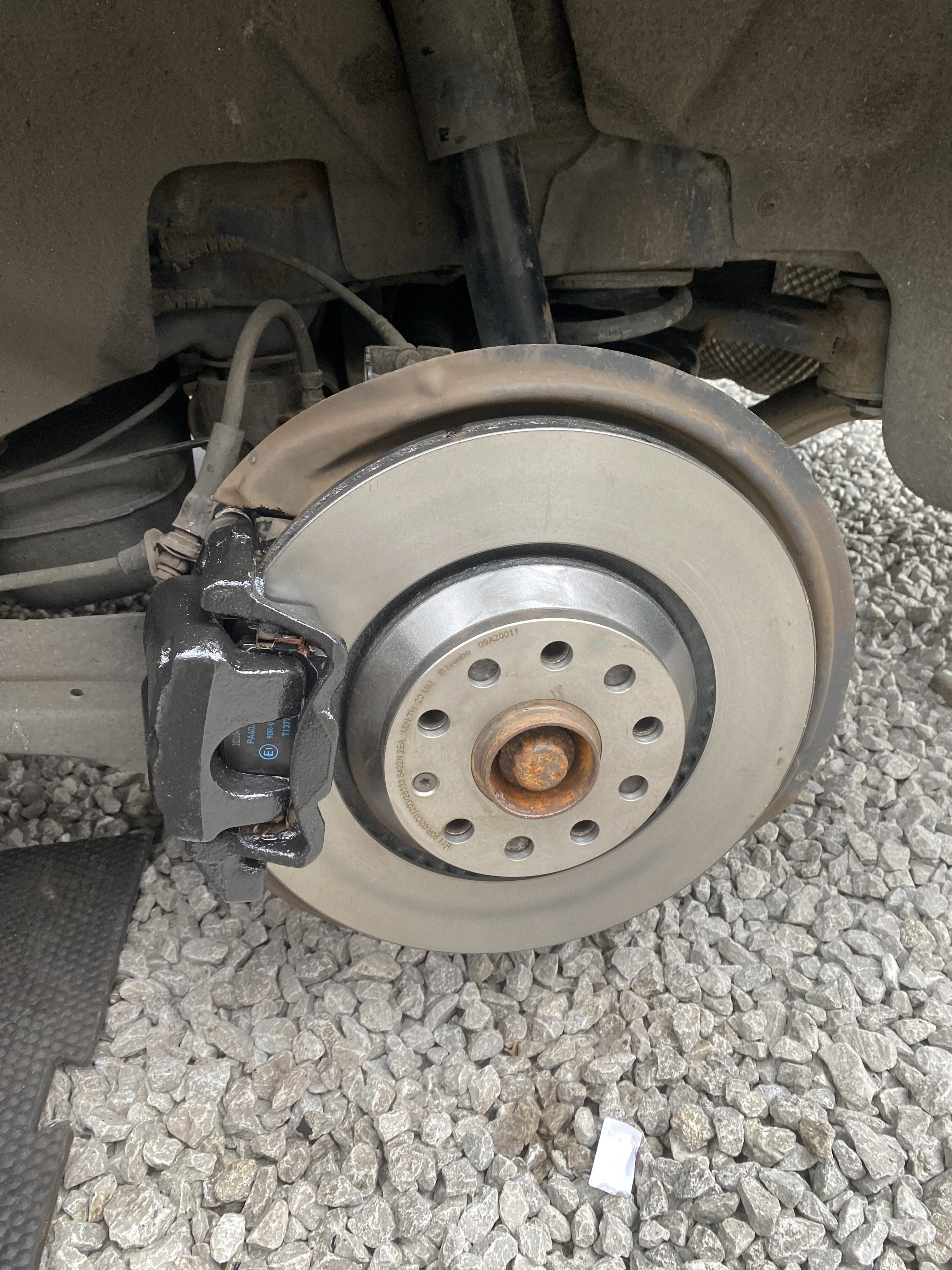

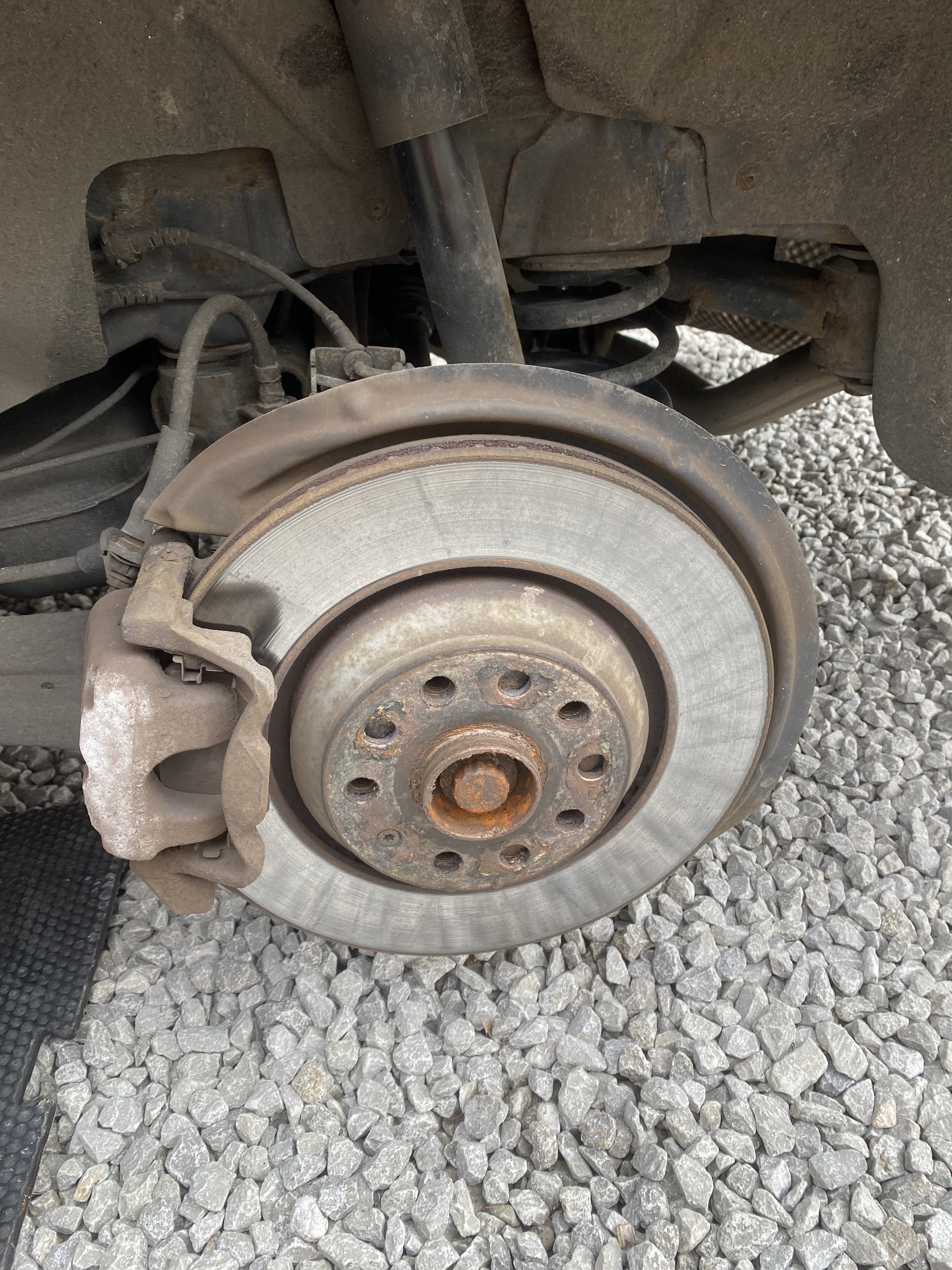

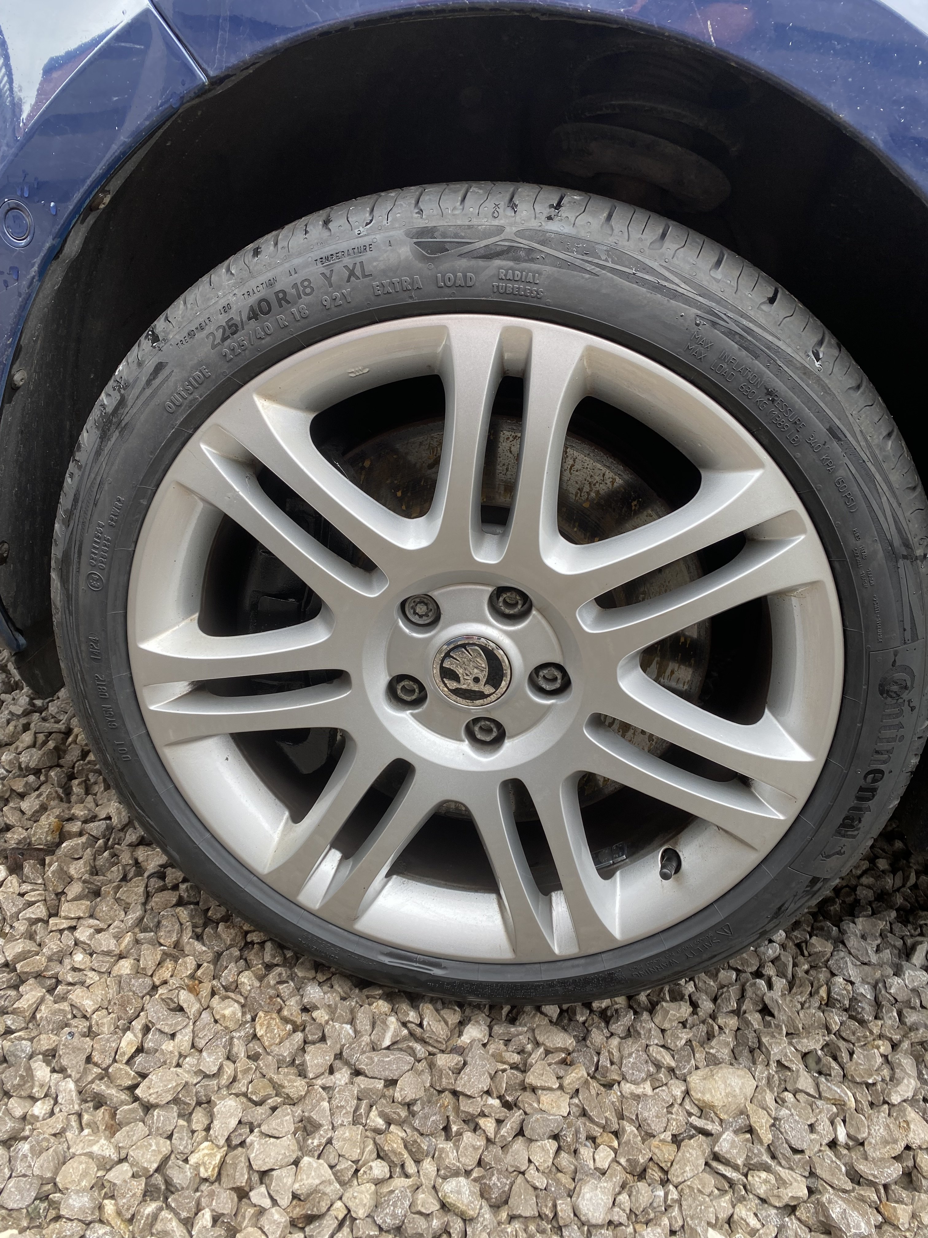

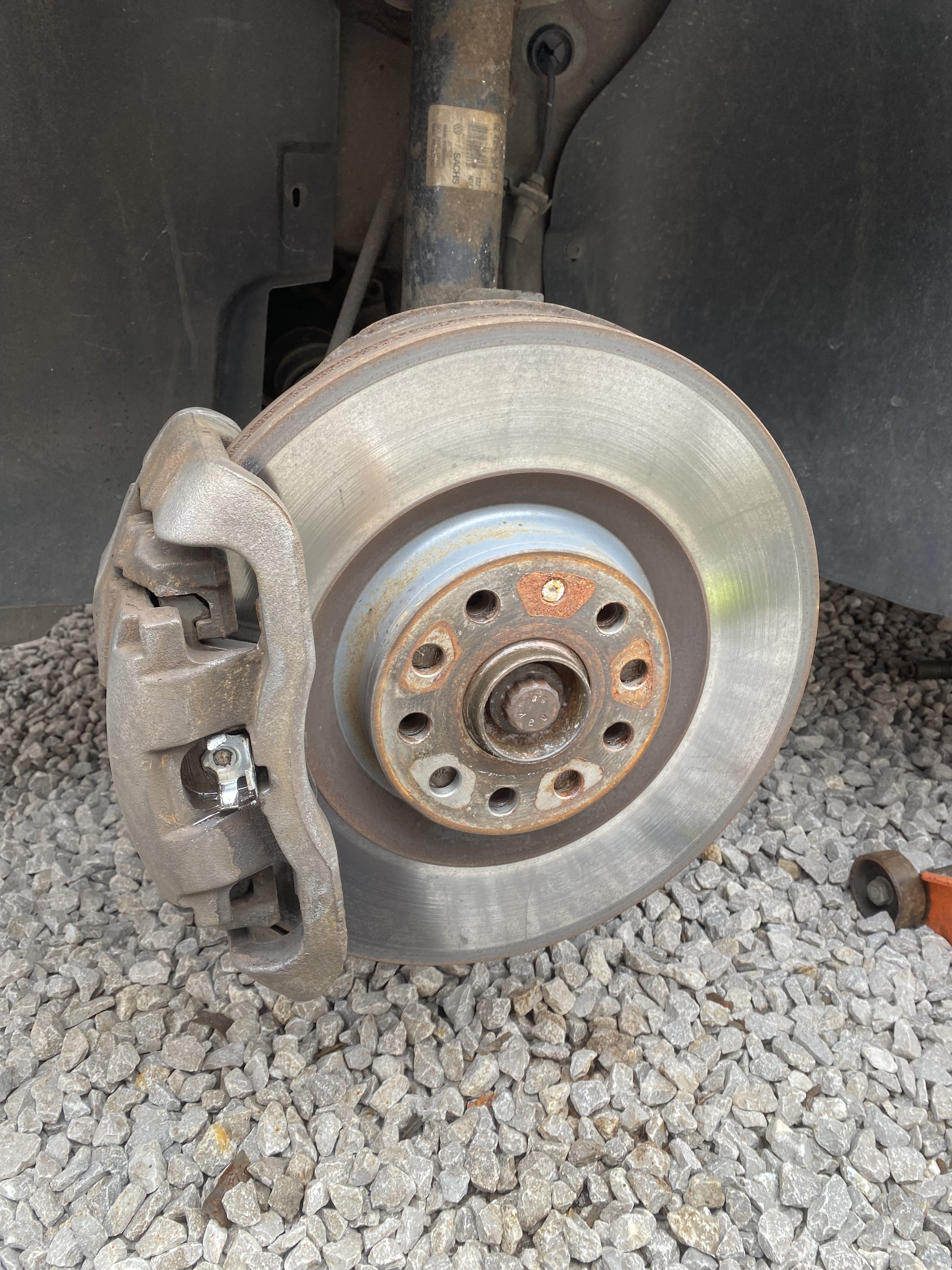

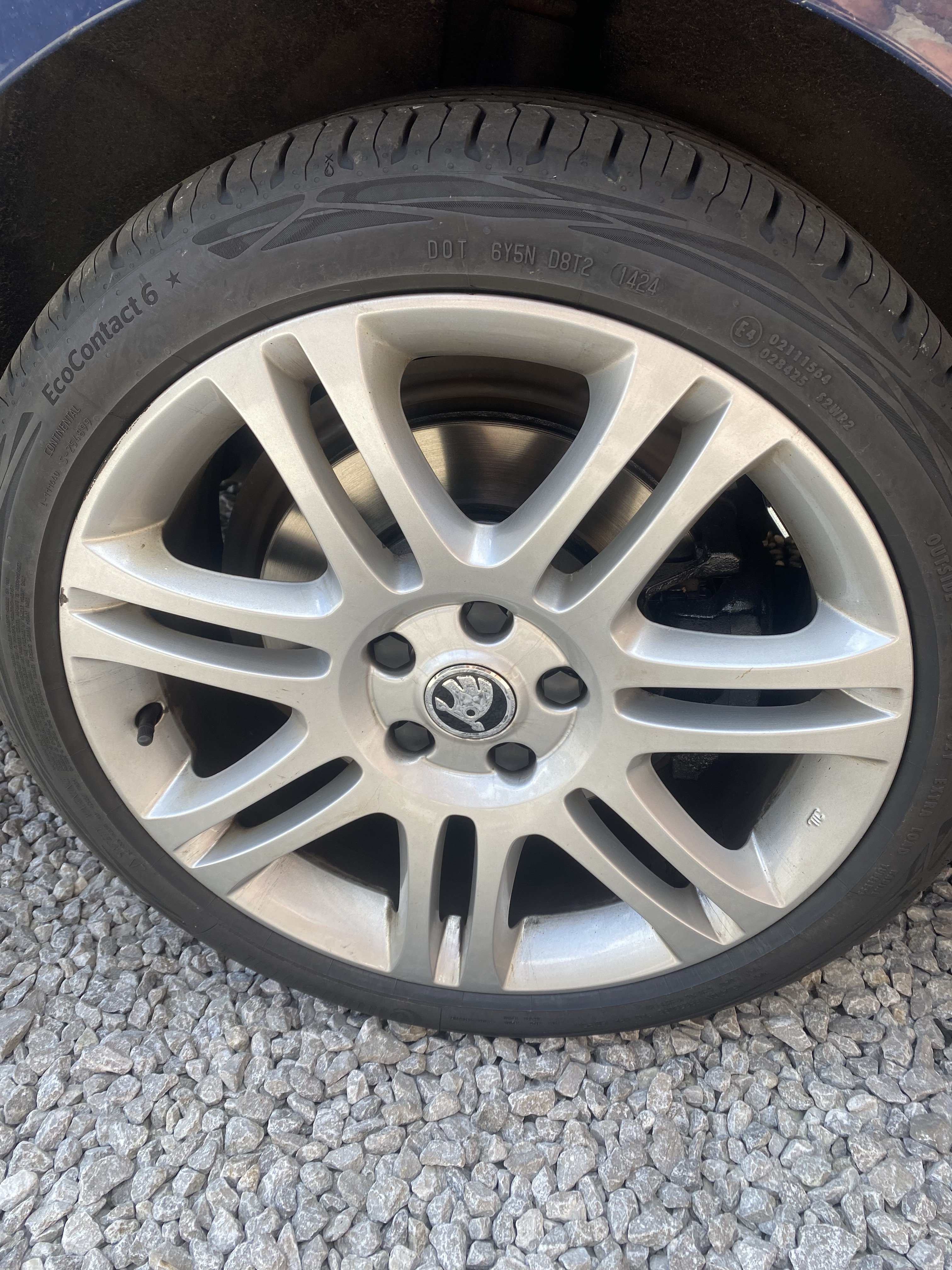

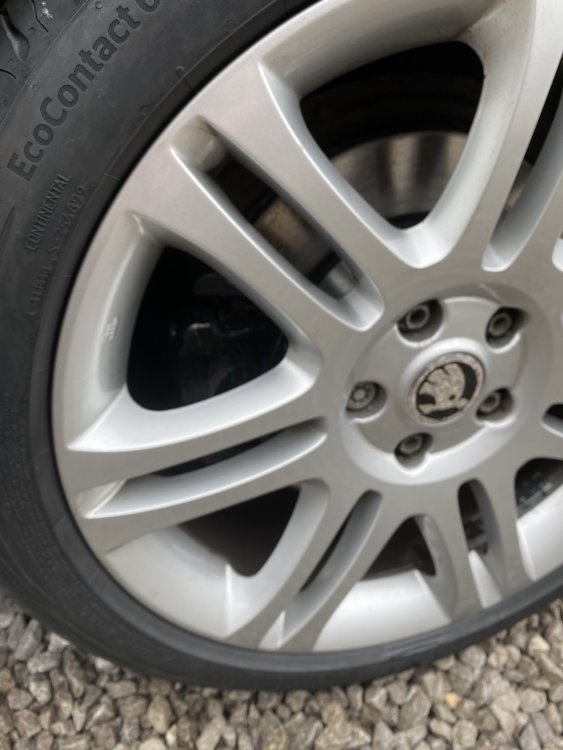

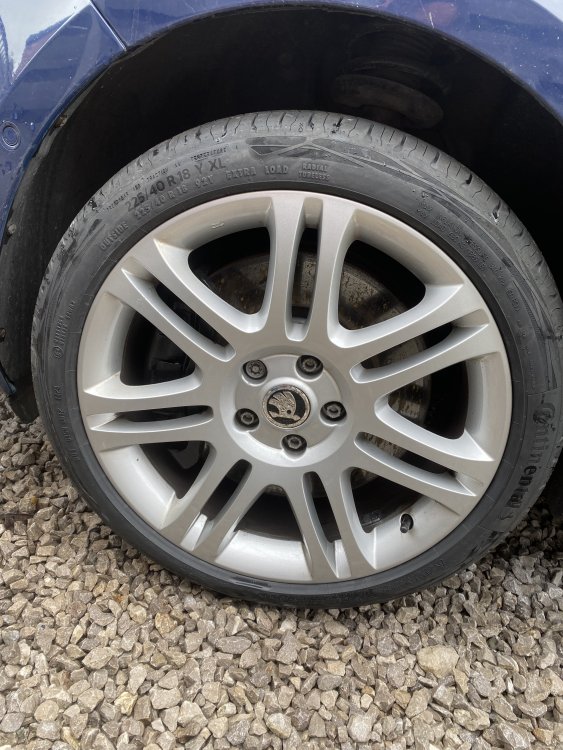

Some new Brembo rear discs and pagid pads and a little tidy up of the Calipers and carriers, painted them a nice stealth Black.

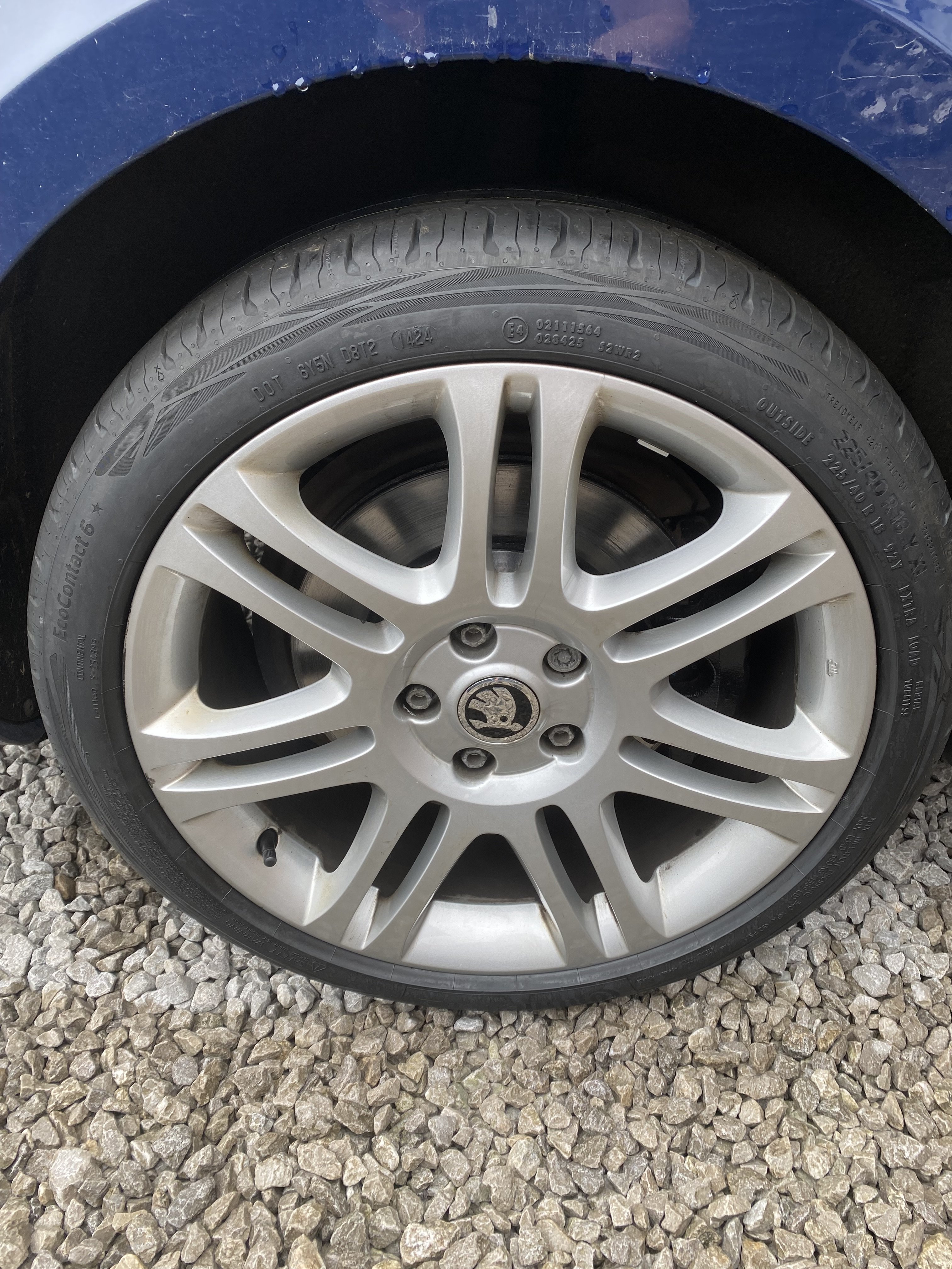

Got the original alloys on just need tyres soon now.
Edited by TrevorB33
Got some top spec tyres for the old girl and on the oem alloys and it looks “superb” just as it should have been.
Wouldn’t even know it was a beast unless you notice the big stoppers and quad exhaust 😂

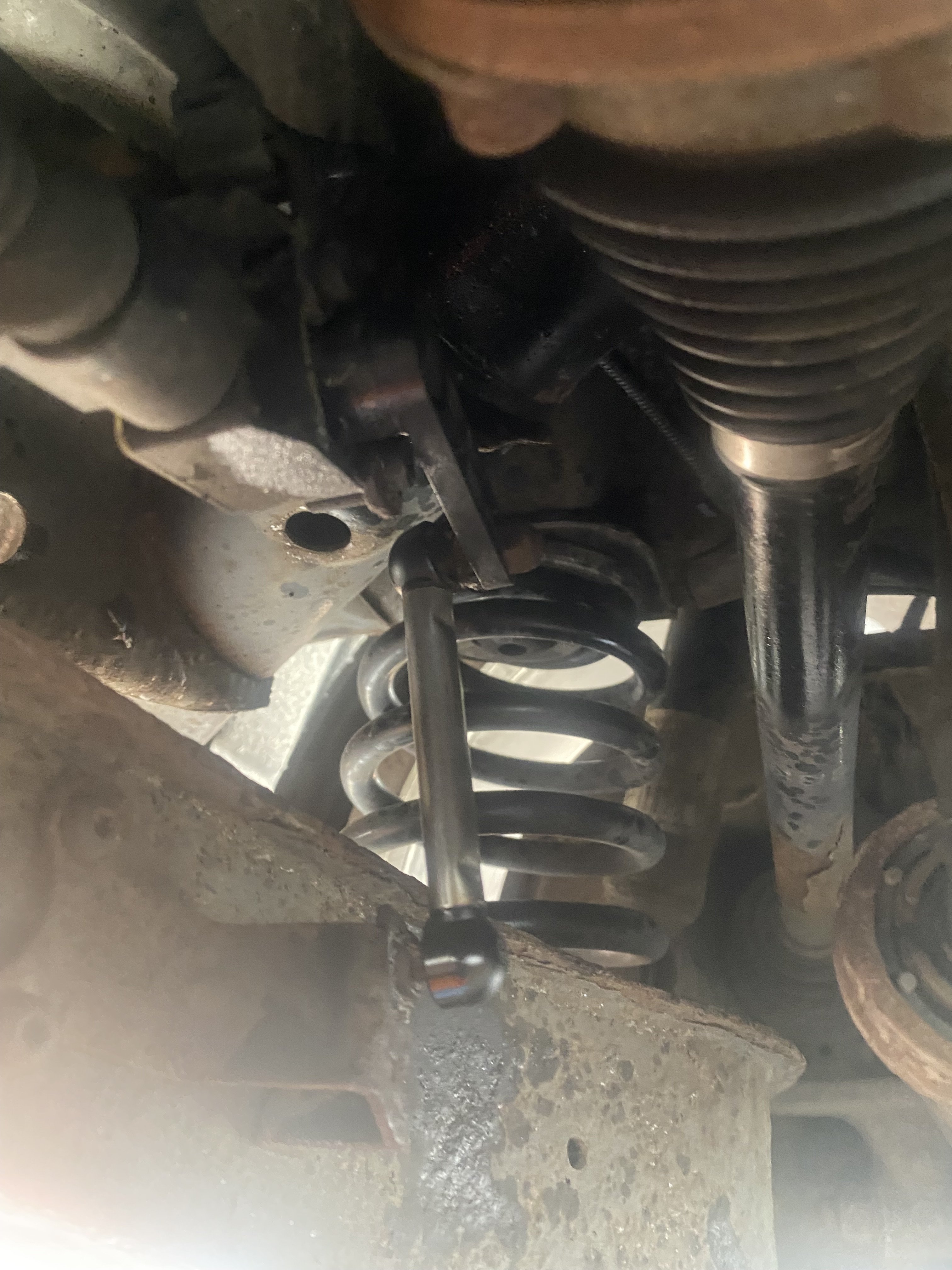

Notice a while ago the rear xenon level sensor had pulled out the balljoint, had a quick 5 mins this afternoon to play with. The bottom ball joint was very stiff so lubed that up and freed it off and with abit of heat on the ally bar and it pushed back in nicely, I’ll keep an eye on it but it shouldn’t pull out unless I let the suspension get full droop again so should be good.

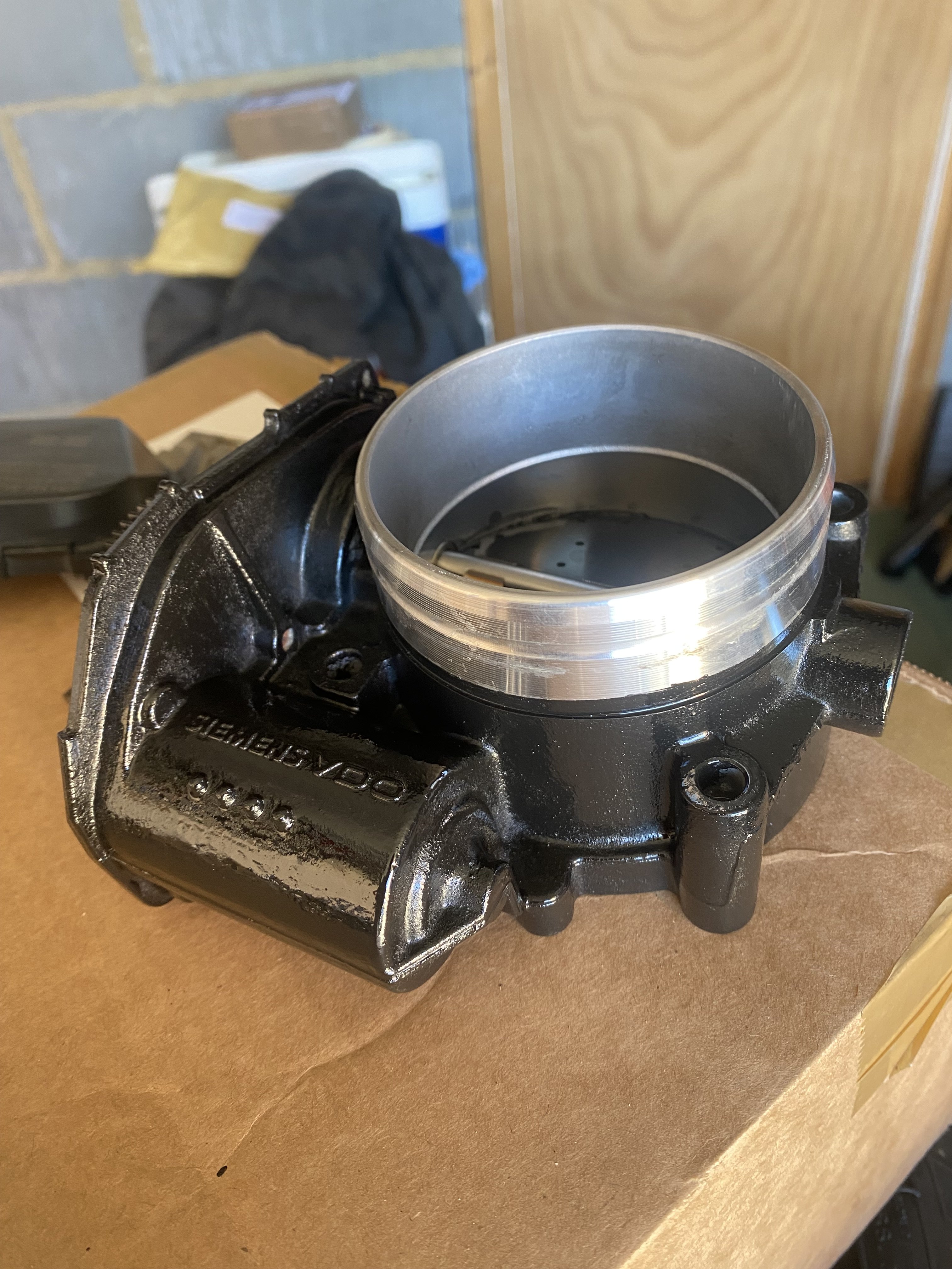

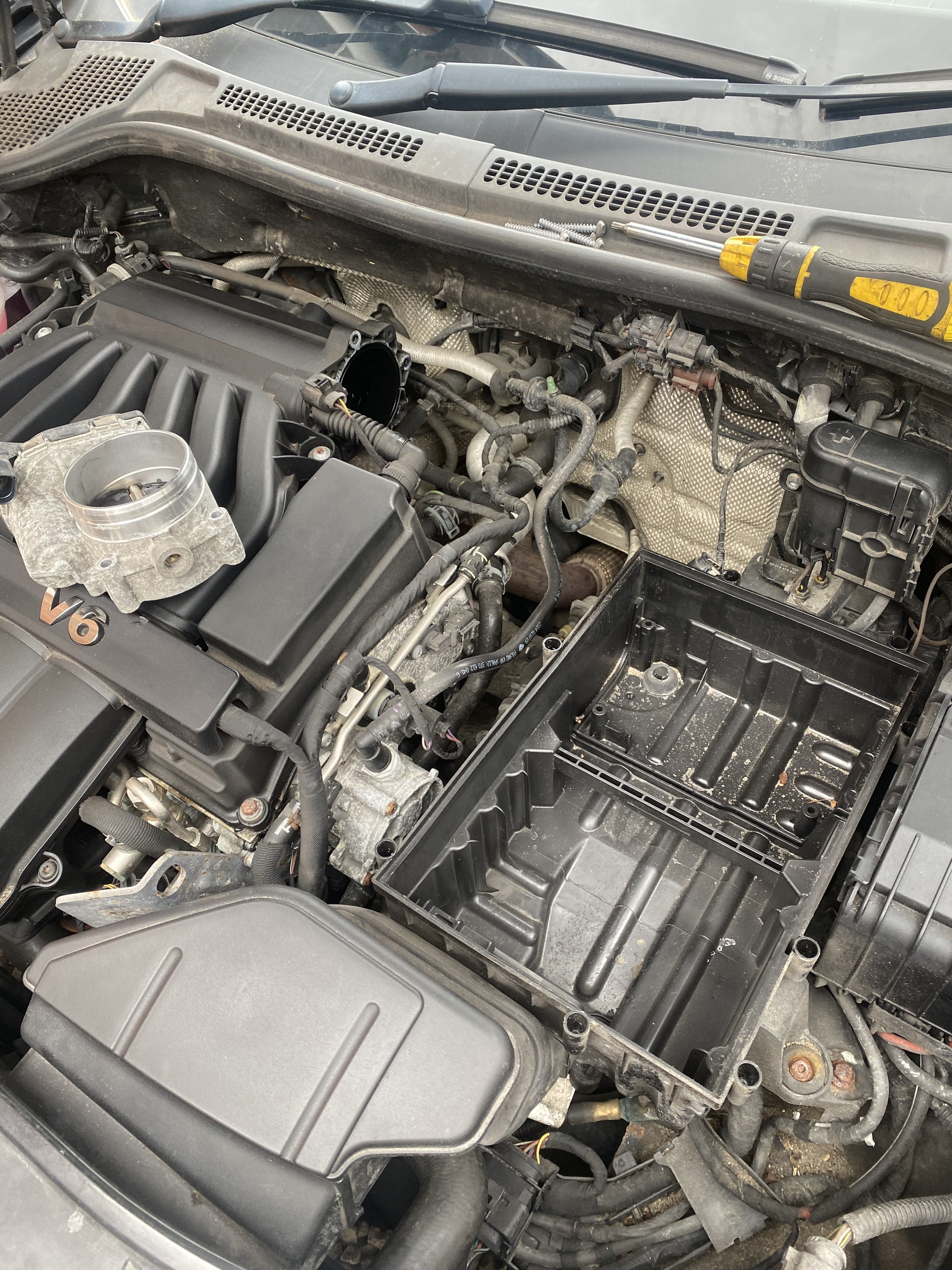

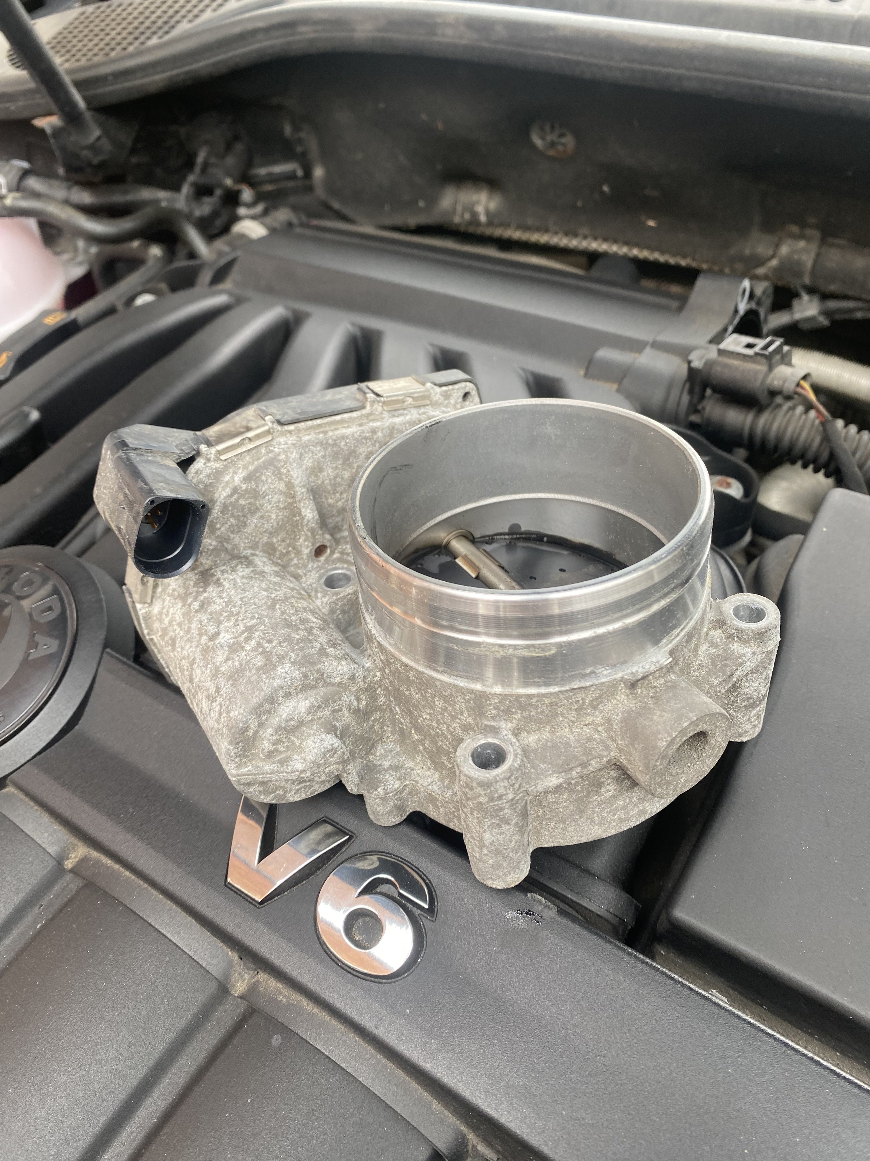

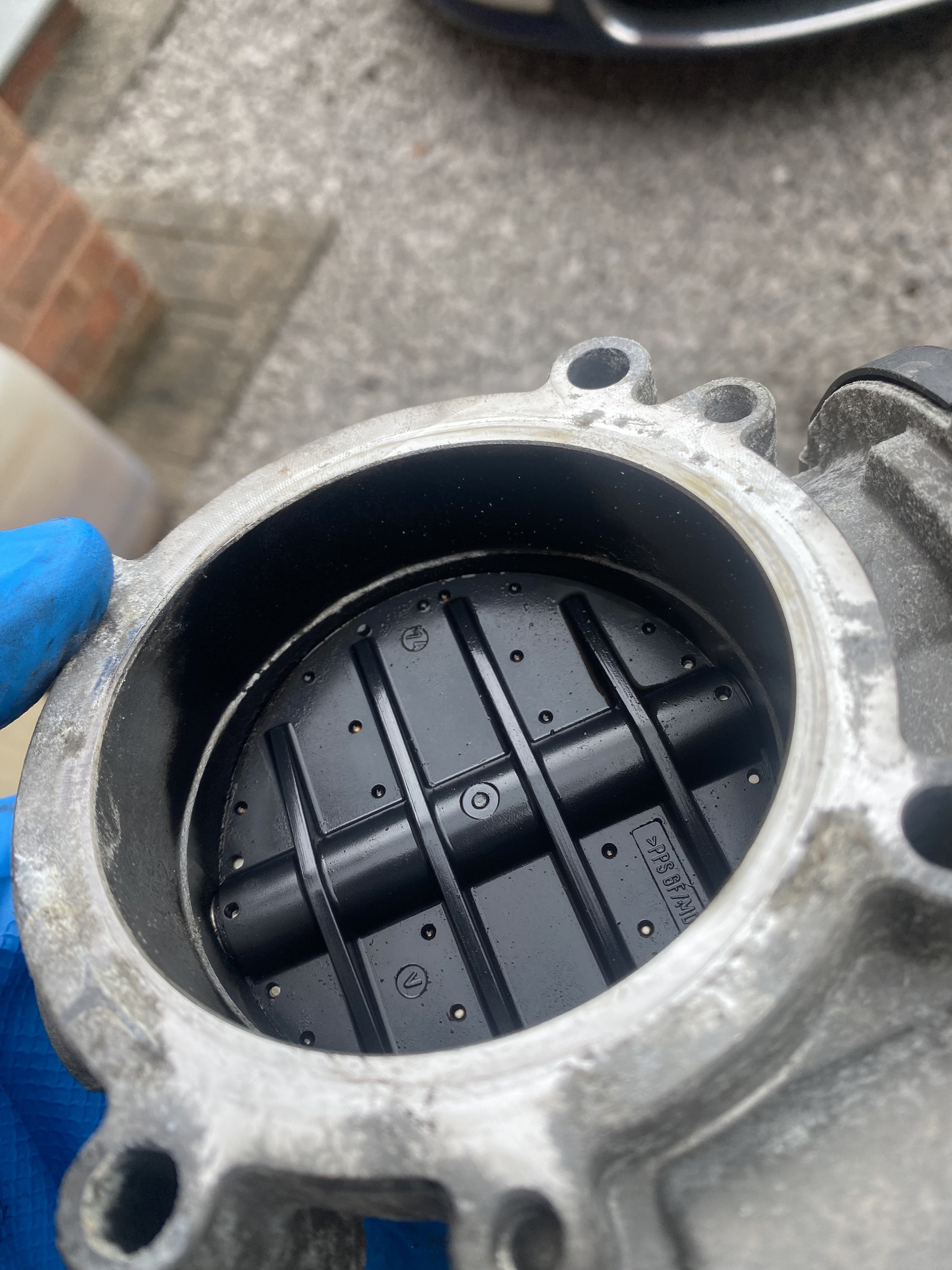

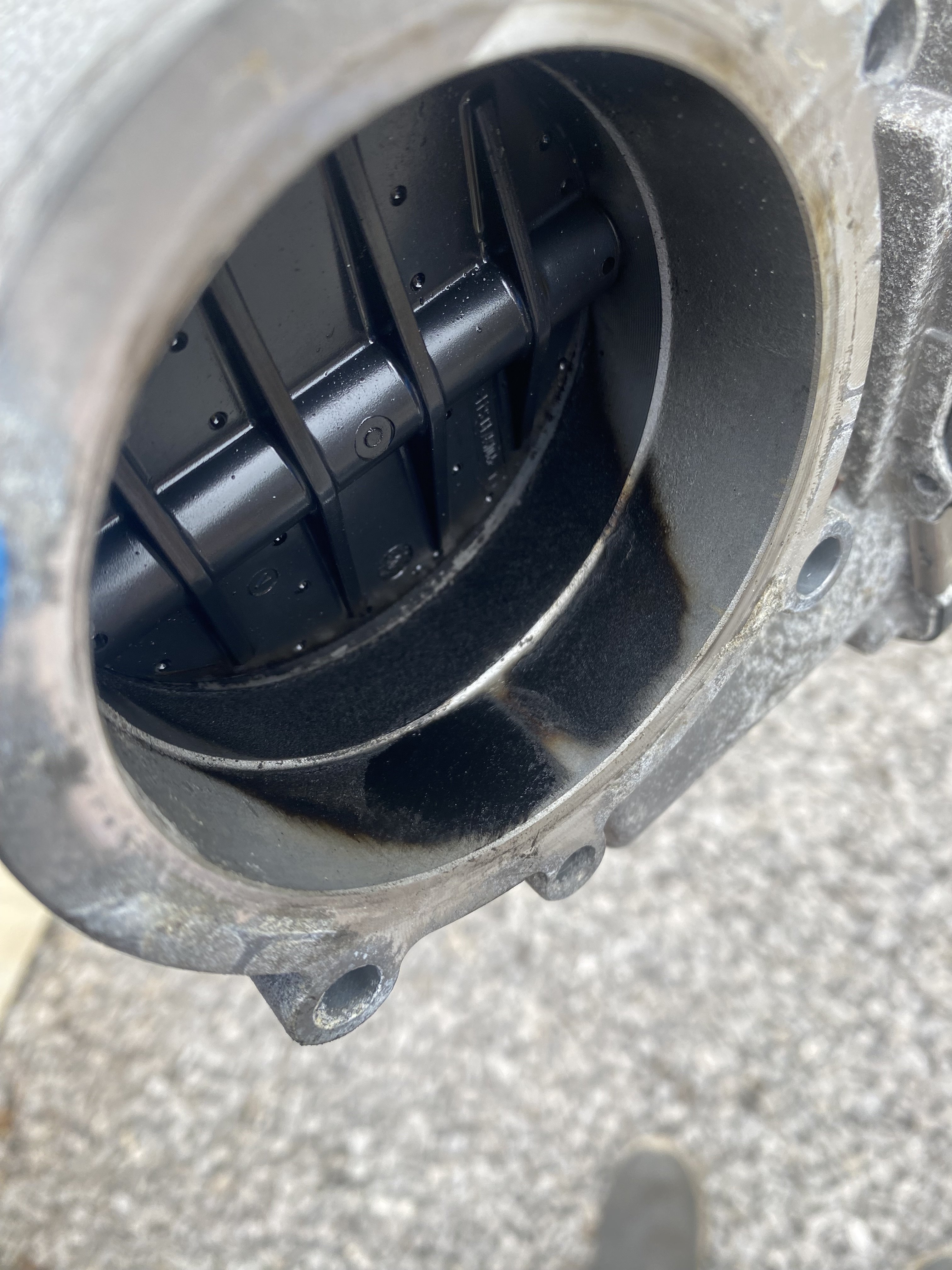

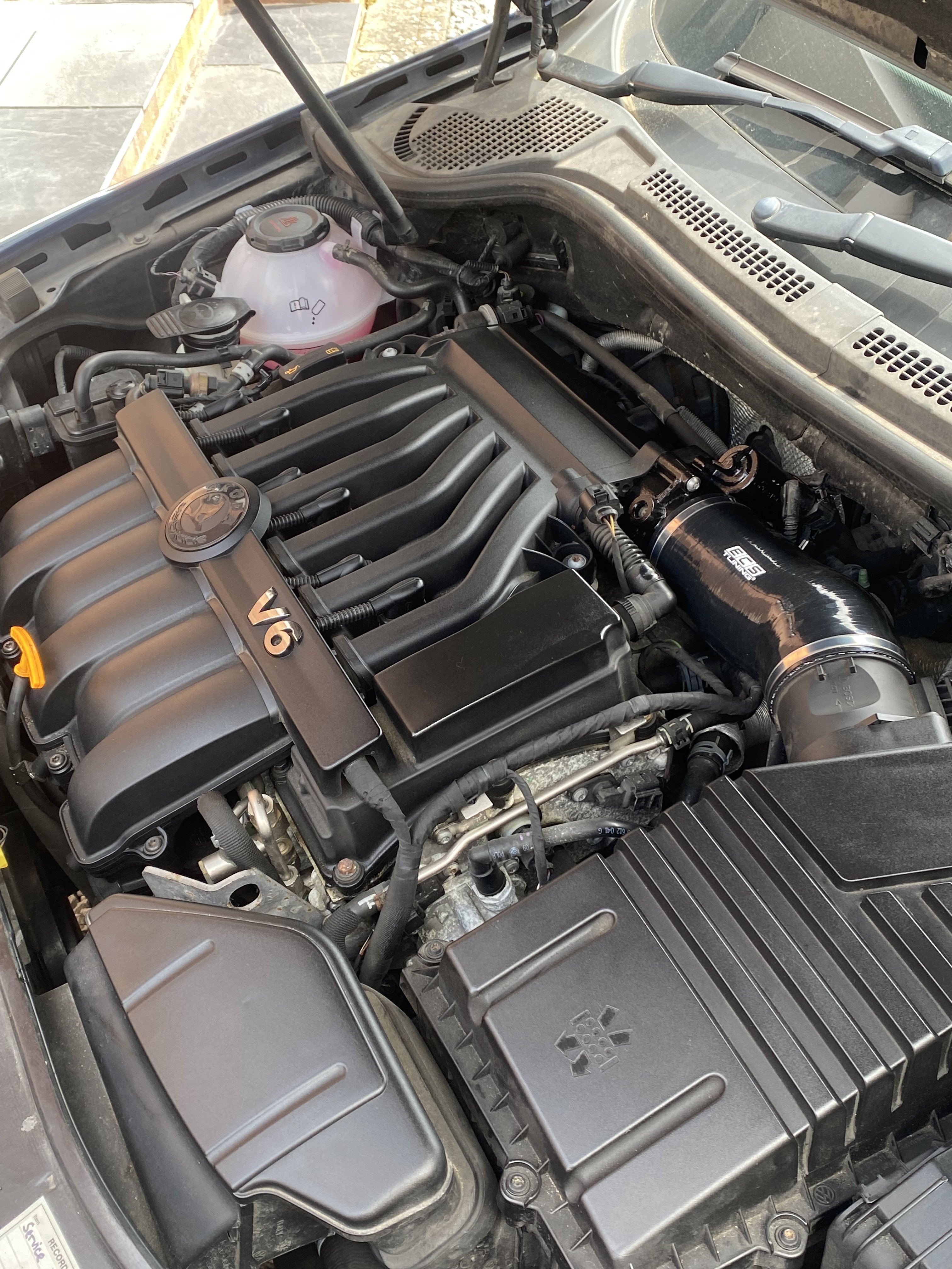

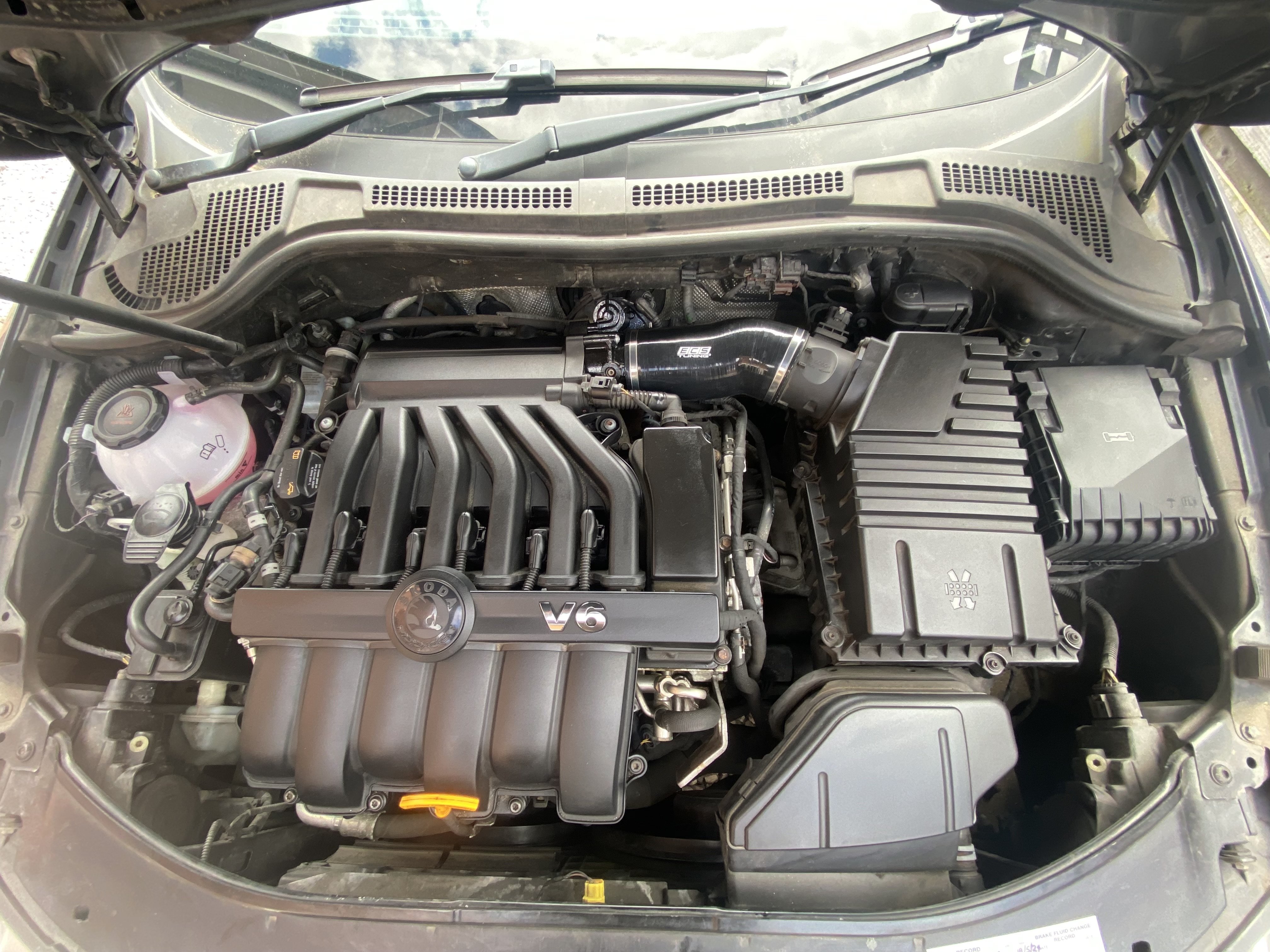

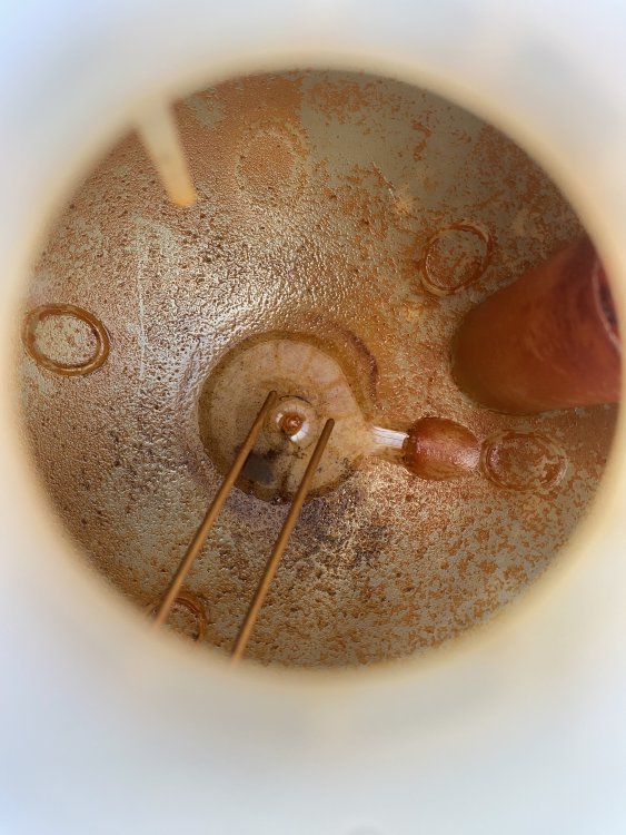

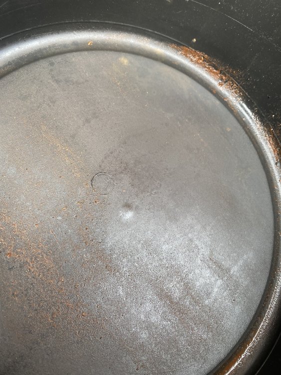

Also started on a little tart up job as I’ve just recieved my Ecs intake pipe and racingline panel filter. I felt like having the throttle body black would really go.
Cleaned up inside and out and hand brushed with some high temp black enamel.
Already to go back on tomorrow once it’s cured, have four new genuine bolts and gasket, then just a throttle body reset to do.
wasnt that dirty inside but had abit of residue.
Throttle body had a good 24hrs to dry so fitted it All back together with the ecs intake pipe and racingline panel filter, I did contemplate getting an induction kit but as it already has such a good oem airbox it seemed a waste, shares the same airbox as tts and rs3.

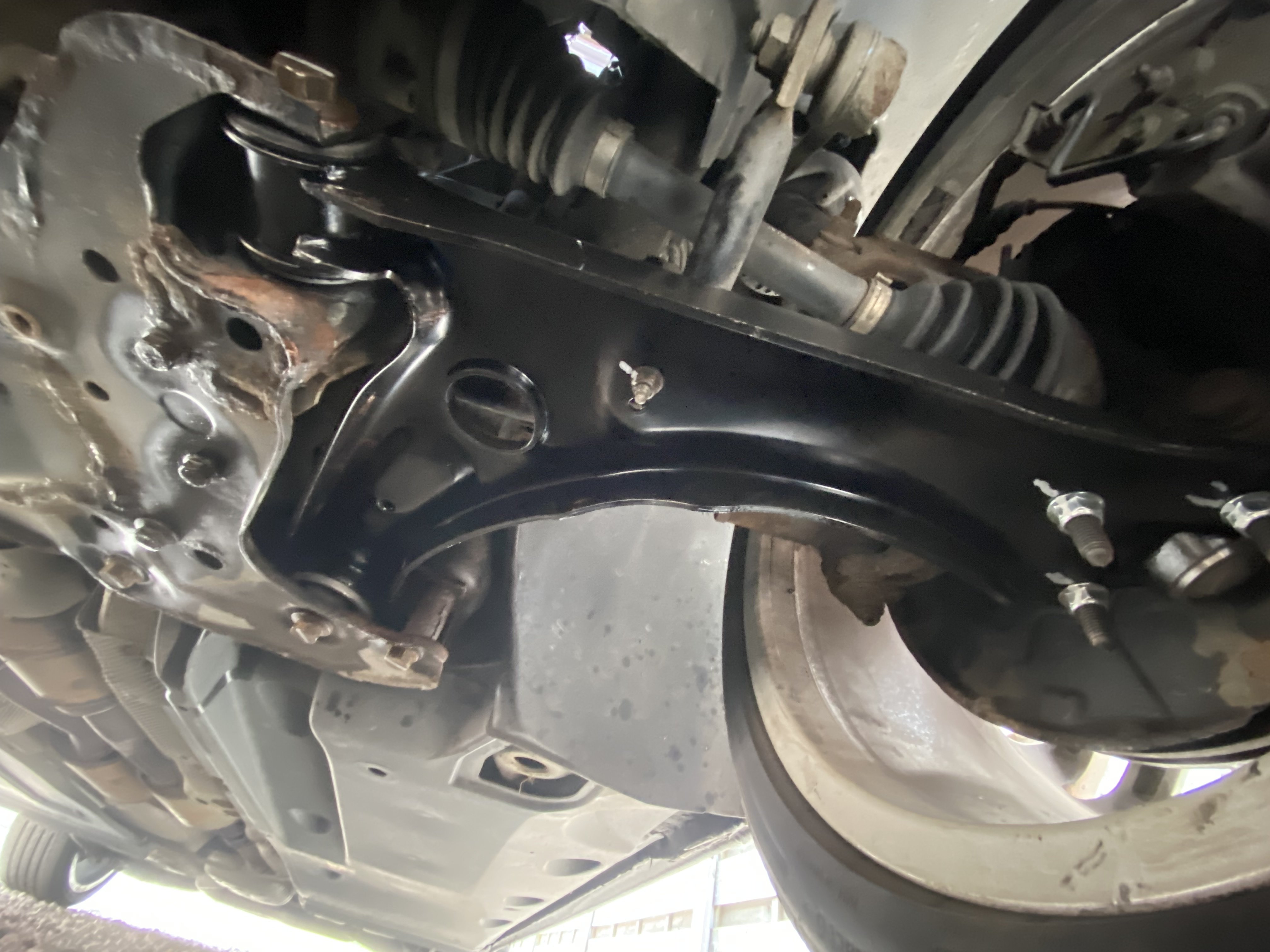

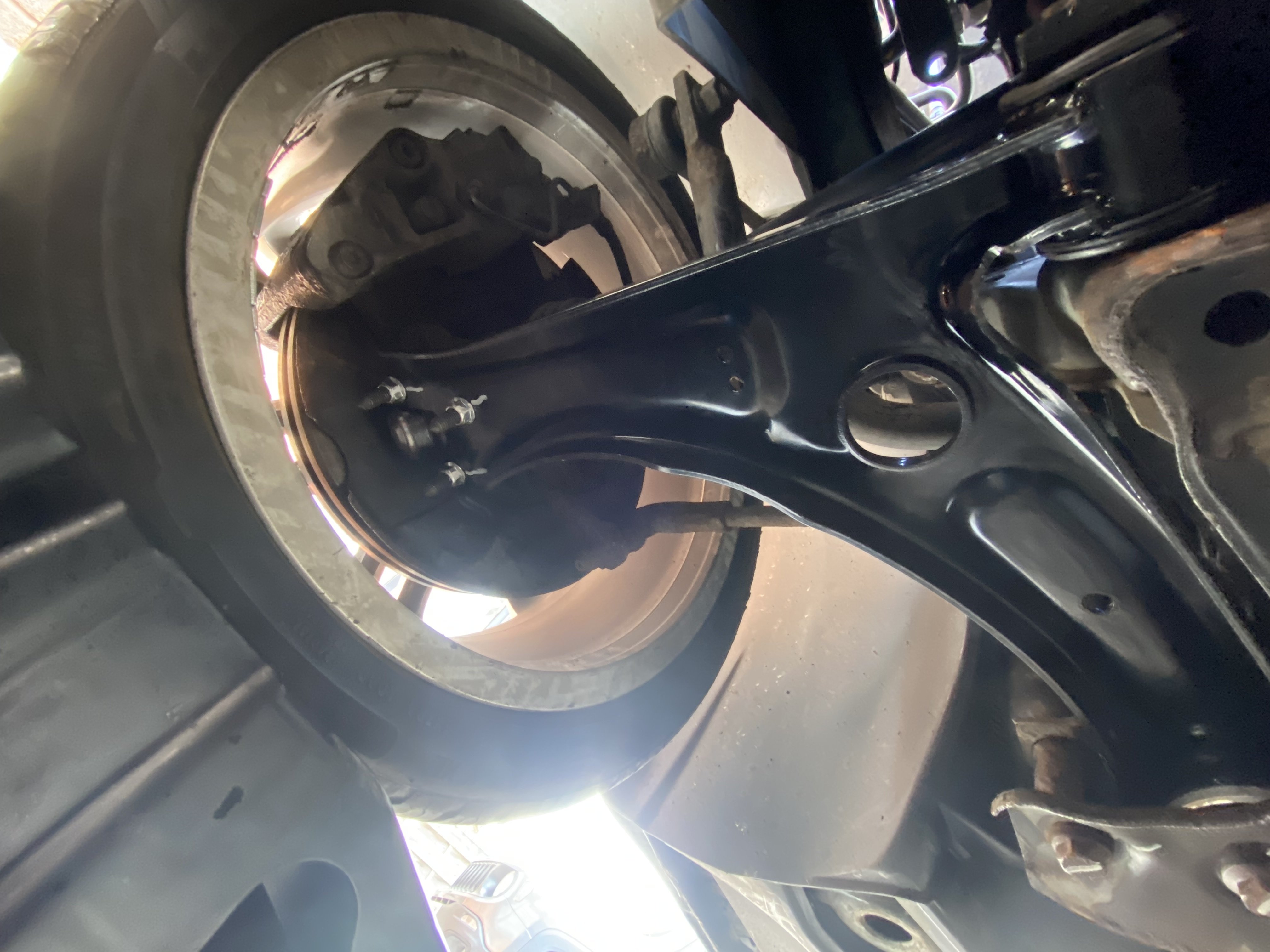

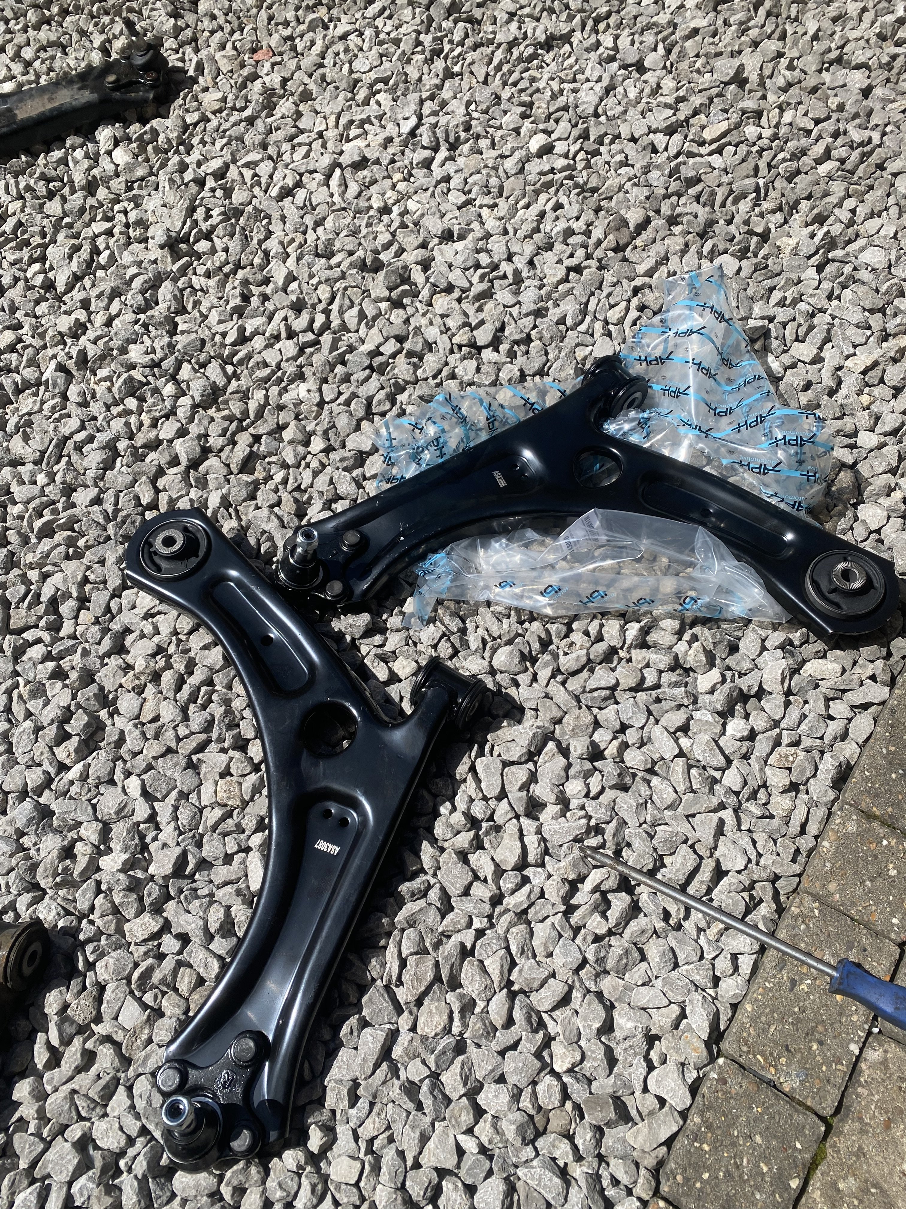

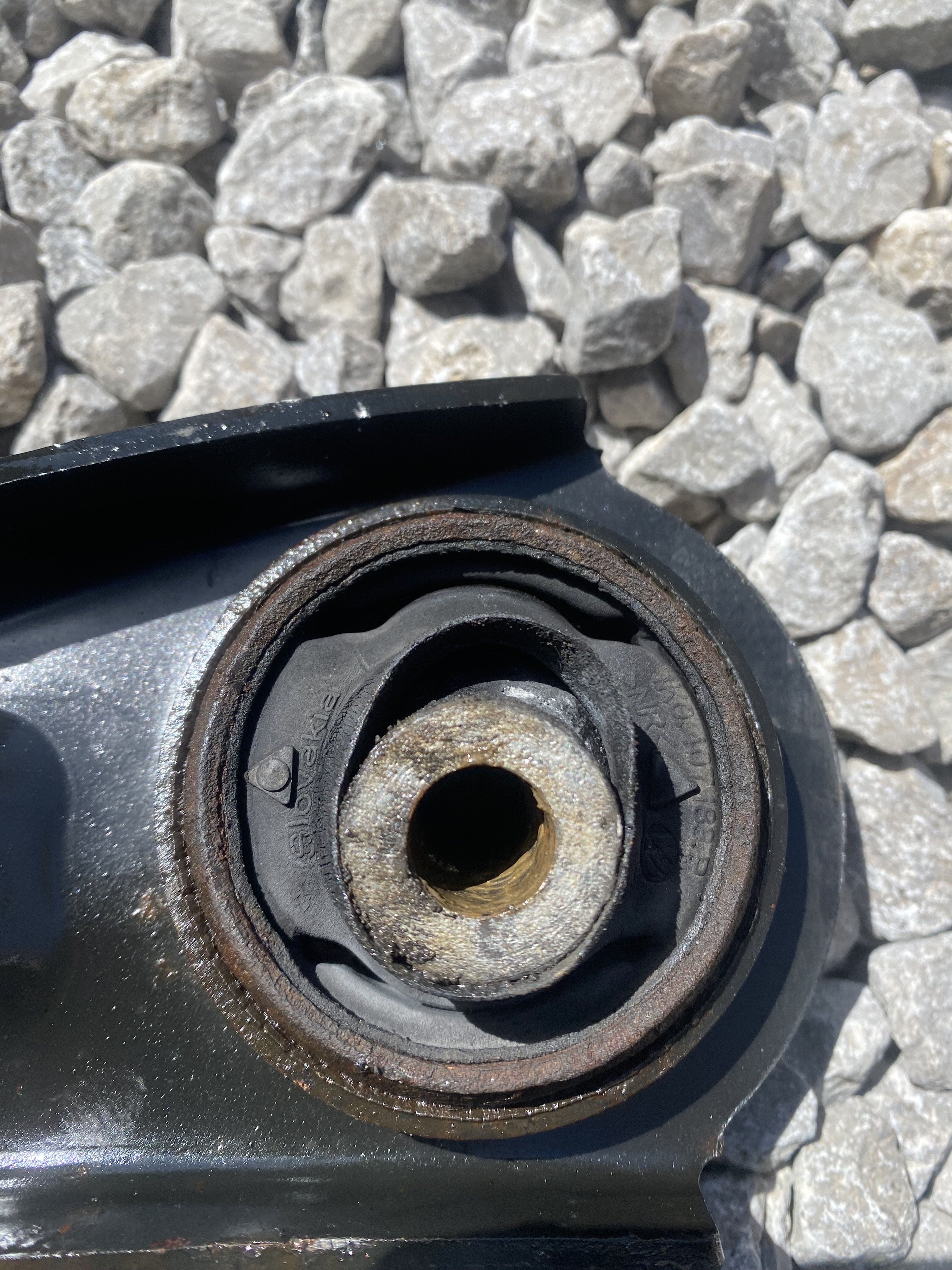

The car had always had a wierd dead spot when initially turning the wheel, that didn’t inspire a lot of confidence. I had a good lever around the other week and found the rear wishbone bush on the drivers side was knackered and could be moved up and down and it’ll stay there, so ordered a pair of wishbones and changed them both.
safe to say the drivers one was knackered as it nearly fell out when removed 😲.
Hopefully all good for the foreseeable now except maybe a wheel alignment as I had to drop subframe to do them. I shall see how it drives .

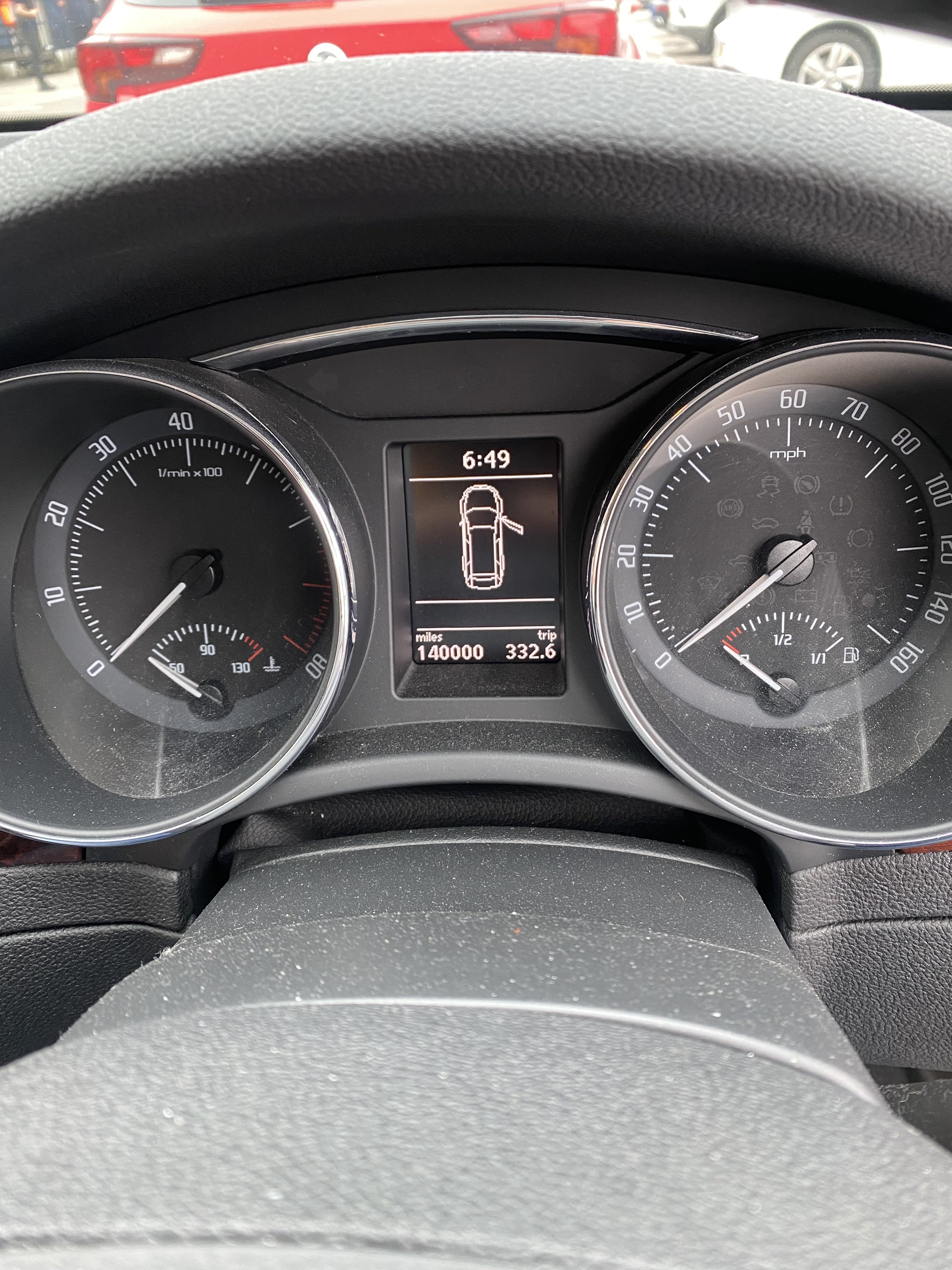

and also just ticked over 140k the other day
Edited by TrevorB33
