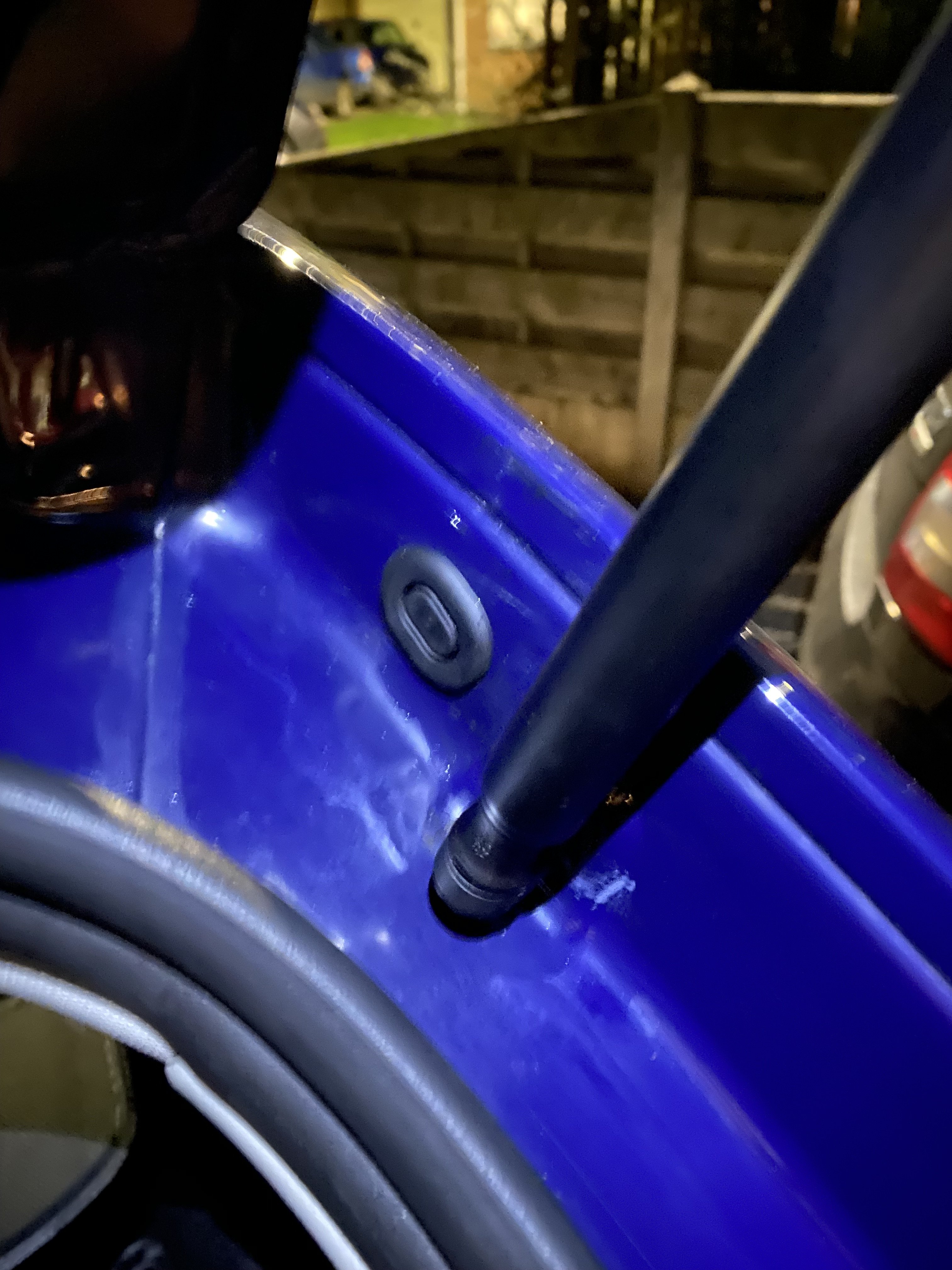

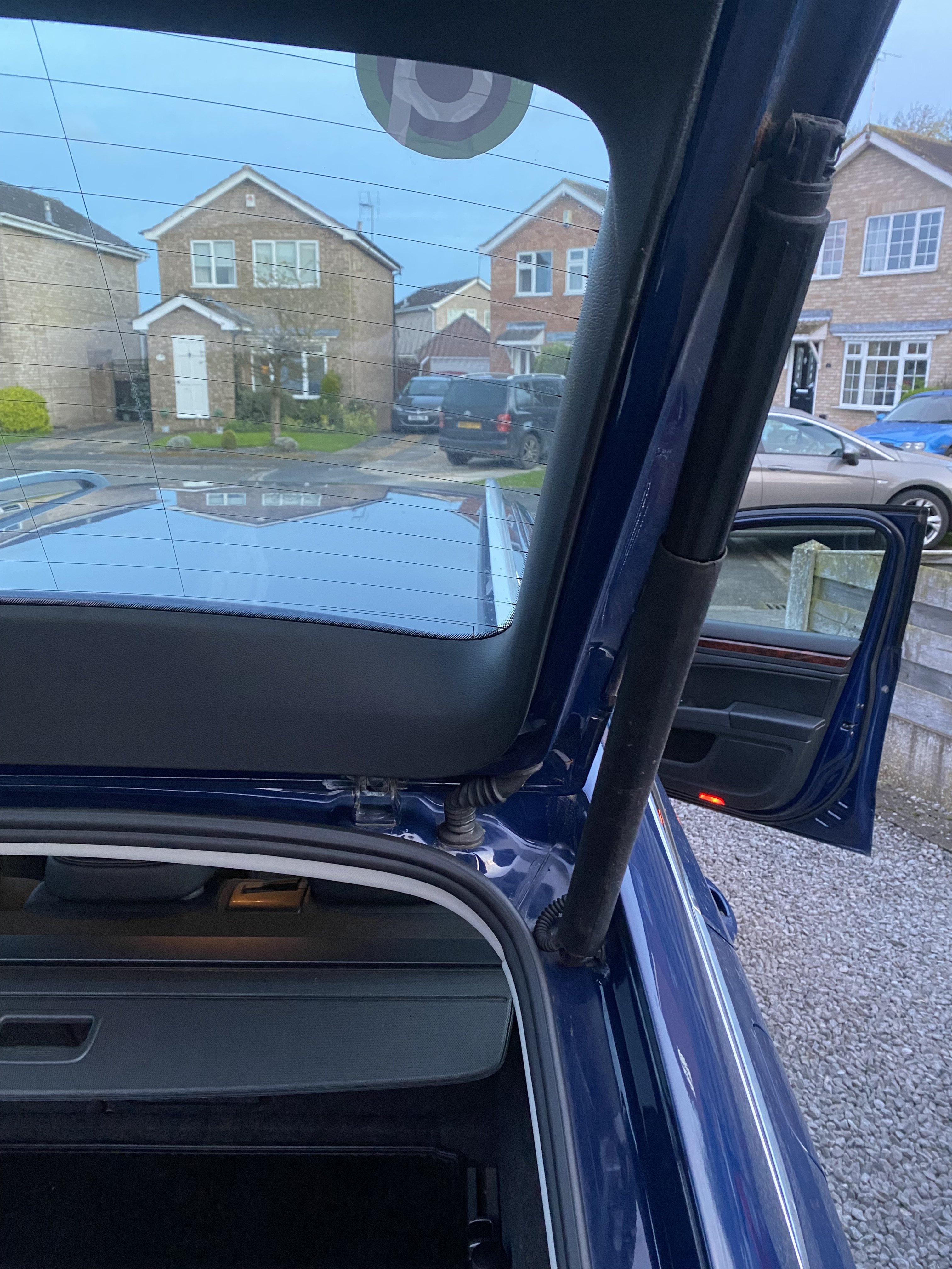

Already converted the boot to manual from its powered struts as they weren’t working, kindly supplied the kit to do so from previous owner.
Might try and get it working again in the future but I’ll see how much it bothers me
powered strut
Manual with wiring grommet blanks

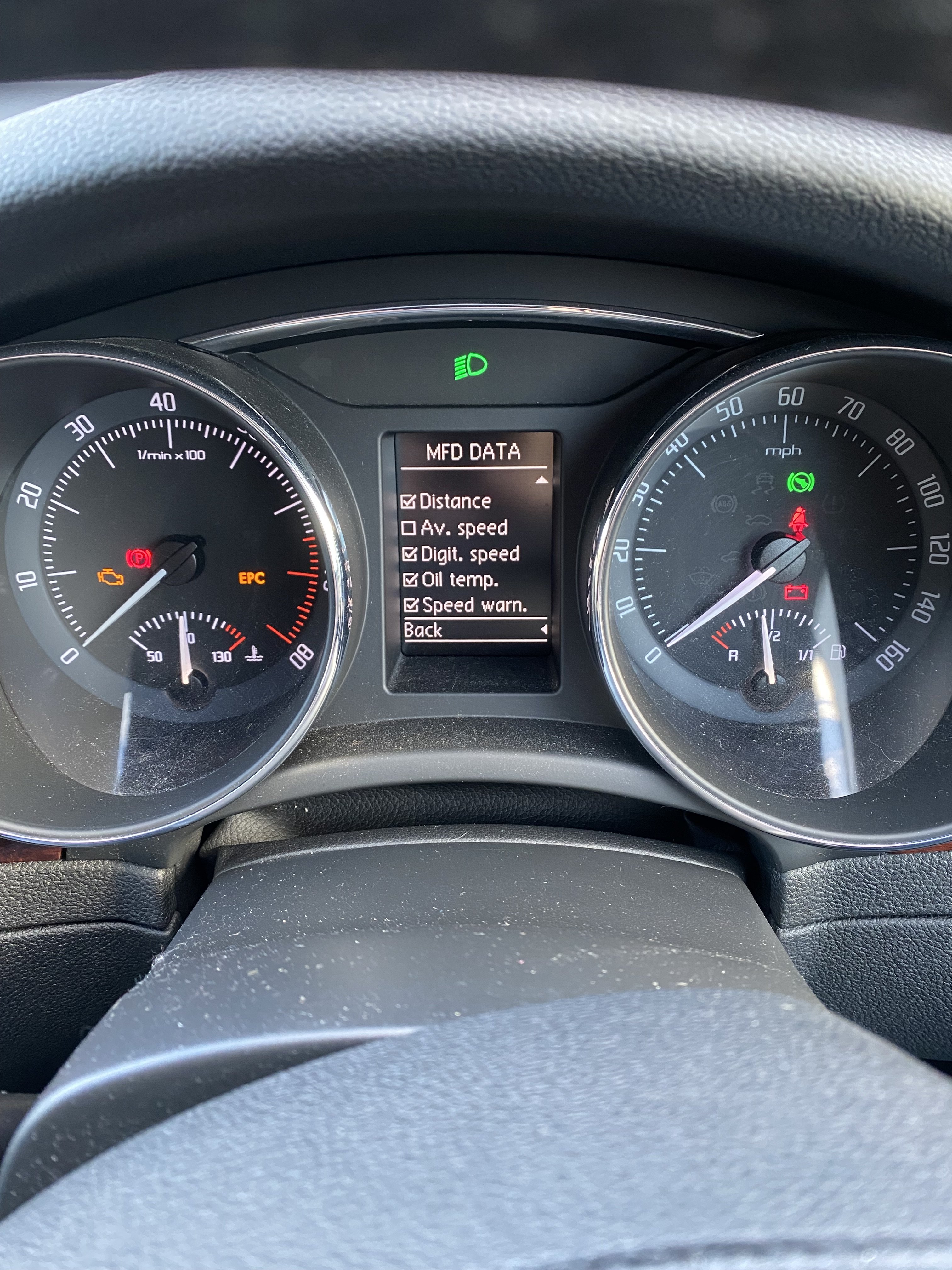

Also did some vcds tweeks,
one to get large MPH on the mfd display and the second to enable led lights so hopefully won’t throw a bulb out warning for the front sidelights

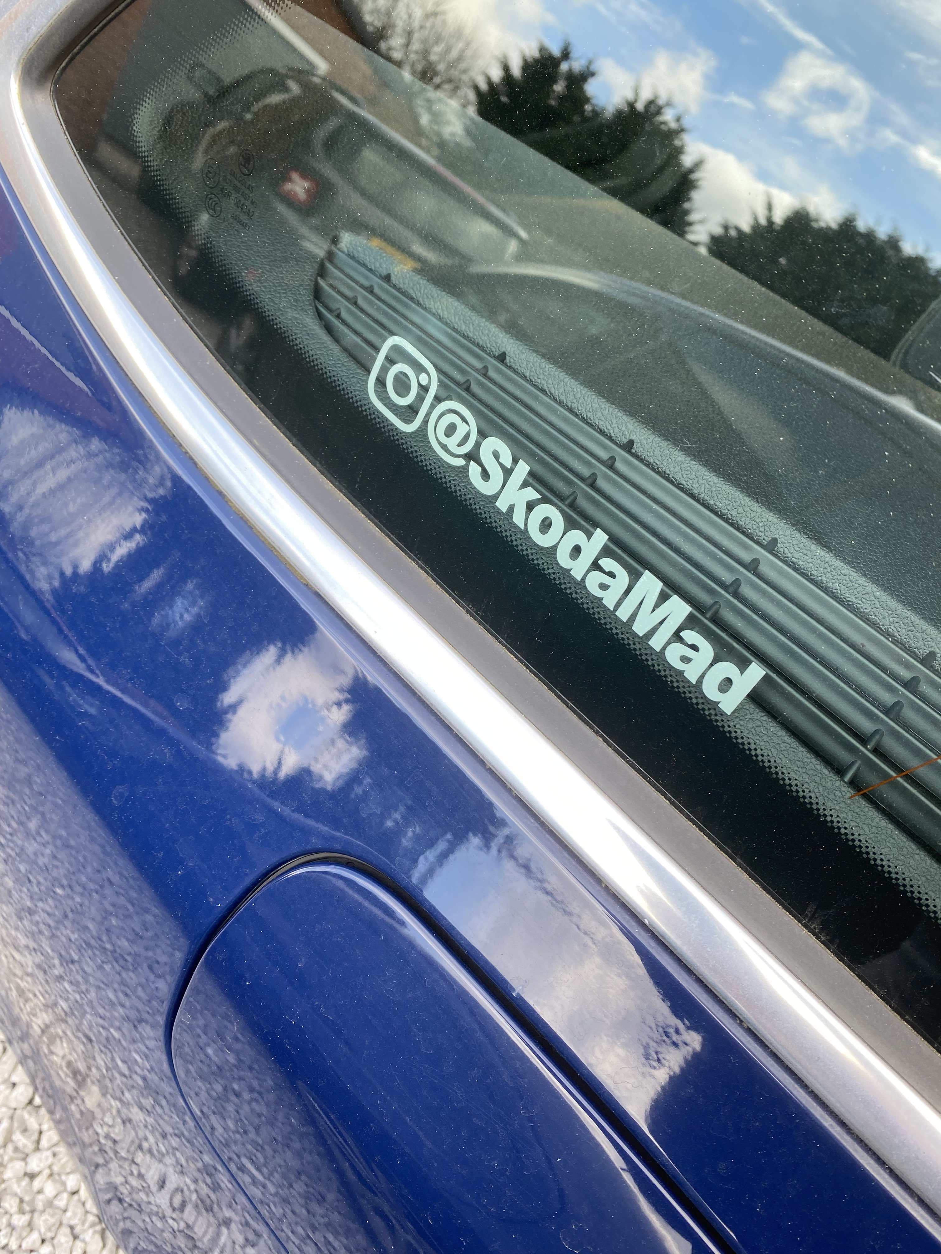

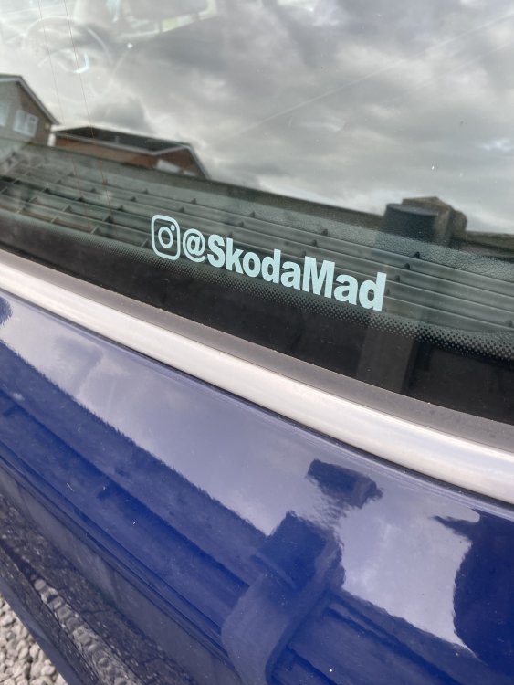

Got some stickers on for my Instagram handle, very apt with my probably 20+ Skodas I’ve had over the years

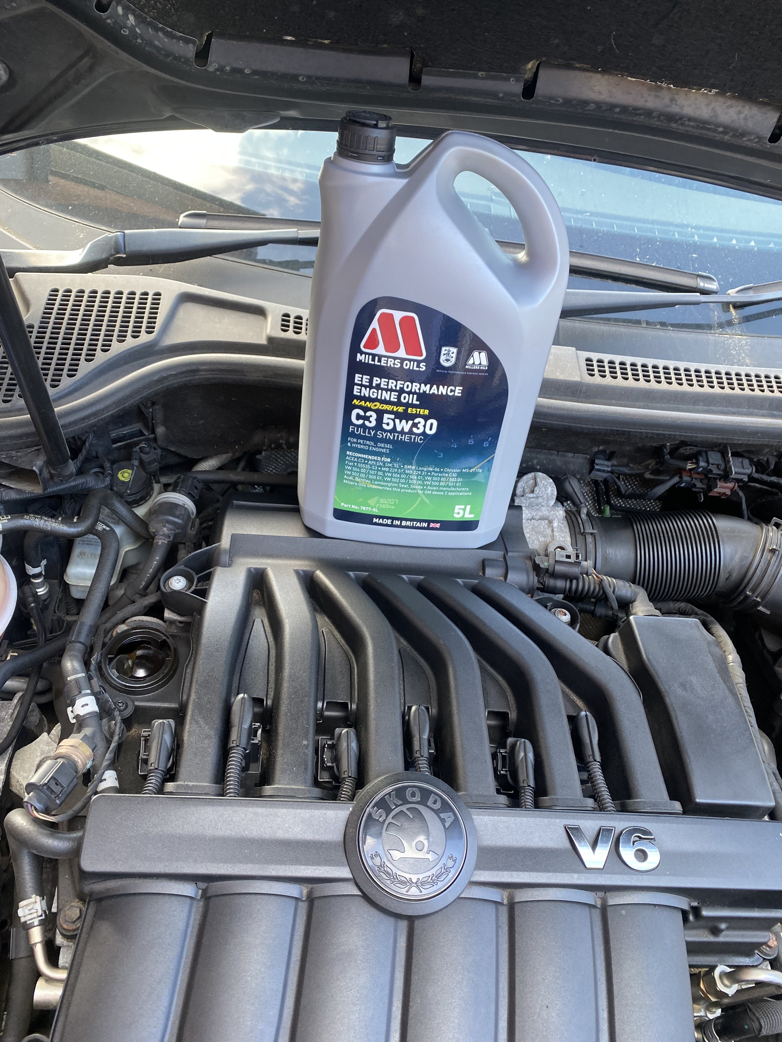

Also just starting to order various bits to get some service items sorted

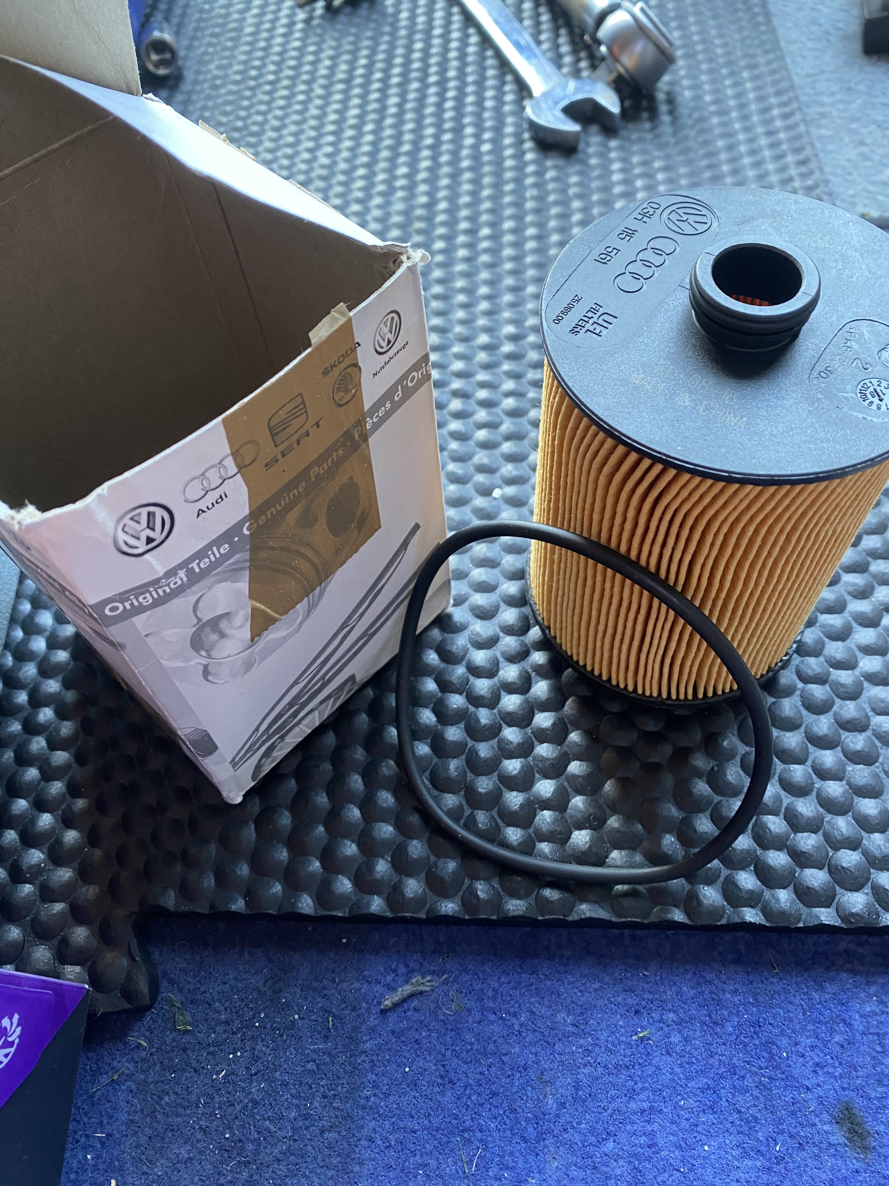

Genuine Eng oil filter and Millers oil
Haldex gen 4 oil and filter service kit
Rear Diff oil
Ive got oil for the front bevel box(transfer case) too same as rear diff oil,
all the racingline magnetic drain/fill bungs for diff/haldex and sump plug

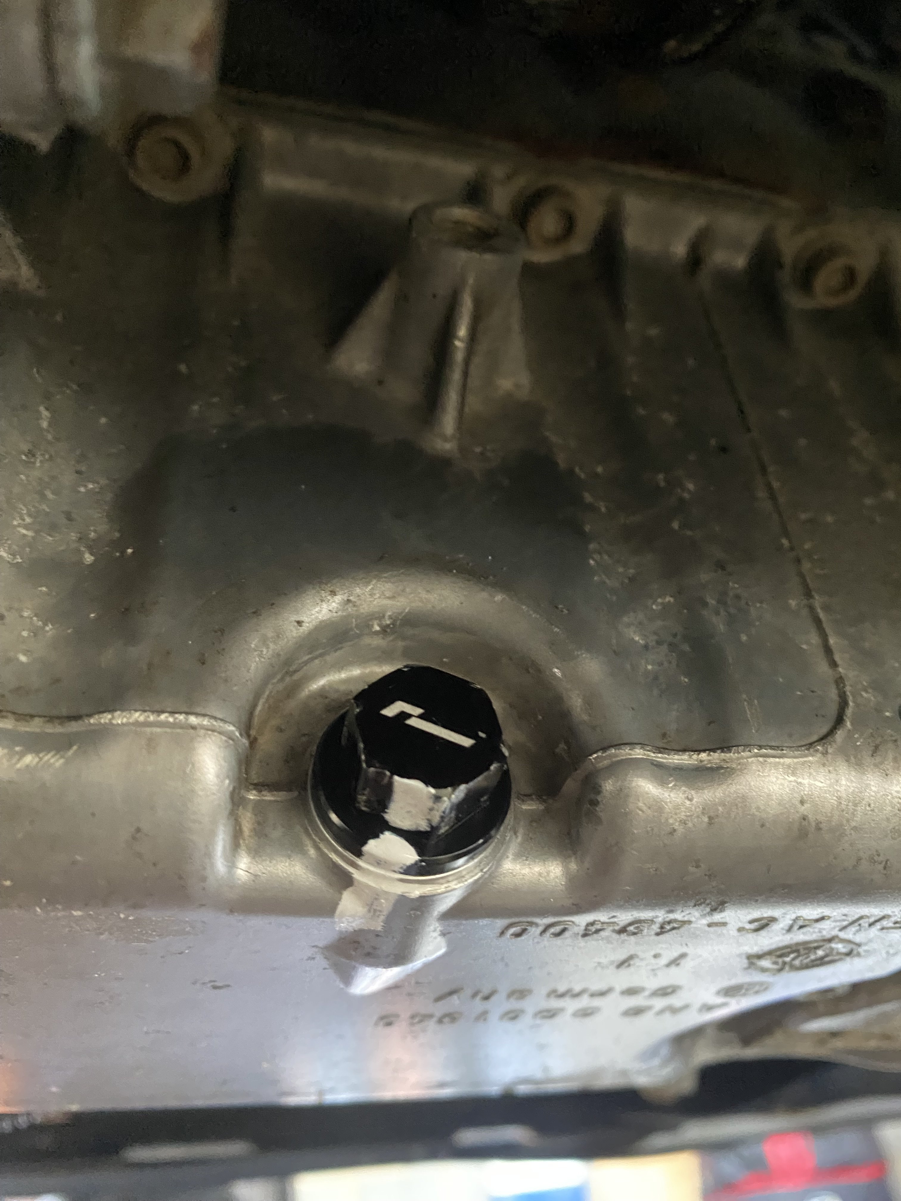

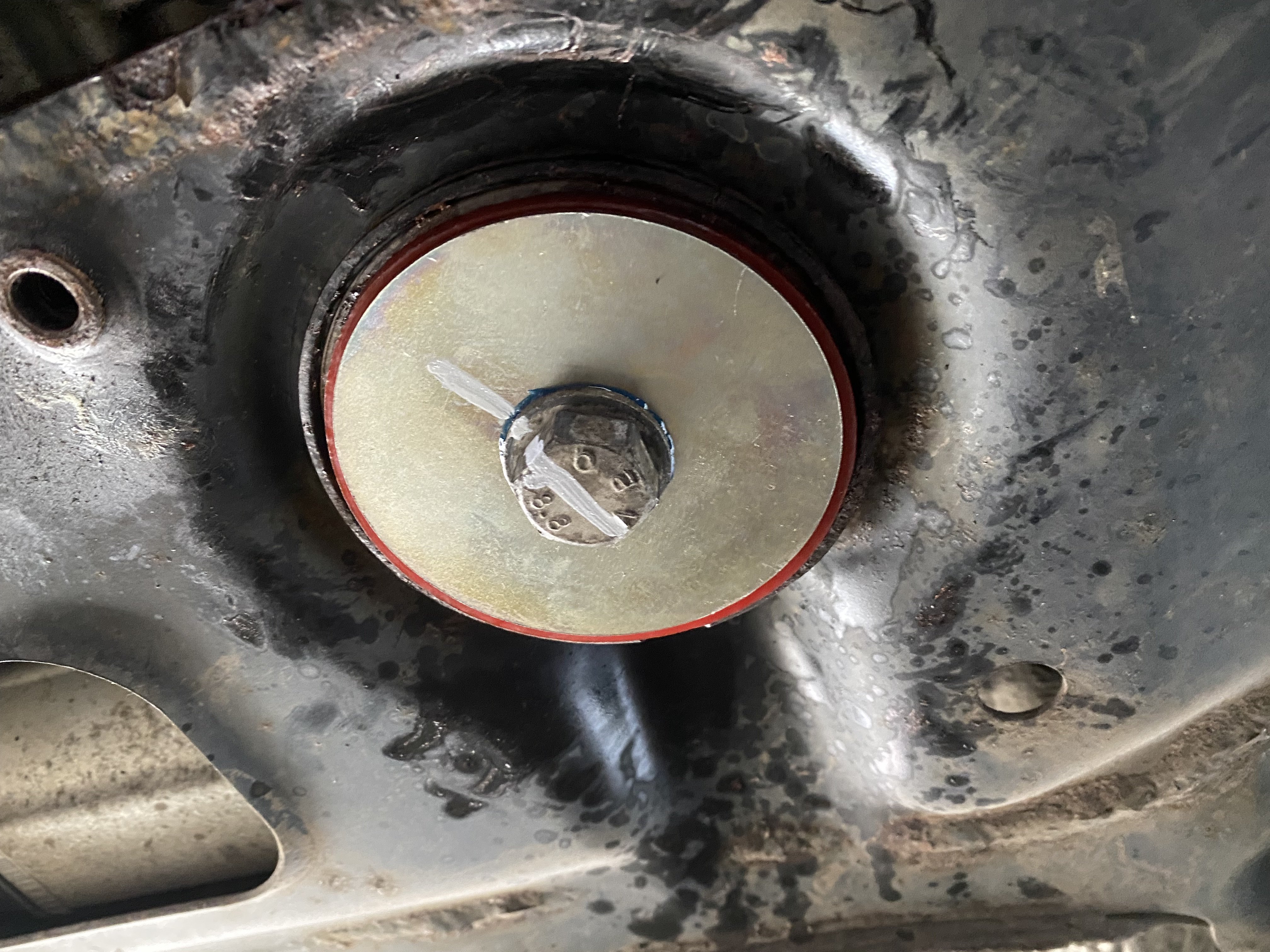

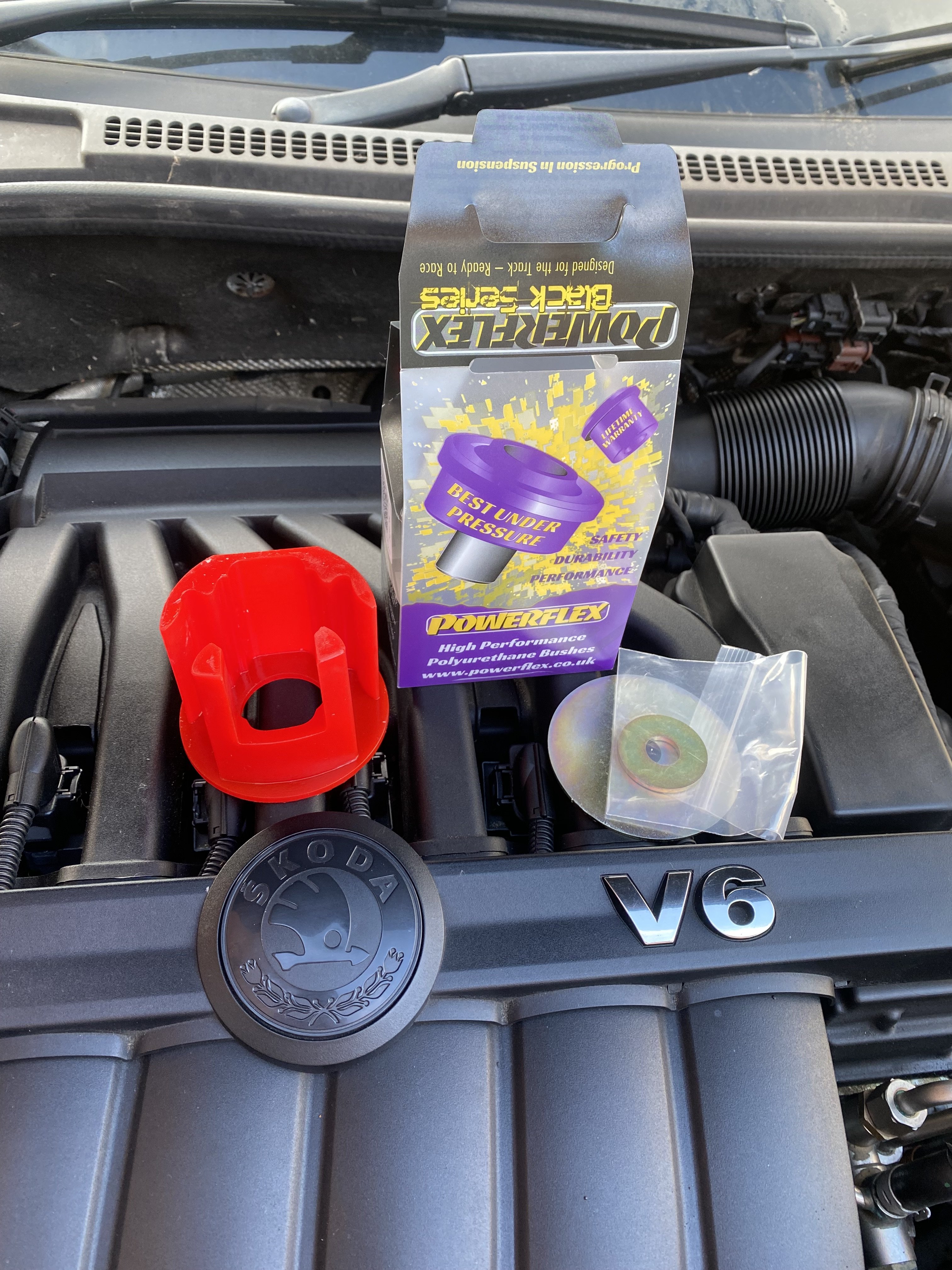

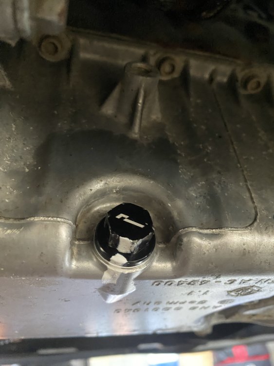

Managed to get some time on her this morning, serviced with some Millers Oil and a genuine vw filter, also fitted a powerflex insert to dogbone, went for the diesel one so I don’t get too many extra vibrations.
Topped off with a racingline magnetic sump plug. All torqued to spec of course :)

Good job Trev.

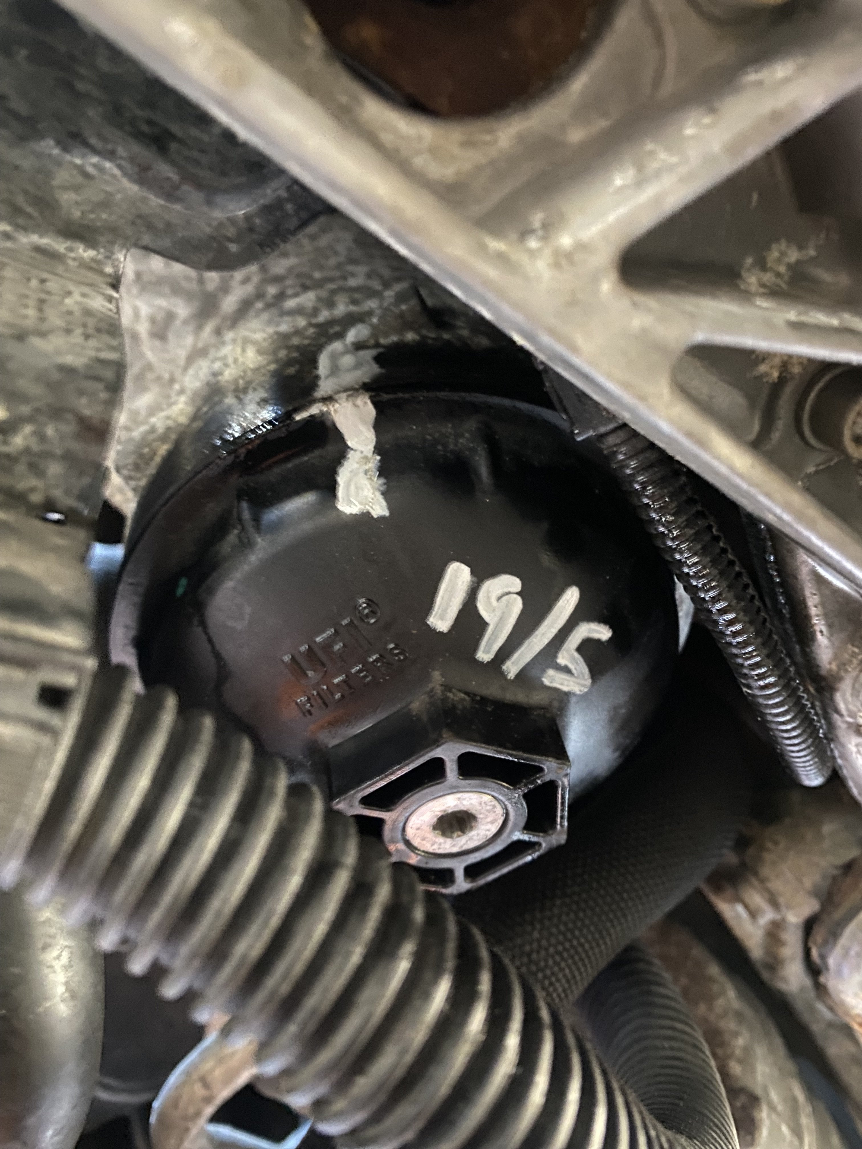

Are you marking every thing you tighten with some kind of marker/paint?
If you reuse the sump plug does the washer have to be changed every time ?
1 hour ago, gav_is_con said:
Good job Trev.
Yes just a paint pen, it’s a requisite from my day job fixing Trains so just got into the habit of doing it, easy visual way of telling if somethings moved that shouldn’t have too.
Should really change washer most sell the plugs complete with washer attached or the racingline one comes with half a dozen washers so should see me out, you can also cut off the oem washer and fit a copper washer and reuse the plug, that’s what we used to do at VW before they realised they can sell a whole plug with each service instead of pennies for a washer.

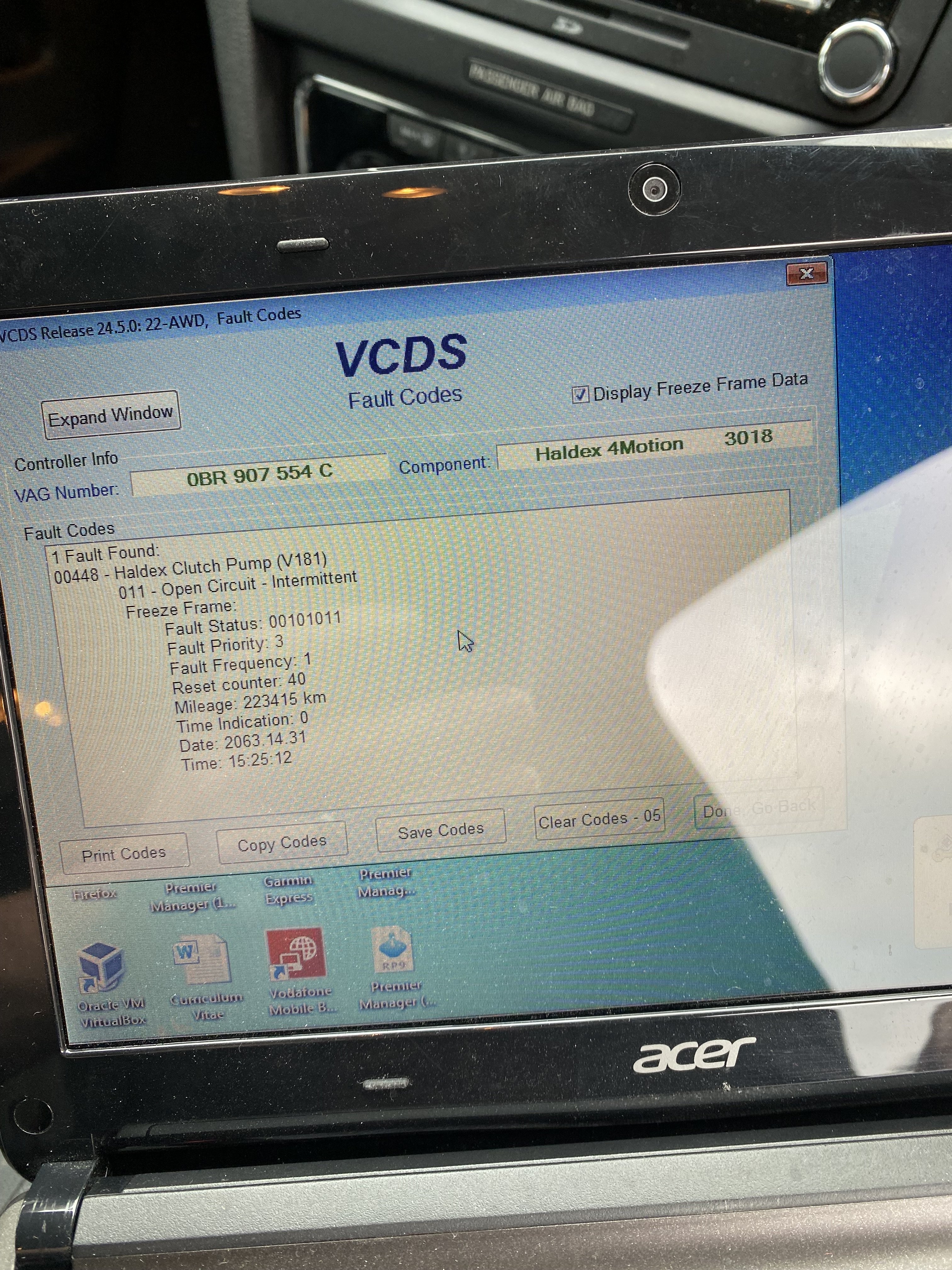

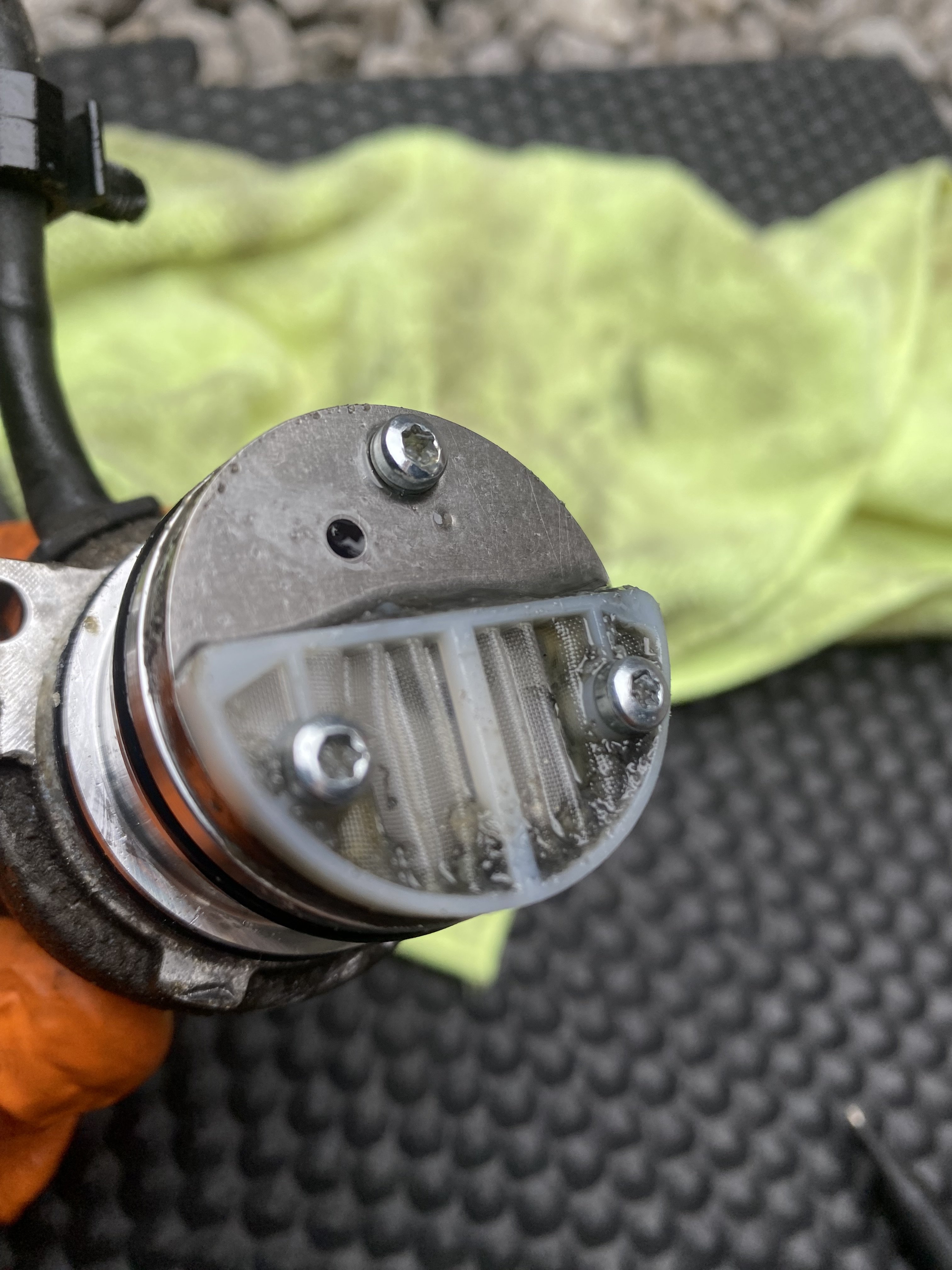

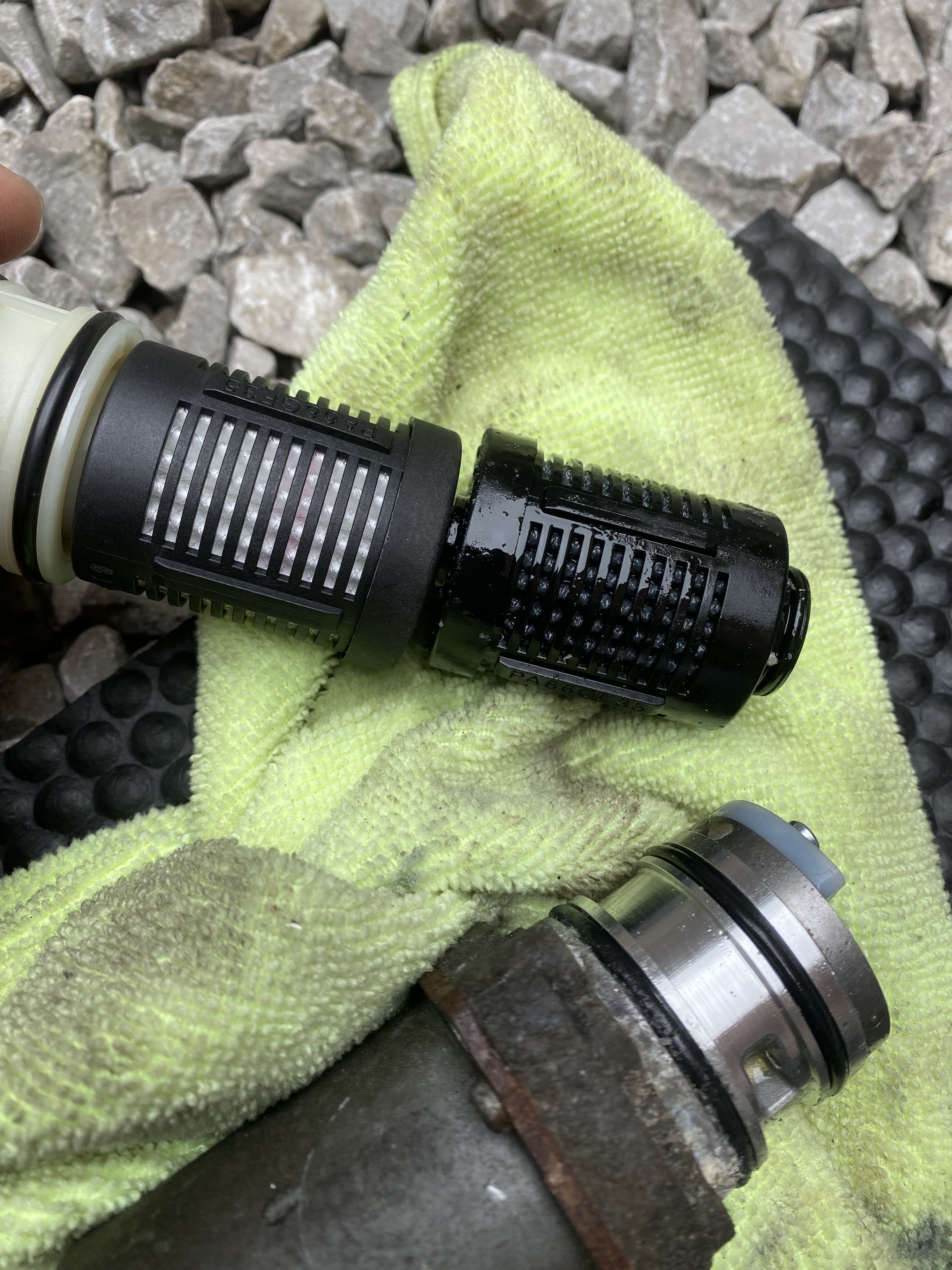

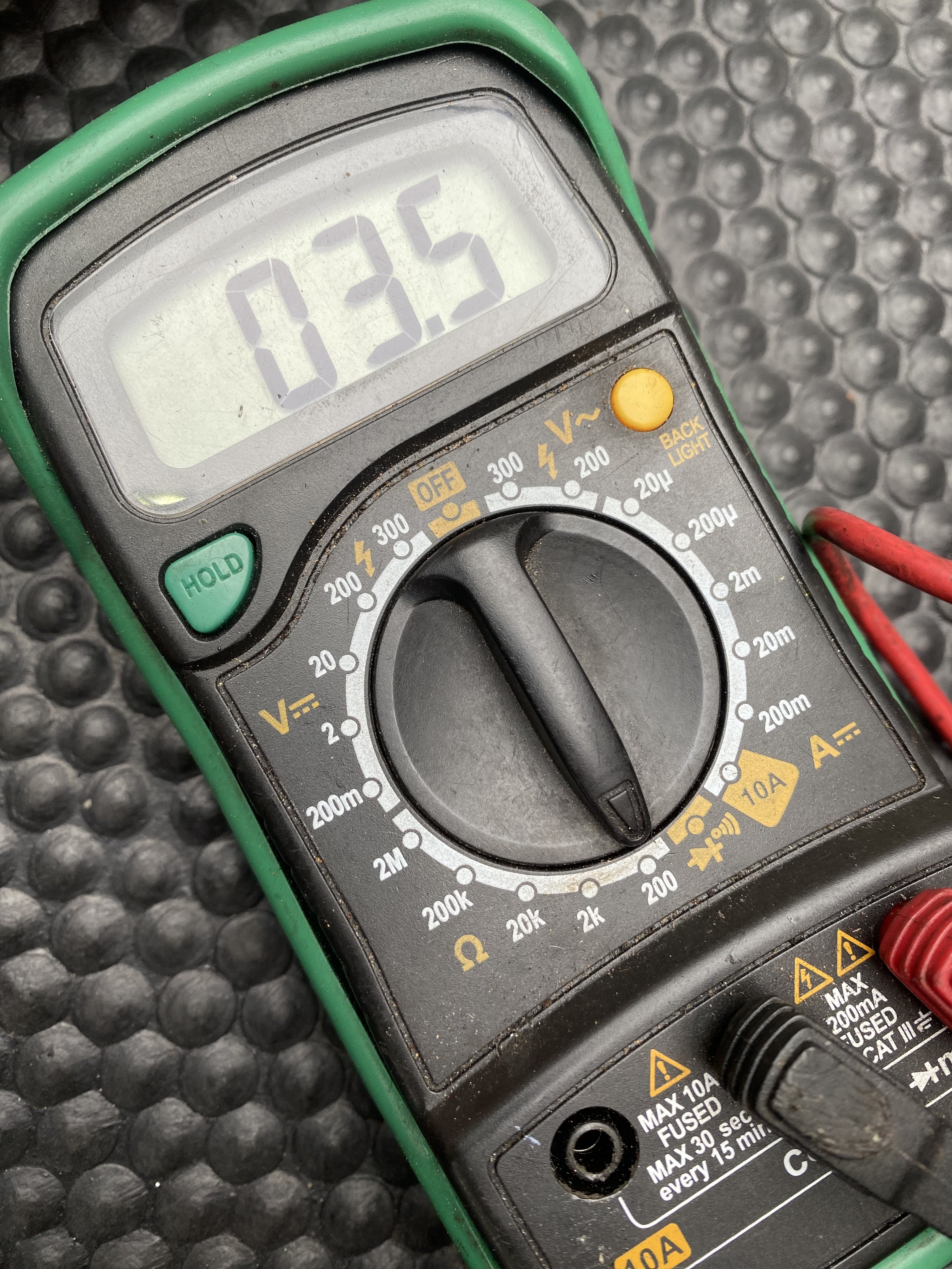

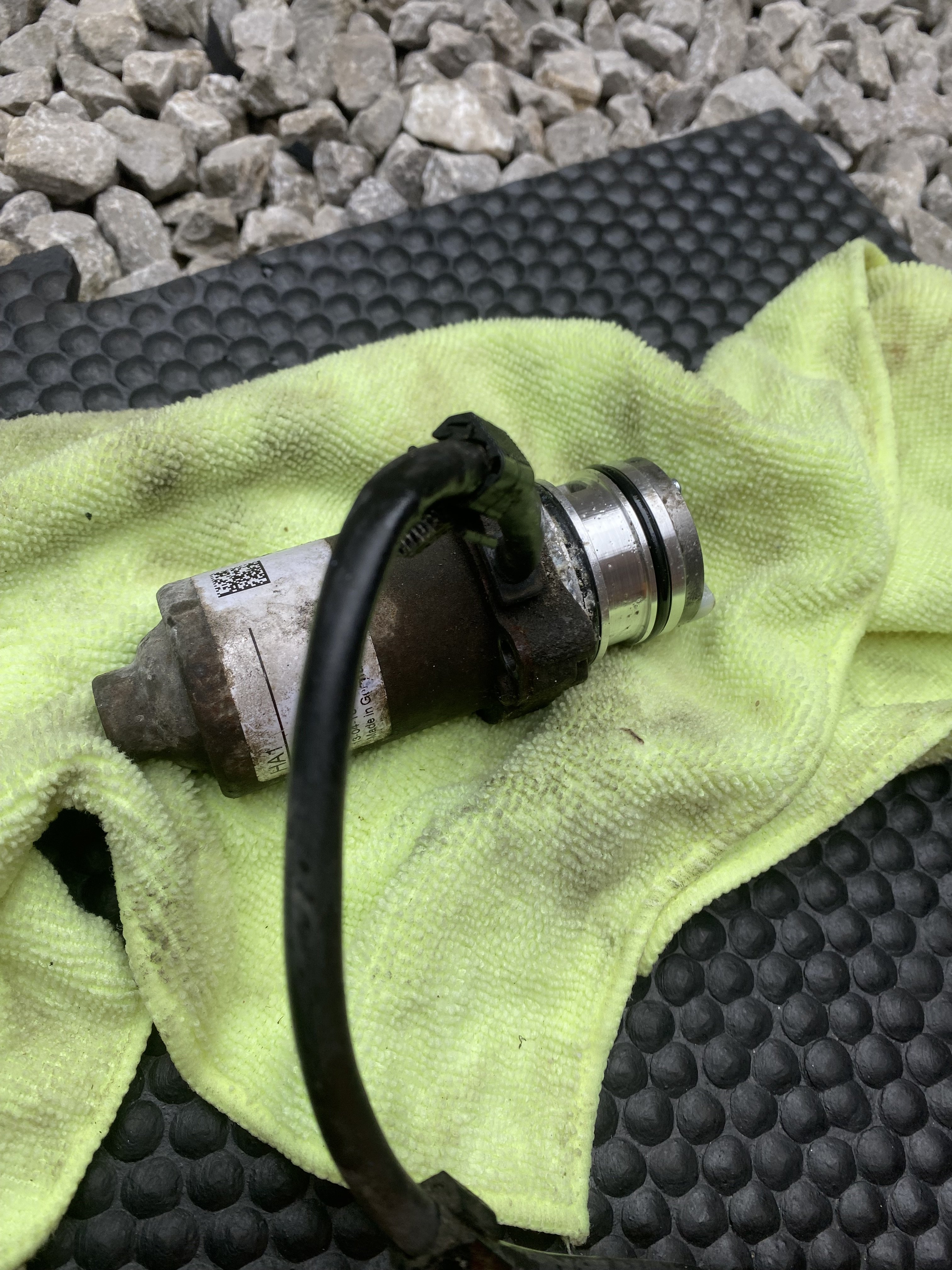

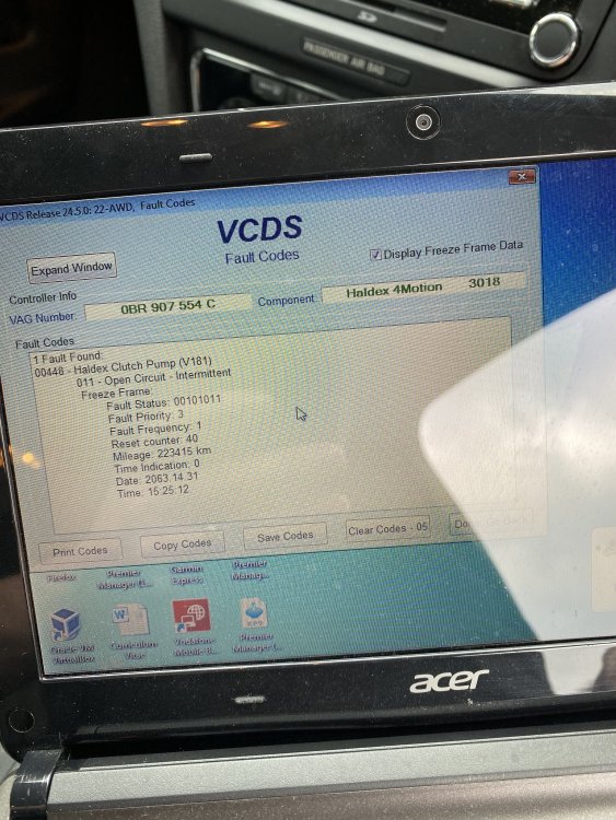

Noticed the haldex was not working, found a fault code stored with 0448 intermittent open circuit fault. Thought I’d check the state of the filter and strainer first as unfortunately not a lot of garages know they have a filter and strainer on the pump too.
The filter I don’t think had ever been off the outer plastic fought me the entire way off. The strainer on the pump wasn’t too bad.
With the pump removed, the resistance check showed it up as out of spec too low should be 5-8ohms and light tapping on the motor makes it go all over the shop so now new motor on order.
waiting to put the new filter in once the pumps here so I can prime it a little.
Also waiting for my diff oil to turn up.
amazing that the pump was still original
