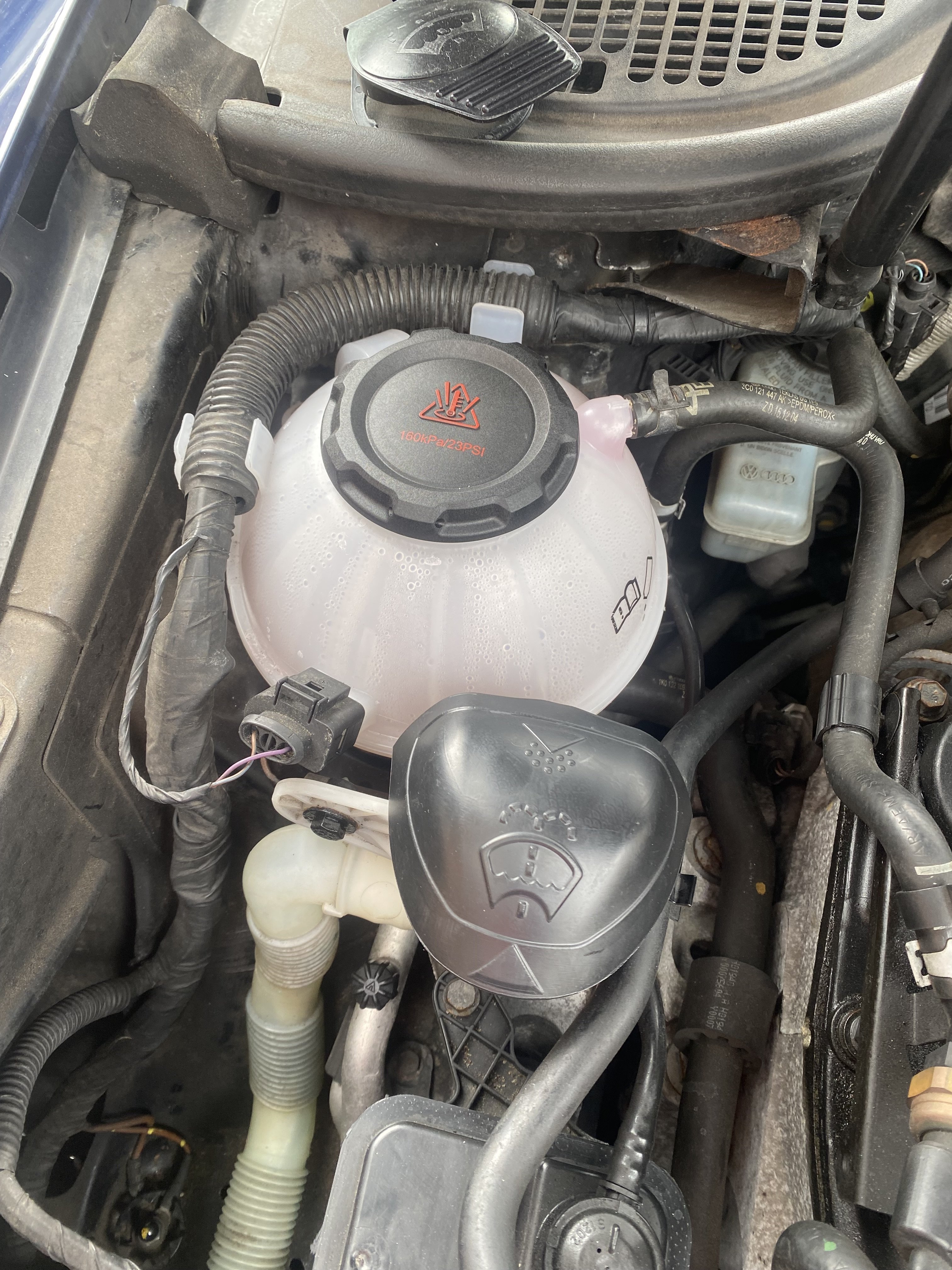

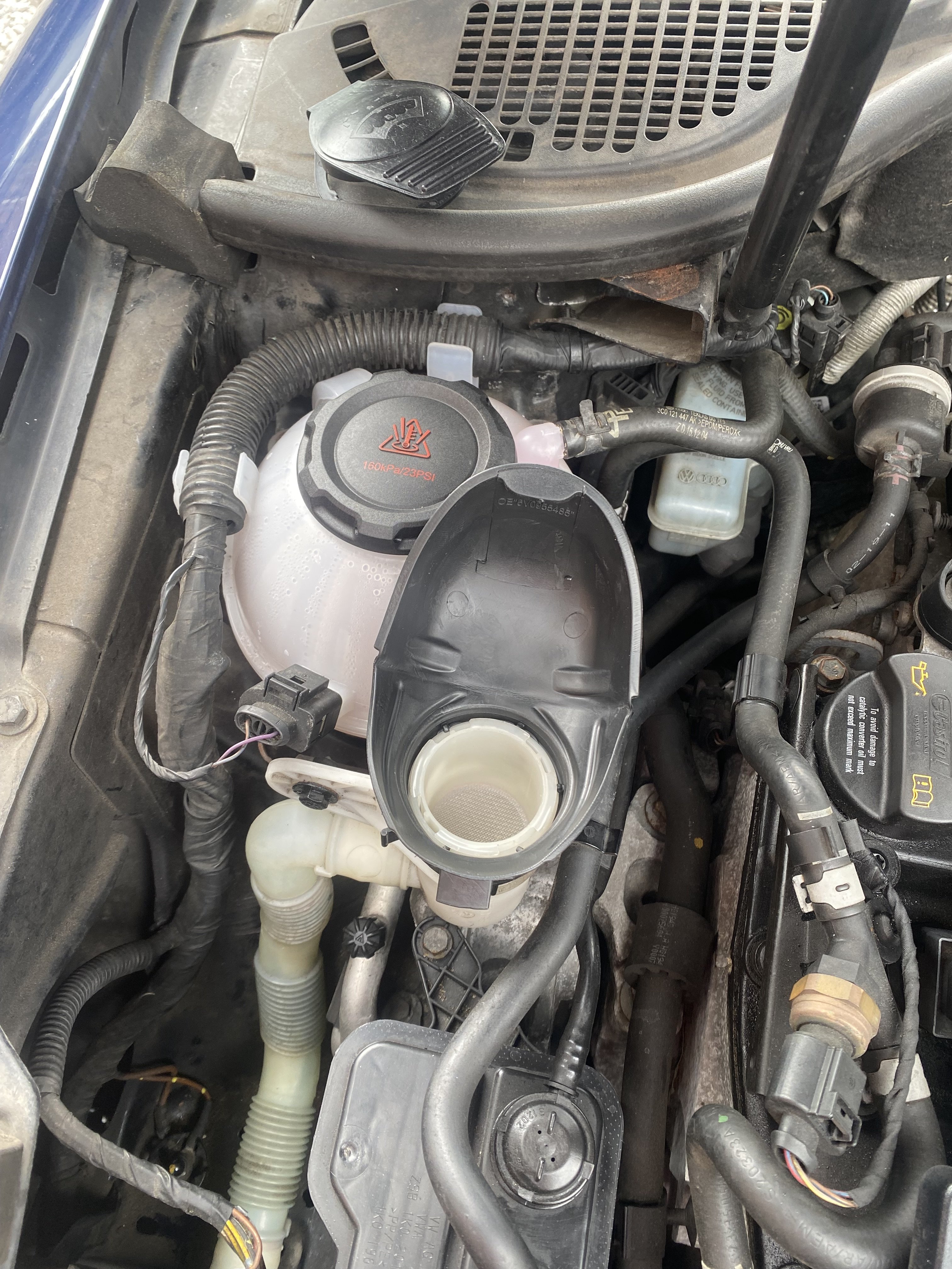

  • Coolant leak sorted and flushed through, filled up and drained pretty much All day, till I got pure water coming out, took forever but I like to be thorough, now have some lovely genuine g12+ pink coo

New washer bottle cap in the style of the later Skodas with the built in funnel but found a black one 😁

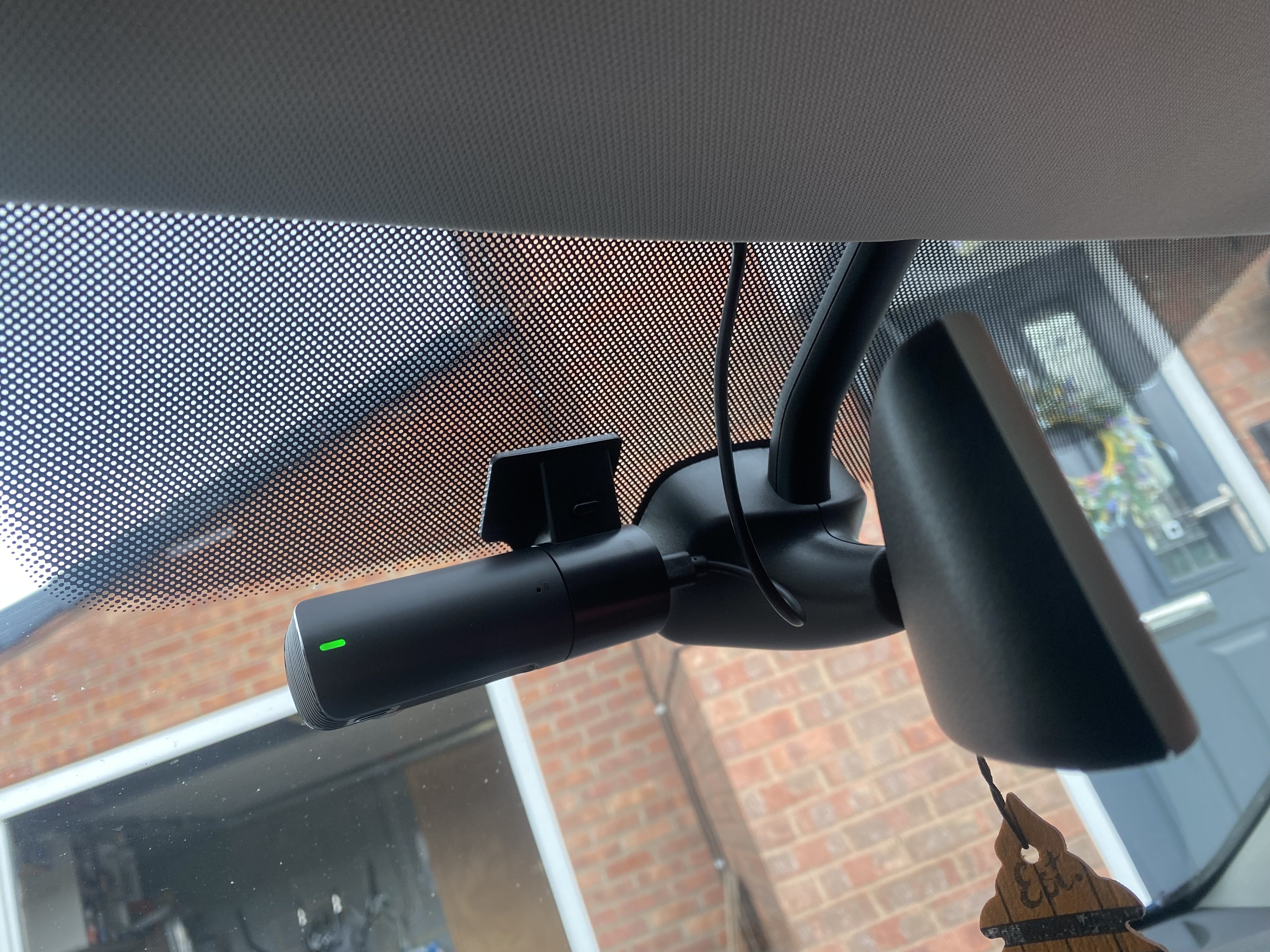

also took dash apart a little to fit dashcam as I don’t like the wires visible where possible
just required a little hole drilled under climatronic panel that will never been seen to feed wire through

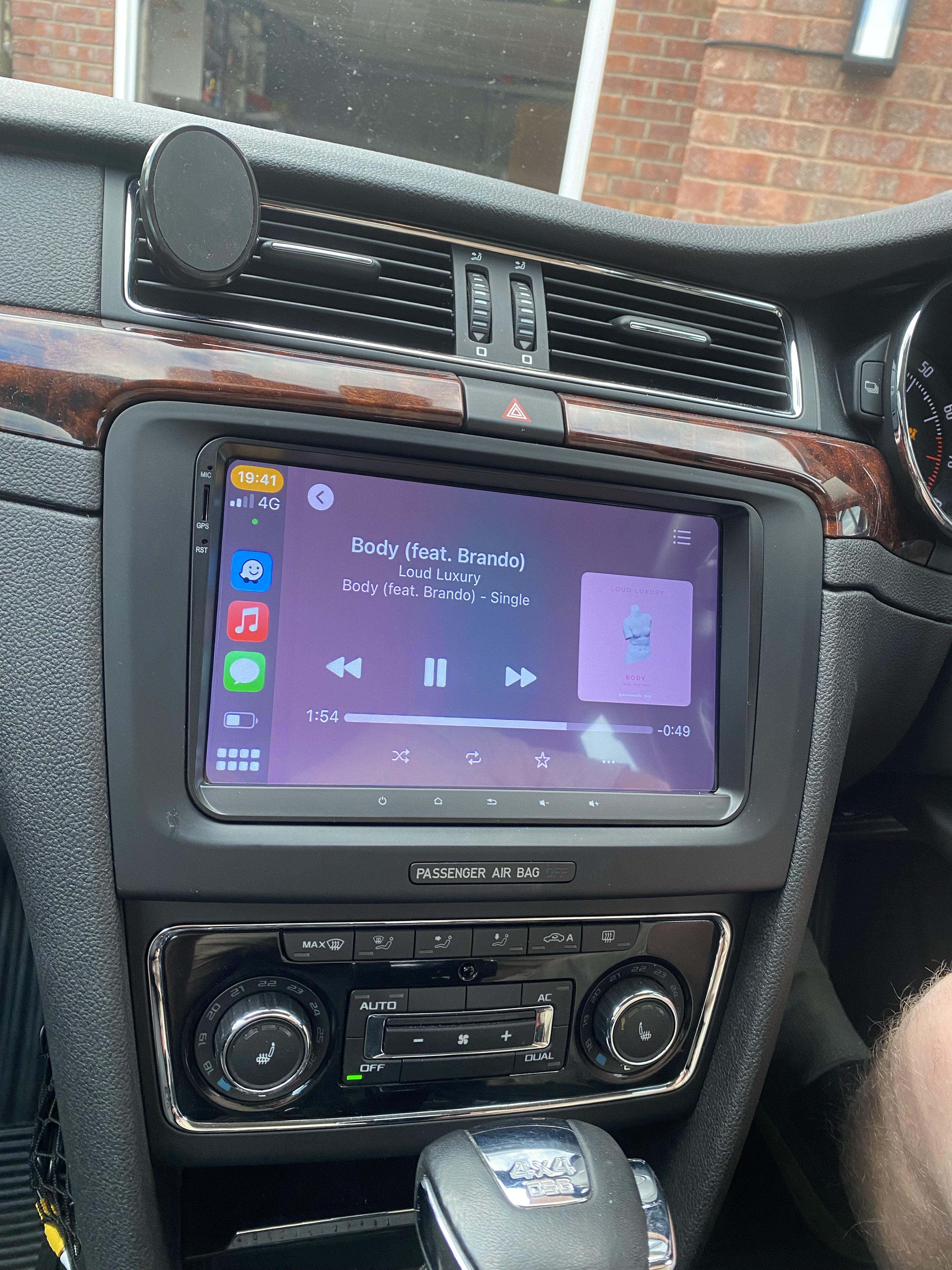

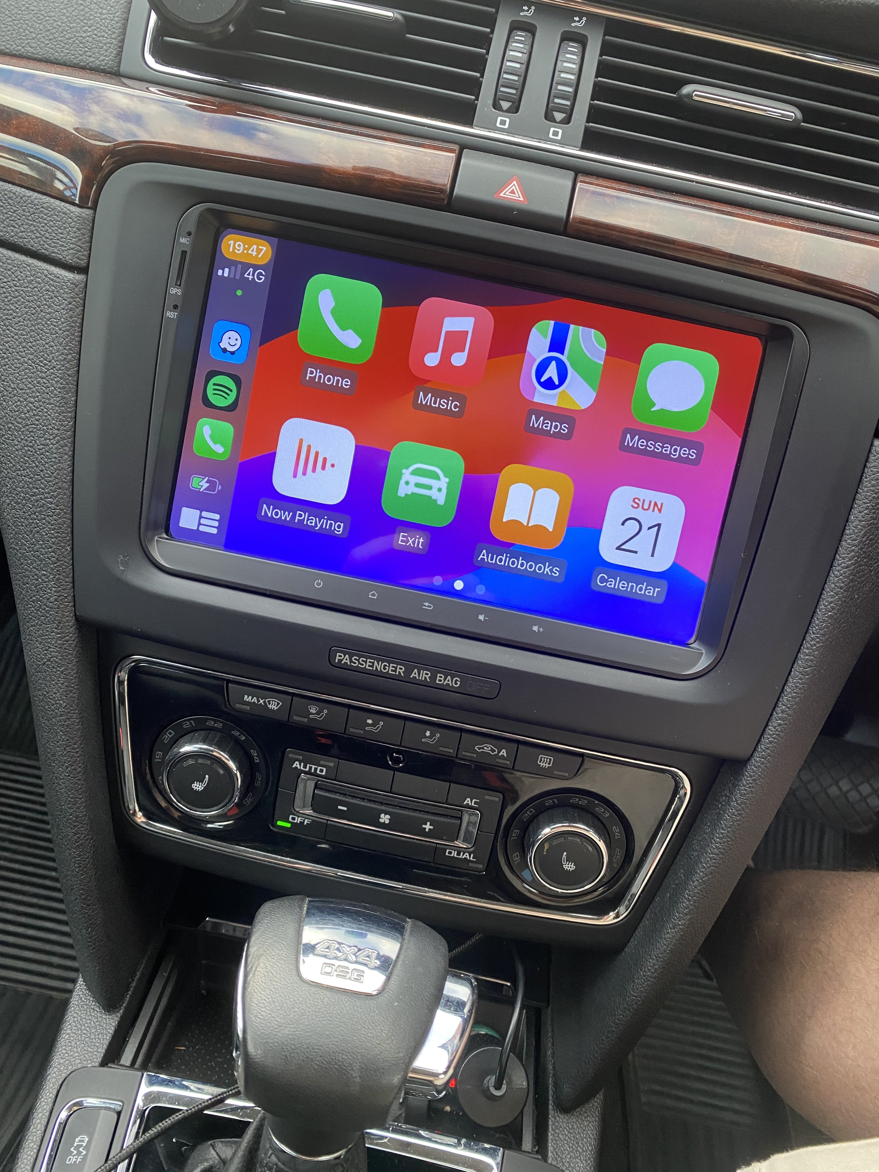

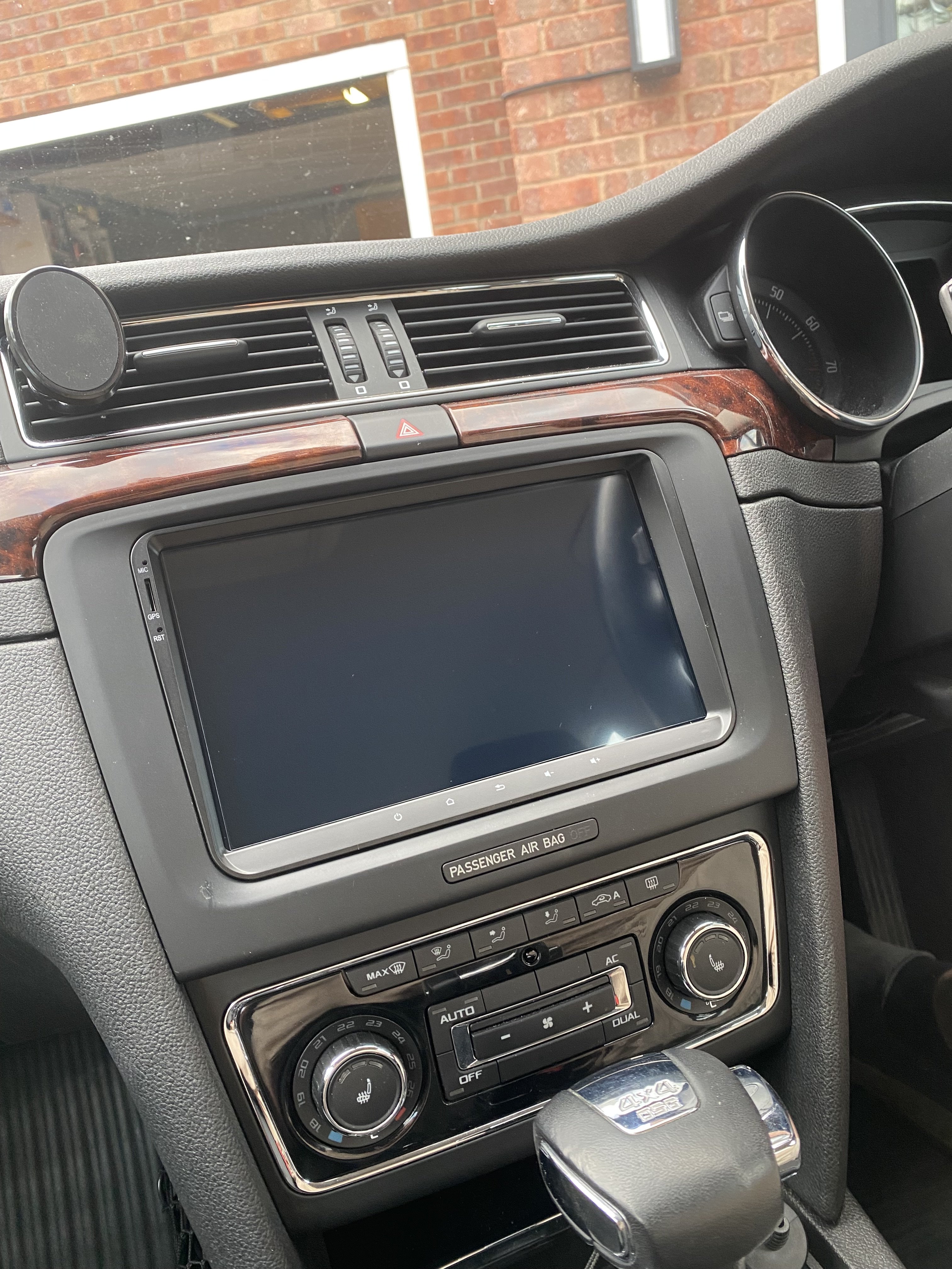

Started with an audio/headunit upgrade as I wanted CarPlay for Waze and Spotify as I use them pretty much every trip.
Went with the latest Xtrons android 13 unit, a little non oem for me but it’s a nice looking unit.

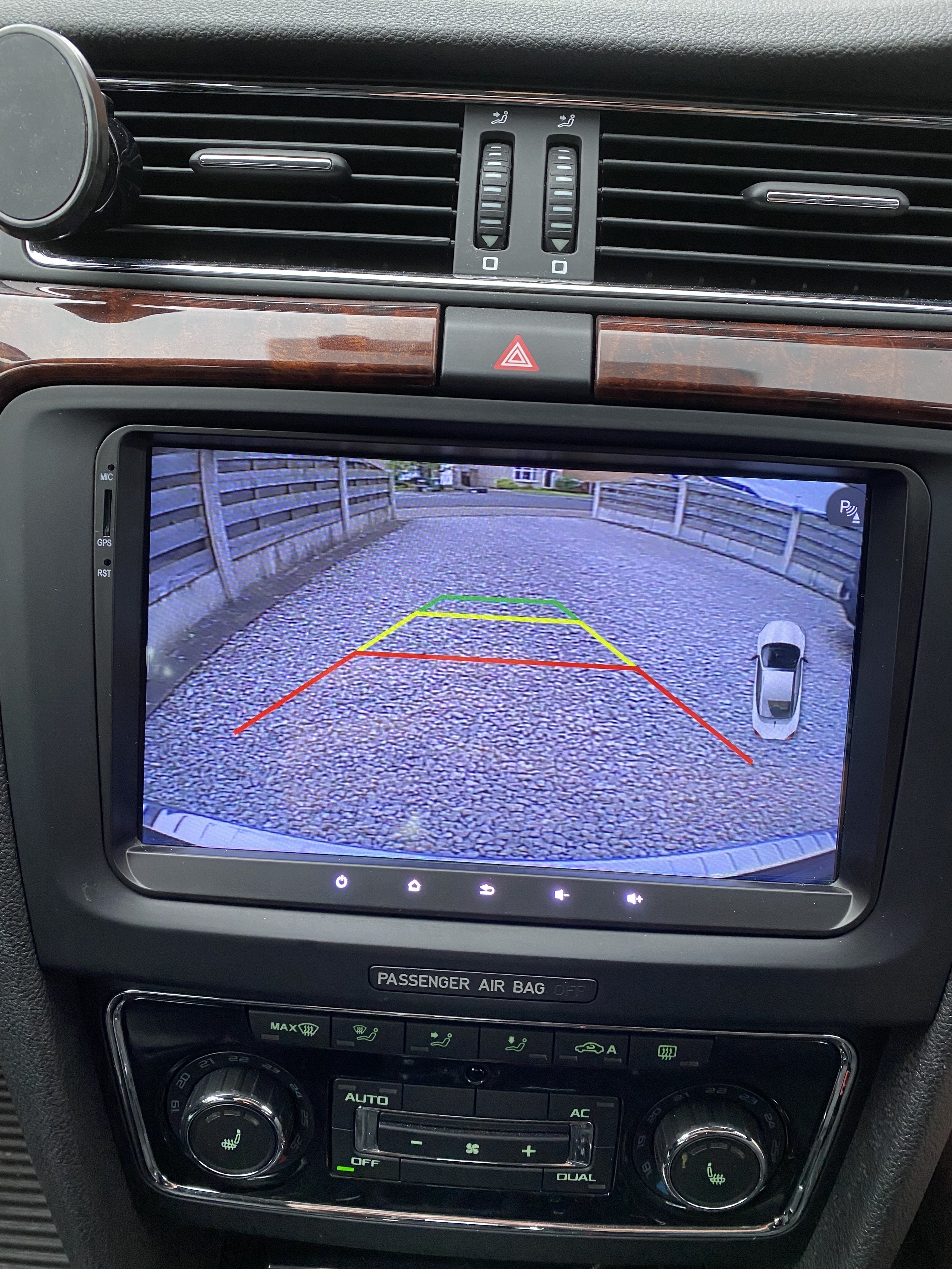

Fitted it this afternoon and pre done the wiring for reverse camera add on which will be a great addition. To finish later on.
Only fitted the gps aerial with it as I won’t be using the built in 4g capability.

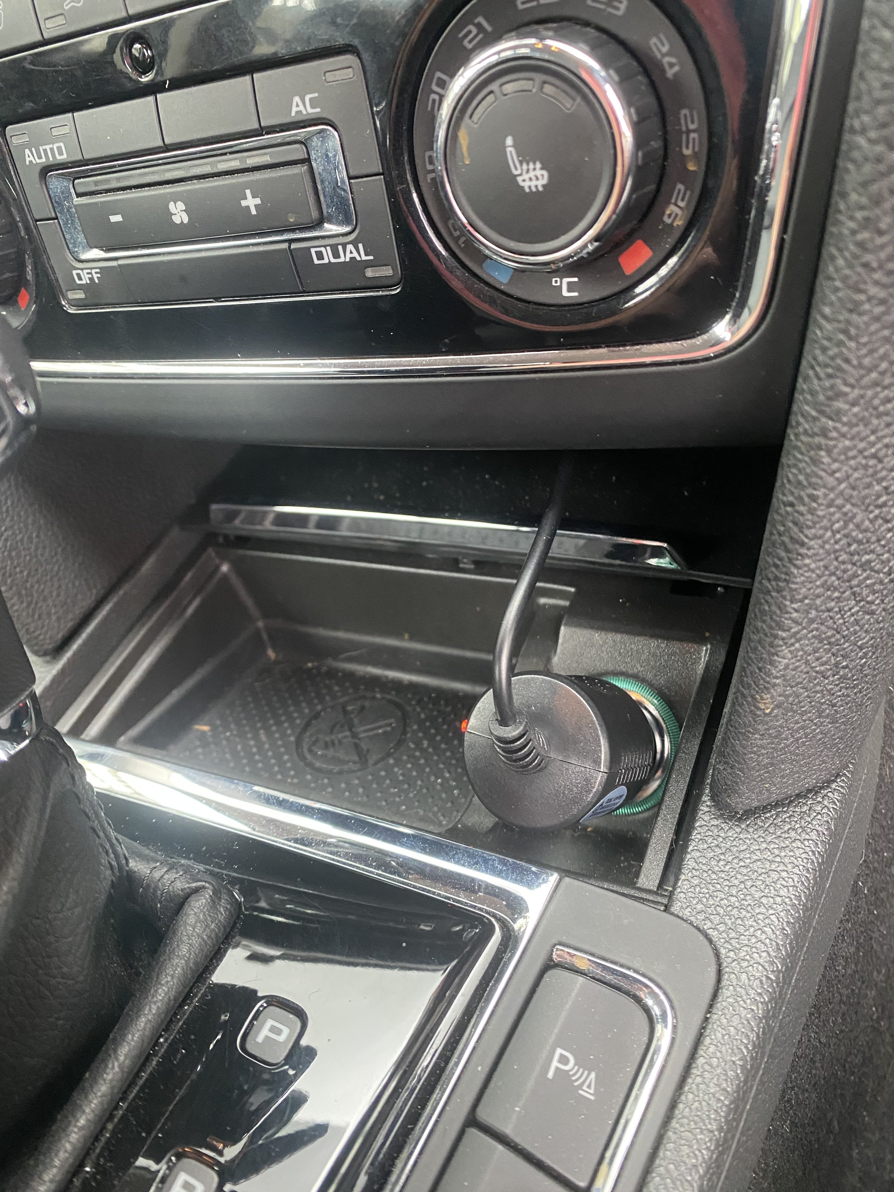

Wired in a usb to next to cigarette lighter for charging my phone.
Seems to work great out the box the sound quality is much improved, all steering wheel controls/park sensors/ac etc show up as original.

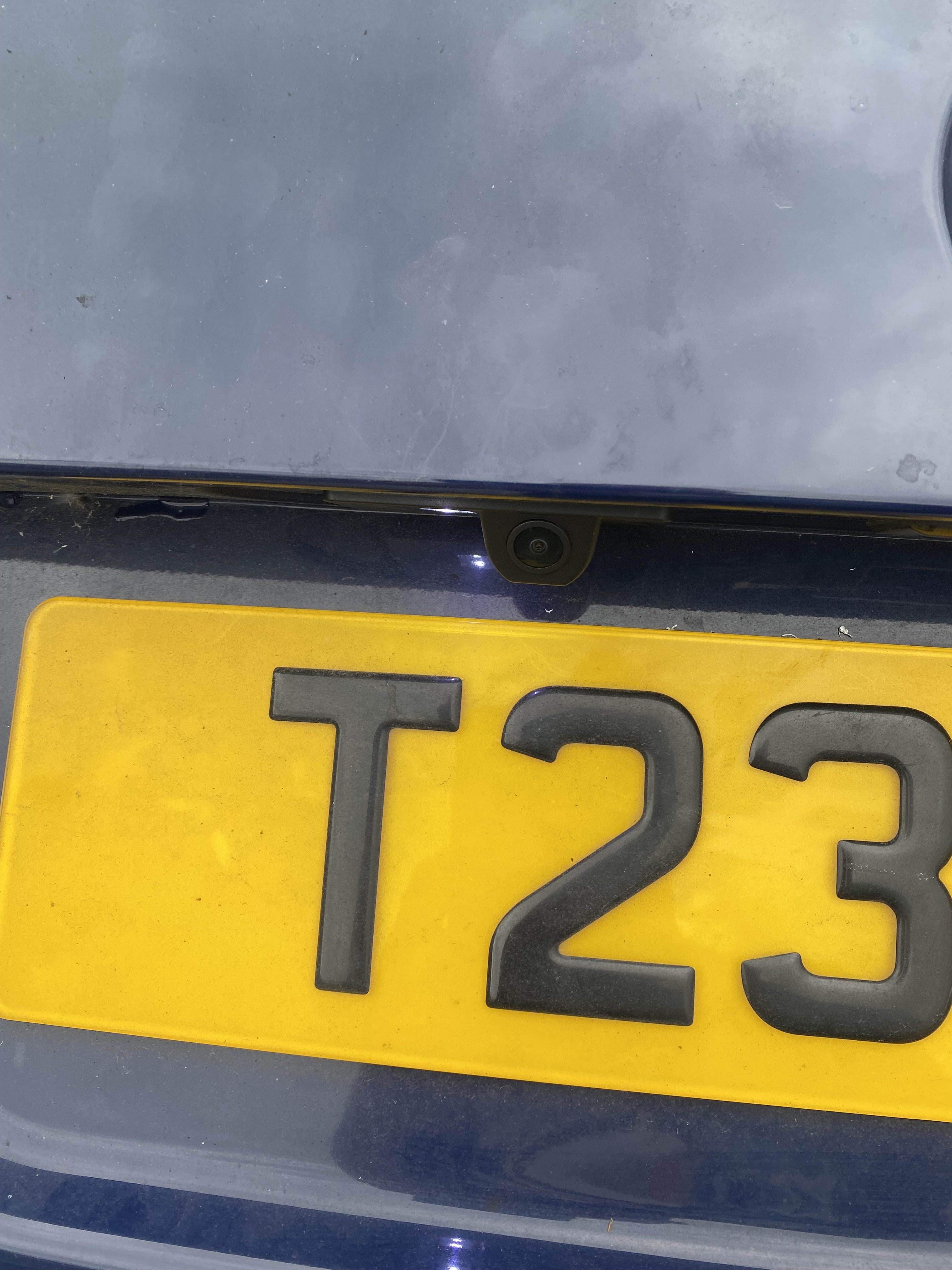

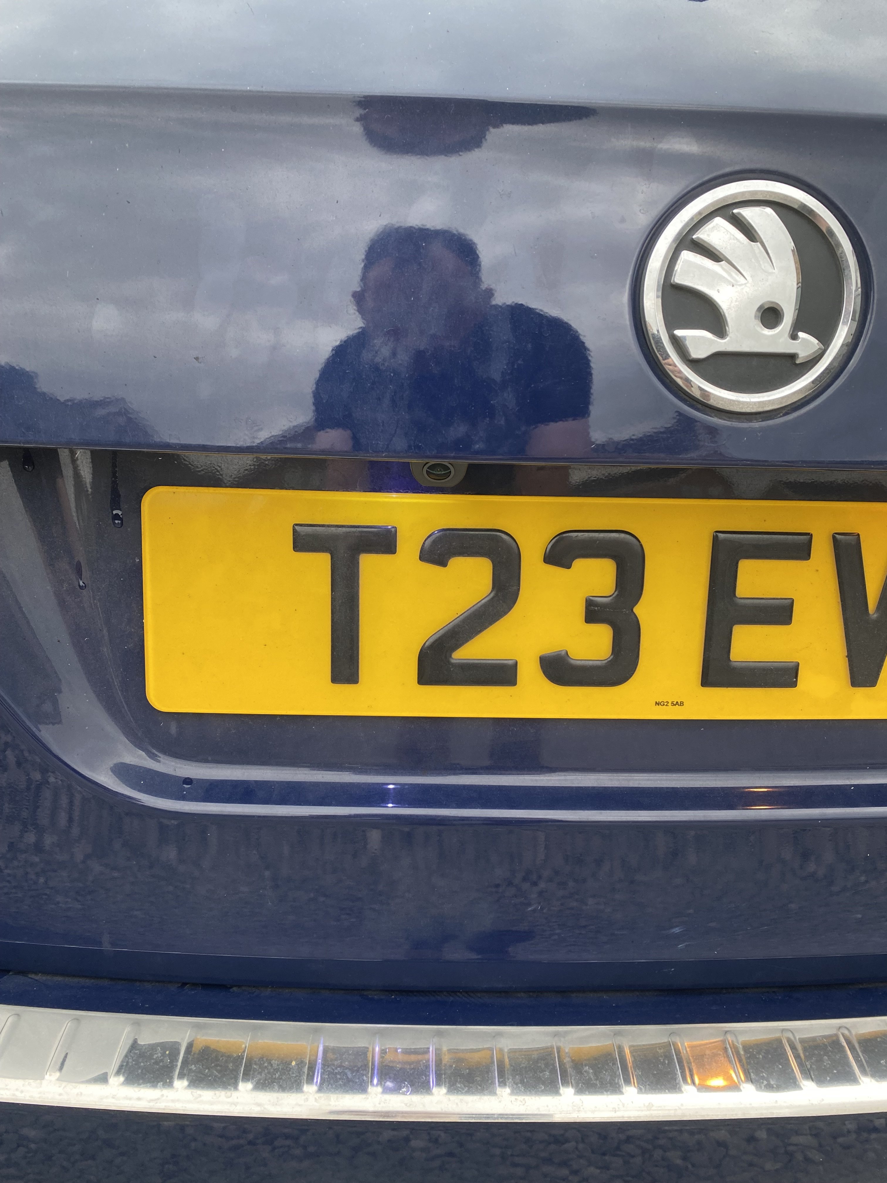

Finally got the reverse camera wired in the XTRONS one didn’t work for some reason, so brought one that has the number plate light in so a lot neater works perfectly straight away
