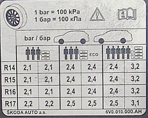

As you mentioned on Page 1 of this forum thread, Fabia Mk 3 cars' tyre-pressure sticker had three columns (as shown below)
The 3-people values in the 1st column are sometimes referred to (in VW Group-speak) as 'comfort' pressures, with the 3-people ECO pressures in the 2nd column providing potentially better fuel economy at the expense of a slightly firmer ride.
For the Fabia Mk 4, Skoda has reverted to a 2-column sticker and - having come across online requests for an explanation of how the 3-column sticker should be interpreted - I believe this is for simplicity's sake. And, for a 2-column sticker, it's understandable that ECO pressures will be provided for the 3-people loading.
I wondered, briefly, if the 3.4bar rear-tyres pressure specified on the Fabia Mk 4 sticker's 5-people column might be to counter oversteer in the event of a high-speed swerve being necessary, but concluded that it's merely close to the pressure needed when the tyres are subjected to their maximum design-load.
