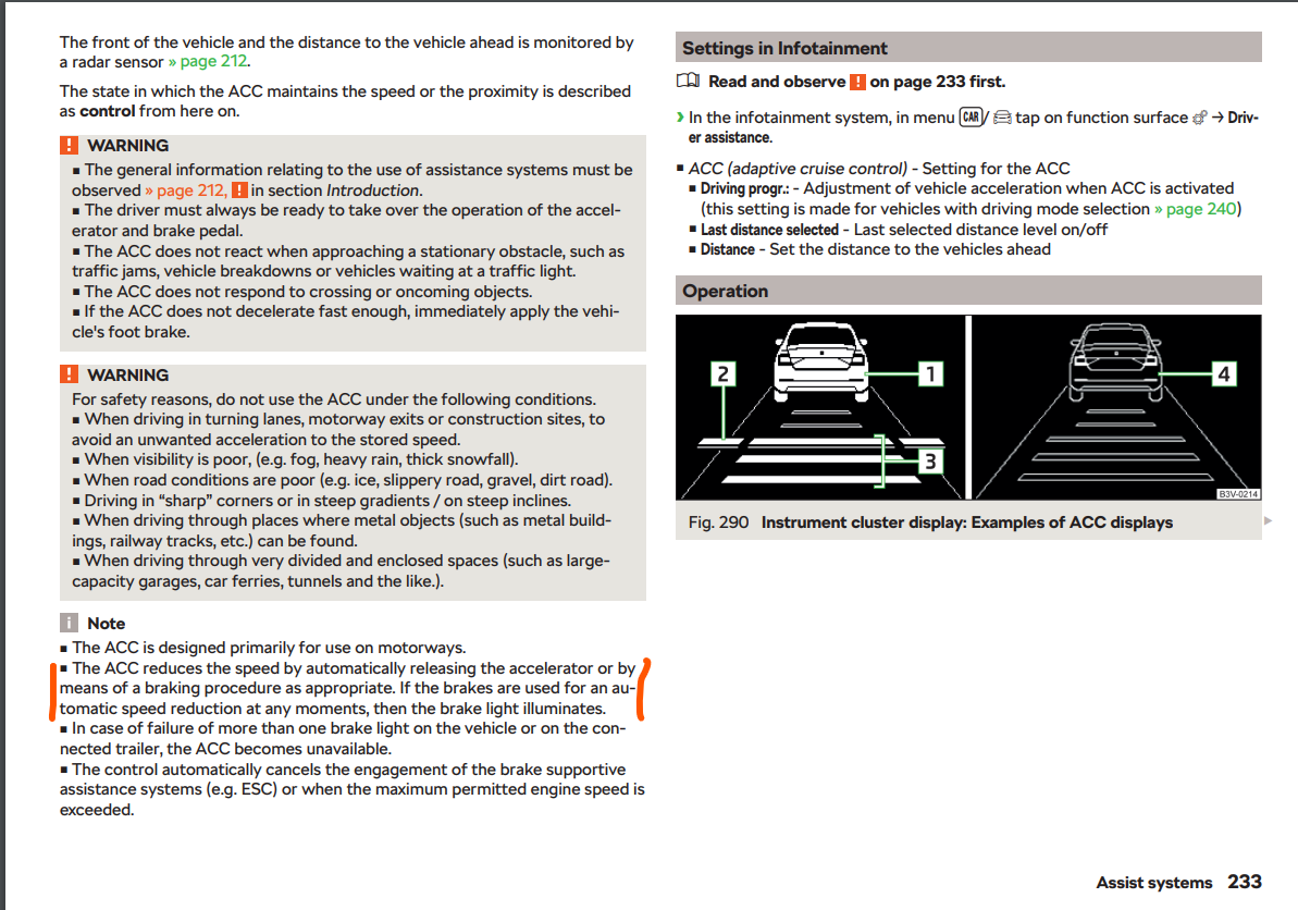

according to the hand book (for the Superb although I would have thought the Octavia is the same) the answer is yes & no :)
Thanks for that - sorry, I try very hard never to ask questions that can be answered by R'ing TFM (and I have R'd TFM) but apparently the long-COVID brain fog is really getting me sometimes these days 😞
Okay, so, it *should* do the right thing... (I still want to test it; I wonder if there are magnetic stick-on mirrors that will hold up to 100km/hr+ speeds at least long enough to see my own brake lights? 😸).
