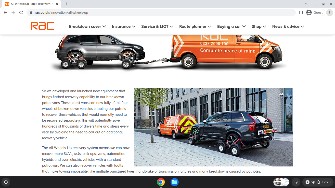

I think they only use a dolly for short trips?? But I think I'm gonna go for the new battery
could be a quick fix if not should be able to take it back.
If it doesn't start get it neutral get get it recovered back home then I know an auto technician and take it from there

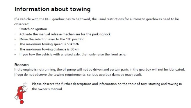

Out of interest why is it bad to tow a DSG in Neutral ?  I'd of thought that in neutral neither of the dual clutch input shafts would be turning, so I'm interested why it would matter ?

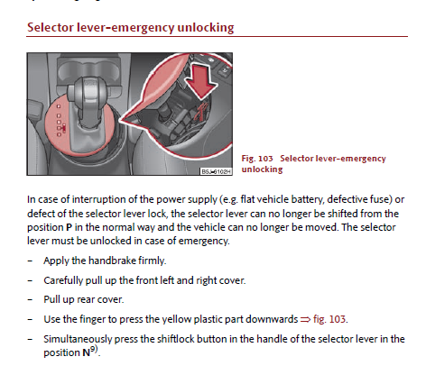

So tried to get the car out of Park as per the instructions in the owners book
but I couldn't find this yellow plastic part?? all I could see was a light blue button at the top of the gearbox housing which I managed to push down (went forward) but couldn't get it out of park but I did feel the shifter move slightly.
AP1GczOVafBQpj5rYB6c_aWYOA4vxWgdPuz9JRfxDCE3Dcwbilj6m_VRHT3_NVEqKU5AYUz1FAK2i2X4WTk7jATP8d_oXE453r22_Ef0GMyLh_mAYlriTPAeK1AuFY-4Gu1-VaJmtDpImFaWXZmZcq-P7TPAFHSdcF0x7_x8ewrfa4_pPxvTtxHMHPTDRq5Hl2r93B8jV9i0-Yx-HJFdZJh64UHaL5VqQiRb4-6SA4TJD138mw42EuOLeqE6egybc0zlJ9mSlQNOJzrgU398UnsLeIlW6cjN52dOKpa0nDywPxB3H_Iik-VWpm_z4SohtfuAH5j6niM4E6EueAmPXtcEtN0n2jNhPWczeDMvKogffQOpvkXK889iSlkS_OBVeBdD_Oxuia5Rxffwe0Himexka6r0xuKmES0w6sr2k9clucPU4j1BnVDU4a5Rr28C8wZ7_9yvPENaxeO5KgbCC6dridam8icw2I2H2RiEknoxlZEh35AF3eRFkGXCXpNE_sGrFf0BohZJWUYx5B6sxKfHQ3CVeKXiphadM9RptLKdoH_n5WMqWvVshSdRDHNBr9IVKm1akoEiO58EvFNb1lDwZKzfTCcHtIbGE7DnIypQH_8Gm3SfmYjRbyZAMVXnznmBxO-BPKmHibEjRY8LgsqNatXW5KCUT8AsZhaCJgv1hik15yjU_-vsVX7K-3_BlASN47BPWkFvC5tg_NYJ0NpK26lmT7A7mIx4R31QbZvBNJX-S3XghlPj_PDNJD0KvkVofkCZrSAIeqtvpl6iTHoggxkgxQaKx-7sQAbM8-tarYaT8vQ6aY6LLVzUPkGmm13c6NMRdK-GeVtfN2lgd8mjqPk7Esf_aJj7a8PFfnN4G21NKcvDY4LOK8X2t2H2BRzMPVijyeBvgNC7oQnv9xwpqCkU7yUih1LR7hCW_NHQvZzs6PhgT9-PMWS_gaUl=w754-h769-s-no-gm?authuser=0
So I then though perhaps the ignition should be on as well? So turned the ignition on didn't get the fault EPS up as I was on Friday when switching on the ignition.
So I tried and it started on the button no lights or faults reported on the dash drove home fine no issues. I wander if it could be an issue with the shifter, so when I stopped and put it in park it didn't hit park properly and still thought it was in gear??  If anyone has any thoughts on this.
