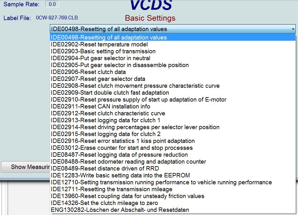

I'd like to do a re-adaption of my transmission and so far have unsuccessfully run IDE-02903 Basic Settings of Transmission, ignition on, engine off.  It starts off ok ( a few clunks and bangs heard as the transmission resets ) but after about a minute or so it will come back with a malfunction error message and doesn't finish the operation.
Thereafter I've run IDE-02906, Reset Clutch Data, IDE-02908 Clutch Movement Pressure & IDE-02909 Double Clutch Fast Adaptation successfully ( they take less than 1 sec each to complete )
I've gone no further with this as I'm mindful of the fact that some operations in 'Basic Settings' can cause big problems if carried out incorrectly or out of sequence, could anyone advise which of the below could be deemed to be Safe to carry out, ie not going to 'brick' the transmission.
My DQ200 clutches are still slow to engage during gear changes with revs rising 500 - 2000 rpm when shifting, and the recent injection of £2.5k has achieved absolutely now't.
