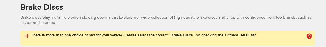

On the europarts website 1zE 1ZS are 276mm and 1ZG are 256mm discs
If you input the details Kamiq 1ltr 2020 it shows both and tells you to check before ordering
Screenshot2024-05-07at21-32-52BrakeDiscsFrontRearBrakeDiscReplacements.thumb.png.57fca234aa13dd3adcf04b3bcb62515b.png
The fitment detail tabs just show the dimensions and do not offer clues to model or spec of the car
I always measure the disc diameter before buying. You can normally see what the possibilities are by what gets offered for sale againat your vehicle.
So above it shows 256mm or 276mm, a quick measure would confirm which you have.
