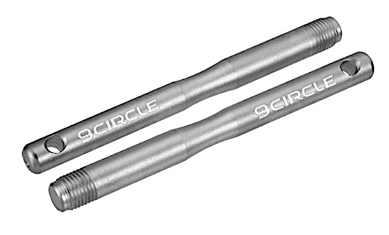

I'm an 80-years-old male and weigh a weedy 52kg. Removing and replacing my Skoda Fabia's wheels at home is fairly easy without using the type of tool being discussed above (I took the alloy wheels off soon after buying the car to give them a good waxing and check that the steel spare-wheel would fit), but carrying out a single-handed road-side 'emergency' wheel change would be a real challenge without some means to safely hang the wheel on as it's replaced on the hub.
As I said above, an alignment tool suitable for the Fabia's wheels is widely marketed and (as nta16 has highlighted) the quality varies. A good quality alignment tool will be made from strong metal (You do NOT want the threaded end to snap off in the hub!), be smooth and - if possible - have a 'tommy-bar' hole in its outer end to aid insertion/withdrawal. (Examples here)

DerekU those alignment tools look a lot better than either of the ones I have.

1: The 9CIRCLE=branded tool is an American product and expensive even in the USA. It was just an example of a tool with a tommy-bar hole.

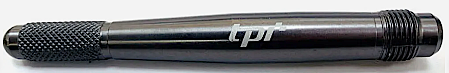

I have one of these
Its light weight suggests it's some sort of alloy. It has a hard super-smooth black (anodised?) finish, is very nicely made and is easily inserted and removed from the hub's bolt-holes. I know it still works OK as I used it when removing/replacing a wheel on my Skoda Roomster yesterday! If I remember correctly it cost about £9.
