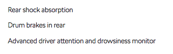

As Tintowellfan has advised, ALL new 2024 UK-specification Skoda Fabia Mk4 cars that have the i.5litre motor have rear disk brakes as standard.
The Fabia configurator 'sequence' that will reveal this is Trims/Engines/Summary /Standard Equipment/Safety and Driver Assistance.
Taking the Fabia SE L trim as an example, in the Safety and Driver Assistance section the following extract applies to all cars irrespective of their engine size
Towards the bottom of the Safety and Driver Assistance section, for SE L trim Fabias with the 1.0litre motor, this appears
but, for SE L trim Fabias with the 1.5litre motor, this appears instead
(Logically, it would make better sense to have the type of rear brake fitment ("Drum brakes in rear" or "Disk brakes in rear") immediately below the "Disk brakes in front" entry, but there you go...)
So, to summarise. for 2024 UK-specification Fabias, all cars with the 1.0litre motor will have drum rear brakes (with no option to specify disk rear brakes instead), whereas all cars with the 1.5litre motor will have disk rear brakes.

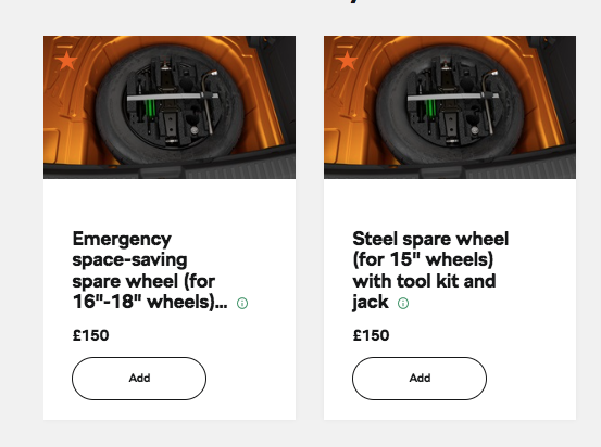

The Fabia Mk4 options list for the 'entry level' SE Comfort model includes two spare-wheel choices as shown below
This makes sense, as the SE Comfort model has 15" wheels as standard, with 16" wheels as an option.
The Fabia SE L model (like mine) has 16" wheels as standard, with the option to choose 17" or 18" wheels, and the only factory-order spare-wheel option listed is the first one (Emergency space-saving spare wheel (for 16"-18" wheels)).

The implication of the two Skoda spare-wheel options seems to be that - if a Fabia has over-15" wheels - a space-saving (skinny?) spare-wheel should be chosen, but the 15" spare-wheel fits OK on my car's hubs and in the car's spare-wheel well.
I can't confirm what you'd get if you ordered the 'space-saving' 16"-18" option as I've never seen it, but, if you take off one of your car's 17" wheels and see if it will fit in the spare-wheel well, you'll know whether a non-skinny wheel/tyre would go in.
(It may be that Fabia's that come as standard with 17" wheels (eg. the Monte Carlo) have larger front discs and the 15" spare-wheel won't fit over the discs - but that's just a guess...)

Thank you so much for this detailed reply to my query DerekU, and so quickly too! Your suggestion that I try fitting one of my wheels into the spare stowage in my boot is a good one which I'll check out, but I rather suspect that it won't. Hence the space savers/speed restricted for larger than 15" fitted wheels. Your link to the ebay offer perfectly illustrates the wheel tyre combination needed, plus of course any associated tools. A great response to this newbie's first post. I only hope that I can be half as helpful to others in future. Again, much thanks!
Basically same diameter as my 215/45x17" OE Monte carlo wheels/tyres.
Don't understand the two listed options, as I dont see the need for any different wheel/tyre combination than the one I have in my boot as it should fit any model of fabia.
