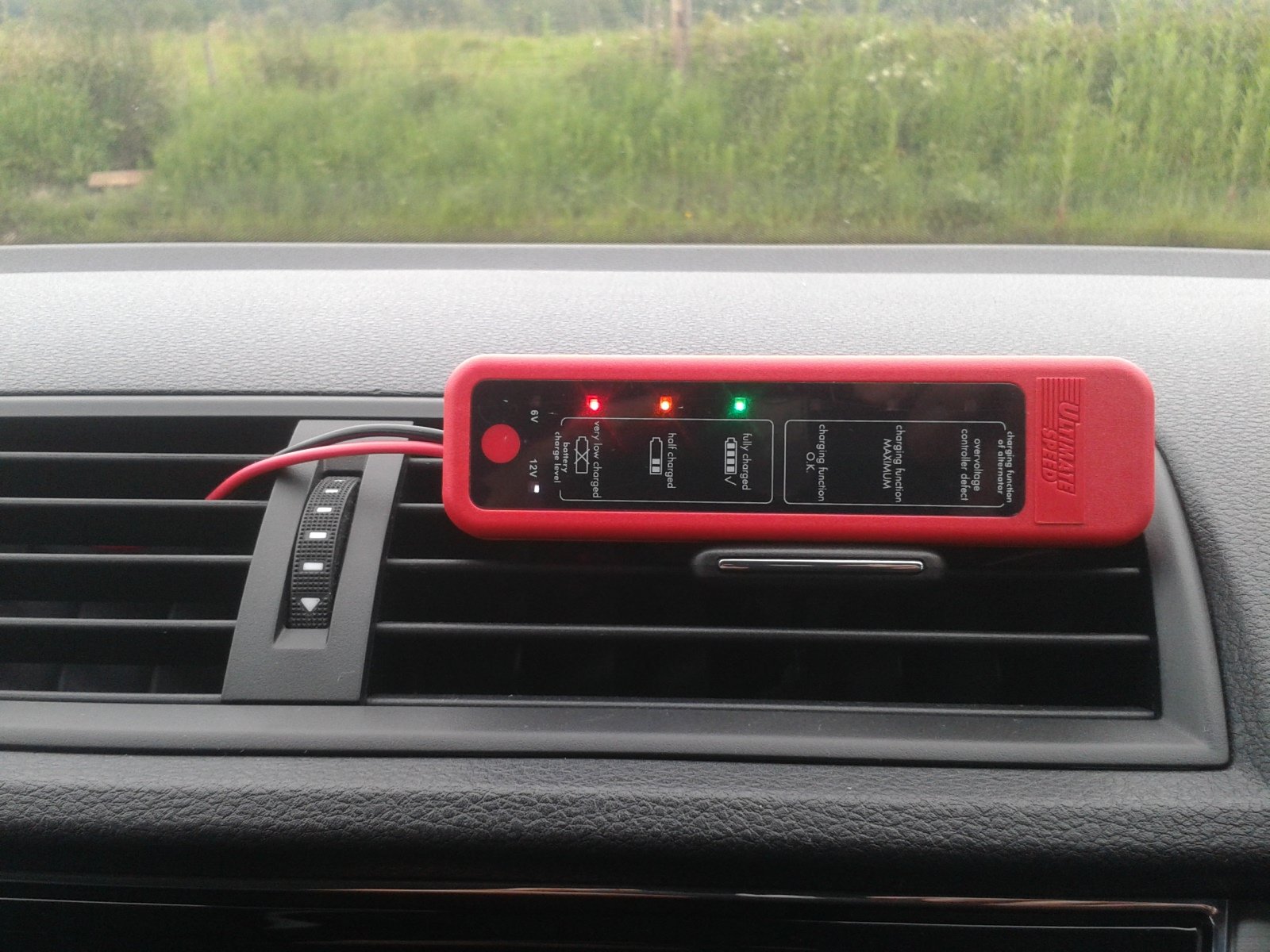

I've got one of those cheap battery / alternator testers that Lidl where selling a while back, put a cigarette lighter plug on the end of it and been using that.
That can just live in the glove box then. Would be nice to have one that had better resolution over the window of interest but does the job.
Actually i just picked another one up yesterday for £1.19 as they were selling them off. Mainly to see how accuracy is compared between them.
It goes green at around 12.5V then amber, then red below around 11.5V. Then the higher voltage alternator LEDs kick in.

Tester can live in the glove compartment. Its actually cleverer design than you might think. Its uses a PIC micro so its all done in software from the A/D readings it takes.

Over V Chrg Defect    15.32V
Chrg Func Max           14.33V
Chrg Func OK             13.06V
Fully Chrg                    12.47V
Half Chrg                     11.90V
Very Lo Chrg               11.50V
Edited by Gonzini
