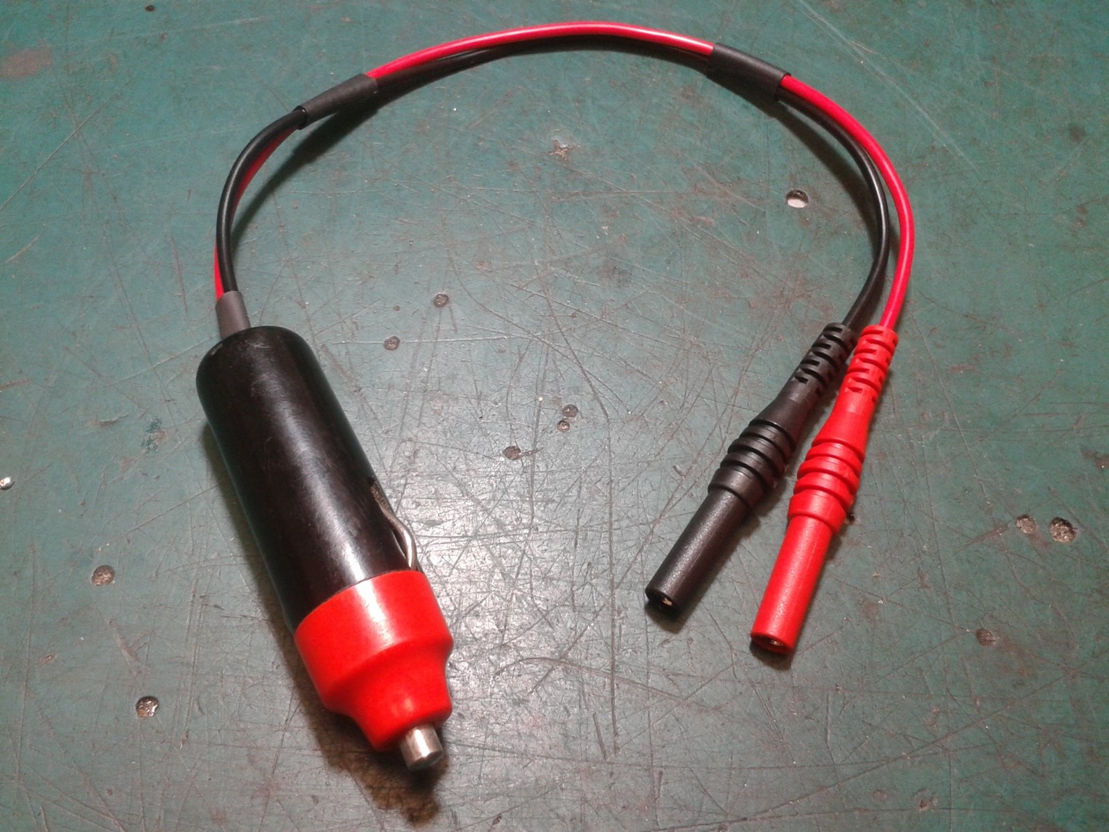

I've just made up a cigarette socket DVM adapter so can check that out later.

Well having the DVM measuring the voltage while driving was an eye opener. It seems, in its present charge cycle it only charges on over run or when changing gear for a split second.
Even running the aircon on auto and windscreen wipers going (its raining and started to fog up...) it didn't persuade it into thinking that maybe putting some charge back in the battery might be a good idea.
It was getting up to 14.8V, even at quite slow speeds with the foot off the go pedal.
Battery was sitting at 12.2V whilst driving for the main part, once i got home and turned the engine off it slowly started to recover. Last i saw was 12.4V
I guess there's different charging cycles then it runs as when i checked it before i had the bonnet open and measured the terminal voltage with the engine idling and it was sitting at 14.8V. At the moment i wouldn't see that, would be like 12.2V which just looks plain wrong to me!

Be aware that your non engine running voltage measurements will be at least 0.7v lower than the true standing off load battery voltage and significantly more than that within 20 minutes of switching off or opening a door or the bonnet.
I have a multicoloured LED voltmeter in my car, the voltages written beside the LEDS are too small to be read (its positioned between the seats) but every morning it is showing only 2 or 3 red LEDS, no orange, yellow or green, the car starts just fine and all the green ones light up when charging, I preferred the predecessor that had an LED voltage readout which after factoring in the aforementioned volt drops would tell me if the voltage was low enough for me to warrant charging before starting, the battery is very good, I have an electronic plus an old school shunt resistor volt drop tester, the only reason I keep an eye on thing is that the car in the past has not be driven for weeks on end and the towing relay means I have a higher than normal parasitic discharge.
