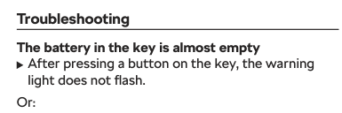

Thank you very much @inspectorman and sorry but on my manual was not explained.
I need to change the battery for sure.
Reread the text in the image….. It says the battery is low if the red light DOES NOT flash. 👍🏼😉
