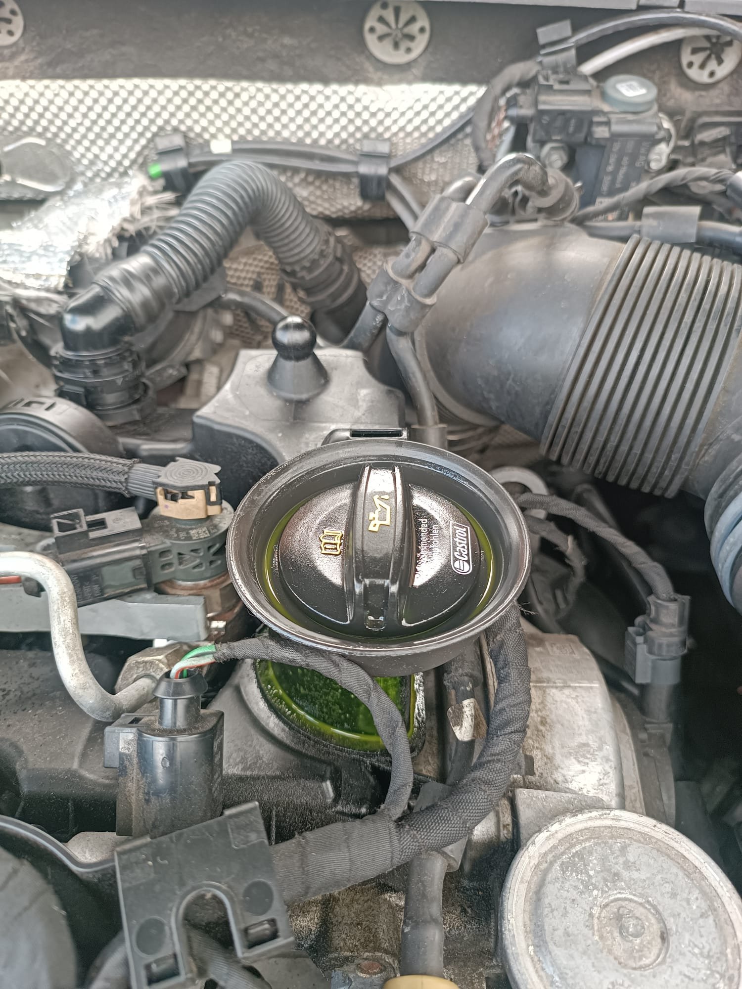

When flashing the UV light the only place I can find a leak is from the area where you fill the oil in.
I've attached a picture.
My question is, is this common and if so what part do I need to replace. Is it just the oil cap?

A myriad of possibles, particularly as not much info known about the car's history, servicing, mileage etc which may be relevant.
If the leak-check is the green dye shown in the picture, was that spilled as well, or is it what has accumulated after running the engine?
First off, I'd run the engine with the filler cap removed to see if you've got pulsating pressure puffing out, this may indicate worn rings or badly seated valves.
If there's no leaks then it must be burning it, probably turbo goosed. Could be other things like rings and valve guides/seals though.

The dye is from after running the car.
