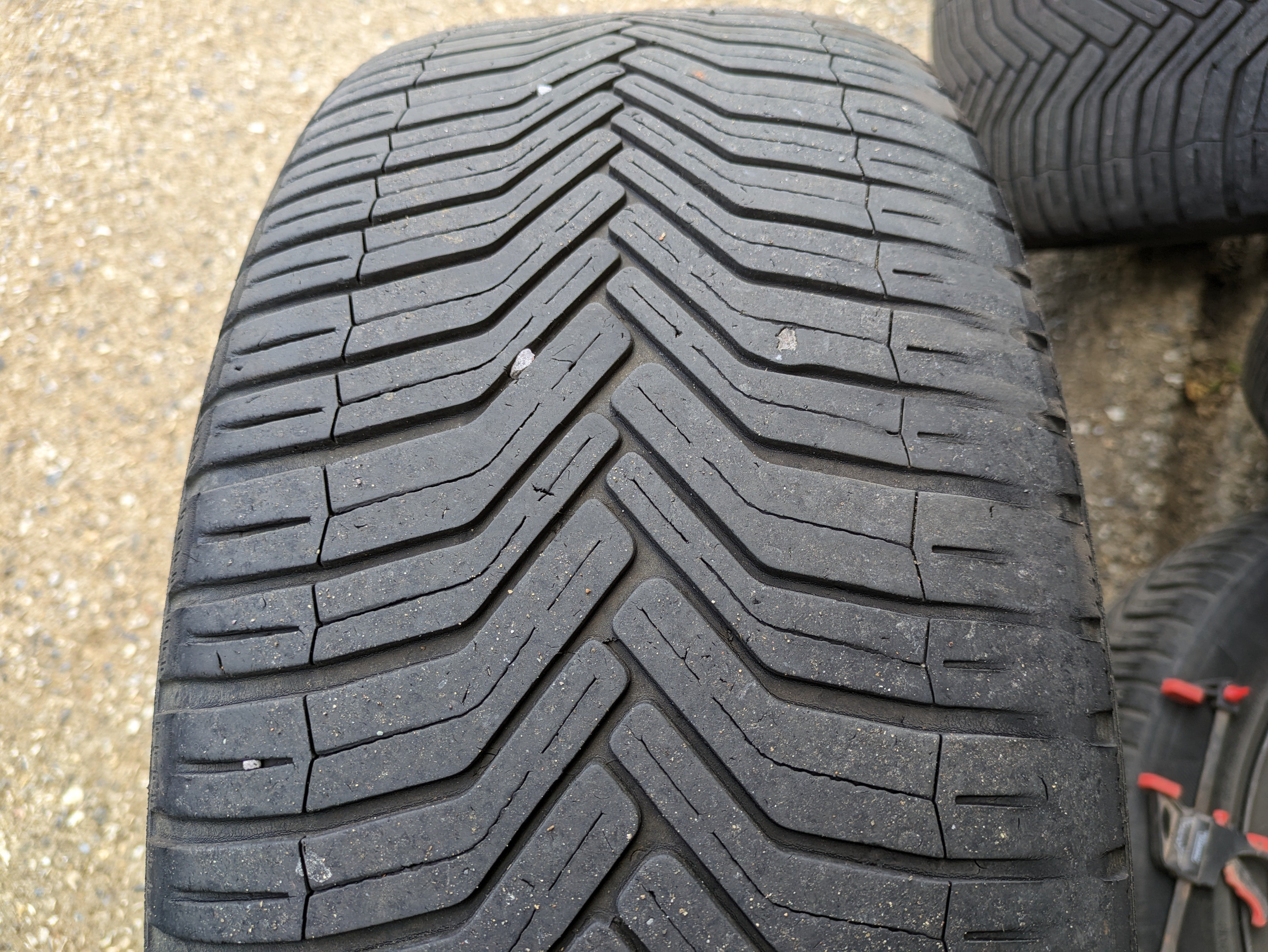

Finally got round to swapping to summer boots. The "winter" tyres that came off are actually cross climates.  They've been on for a combined 24 months give or take. I do about 10k miles a year so around 20k miles on these. The photo is of the worse one. This was a front tyre. The other front isn't much better. The rears at least have legal depth tread across the full width.  All tyres are slightly affected by UV damage in the form of mild cracking.
This brings me to the possibility of replacing. I promised myself that I would change them for full winters when they wore out. What would briskoda do? Use them for another winter season? With a worn shoulder my gut says don't compromise on safety. Especially as they are for the colder, wetter months.PXL_20240527_141743953.thumb.jpg.615c46c4b60e3652c8129f865c9ec18c.jpg
What is the tread depth over 75% of tyre? Is the scrubbing on the inside edge? if depth getting close to 3mm, I'd say replace for confidence.
Depth is definitely close to 3mm. Worn shoulder is the inside. I need to get the tracking redone. Drive on the motorway today the steering wheel was slightly out. Didn't notice it on the old tyres. Maybe due to the scrubbing.
Change them.  If you re bothering to change between all-seasons/winter tyres and "summer" tyres then now is the time to go the whole way with winter, "summer" swaps or all-season all year.
I’ve just ordered 4 Goodyear Vector Gen 3 All Season tyres.
Was surprised to find ASDA are cheapest. Coming in a few days. Less than £500 delivered.

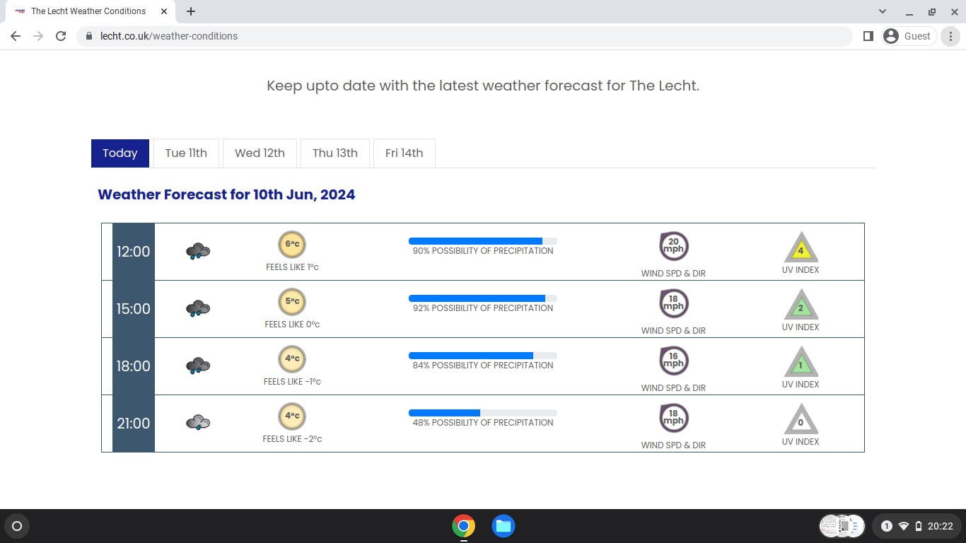

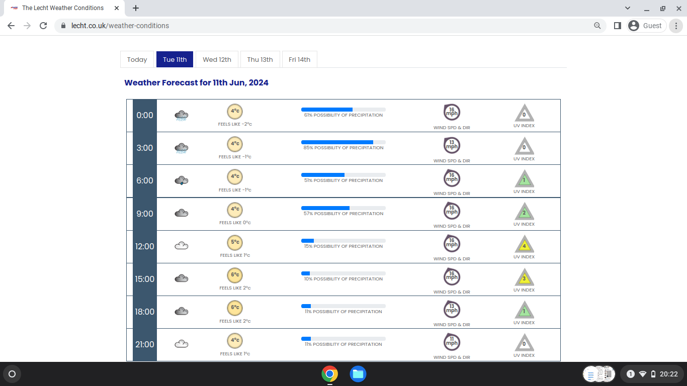

North East Scotland this week , Royal Deeside and across the Cairngorms, but people often just drive to the conditions in what ever, many visitors from anyplace will be on Summer Tyres.

Thanks all for the comments.  I think I will go for cross climate 2's or similar in another brand. I'll take a look at the tread patterns to see if any are ambidextrous as that will be handy for evening out tread wear.
I'd get my tracking sorted if that's what's caused the scrubbing, and then if I was stuck for cash, I'd pump them up to the higher "economy" pressure rating and see how I got on with them.
If the scrubbing is purely caused by hard driving, I'd change them.
