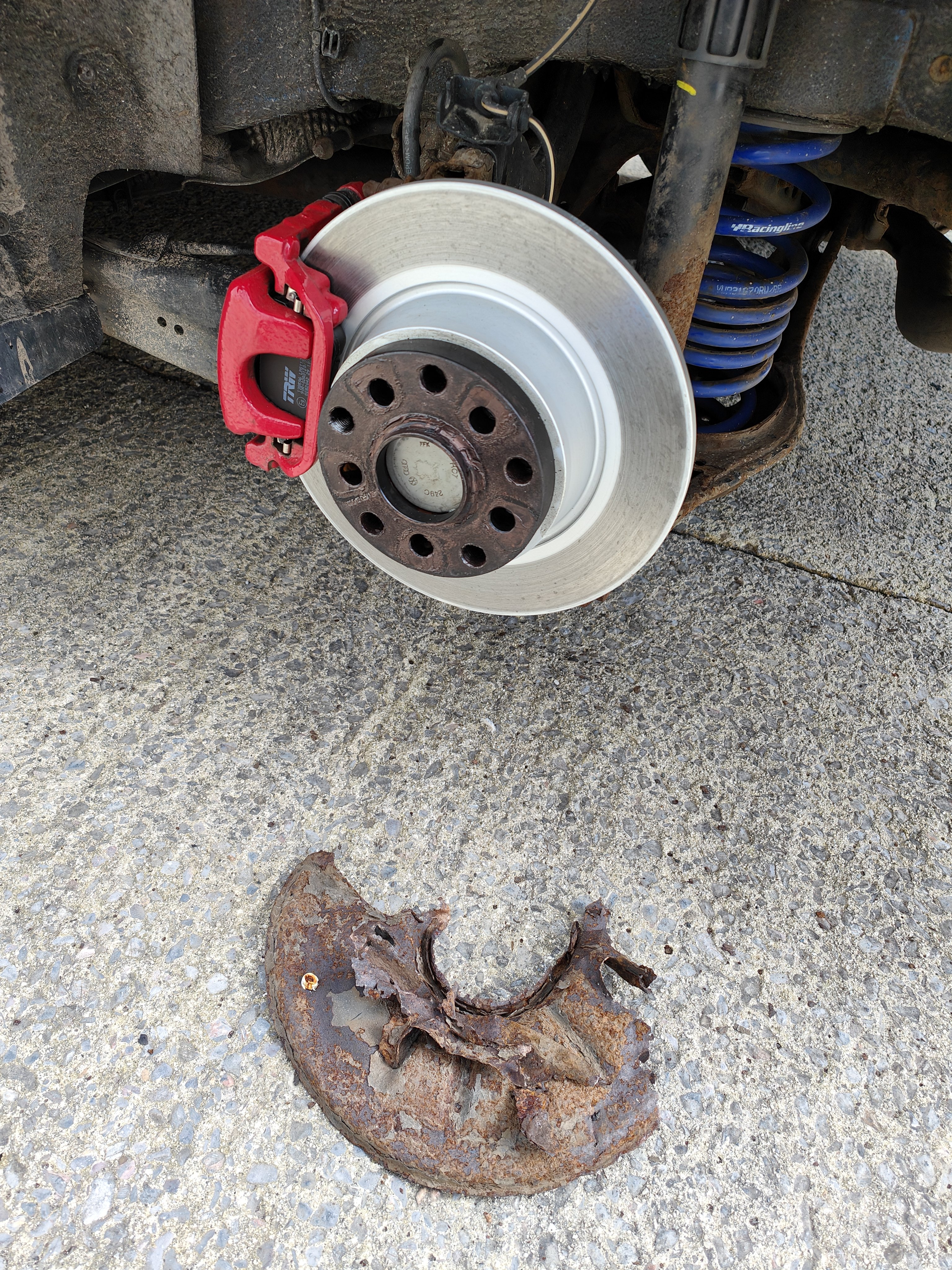

I've recently changed all 4 discs and pads which showed both rear disc guards are now more reminiscent of something made by British Leyland after one UK winter. Subsequently, after knocking one changing the disc it ended up having to be broken off. I've bought replacements and new bolts however I know I have to remove the rear hub bearings to get them on.

Possibly for non VRS or smaller discs, but having had it all apart I can't see how you would get the new ones over the hub.

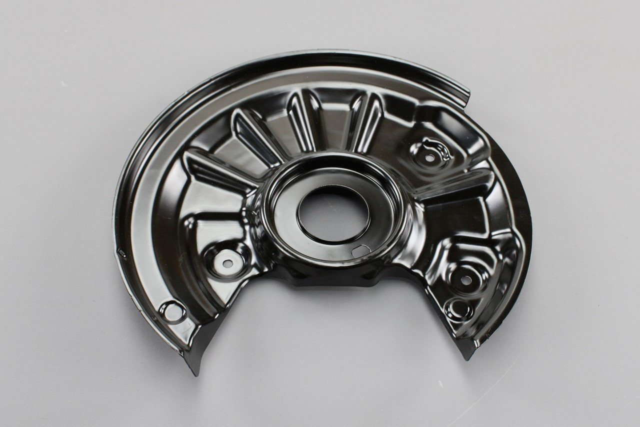

I can confirm the wheel bearing has to be removed to allow the guard to be fitted, there are three screws behind the disc that need removed. I replaced mine a month ago, while replacing the discs.
Thanks, that's what I thought. I've got the replacement bolts too as I think they are original and it's on 93k now.
