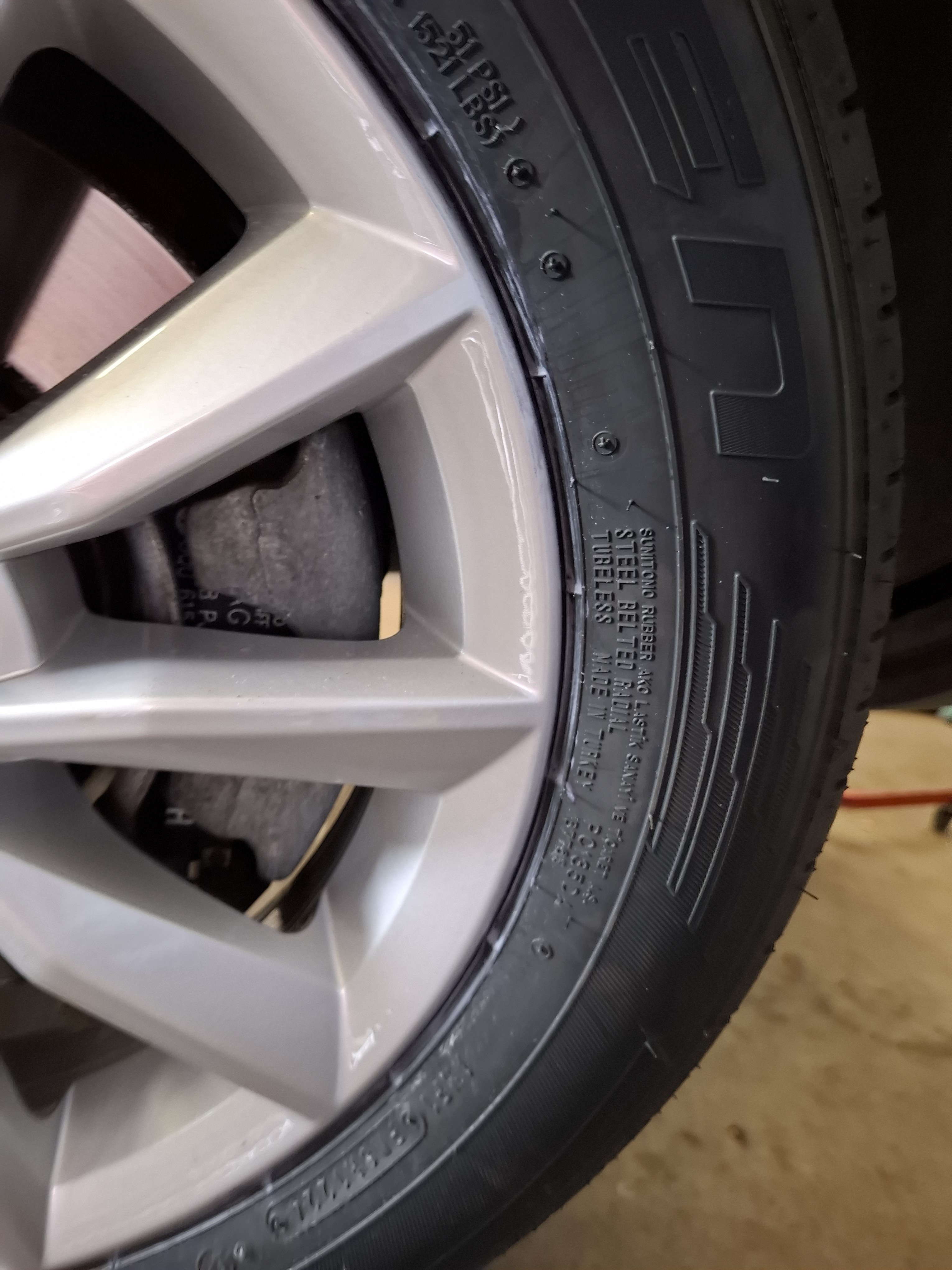

Did a trial fit this afternoon.
Not much of a gap tween extremity of caliper & inner rim :thumbup:

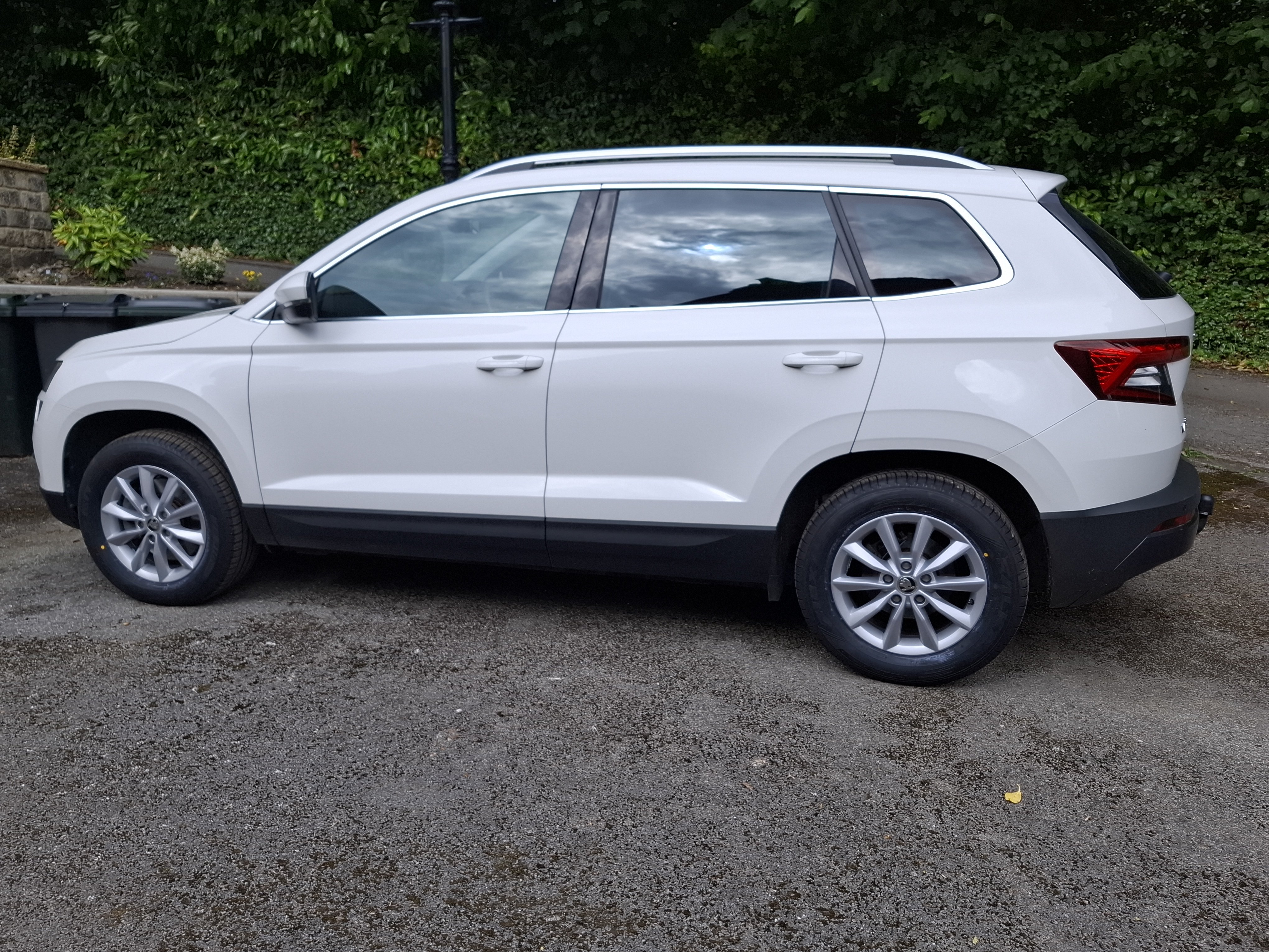

Just like to thank everyone for their comments.
   Wheels away for powder coating.
Will post some pics of car with new wheels tyres on in 10 days or so.
:thumbup::thumbup::thumbup:
For those interested.
Had the four 16" Octavia wheels with Falken 215.60.16 tyres fitted today.
Total excercise cost me £740.
Very happy with outcome....
Better ride & much less chance of kerbing the alloys.
Plenty clearance between front caliper & inside of wheel.
Replacement tyres in future at 100 quid rather than 200.
